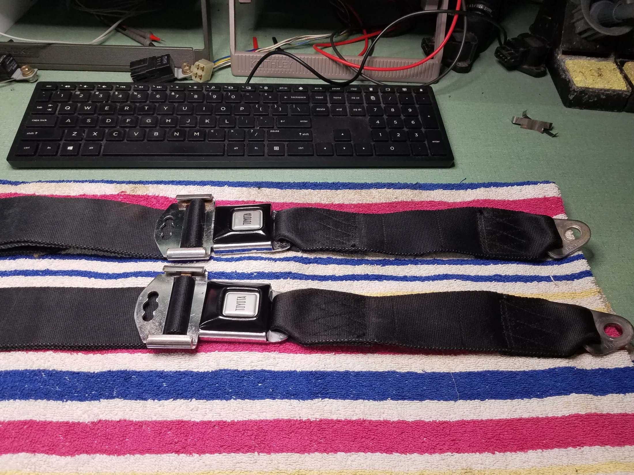

I finished cleaning up the rear seat belts. They are still 50 years old but at least they are clean.

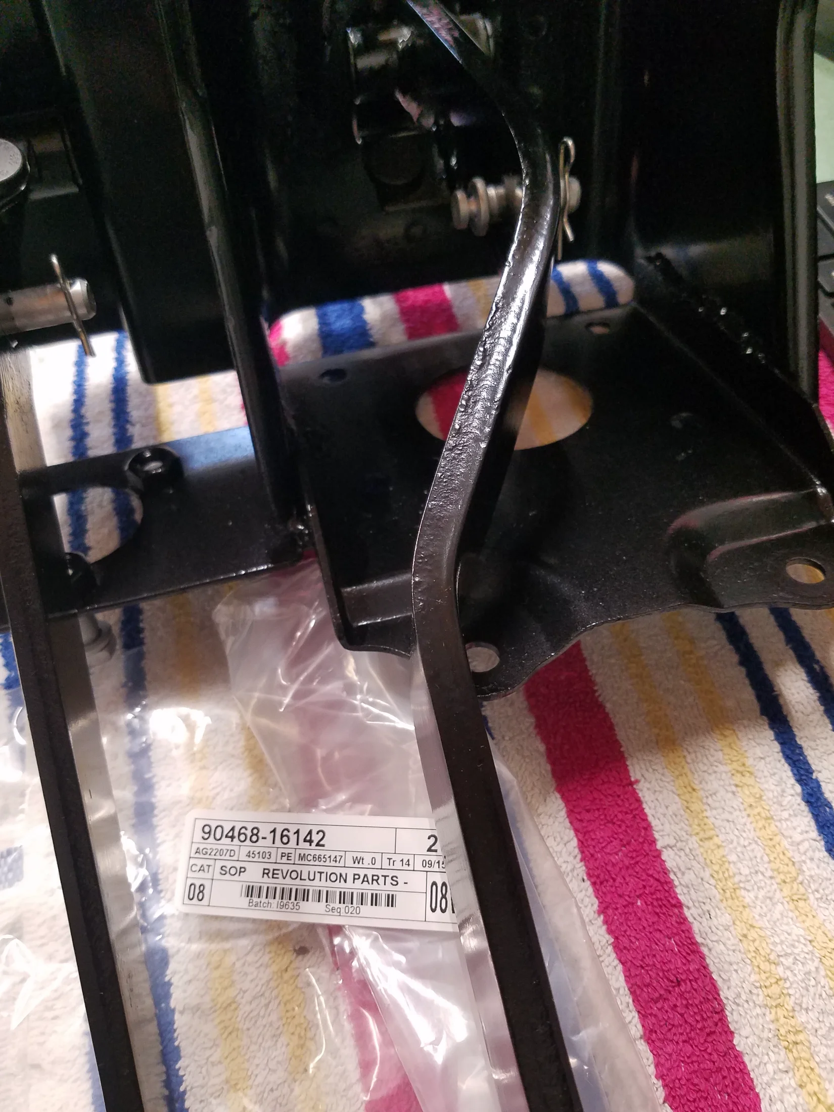

The clevis pins for the brake and clutch pedals use a cotter pin to retain them on the 40 series trucks. I hate standing on my head trying to install or remove one of those pins so I looked around and found these clips used on the 80 series trucks and a bunch of Toyota cars.
Why couldn't you have posted this about two weeks ago? Haha 😆

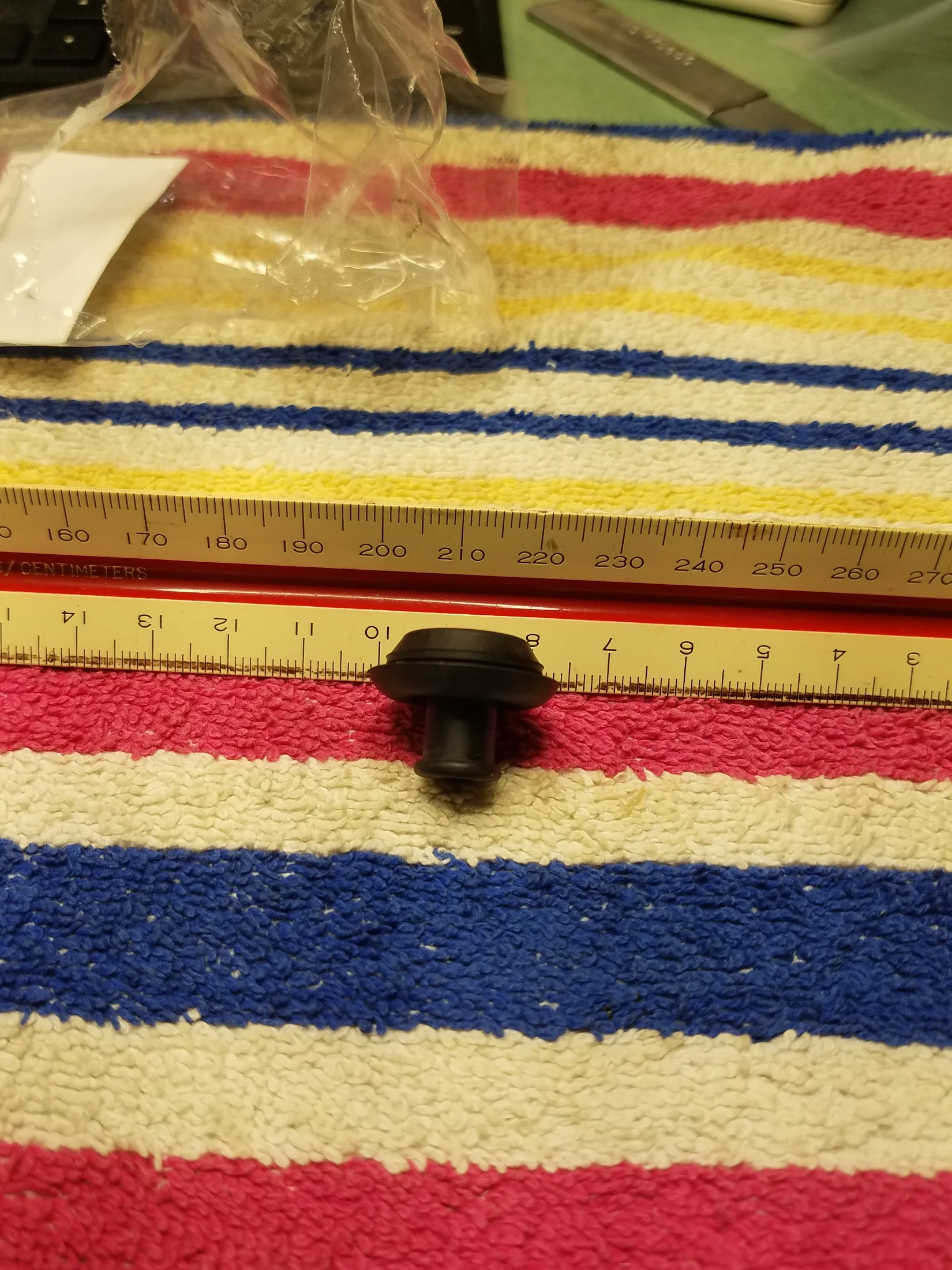

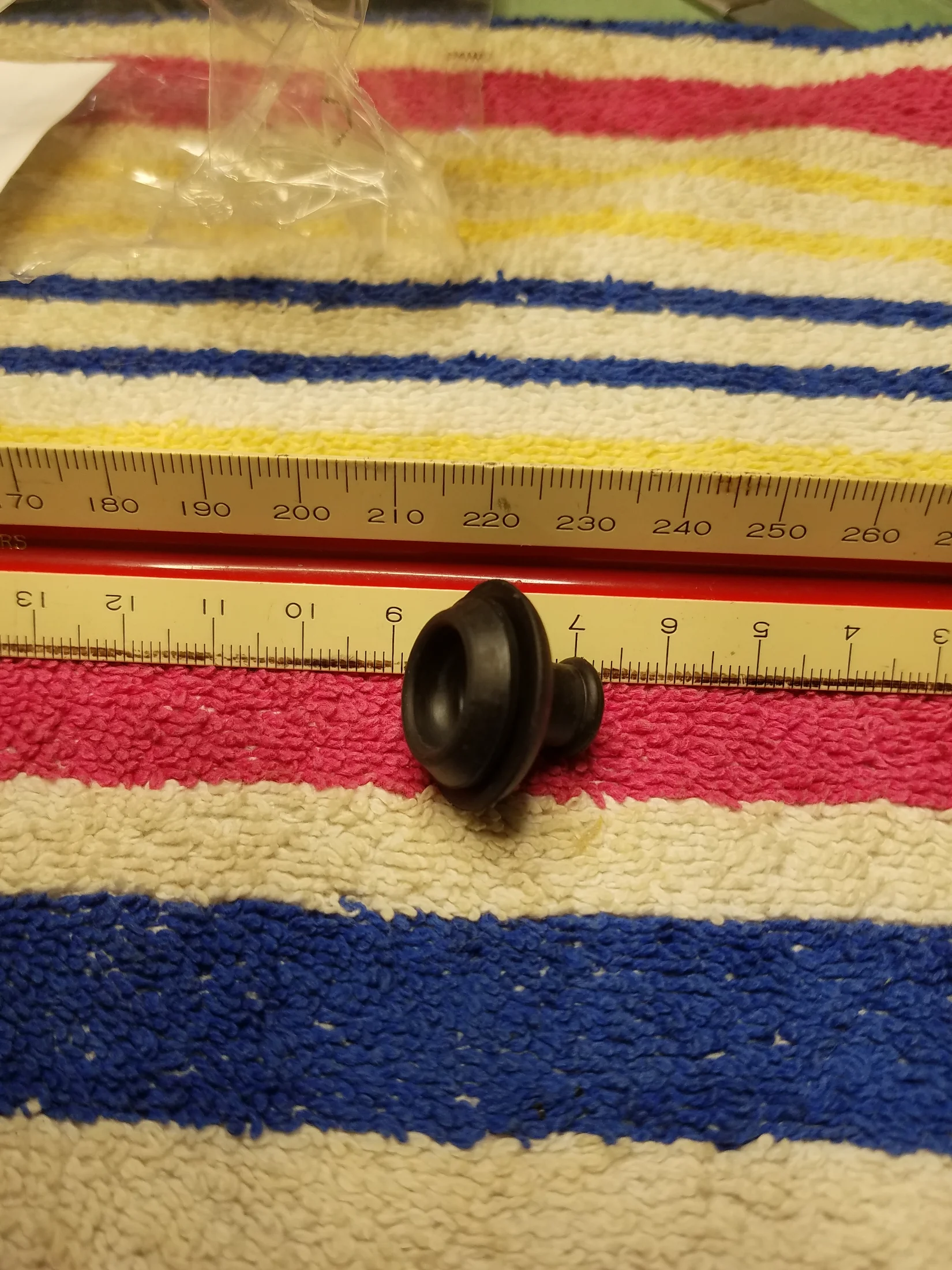

As an aside, I am working on adding a rear camera on my 08 FJCruiser. There is a boss on the rear door for the grommet to feed the camera wire through but the part number for the grommet is a mystery. I found this one, not the correct one for the camera but is commonly used as a license plate wire grommet on Toyota cars. I wanted something with a neck on it to help seal out the water. It might work on the FJ40 rear wheel wells where the wires for the side markers come up through. I will check next time I visit my truck at the body shop. $8.37 from Mr. T, 90480-15194.
View attachment 3999316View attachment 3999318
I wonder if this would suffice as a door wire grommet for 60 series trucks?

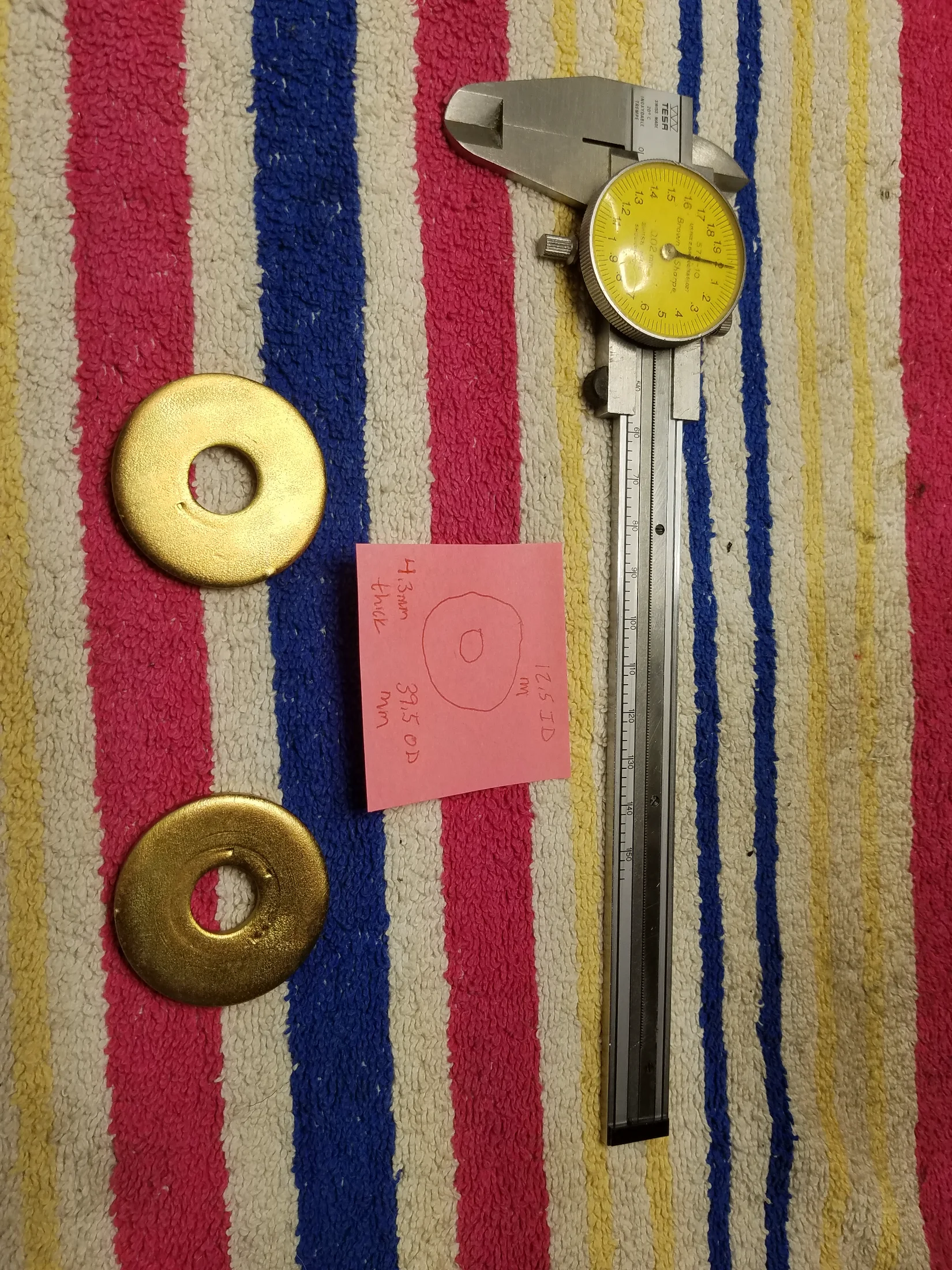

I wouldn’t say with any certainty but since I am elbow deep in my FJ40 seats, there are washers like these under the bolts that hold the sliders to the floor uprights.
One thing I notice: the holes in the seat slides for the bolts are almost double the size of the bolts. It’s as if someone intentionally planned on potentially twisting the seat a few degrees left or right instead of a well- calculated hole alignment. Of course with a hole that large, a decent washer will keep the hex head of the bolts secured better that just the minimal edge of the 6-point head
They did come from inside the truck I think, this makes sense. I will put them in the seat bracket box.

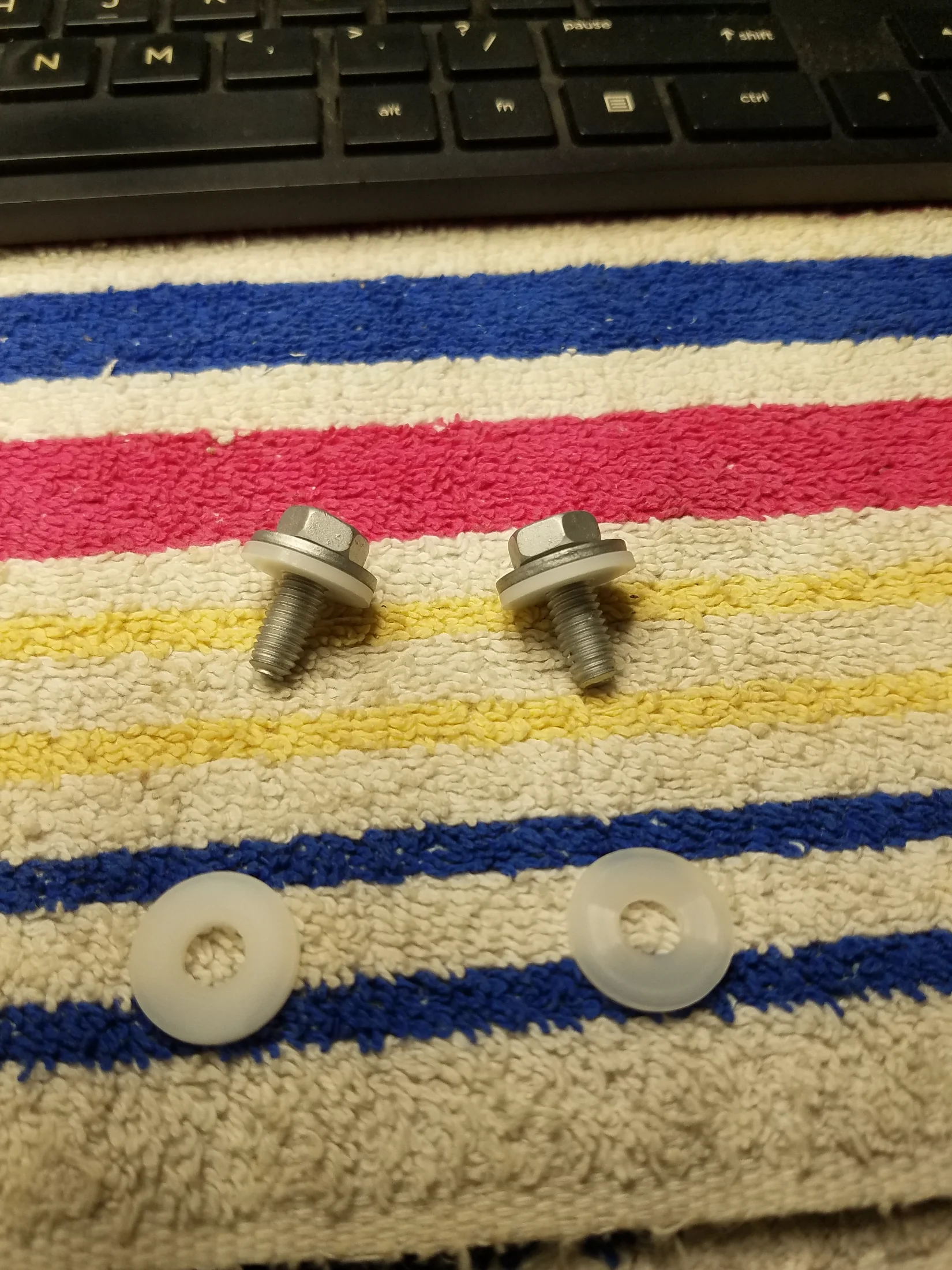

The four bolts that attach the front top to the windshield, 90119-06086 are NLA. They are apparently a hex head bolt with a steel and Teflon washer.
I am using a 90080-11179 with an M6 nylon washer added.
