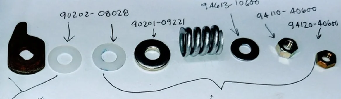

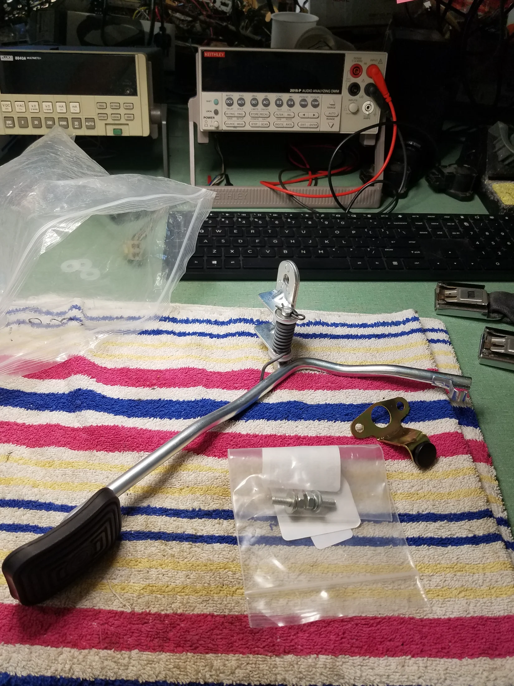

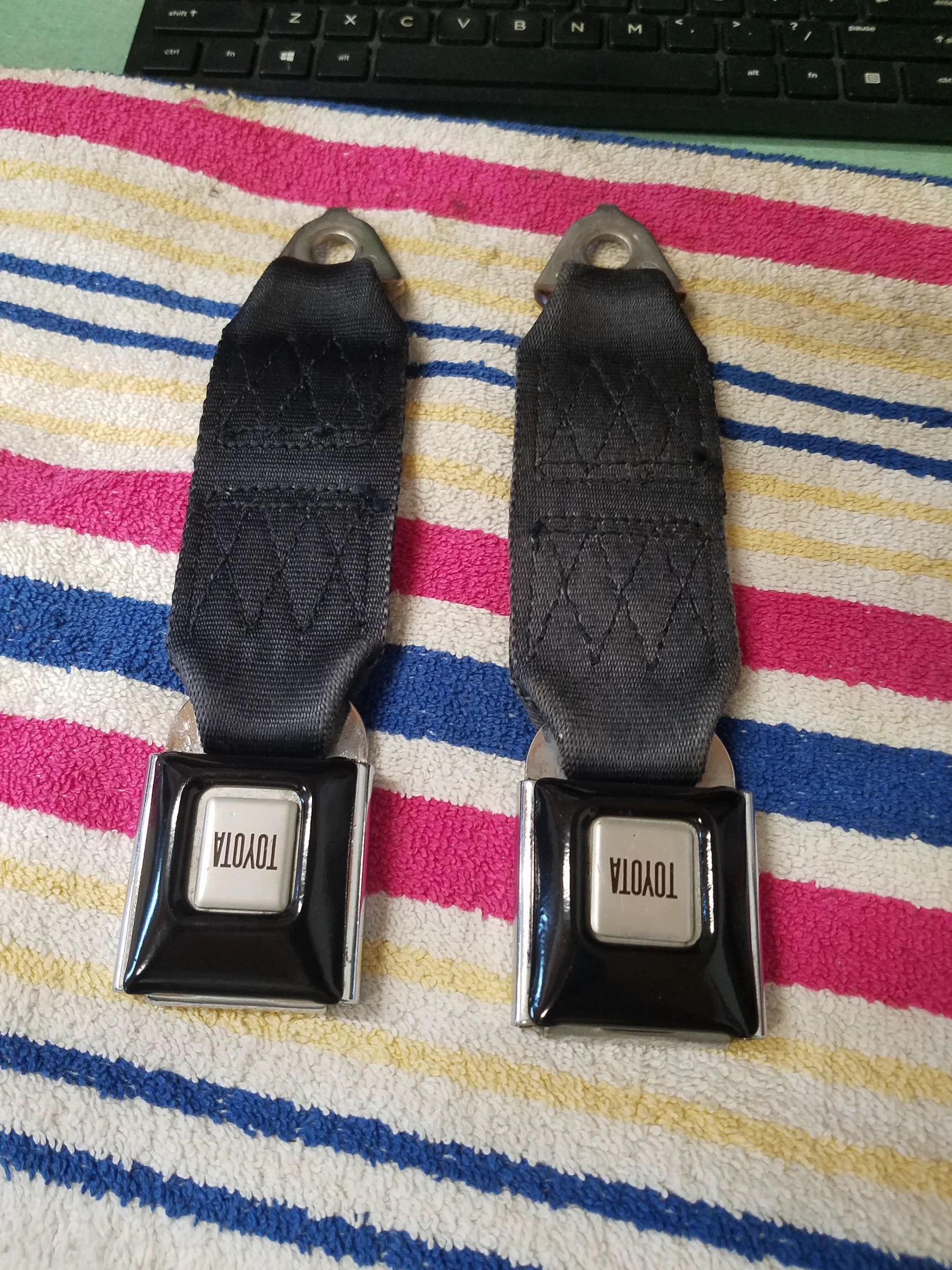

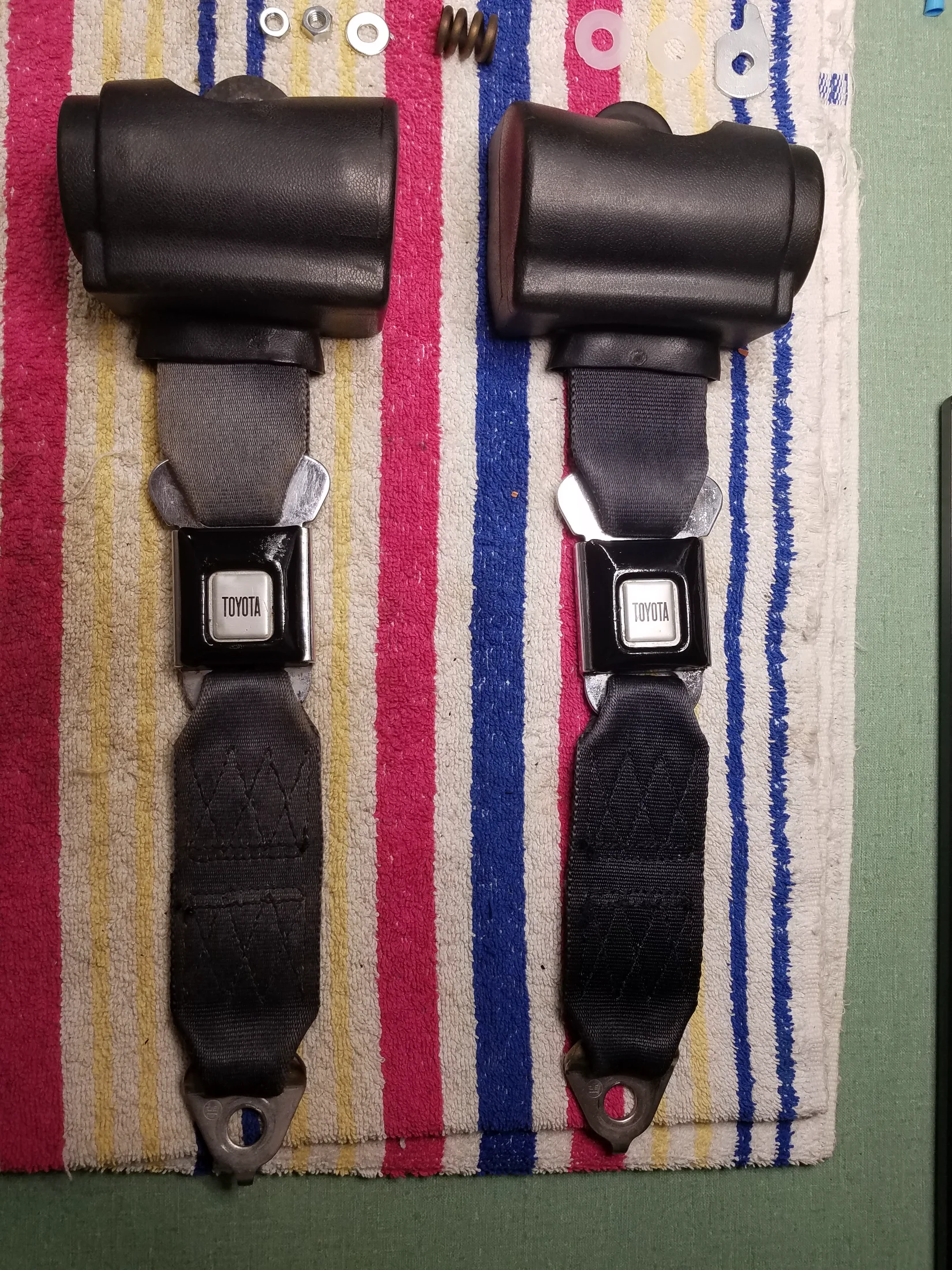

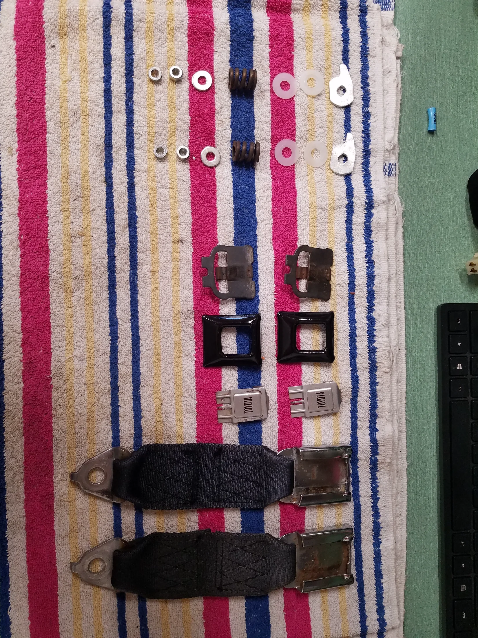

Gathering wing window hardware, somehow missing a washer. Ready to assemble front seat belt buckles.
Missing 90201-09221, NLA, thought I had them plated but guess not. I ordered some thick M8 plate washers, nobody will know.

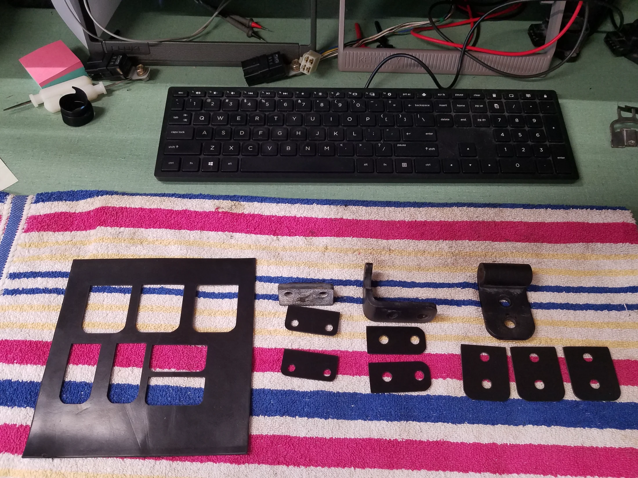

In his defense, there was a lot of rust to fix and he is doing a great job, he is an experienced body guy. He also has other projects in the shop needing his attention. He replaced the rear quarters, wheel well tops, rear sill, front floors and inner/outer rockers. We are fitting the tail gate and spare tire carrier now. Since the rear quarters and sill were replaced, it is a blank slate. He is careful and we are looking at a lot of photos to get it right. I am using the nut plates that @cruisermatt sells for the tailgate hinges. The location of the spare carrier latch on the replacement rear sill is not correct for a tailgate truck so that was a puzzle. By the way, the hole spacing for the tailgate hinges and spare carrier latch are the same, so those nut plates can be used for that also.
When the tailgate and spare carrier are settled, they are coming for the chassis to mock everything up before final paint prep. Almost there.
