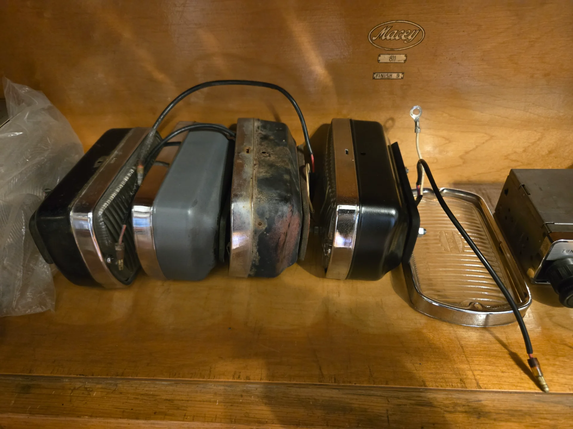

I have a stash of 73 reverse lights. I will probably keep one as a spare and sell the other two.
If you have a spare glass lens I am interested. My original from my 73 got broke when the cruiser was parked in my driveway many years ago. Probably the main reason I searched for a spare many years ago.
You are first in line when I get around to moving them on.

Check out this thread. I purchased one to install on Louie so that the glass one could be kept on the shelf in the shop.
I have a plastic one too. I will probably use that if I get to using this truck a lot. I have an aftermarket vader light hood also that I use so someone doesn't five finger discount the real one.
Unless someone knows what it is doubt it would be an issue. Years ago I would put one in a pile of parts I was buying from a wrecking yard and wouldn't be charged for it. I once bought a 73 reverse light off eBay for $10. Only description was a fog light off an unknown Toyota. One man's trash is another man's treasure.
