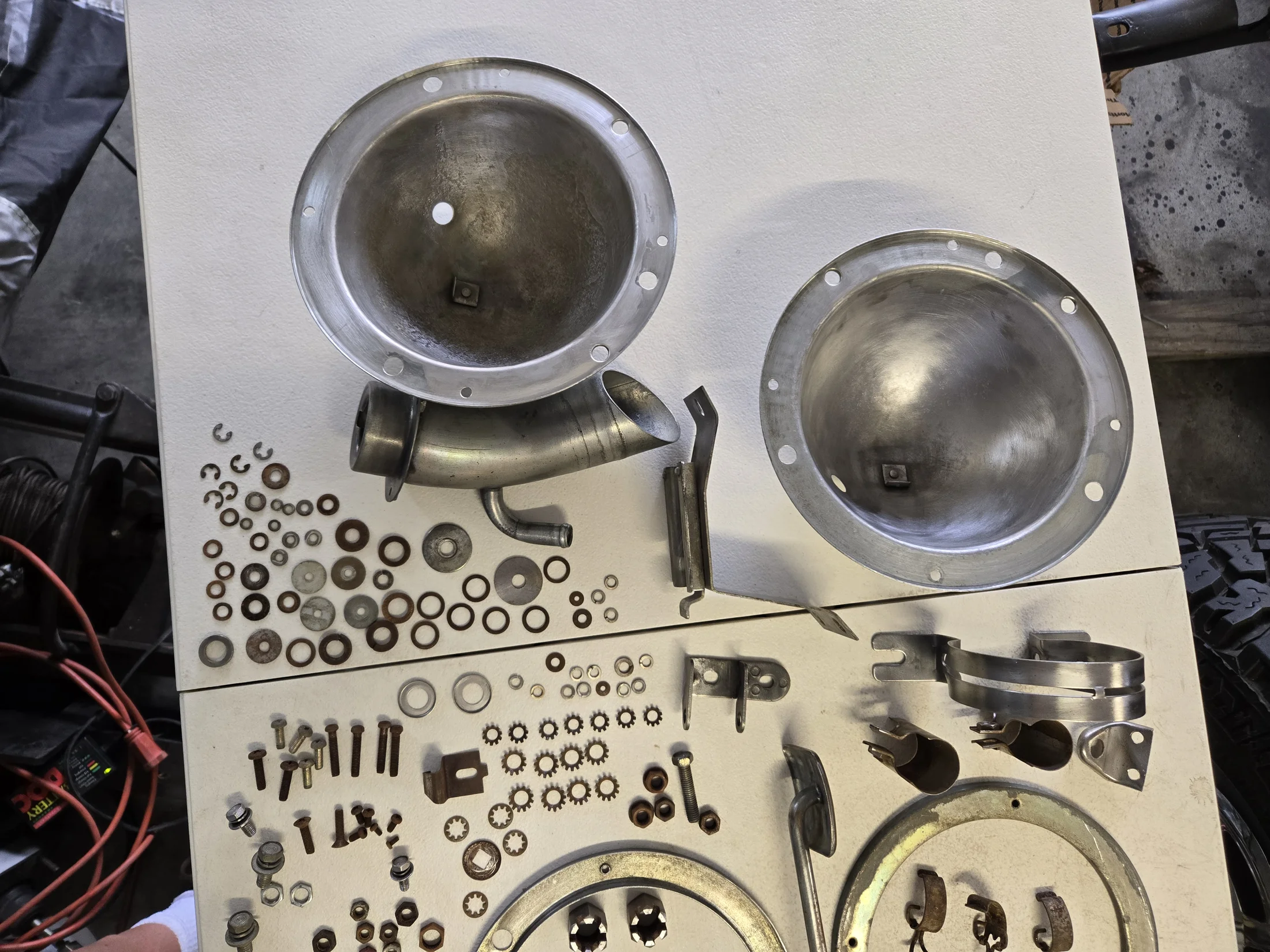

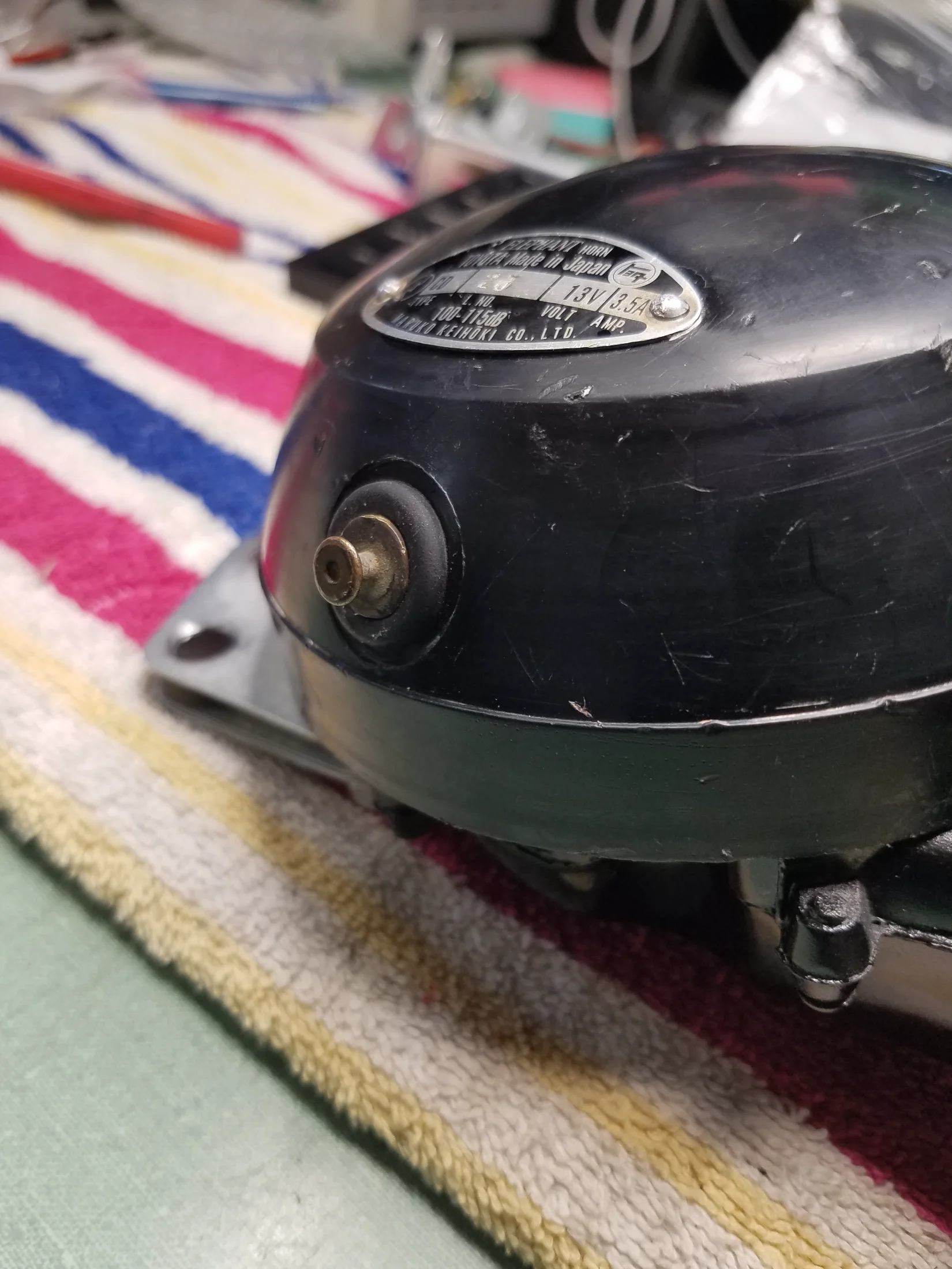

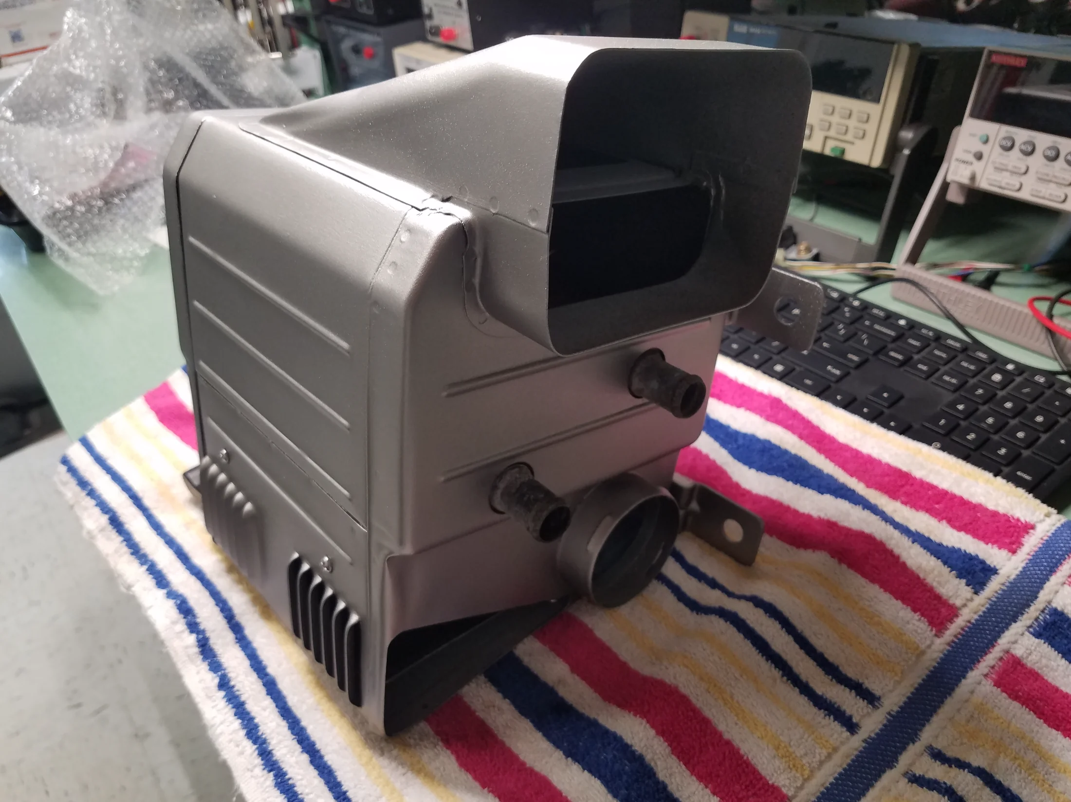

Finished the front heater today.
The Cricut is great for cutting gaskets. I’ve cut several different types of material to generally good results.
Excellent …this will some beautiful presentation when you’ve finished…meticulously assembled and I look forward to seeing the completed vehicle..will be a winner for sure

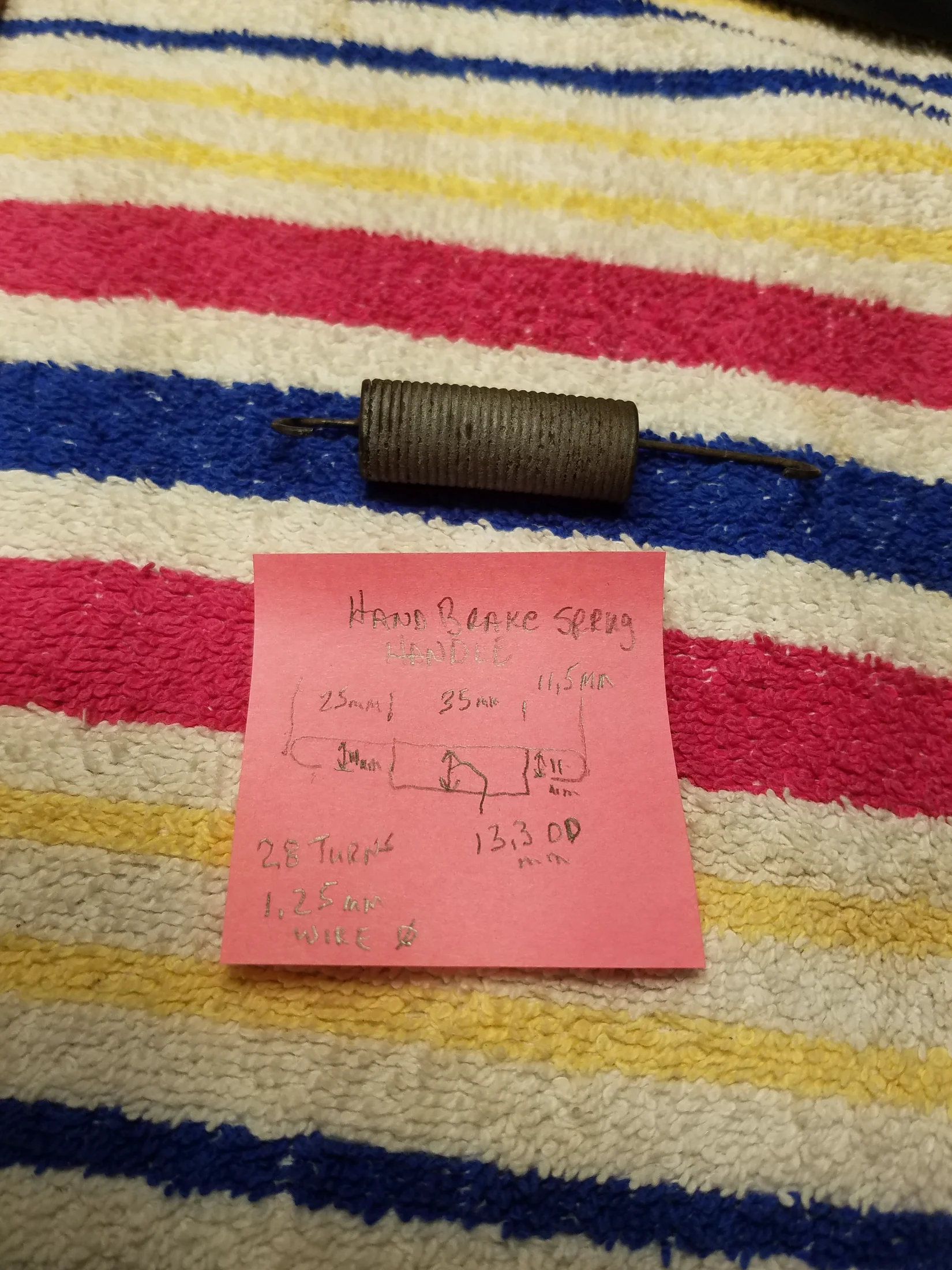

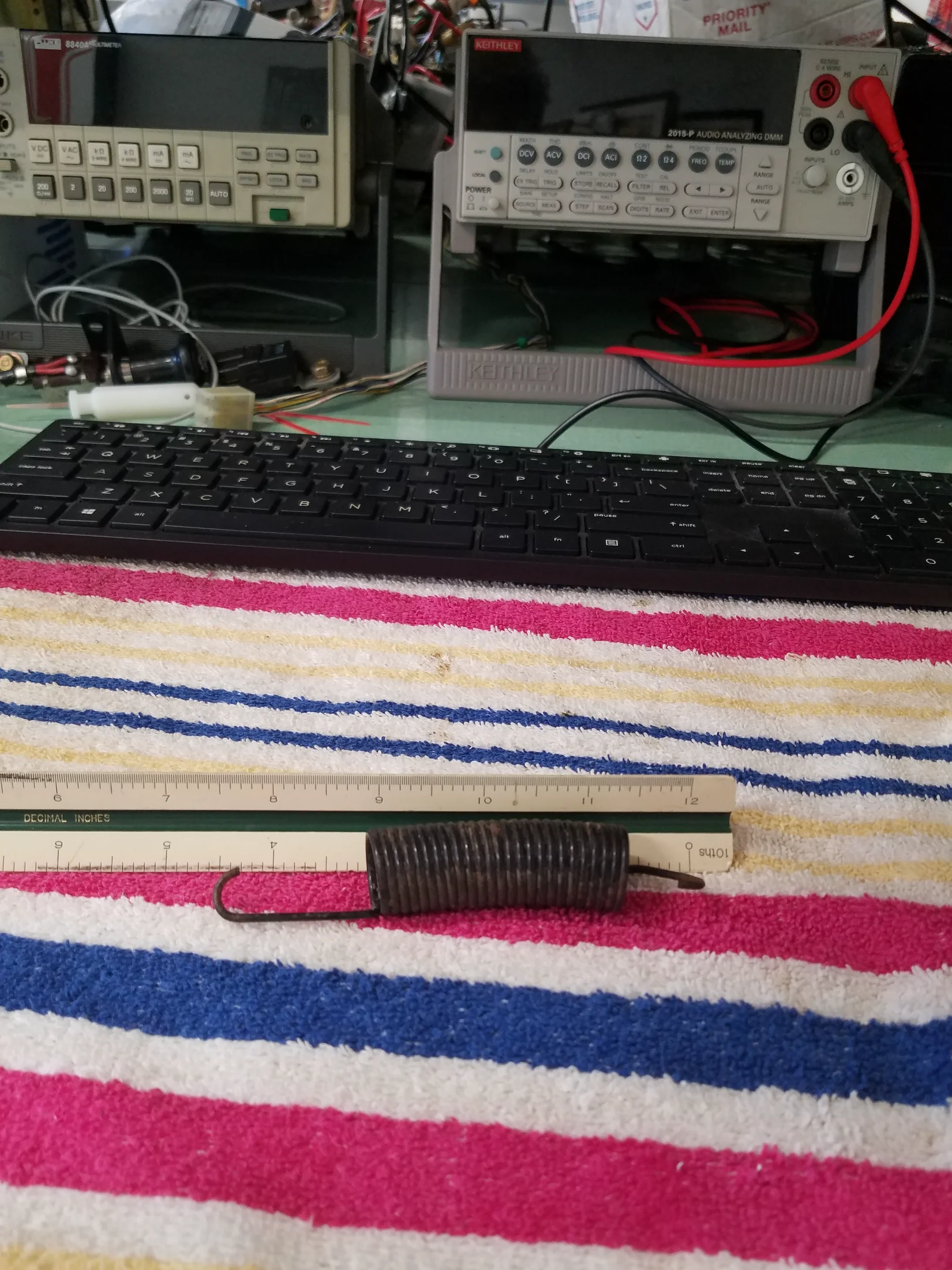

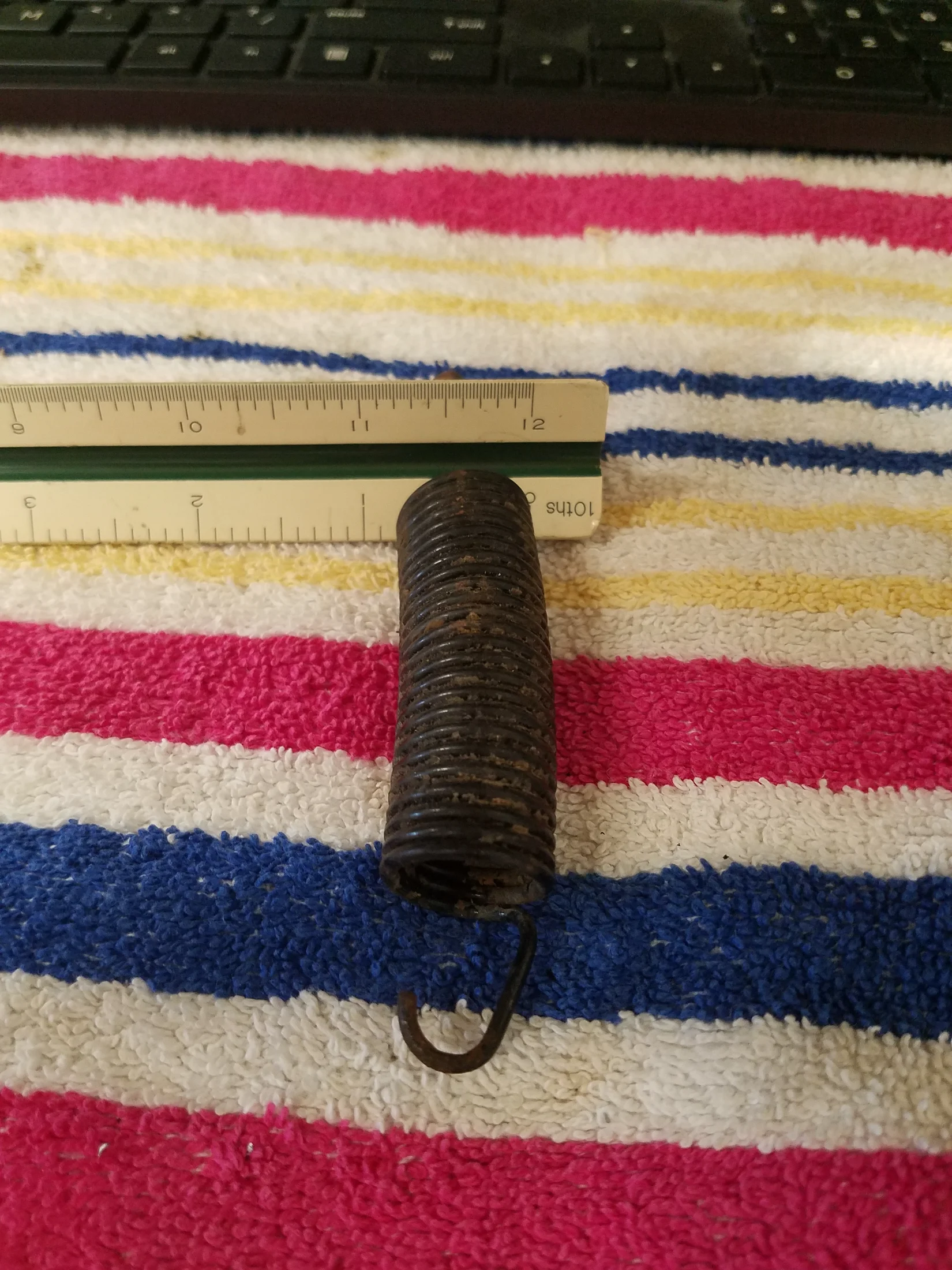

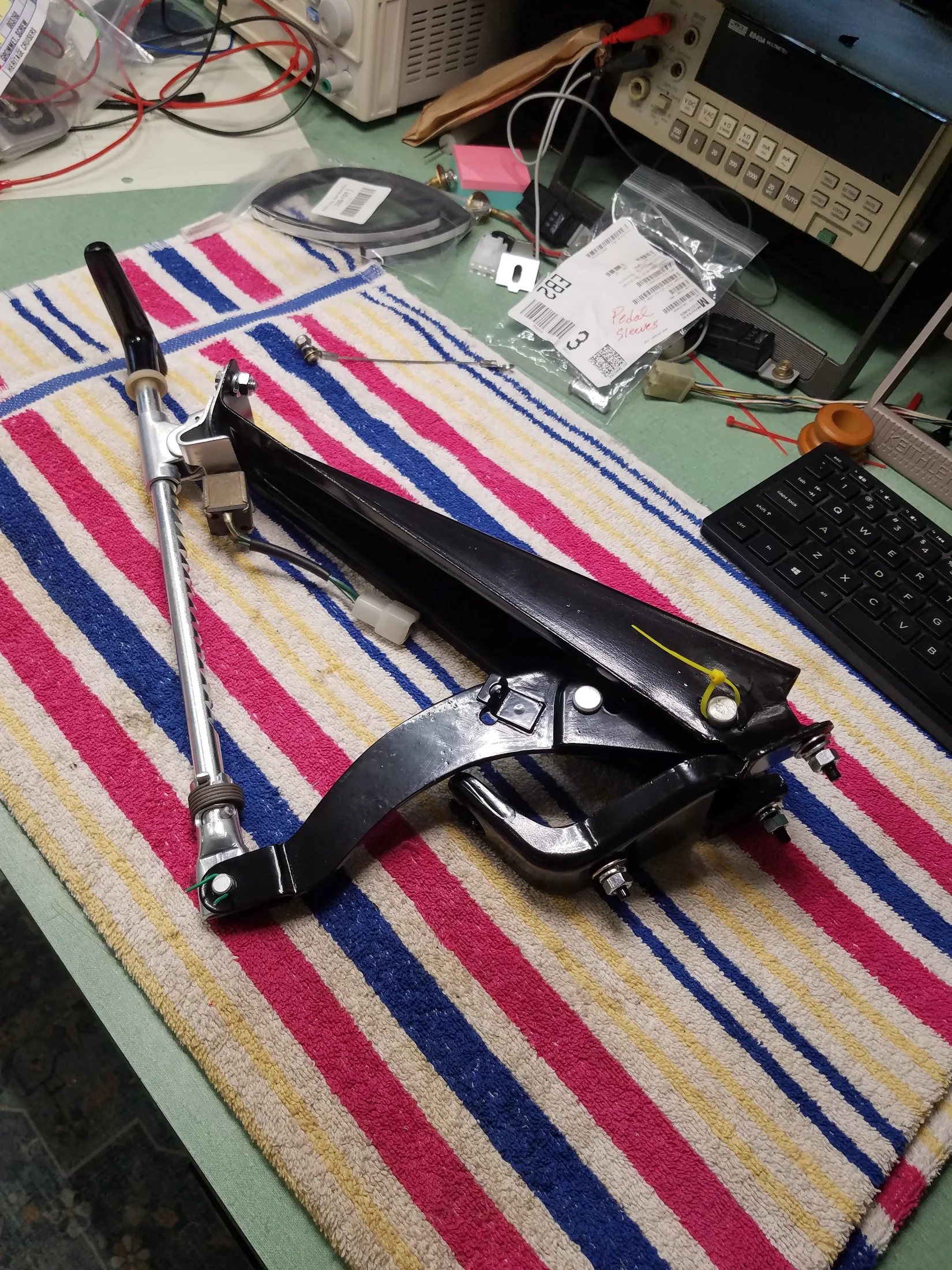

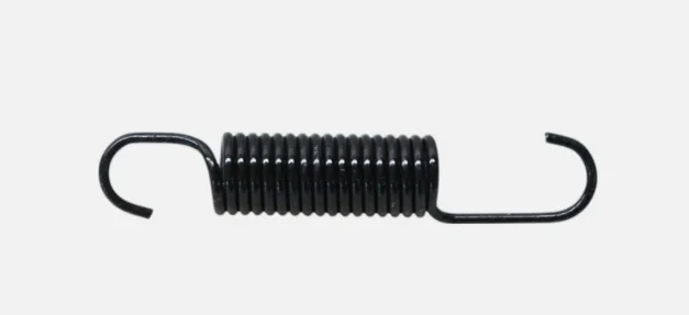

I'm trying to track down the spring for my parking brake handle. Is this it? I think it is too big and the two hooks are clocked 90 degrees from each other. about 4.5 inches long and 3/4 inch diameter.
