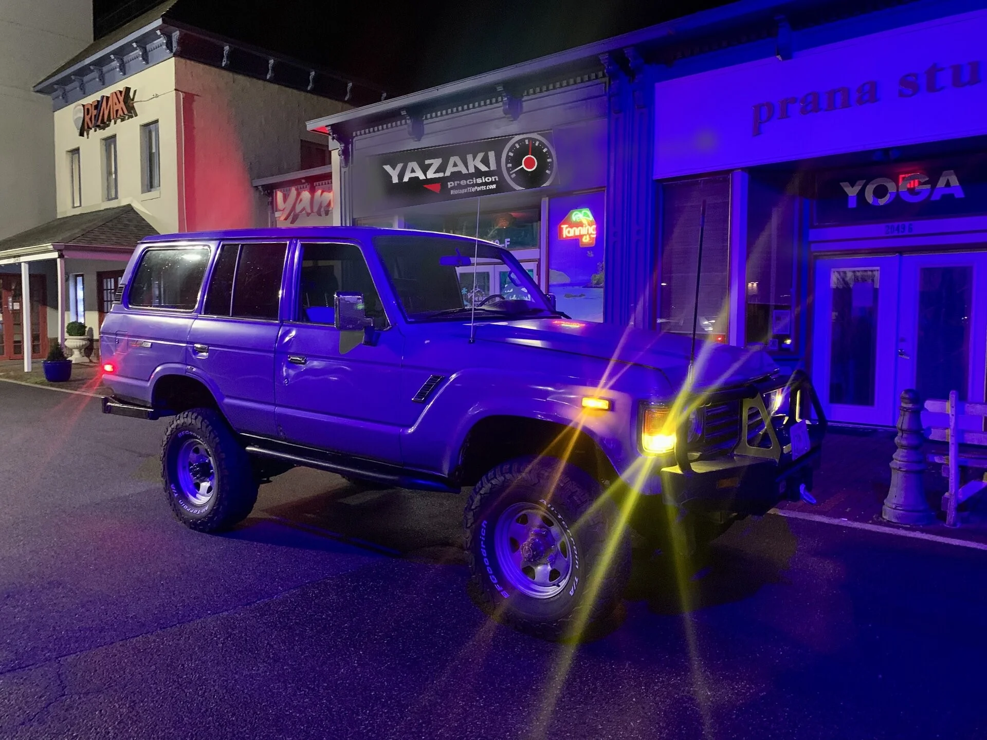

I personally find the whole steelies grey or this new ODD black glossy look , awkward and the use of them on a 60 / 62 with the chrome teet ctr caps , goddless 🤢

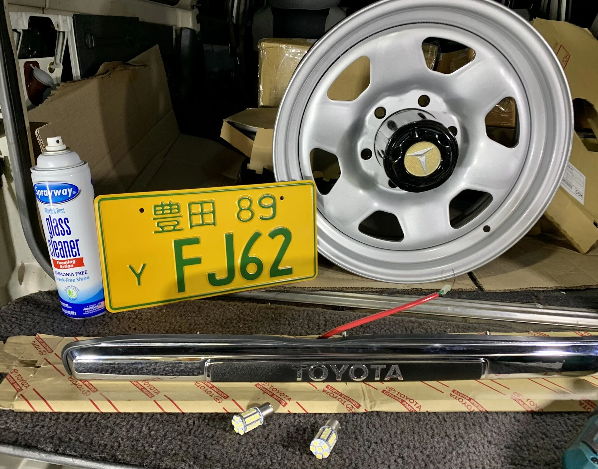

- this is the moment i brought them home to the shop , i swear it felt right , NO shipping at any local toyota dealer either
, there affordable and a 16" wheel
go find any tires for a 15" wheel in 2023
this is the way ....
Yes.
the perfect storm topic here is a 15" wheel of any kind is now a fossile , in the tires world period
- why ?
- front brake calipers got bigger and bigger
- but in the non-usa far away , solid front axles still used
- hence ,
- PROPPER tie rod ends clearances OK !
- F Spacers , if you want to cheat fate go ahead ...
- these WILL also direct bolt to ANY NON solid fronts or rears toyota oem 6 lugs ....fyi
- finish is a metalic pewter , like a 40 YAZAKI cluster meter and glove box is

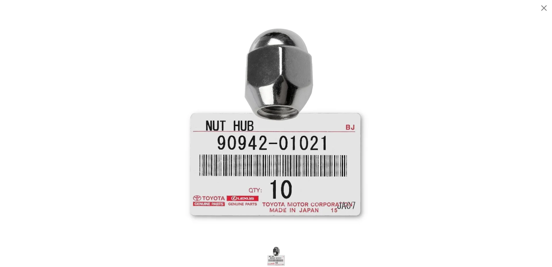

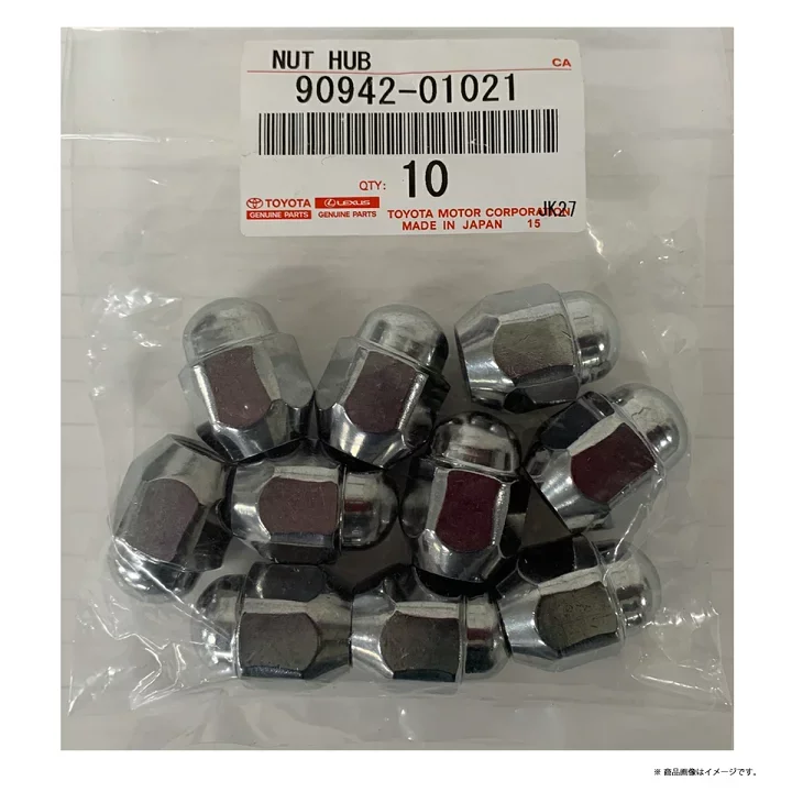

- i chose the : 90942-01021 lugs for my own brat reasons , but i only roll a PURE ACHORN's
- no sissy , almost pure radious ones
- + the 90942-01021 still made in japan
CHROME is thick and heavy duty too

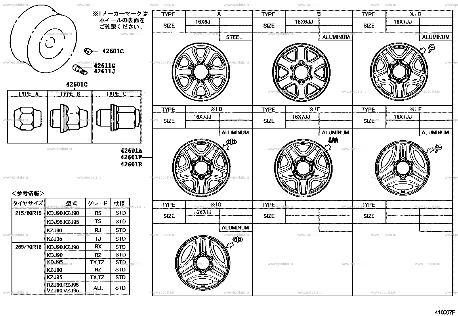

They fit and they look great, but they have a zero offset, meaning that they sit inwards 15mm compared to the stock wheels, so your track width will be narrower by 30mm.
can you please elaborate on the Zero-Off-Set topic ?
- if you have a copy of your PLANT A11 market regions offset . JJ spec's resource chart that would be good , i left mine at the laboratory today , .....
- oh , what stock wheels are we comparing the new Sparky 70 series wagons to ?
thanks
matt

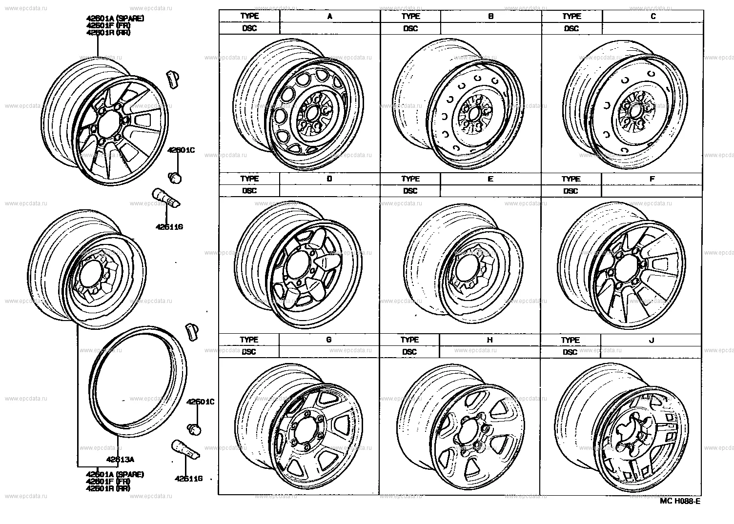

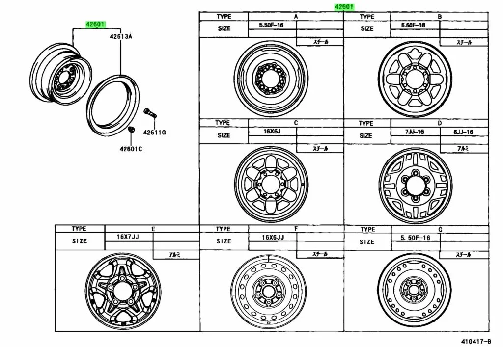

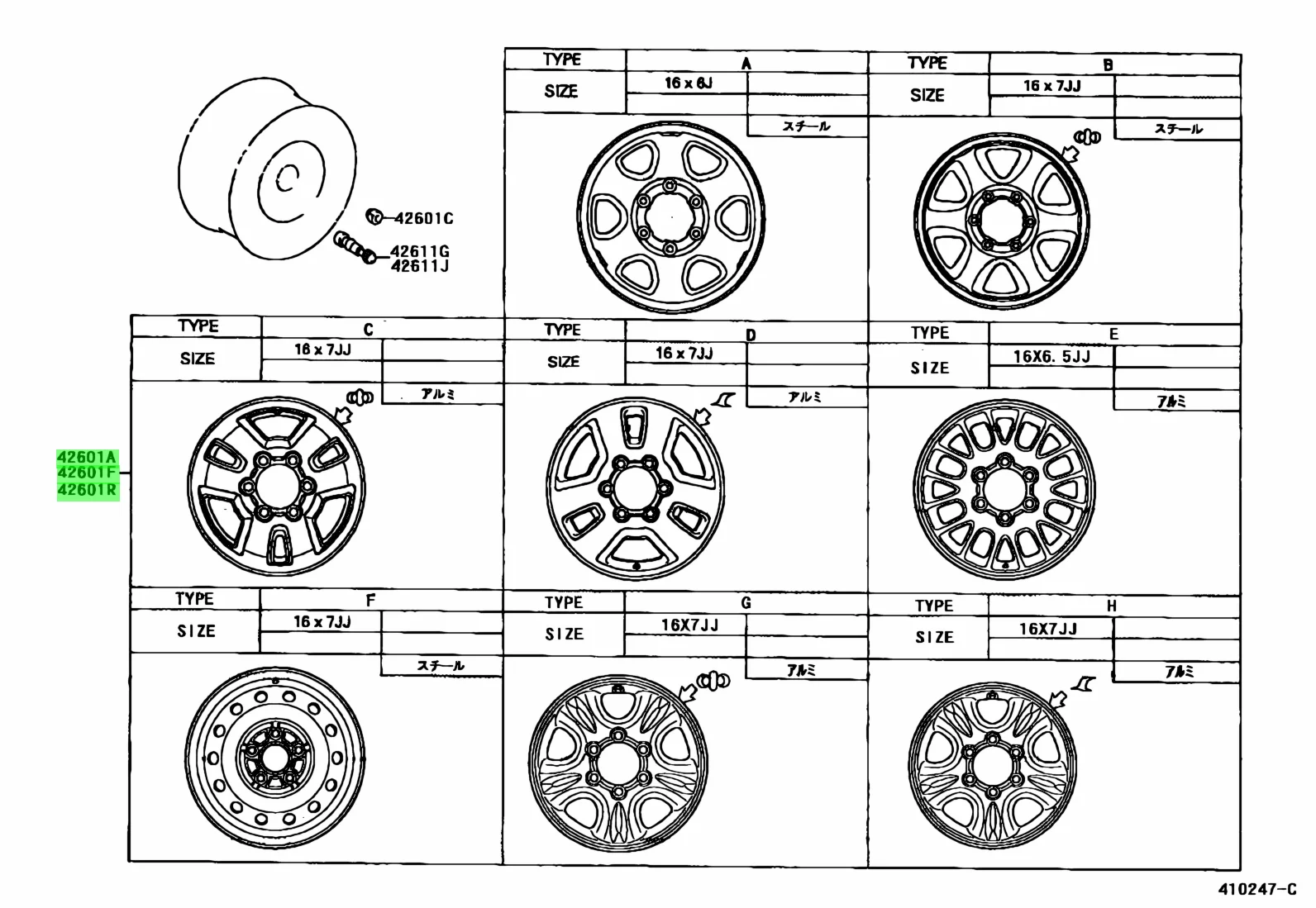

I'm just working from memory from when I was researching wheels for my 62 build. I'm 99% sure that the 42601-60262-03 (Type C above - 16x6J, I think) steel wheel is ET0, compared to the ET-15 of the stock 60-series 15" wheel. I've found a couple of posts here on Mud that back that up, but nothing in the way of official documentation.

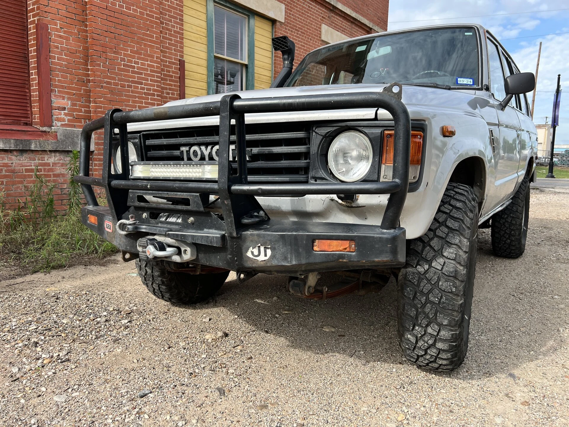

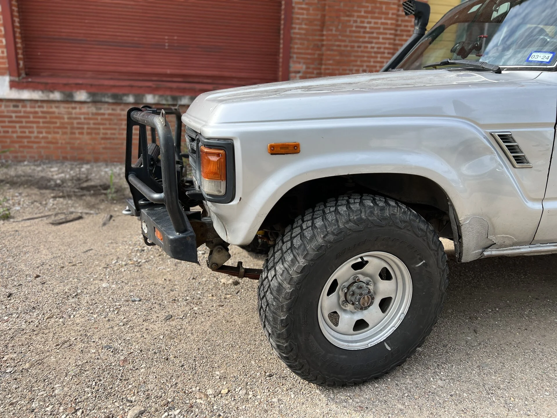

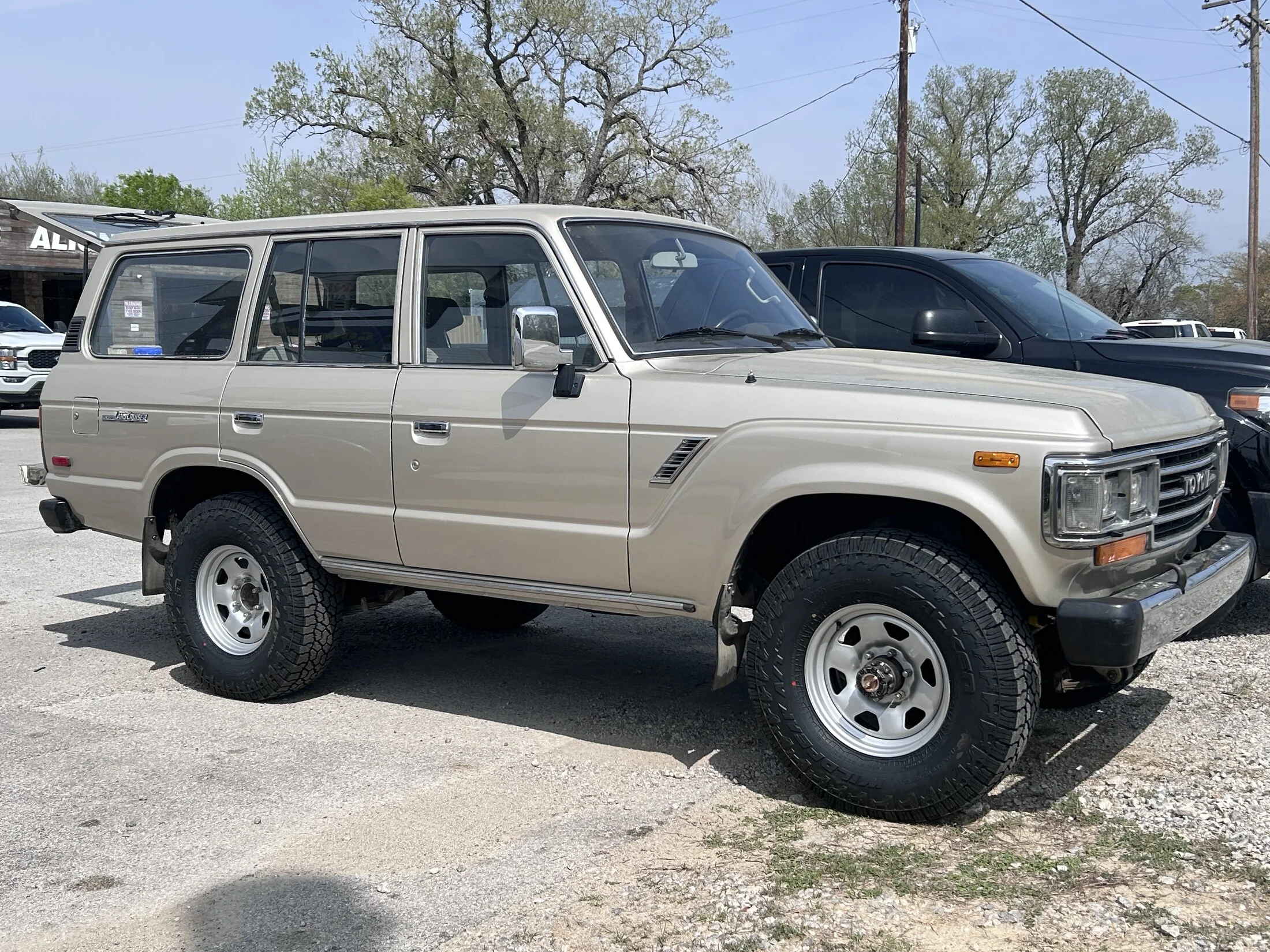

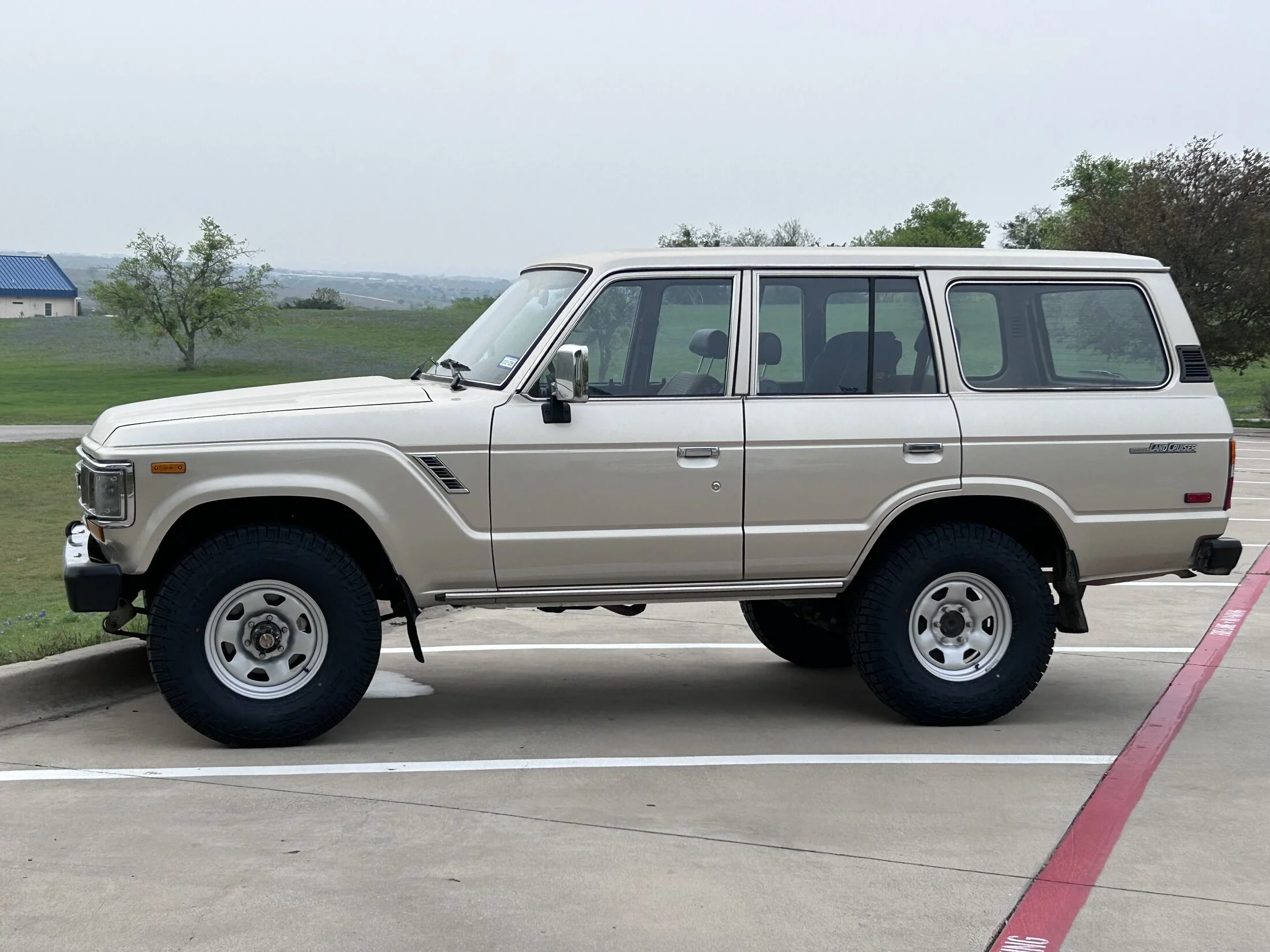

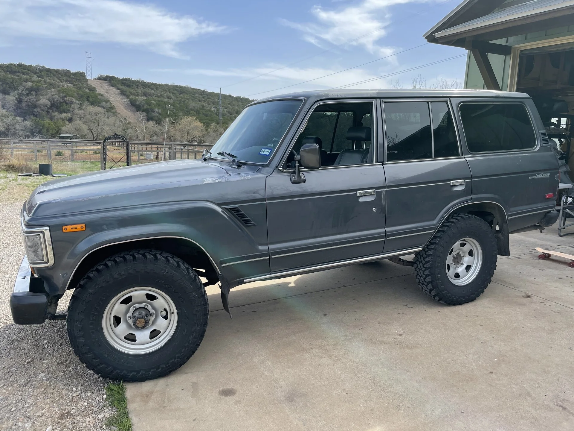

Another 2.5” OME on 70 series rims running 255/85R16. These are the new Falken Wildpeak A/T4W which run about 32.8” in diameter…I think the proportion runs perfect with the vehicle. Not too big, not too small. Well balanced aesthetically.
The rims give it the stock look with access to modern 16” tires.
