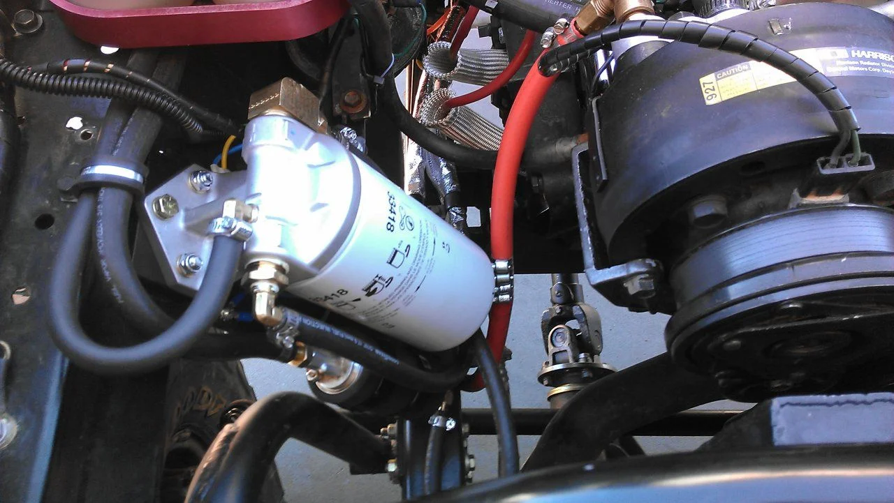

Fuel accumulator system finished and working after much noodling and re noodling on where to locate things. Copied from a Blazer friends setup which was patterned after something from the Mustang crowd. So far so good around town.
Got enough hose clamps on there, I think you may need one more just to be on the safe side;)
Only the amount required by the laws of air compression. If it's the orange hose with all the jewelry you speak of. That is part of the on board air system. The air/oil separator had to move to make way for the fuel parts. So rather than toss out 5ft of hose threaded through the frame, I just stuck a hose mender in there. The so called air hose needs 2 clamps per barb or it just shoots right off.

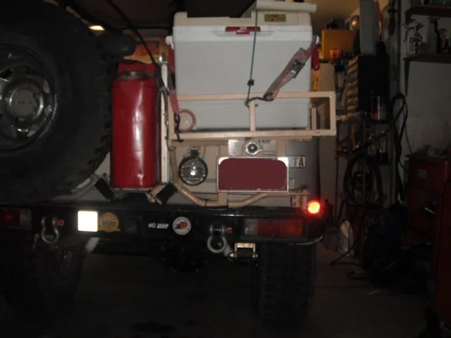

An attitude adjustment on the cooler rack. Cooler suffered some insults too.

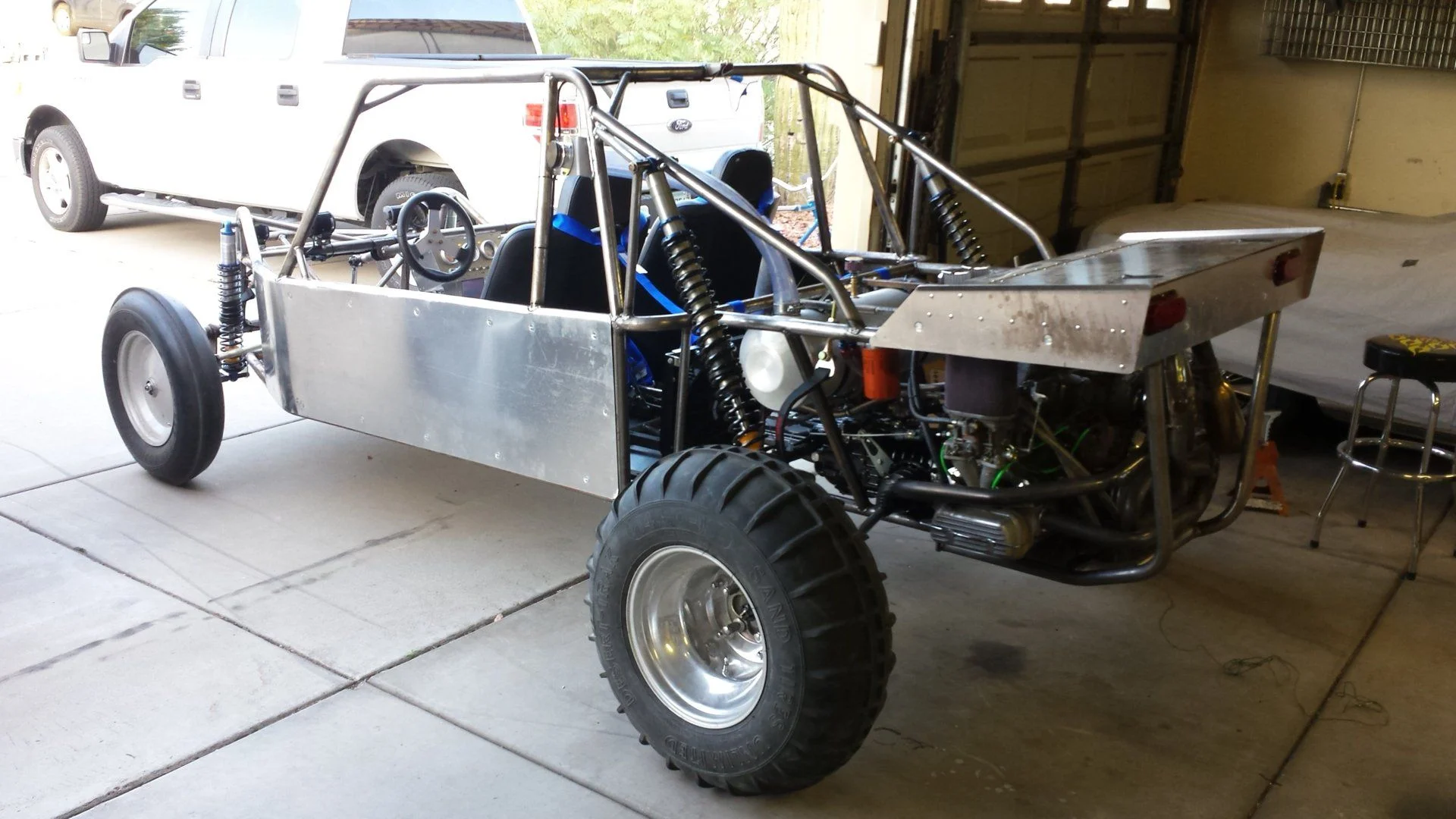

Hasn't happened much lately though. My other motor hobby has taken over. Built a sandrail from scratch. And currently it's getting repowered with an ecotec.
