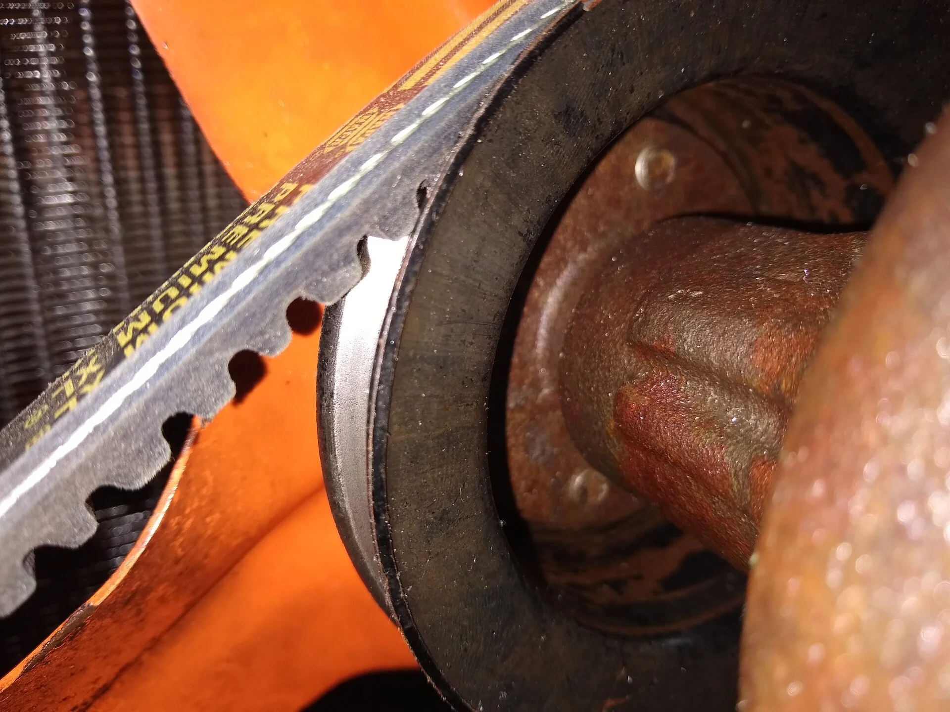

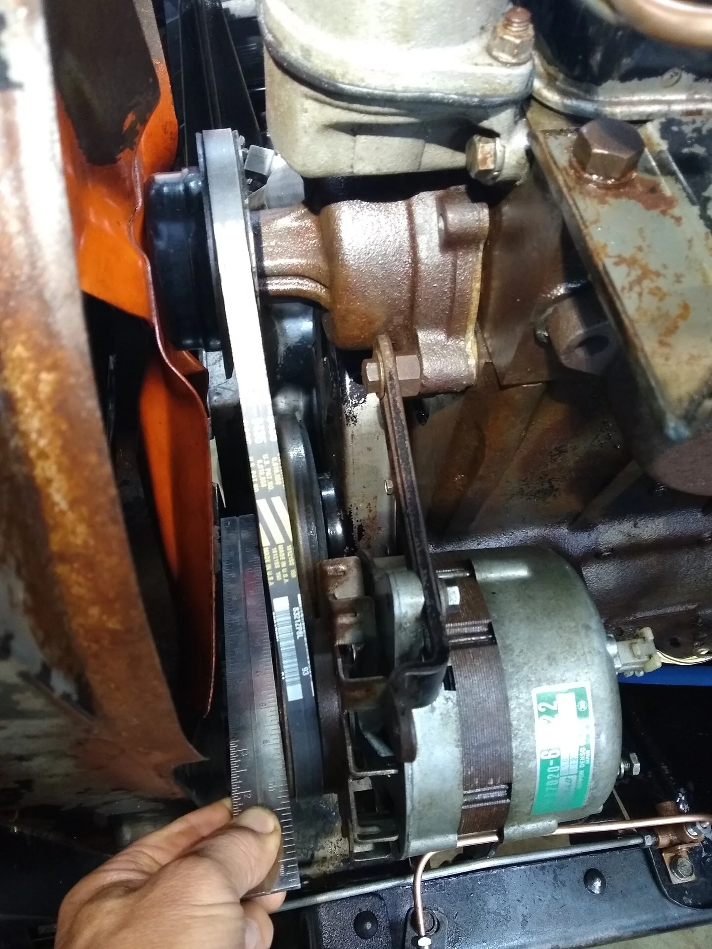

Hey all. Restoring a `66 FJ40, keeping this rig as was, minus necessary upgrades. Just noticed the water pump alignment is off after putting on new belt. The alt. and crank are aligned, albeit the alt. bracket is either backwards or something, as there's a nut spacer going to the water pump. It seems to me the wrong water pump is installed? The pump is approx. 1/2" out from crank and alt. Doesn't look like any spacers on the pump pulley. Two things wrong here:
1). Why is the pump extended out?
2). Is this the correct alt. bracket, and if so, is it reversed? I looked around the site for pics, but still doesn't solve the pump problem, so I'm putting both problems out there.
Lmk what you think
The thing that you bolt the pulley to on the water pump walked forward it seems, approx. 1/2", for anyone interested in what happened. Dead blow hammer set it back into alignment, now hopefully it doesn't leak.

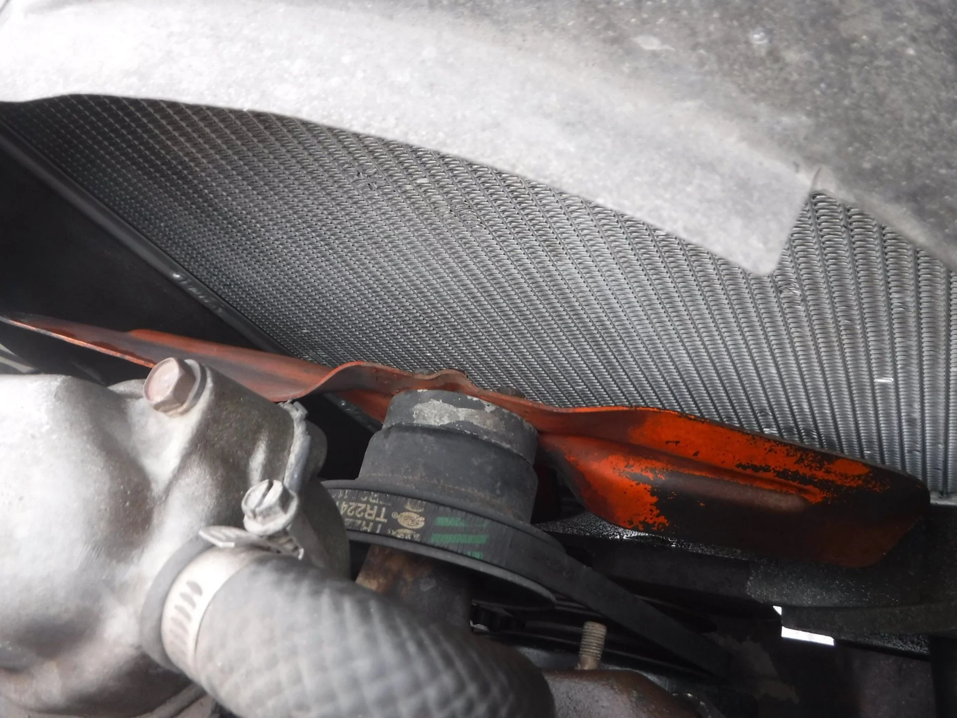

just a heads up, unless a true restoration, you should look into changing the metal 4 blade fan.
several threads of broken blades going into the rad or hood.
the fan will break
here's a thread of mine from a few years ago:
Your alternator bracket is backwards it looks like . The little jog at the end is the part that is supposed to be bolted to the water pump.
Bingo!
