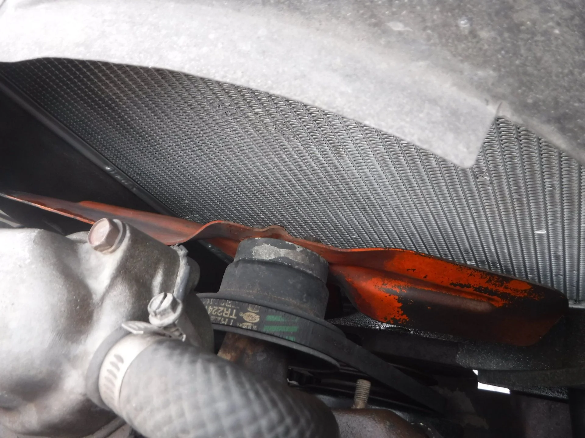

a customer calls me from the interstate, asks if he can have his rig towed to my place. He was doing about 55mph, heard a loud bang and vibration. Opened the hood, fearing the worst, and found this. He is extremely lucky as it didn't take out the radiator as others have experienced.
Mark A has said in the past, it's not if but when this will happen.
@65swb45
All with metal fans should replace them. You can see in the middle pic, it has been broke for awhile as it is half rusty, then a clean break in the other half. A replacement fan and another shroud and he'll be good to go.
@65swb45
Especially since it’s been broken for a while.
He got extremely lucky with that one, remove that fan and send him home, we don’t need a cooling fan right now!
