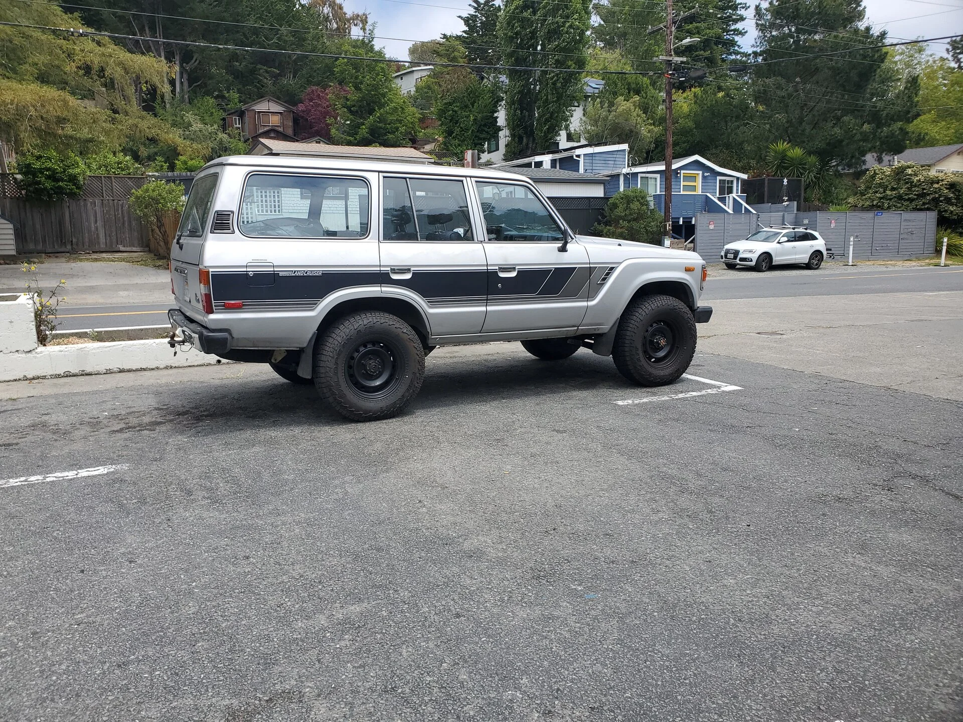

Once the swap is done, planning on tossing these fenders on to take up the additional width of the 80 series axles to keep it looking pretty factory.

Can you throw on something like an 80 Dobinsons lift at the same time?
My goal is to keep this as low as i possibly can to still be able to park in my garage. Im using OME 2861 and 2862 "stock height" springs from OME. For the shocks im using Dobinsons MRA!

I know that on my 60 with 80 axles and stock height springs I got like a 2" Lift equivalent. Enough for me and the stance I was after.
Your going to love driving it everyday with that setup.
Jason was really awesome when i ordered i basically sent him pics of my truck how it is now and was like I want it to look like this and these are the springs he suggested. Im super pumped on this project!
