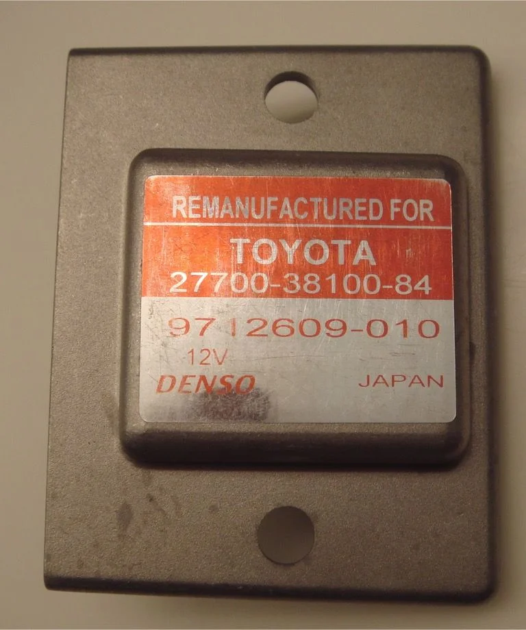

Toyota makes a remanufactured VR for the stock alternator.
No guarantee that this is the problem, but here's the part number.

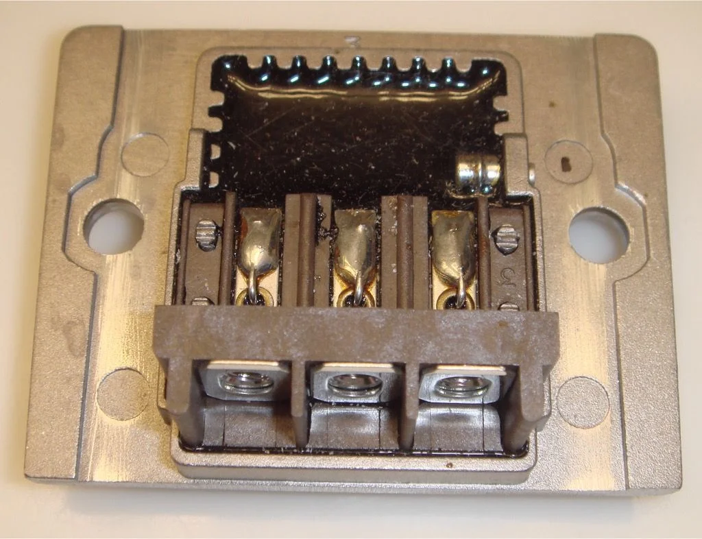

Two screws clamp the outer shell down, while three screws make the electrical connection inside.
