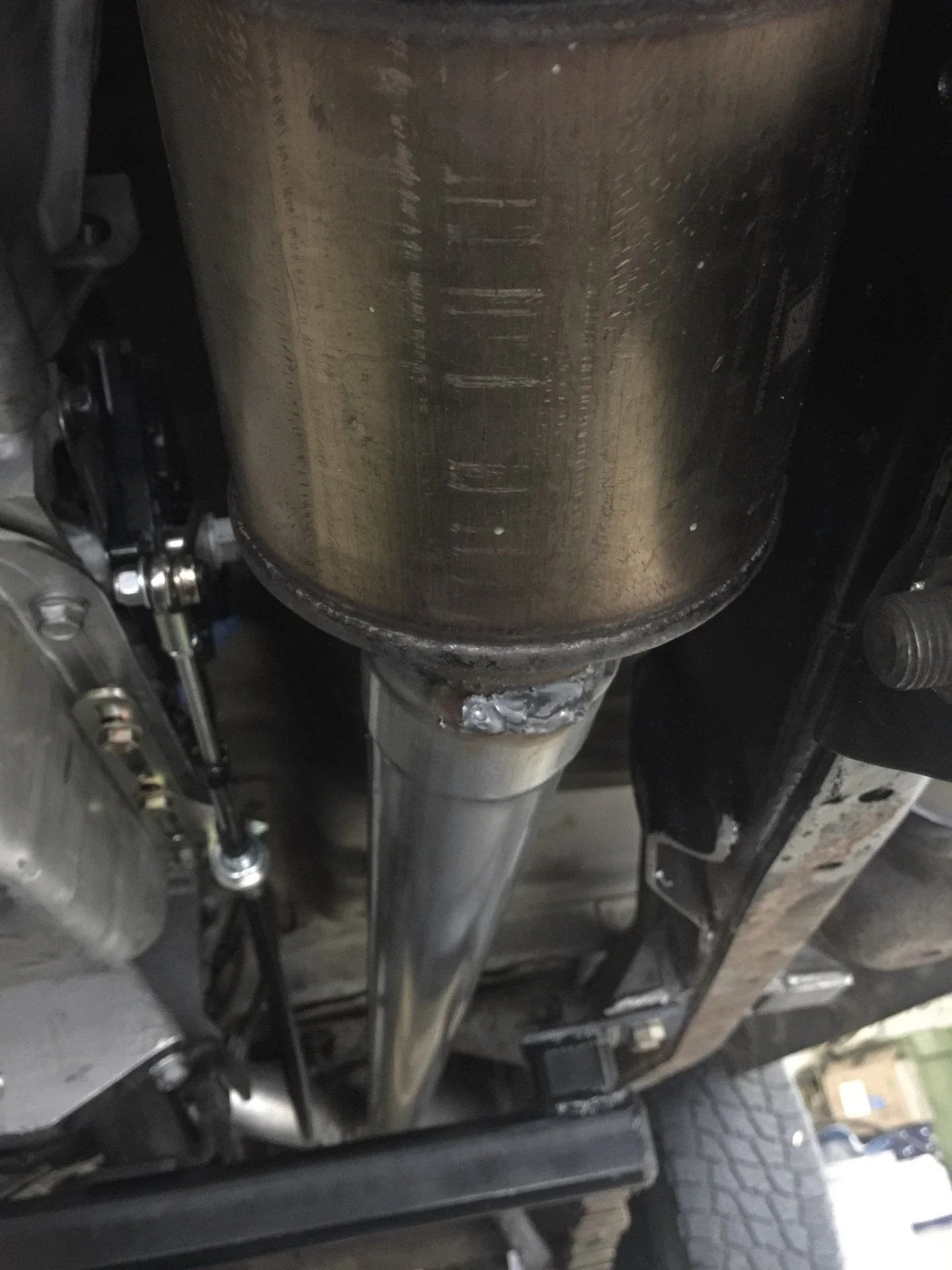

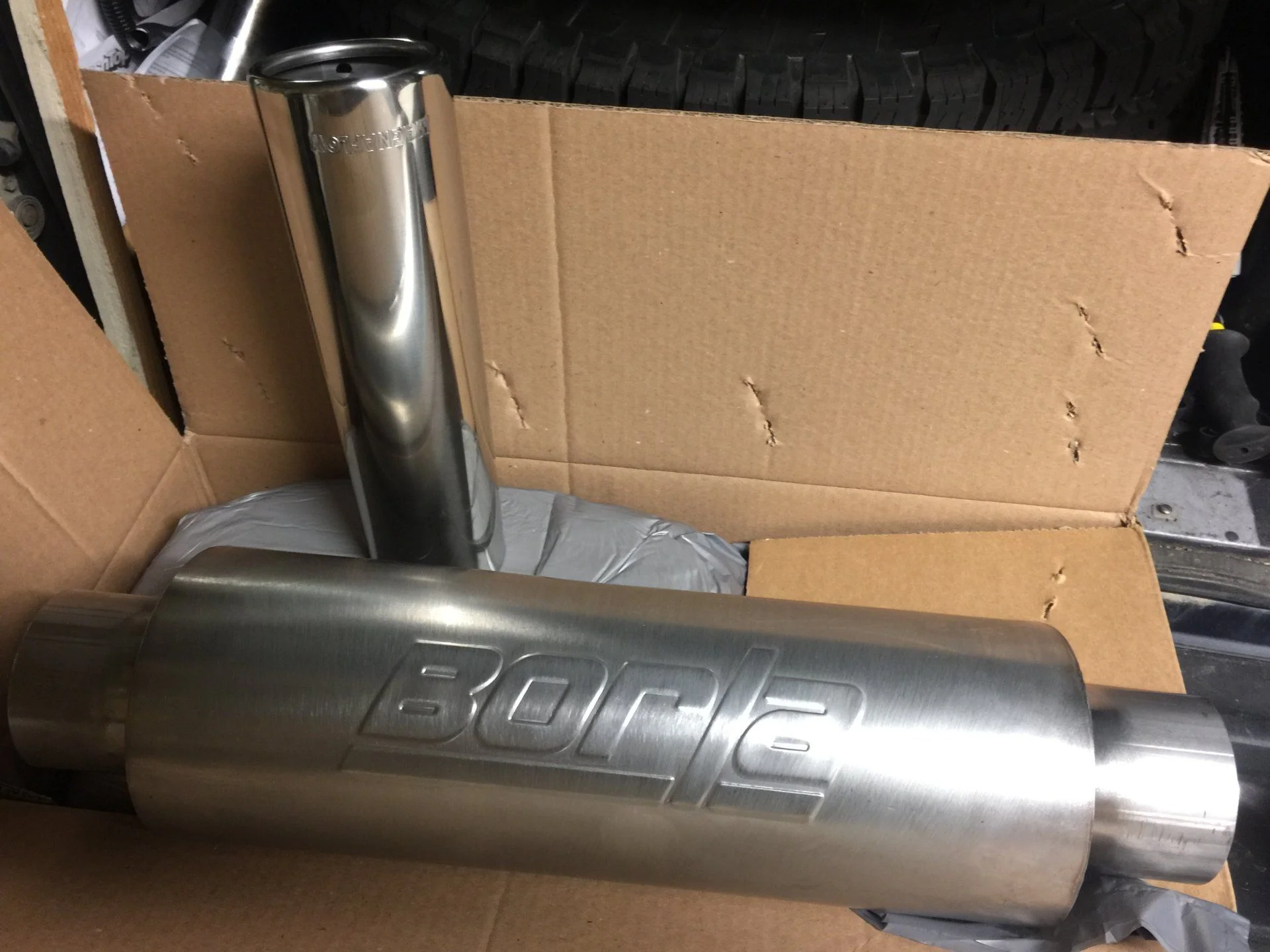

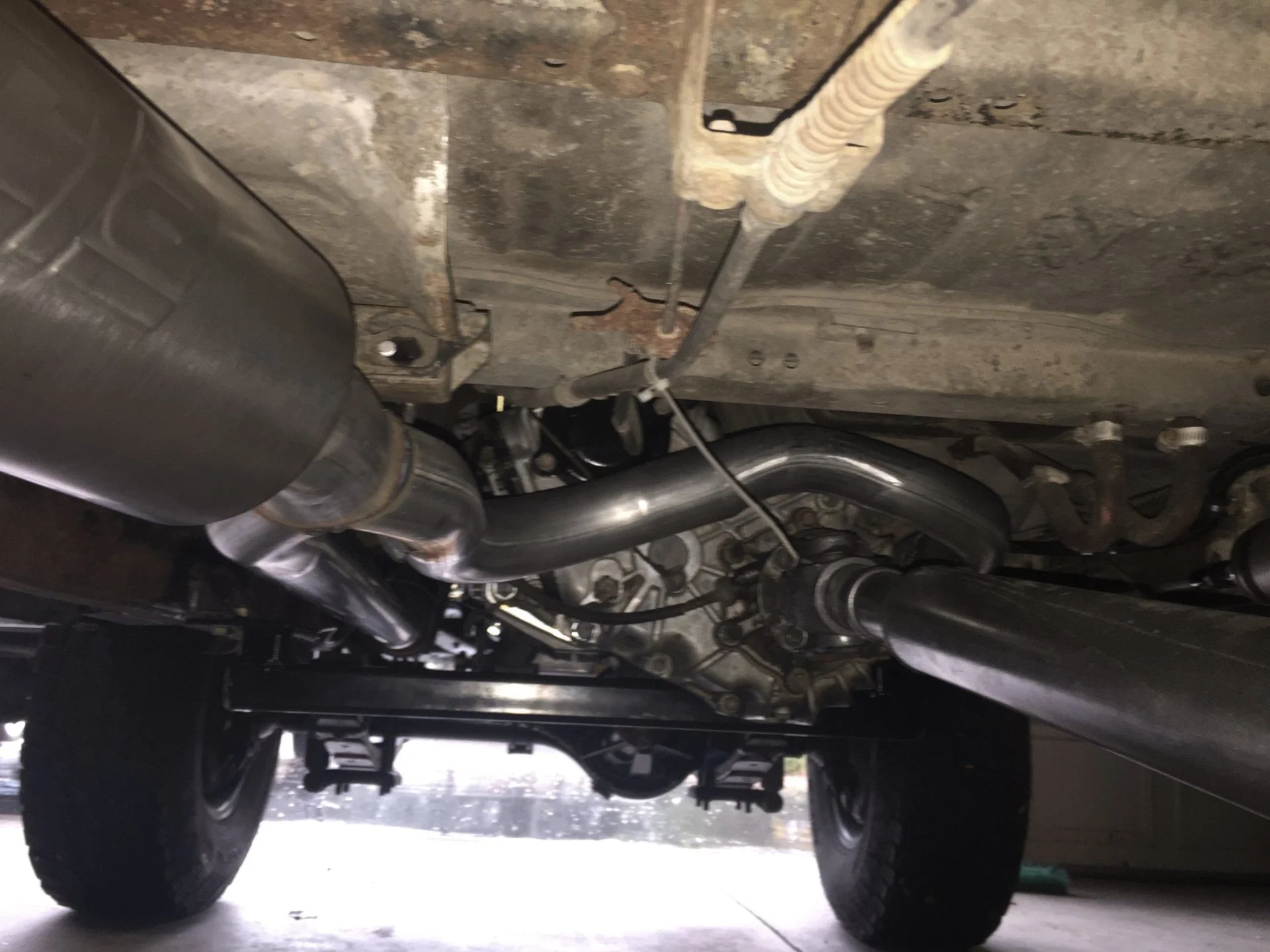

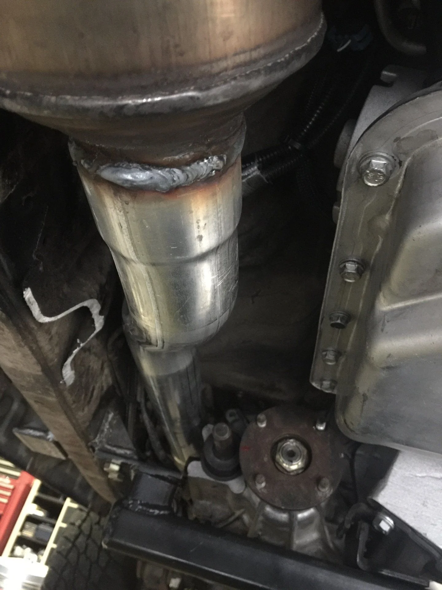

Trying to find everything I want out of a exhaust without blowing serious coin is like trying to find a unicorn at the end of a rainbow with a pot of gold. But Made a decision. It wasnt easy. Its kinda like 31 flavors. Ya wanna sample every flavor.
Running the stock 2 1/2” pipes out of the cats to a 3” y-pipe, into a borla XR-1 muffler and 3” single pipe out to the stock FJ location or nearish. Magnaflow 3” tip.
We’ll see if the gamble pays off. Should sound pretty mean. Hopefully it doesnt drone too much. But ask 2 people with any agressive muffler and one will say no drone, other will say drone. So just gonna roll the dice and take my chances.
Get a sound byte up once its all done.

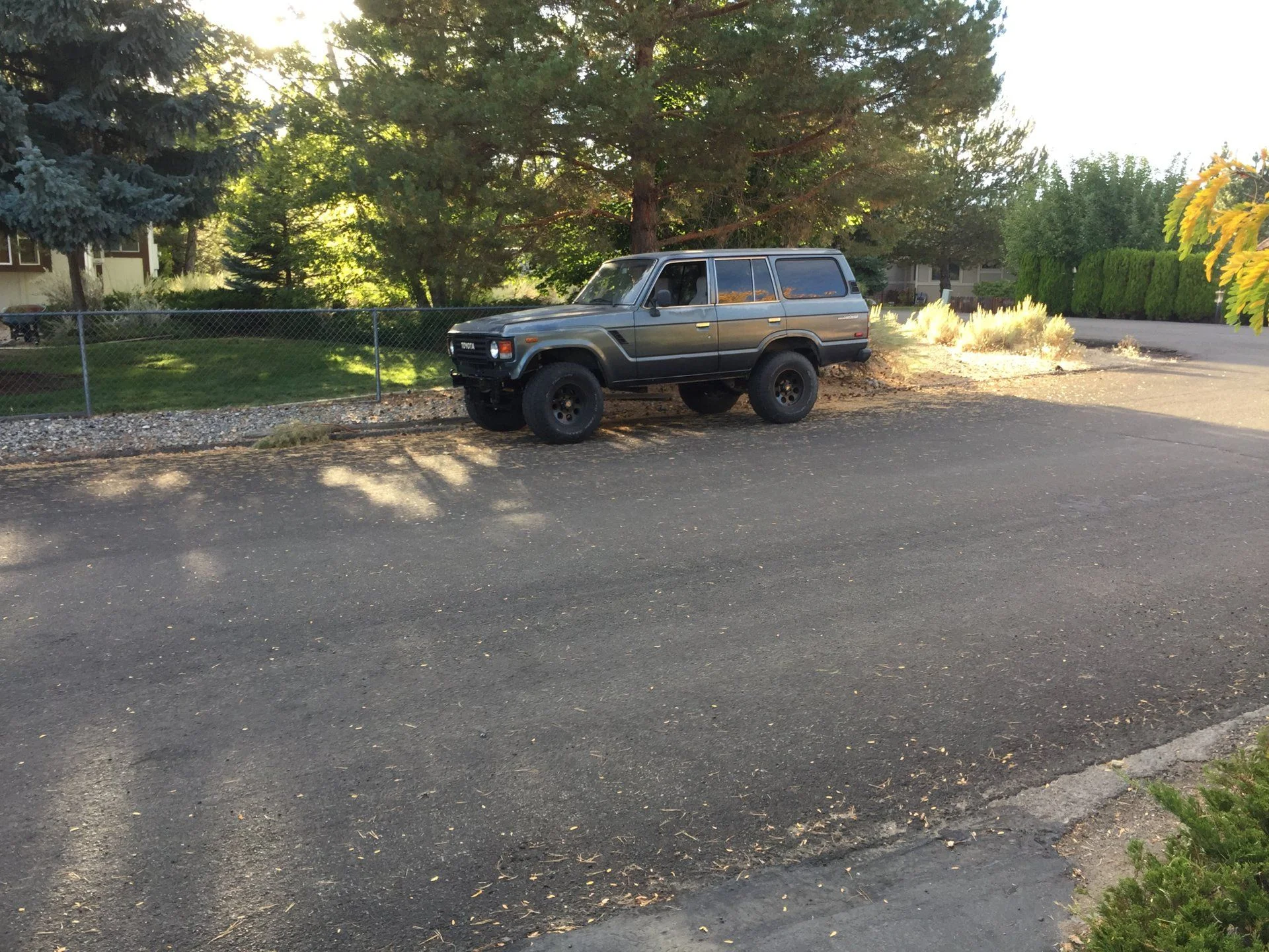

Sometimes a set of legs is better than an FJ. Yeah I said it. Heh. *Not always*
Breakfast with Yogi.
Build should be done next week! :clap:
Congrats! Hows it drive, sound, etc?

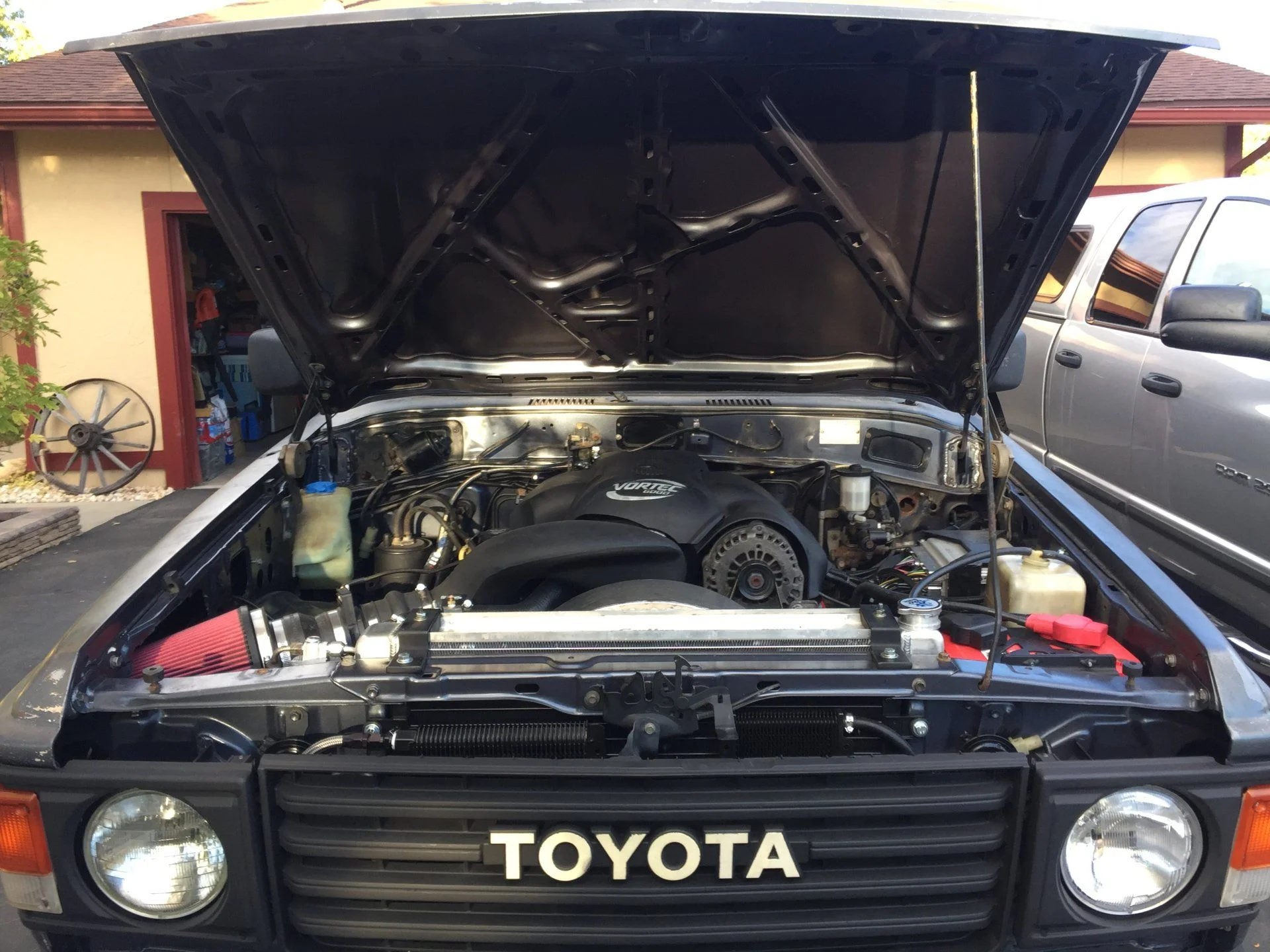

Thanks. Runs awesome. Plenty of power. Feels a lot more solid than the chasis it sits on. Haha. Definetly sounds healthy. Not to loud at idle, but barks when ya get on it.
I did pop a damn code though. P0171. Which equates to runnig lean on fuel bank 1. So either too much air (sucking air from somewhere) or not enough fuel (clogged fuel filter, faulty regulator). Anyways i’ll have to track down whatever is causing it.
But what a difference from the old 2F. Night and day. :grinpimp:
Burnouts!burnouts!burnouts! Lol
Burnouts are in order. Puttin a order in for a new axel afterwards - not so much. Haha. Hard to fight the temptation. Believe me. :hmm:
