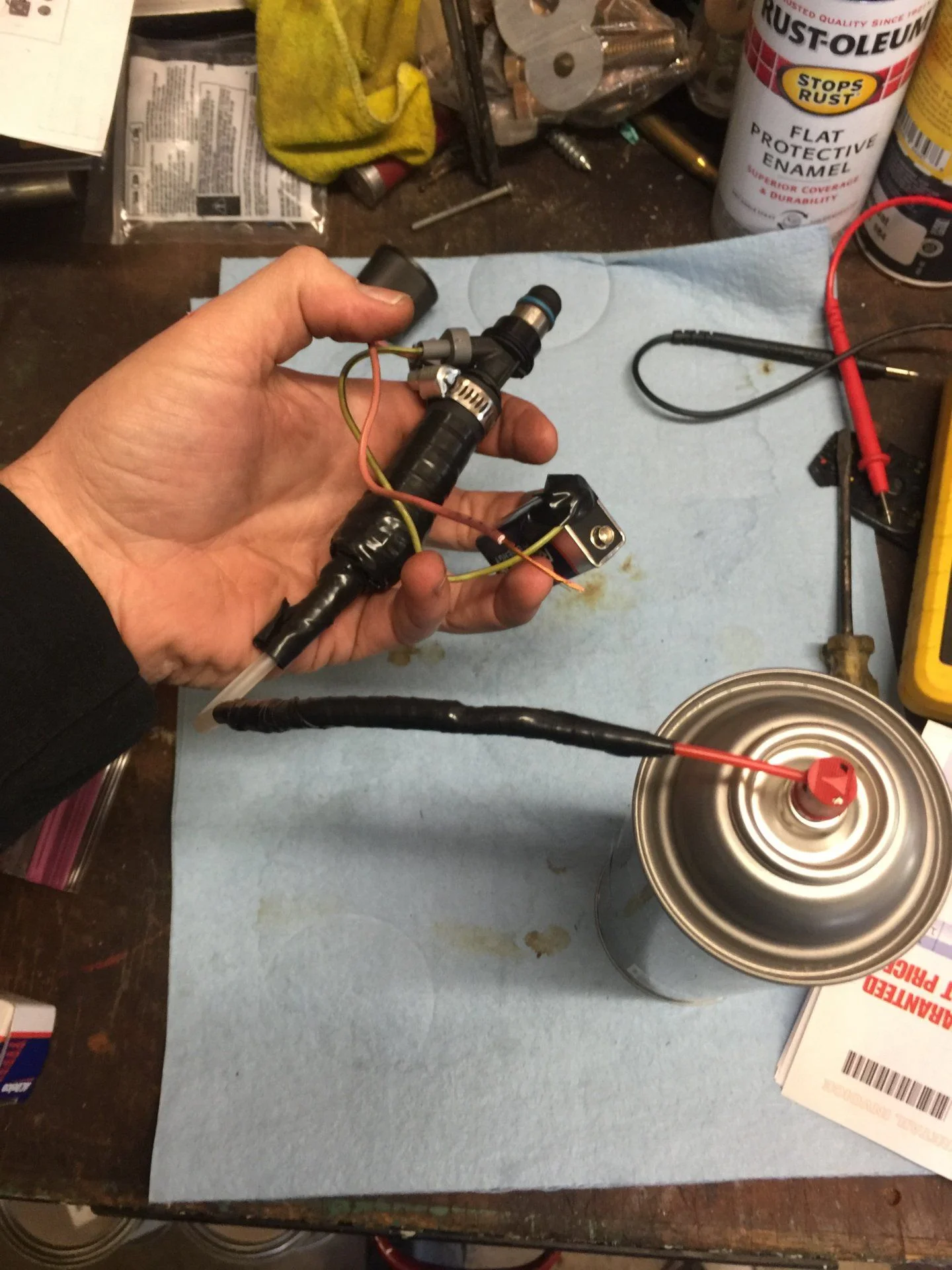

Cycled the injectors with brake cleaner to check for clogs. 3 of em sprayed correctly. One wouldnt produce a drip. That means one cylinder is getting zero fuel and should be the reason why I’m getting a lean code as motor isnt getting fuel to that cylinder. Off to grab an injector. Hope this resolves it. If not, i’m glad I caught the issue regardless.
Make shift fuel injector de-clogger.

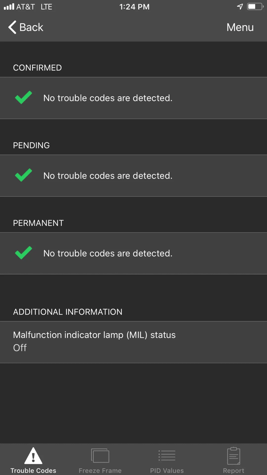

Problem Solved

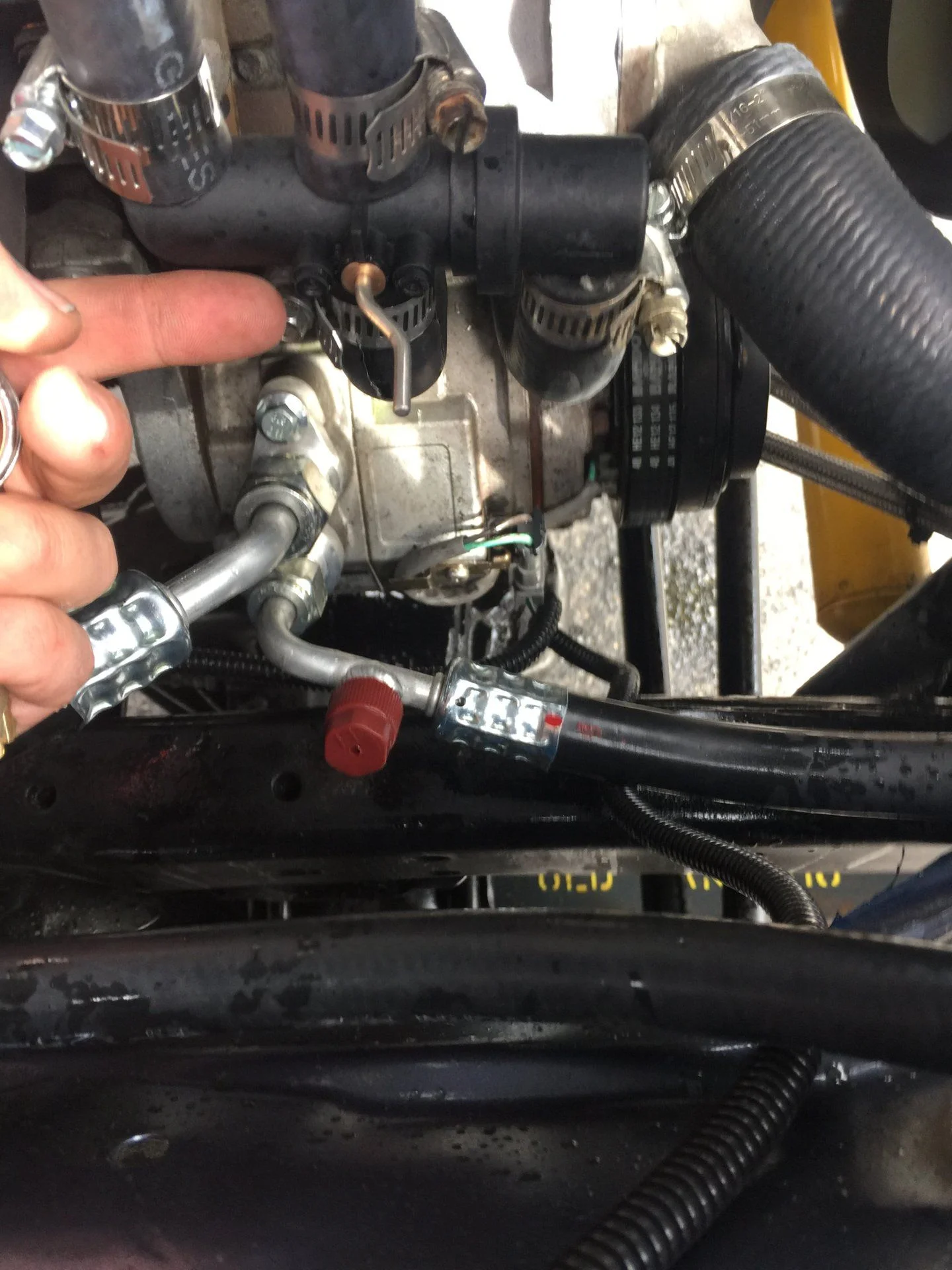

Decided to celebrate and go get gas. And next problem happens. This motor is cursed.
Leaking out of this cheap valve I put on. Garbage. Now waiting for a trailer.
Yep, that’s why I builtinenout of stainless steel.
You towed it home? Lol, you can’t just top off the water?
Not when it spews half the coolant out in 2 minutes. That puddle is after i moved it.
