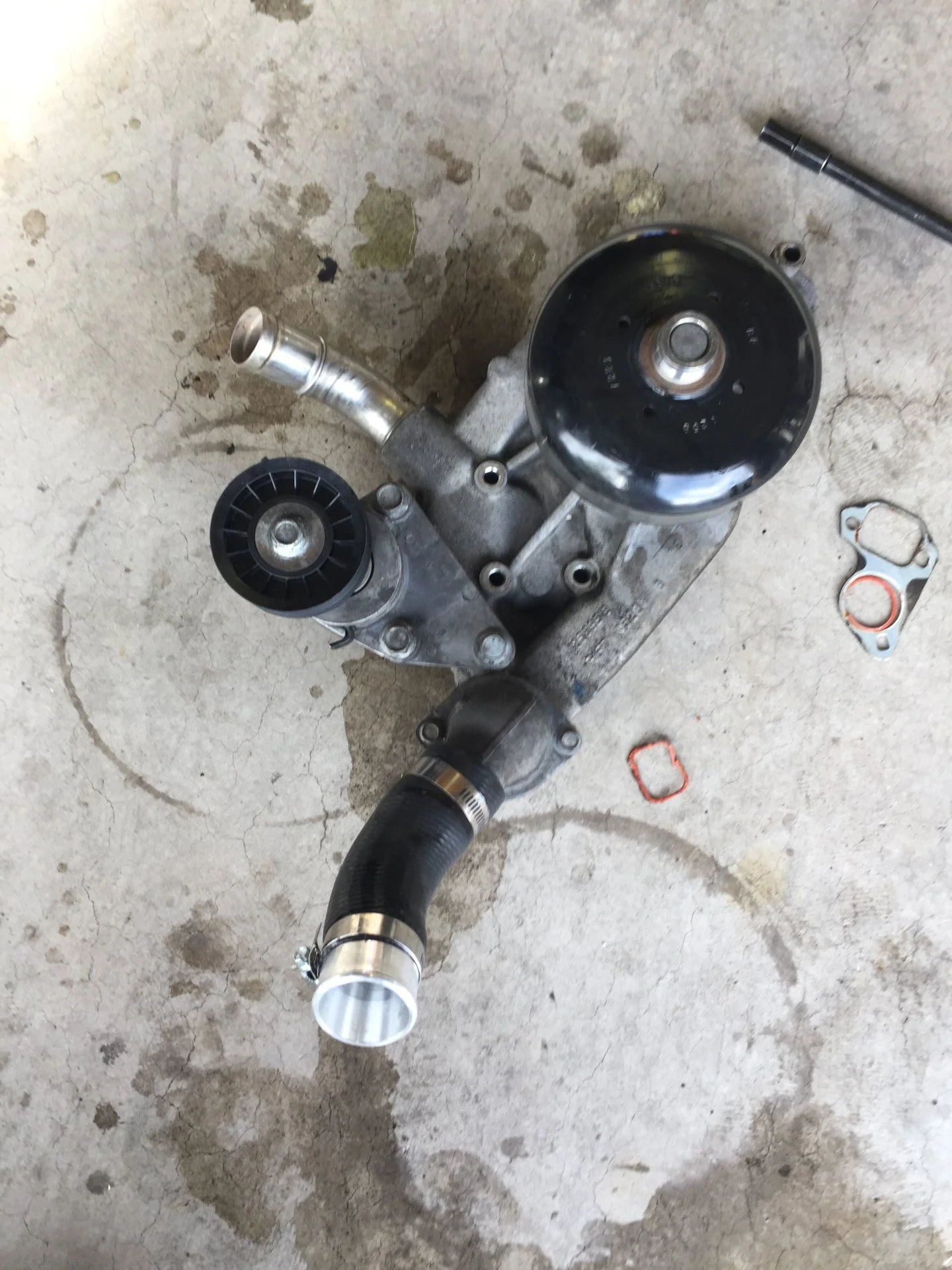

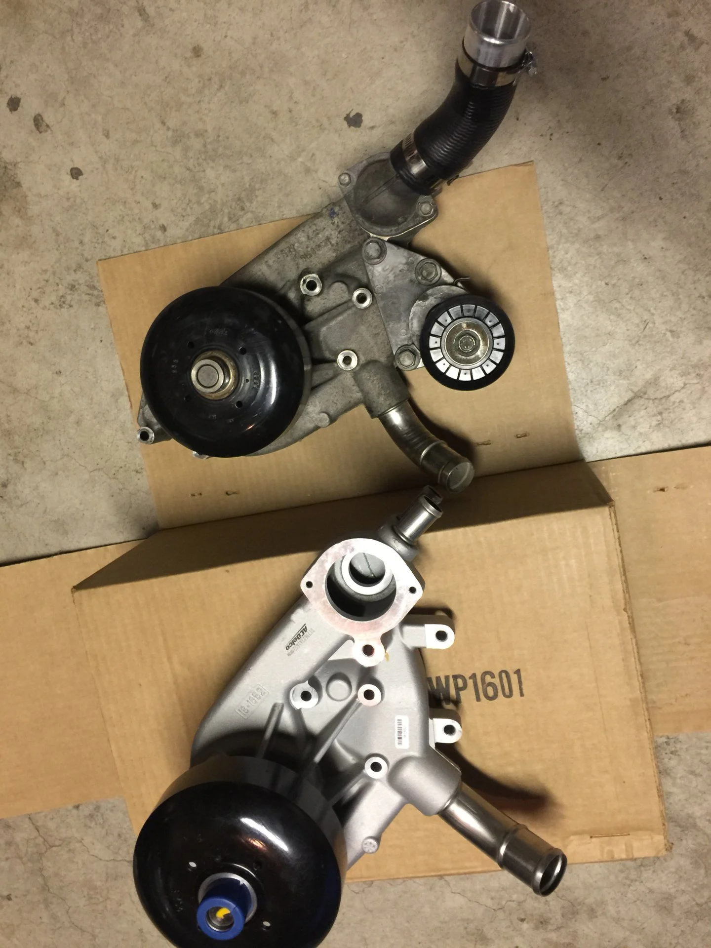

Filled up the motor. Then discovered a leaky water pump. So that was lame.
Installed new water pump

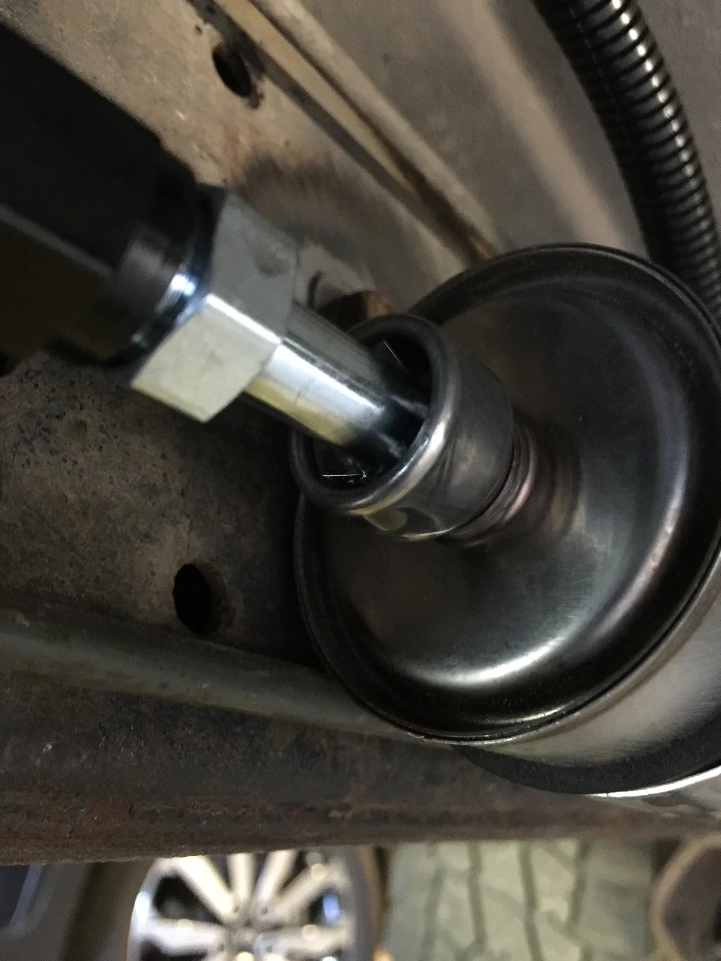

Switched on ignition to prime fuel lines and look for leaks. Of course there was. The fuel filter / regulator was faulty.
So had to buy a new one of those.

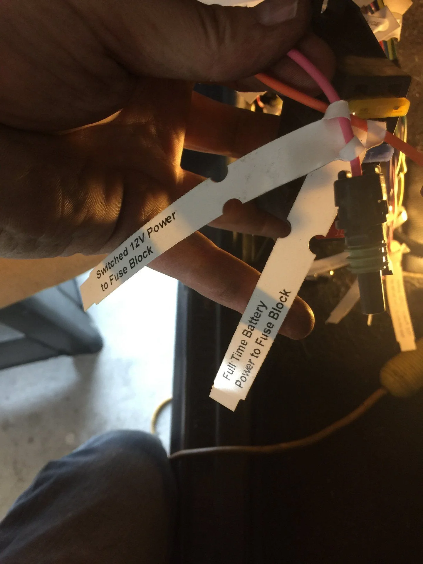

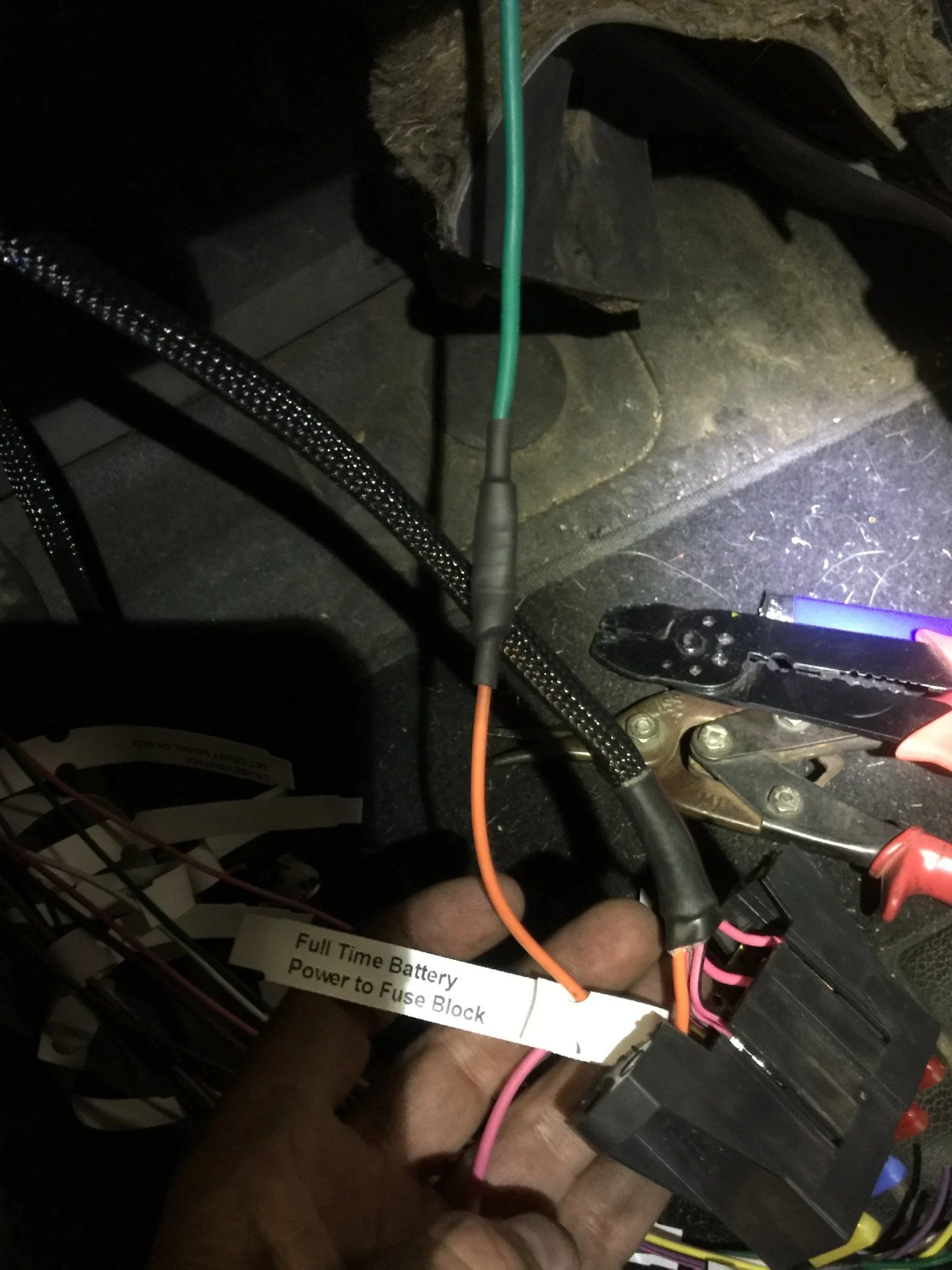

Next up is full time power to fuse block. Ran the wire to the Vortec Alternator Lug. Pretty sure this could be ran to a power block if your motor has one or directly to battery.

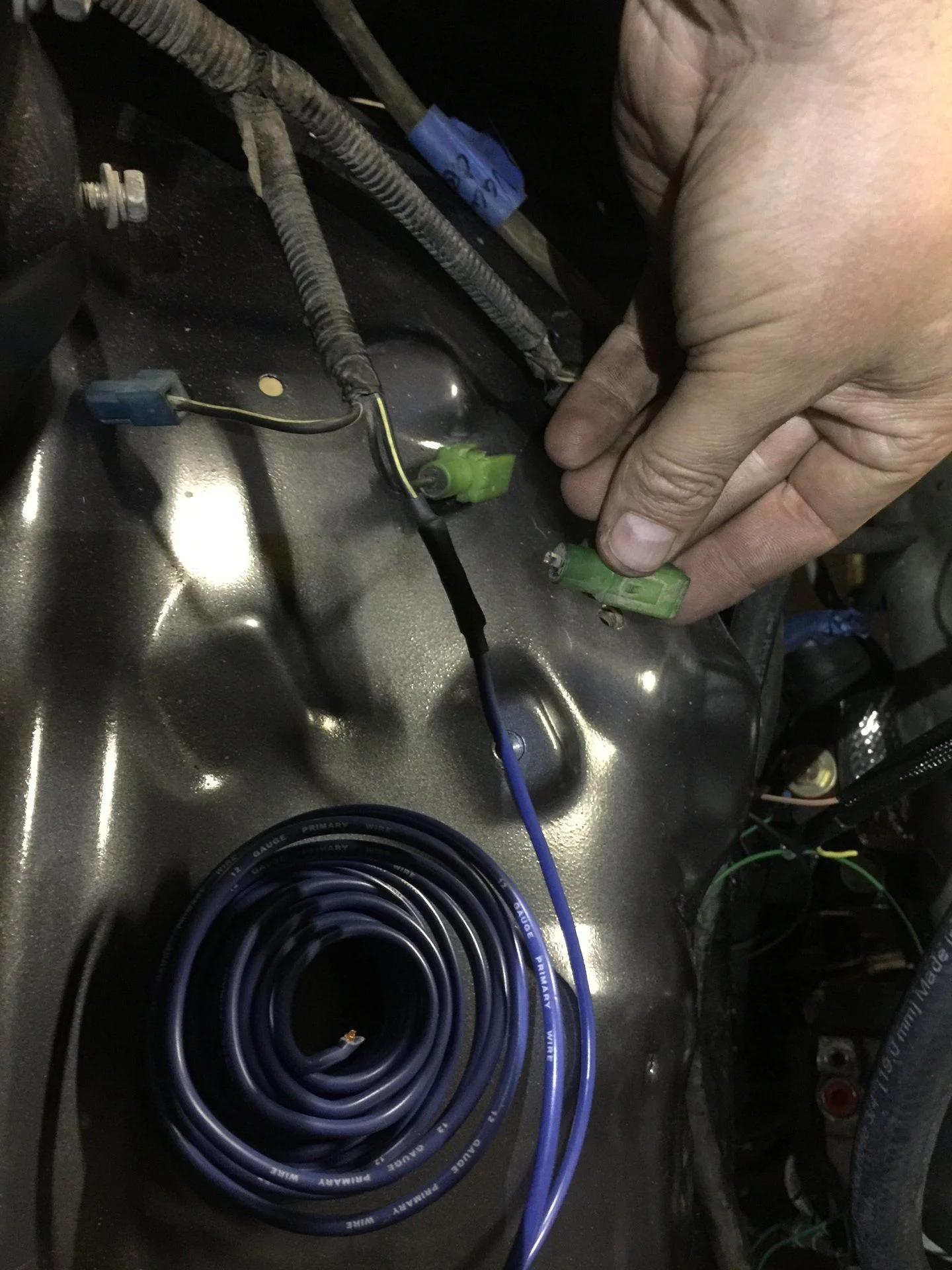

Next I cut off old harness Coil + clip & soldered blue wire on to run through my firewall to be utilized as my switched 12V power at fuse block.
Tied blue wire into pink inside cab.

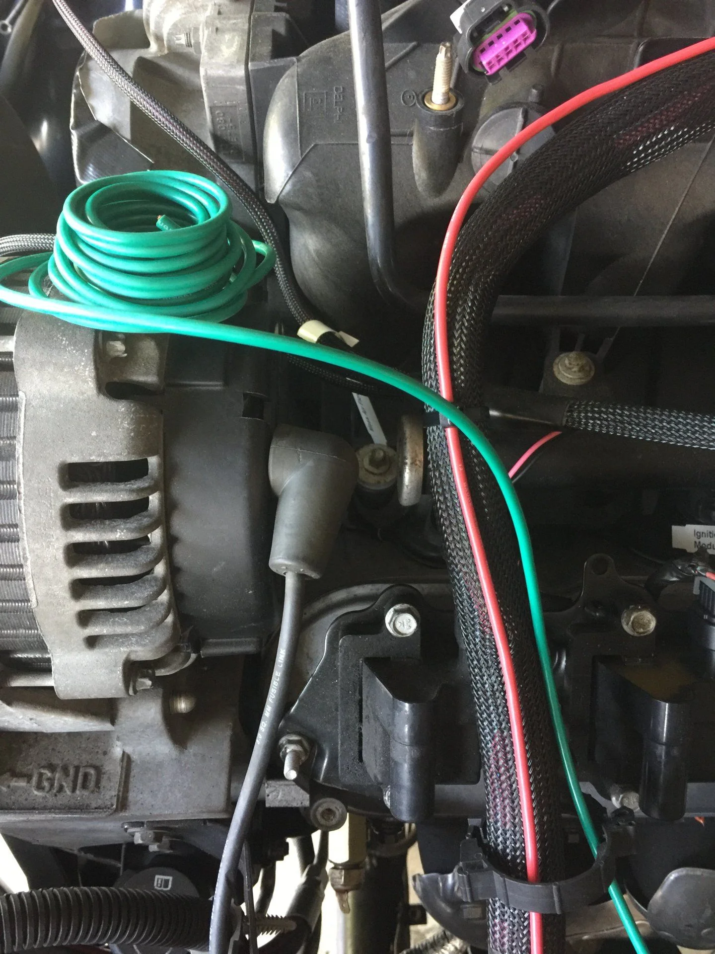

- AC Compressor -
The Vortec has a two wire plug that goes to the AC Condensor. Green & Black wires. Green ties into the old FJ AC Compressor harness wire. Black gets grounded.
