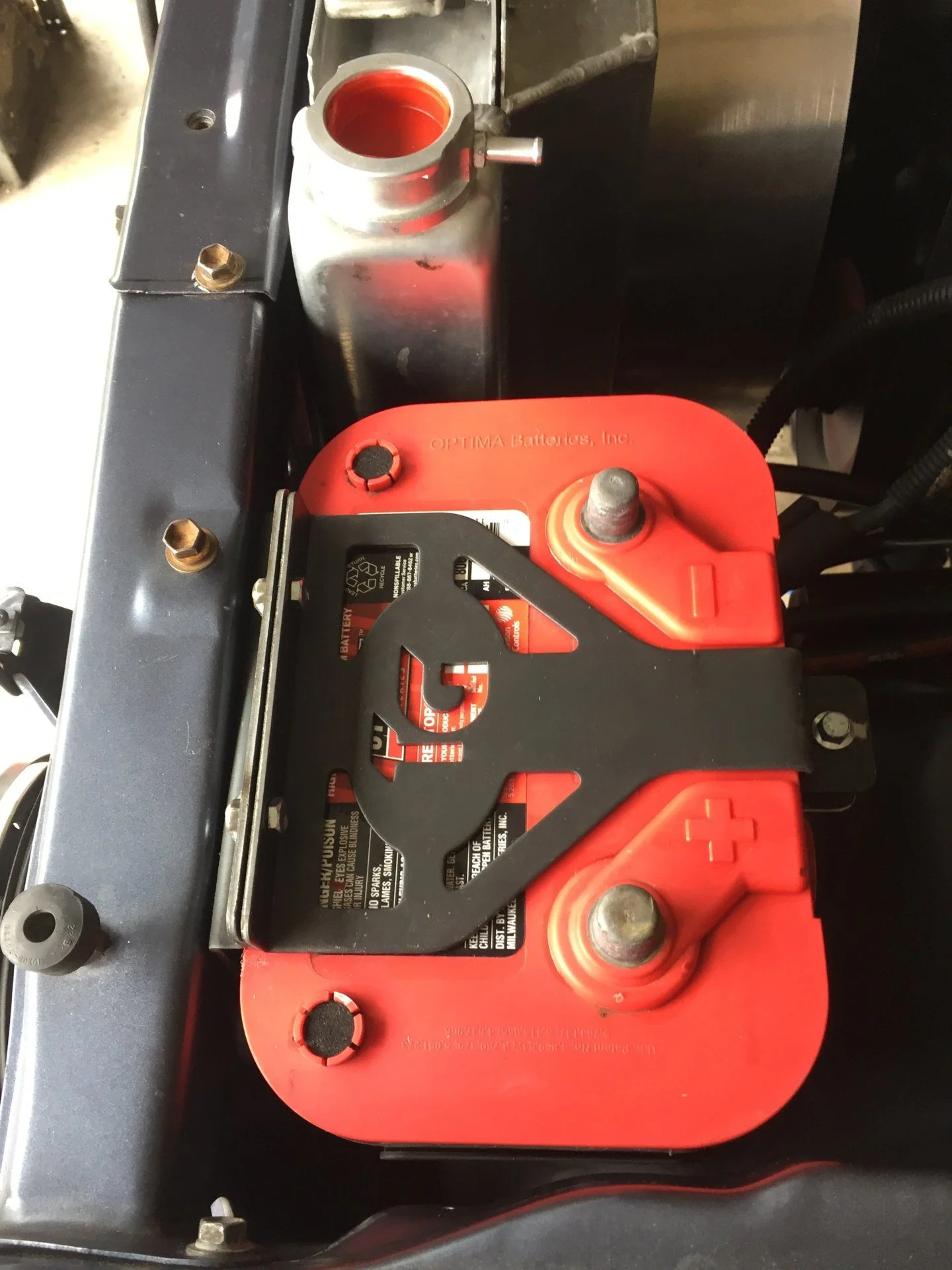

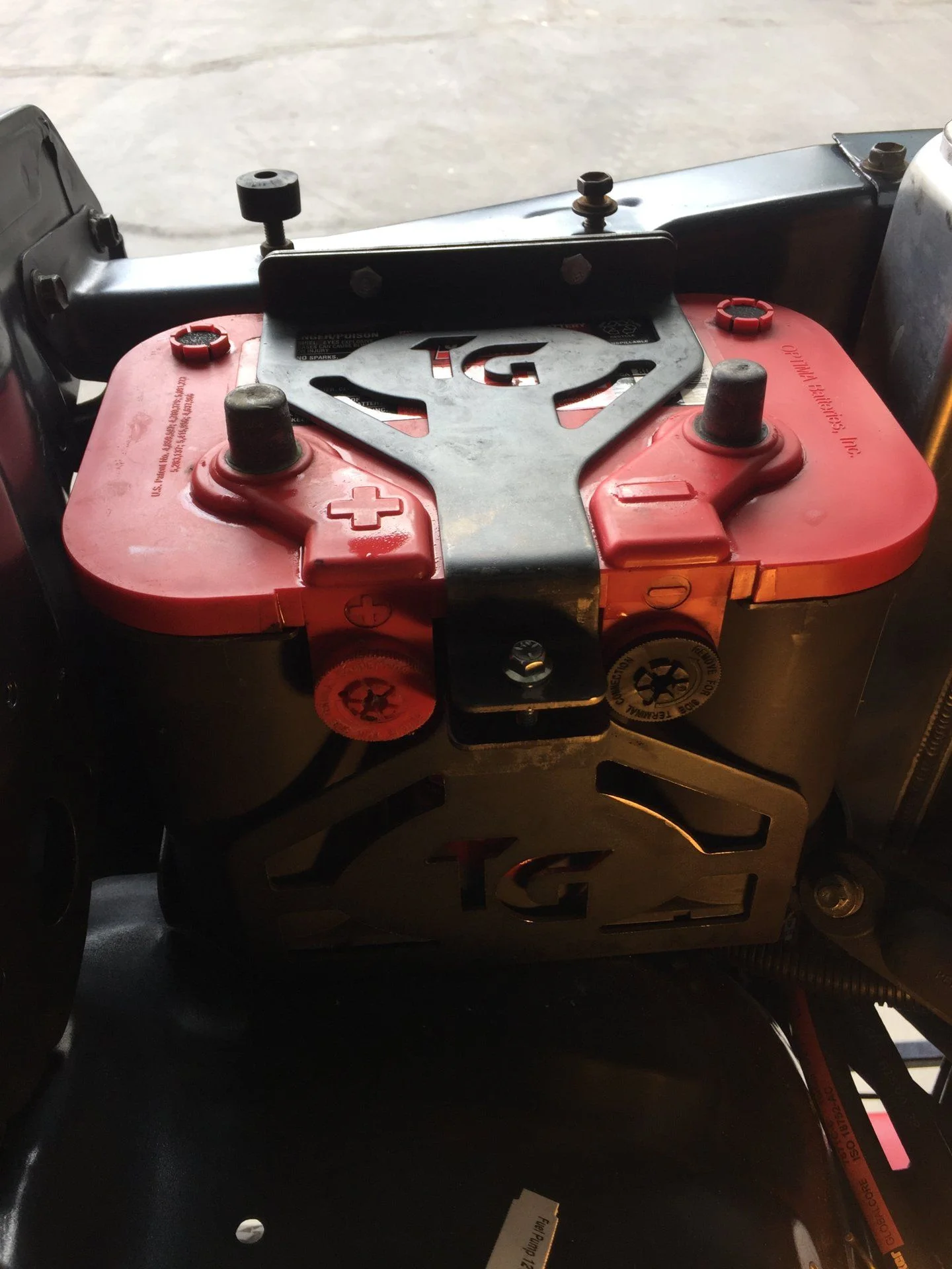

Mounted battery. Had some issues trying to find a battery tray that would fit. My radiator is pretty damn wide so I needed something that would be narrow and be able to bolt to front end of fender well and the front of the truck somehow. Tried a few different ones and was just about ready to Fab one up when I came across this guy.
The Battery tray may not be that big of an Issue if you dont have a huge radiator and limited room. For me it was. So I’m excited about it.

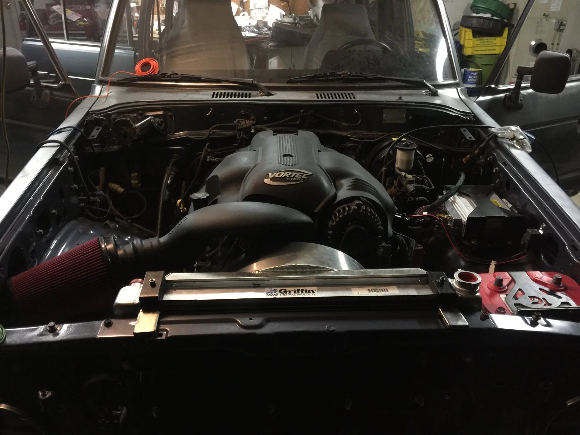

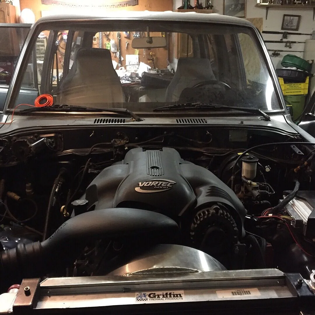

Routed radiator hoses.

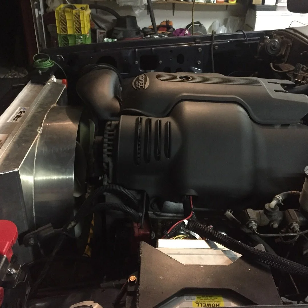

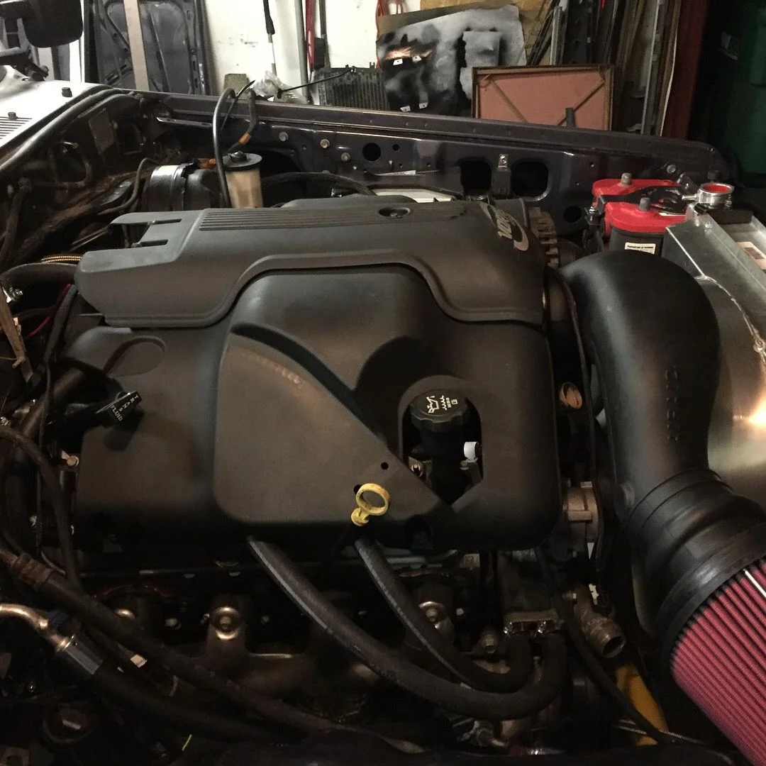

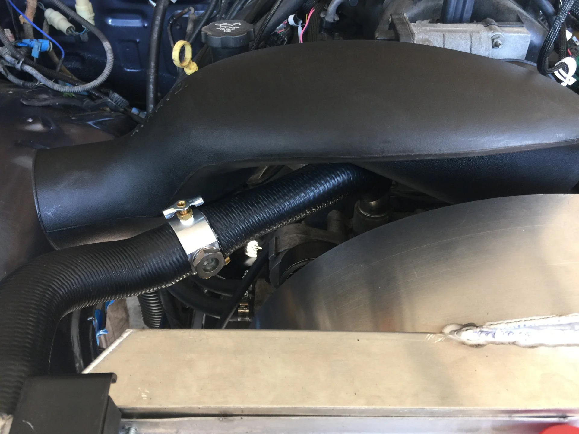

After the 3rd air intake system I think I found an Airaid that will work. It’ll need a few mods but doable.

Airaid system looks pretty good. Which one did you go with?
I went with AID-201-145
Few things - First you’ll have to build a cold air box. I dont think any of these over the counter intakes will have an out of the box solution for that.
Second - you’ll need an extra rubber adapter ro run MAF inline where filter hits tubbing.
Third - the filter is huge. I may trim a small section of the inner fender to run the tip underneath

Yeah the box has to be Fabbed anyway ya cut it. Really just need an adapter. The Airaid sustem assumes you have the boot off the original vehicle for MAF. So need that. Could definetly make your own system I guess. Just figured this may be easier. Time will tell here shortly.

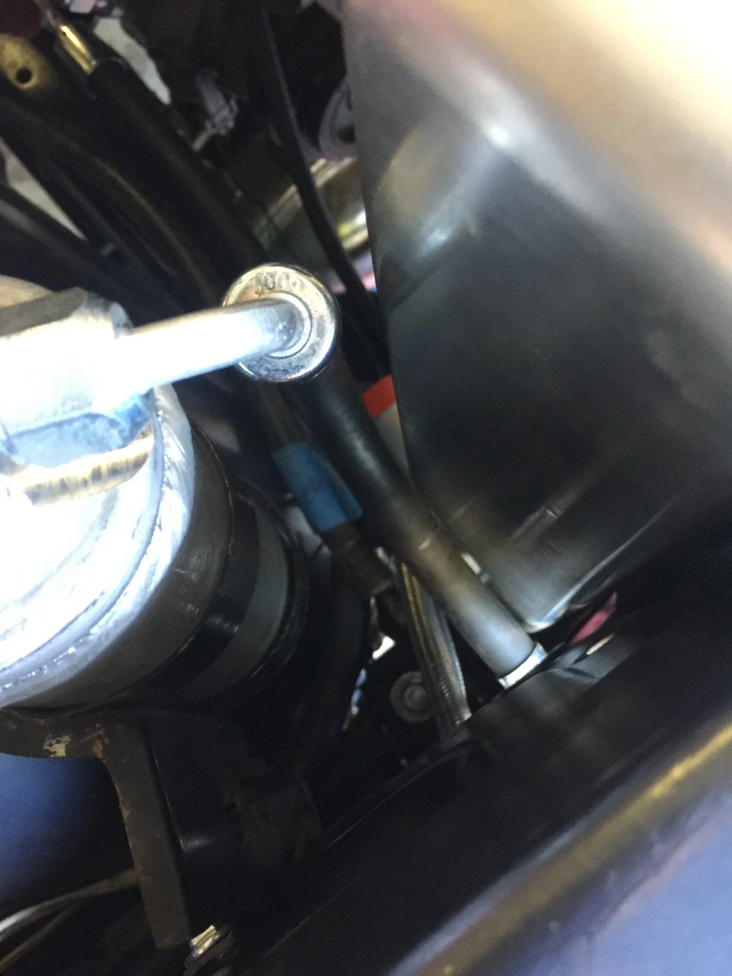

Mounted the new AC drier. Not many spots left for it. Looks like it’ll be ridding inside the cold air intake box. Guess my AC will be really cold. :hmm:
Tight fit with hoses. Damn radiator takes up the entire front stretch.

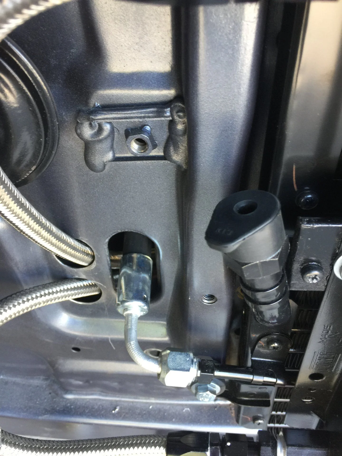

Drilled two holes for trans cooler lines so I have more room for lines from my AC condensor. Need to throw some rubber groms on em.

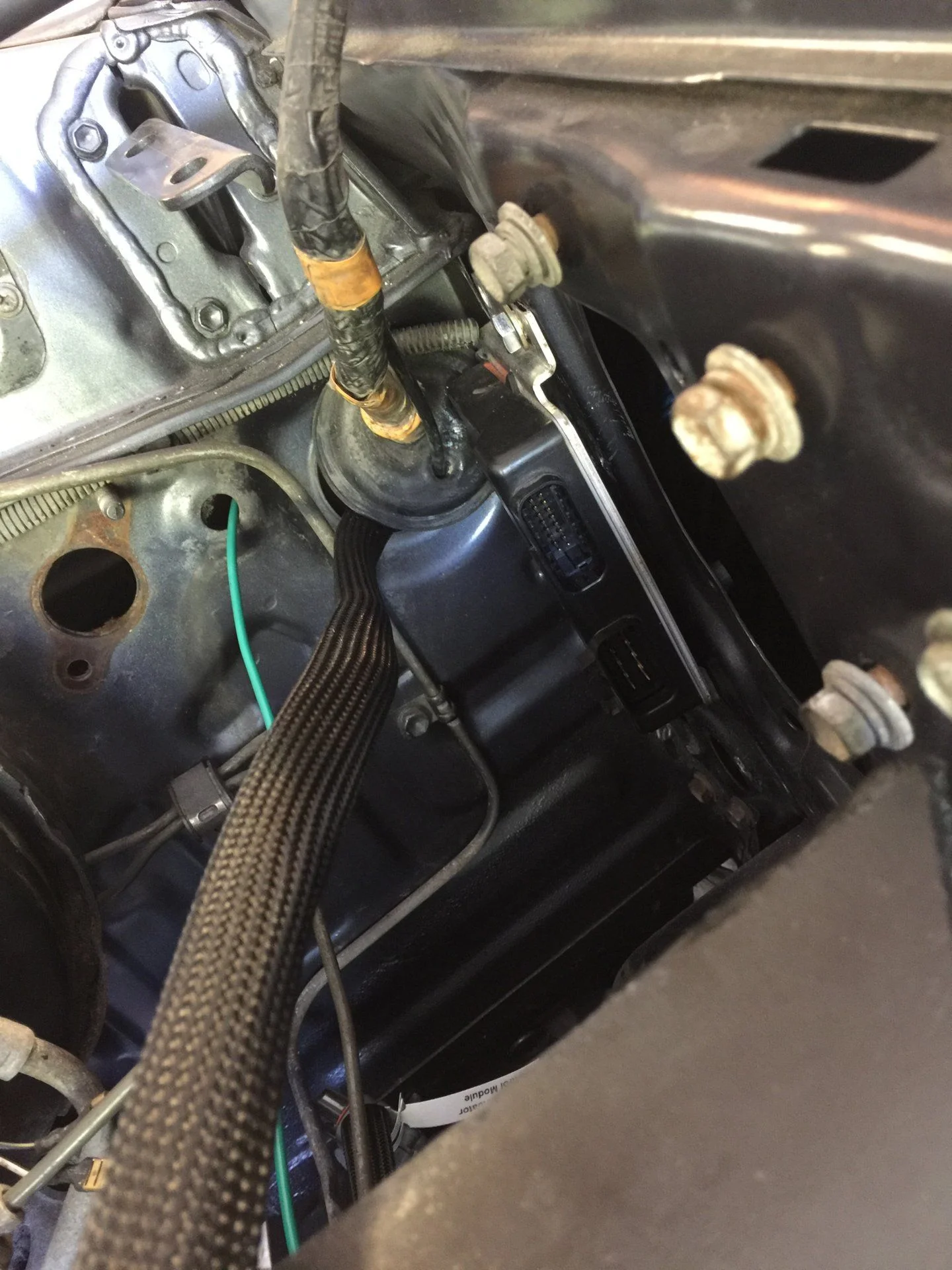

Mounted Gas pedal computer in a tucked away spot. Try and get a drill in there. Lemme know how fun it is. :rofl:
