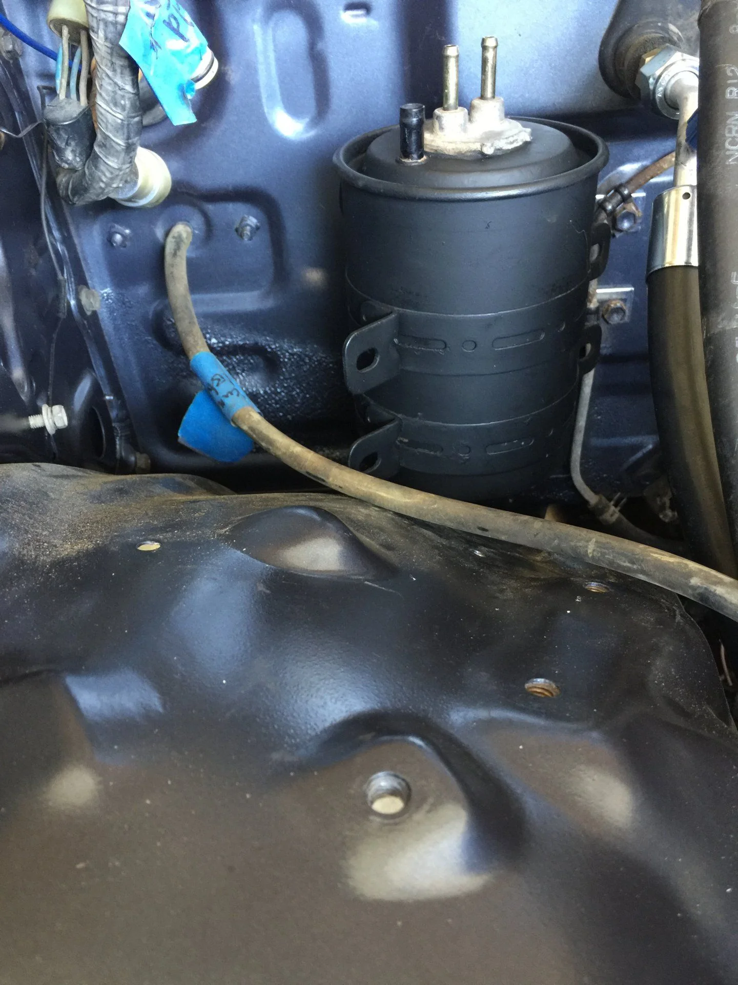

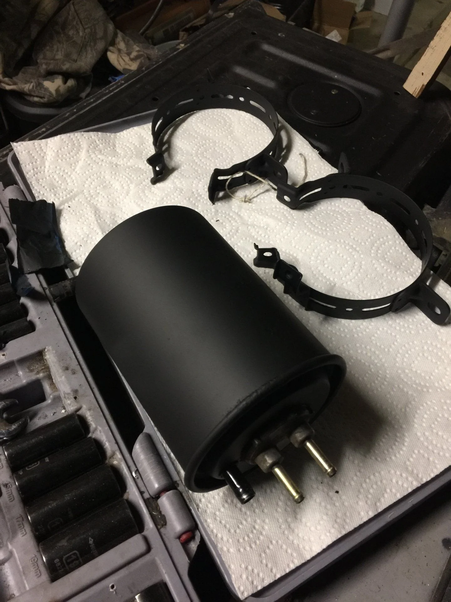

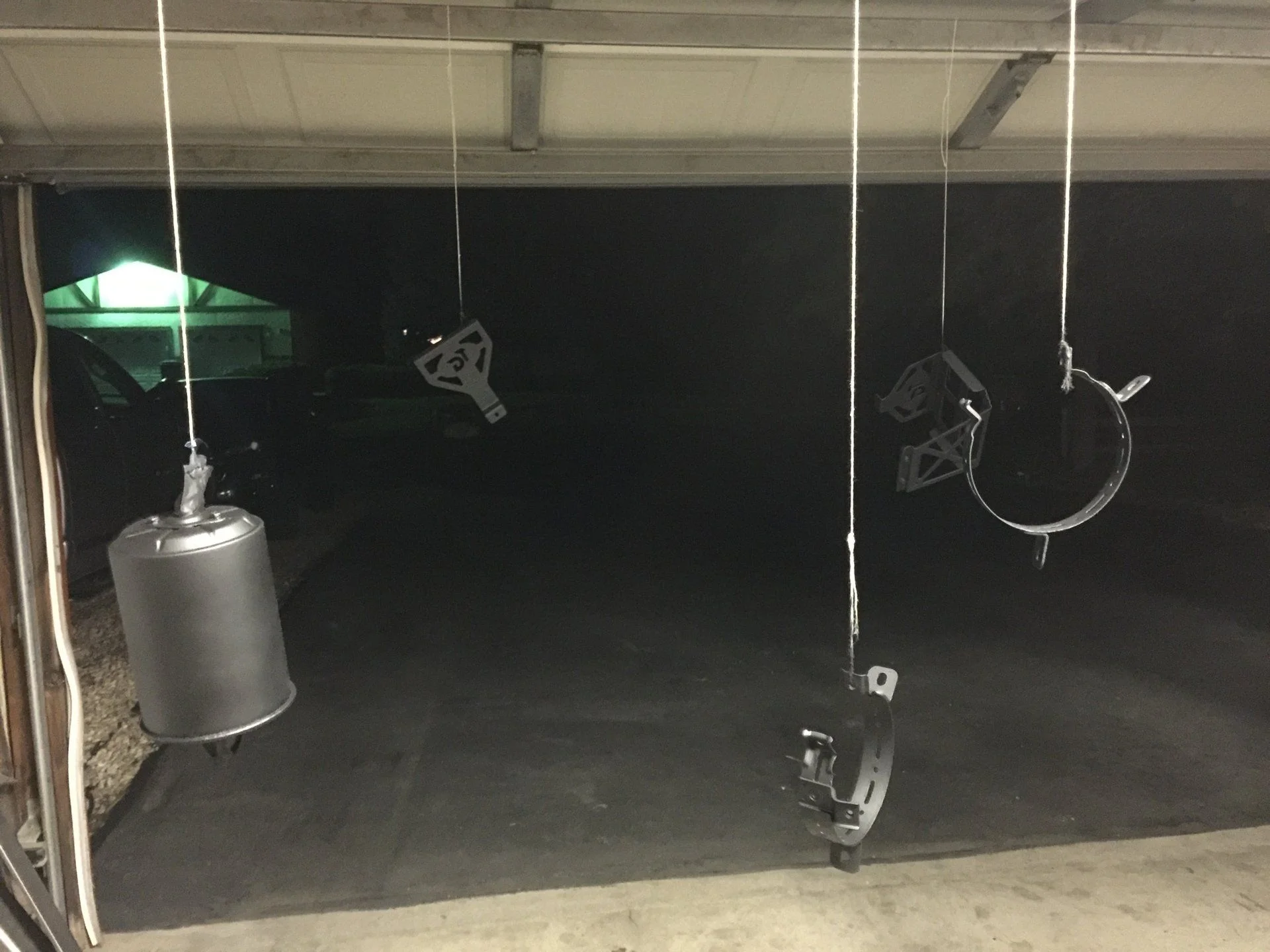

Painted a few items. Battery holder, charcoal canister & AC Drier bracket.
Charcoal Canister
Installed

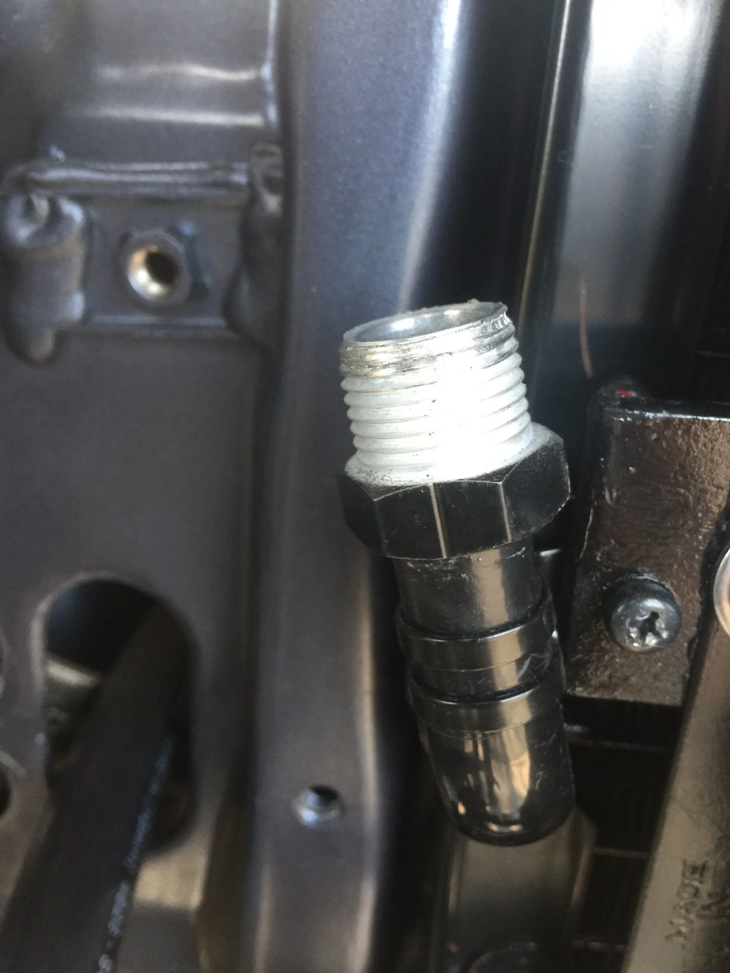

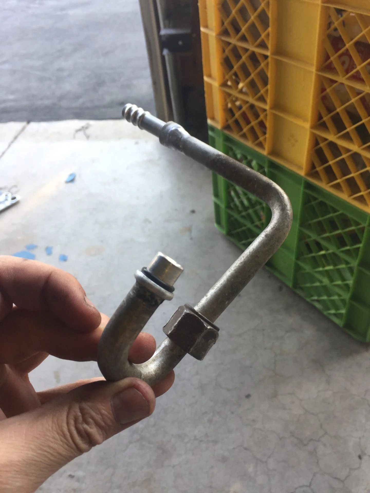

Got the tube that connects to the AC condesor brazed with a new barb fitting to
Run my new hose.
Be even cooler if the damn nut didn’t have screwed up threads and began stripping my new condensor. Back to the drawing board. :bang:

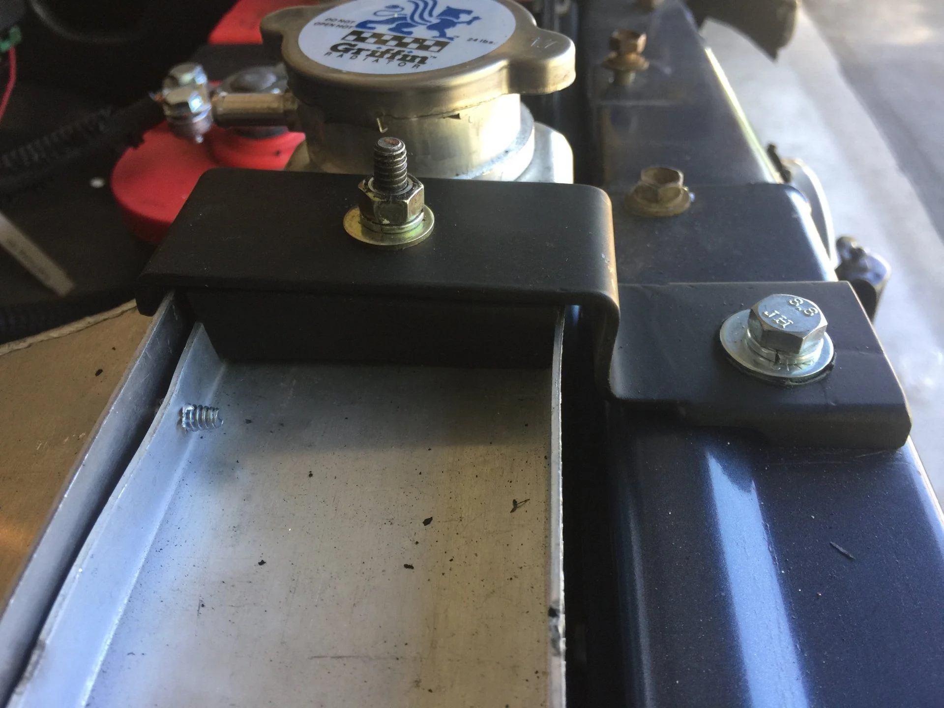

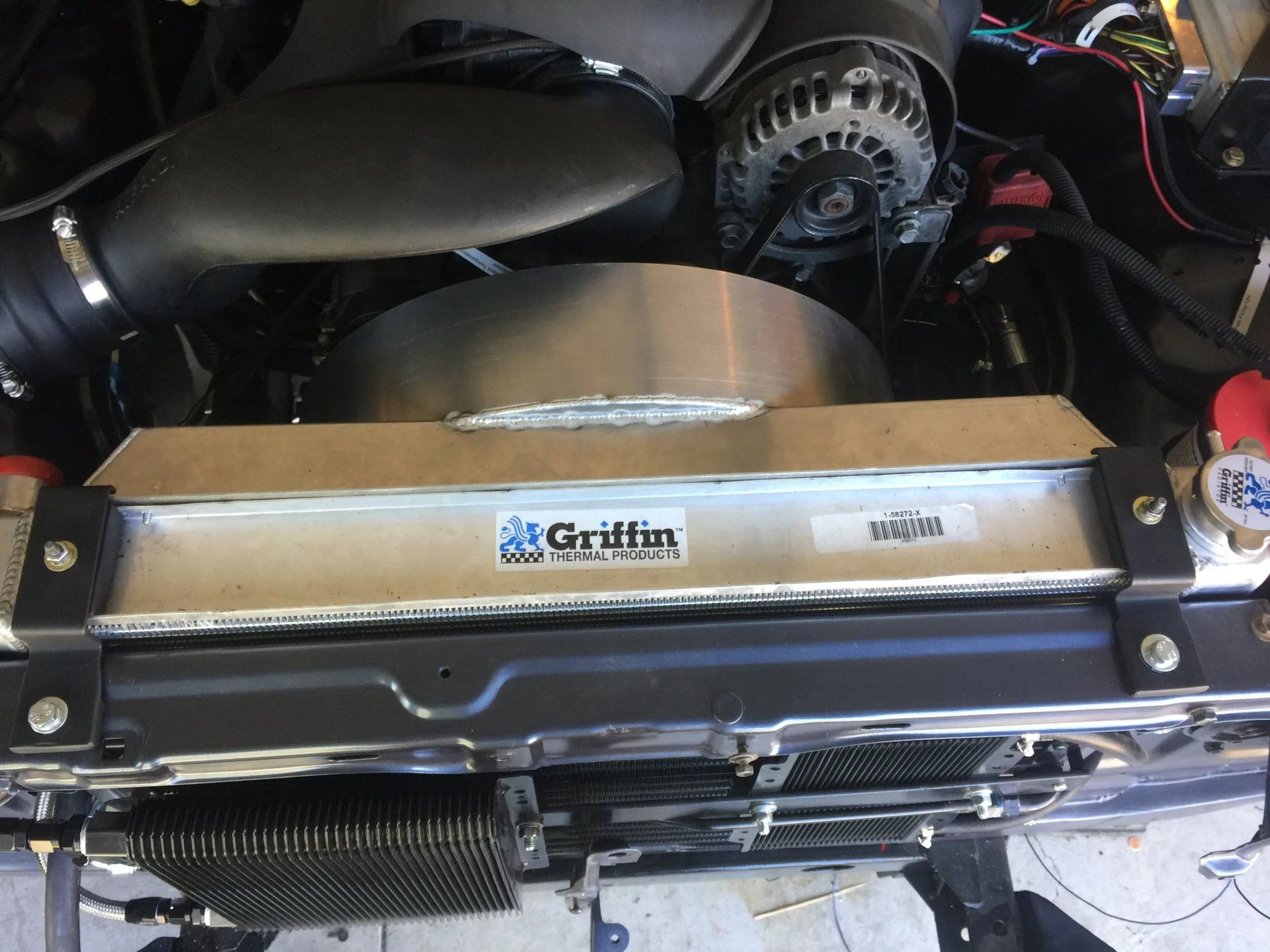

Got my top brackets to my radiator finished and installed. Can finally say the radiators done 3 flap discs later. Thorn in my side. Forgot to take a pic. Get one up tomorrow.

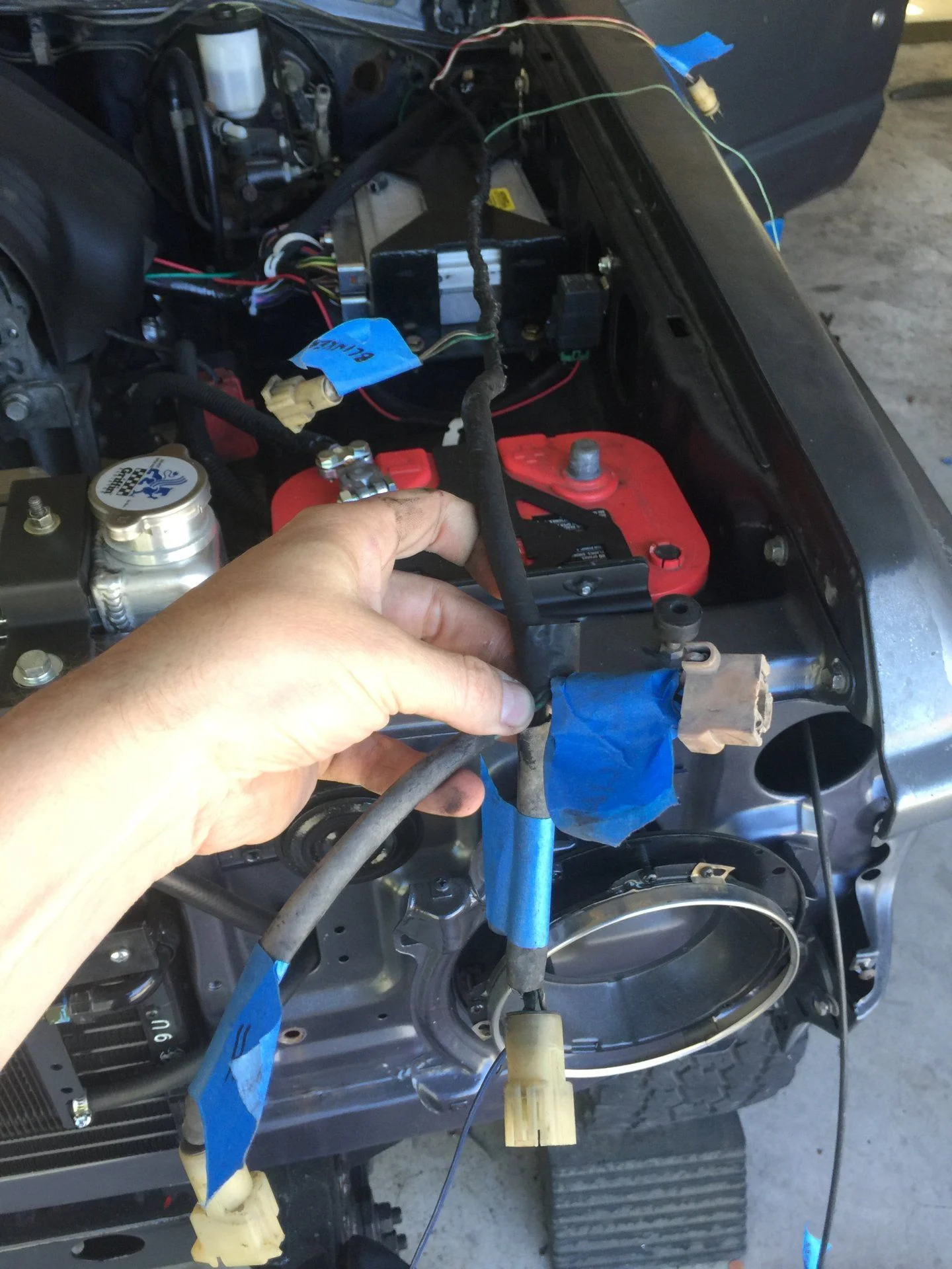

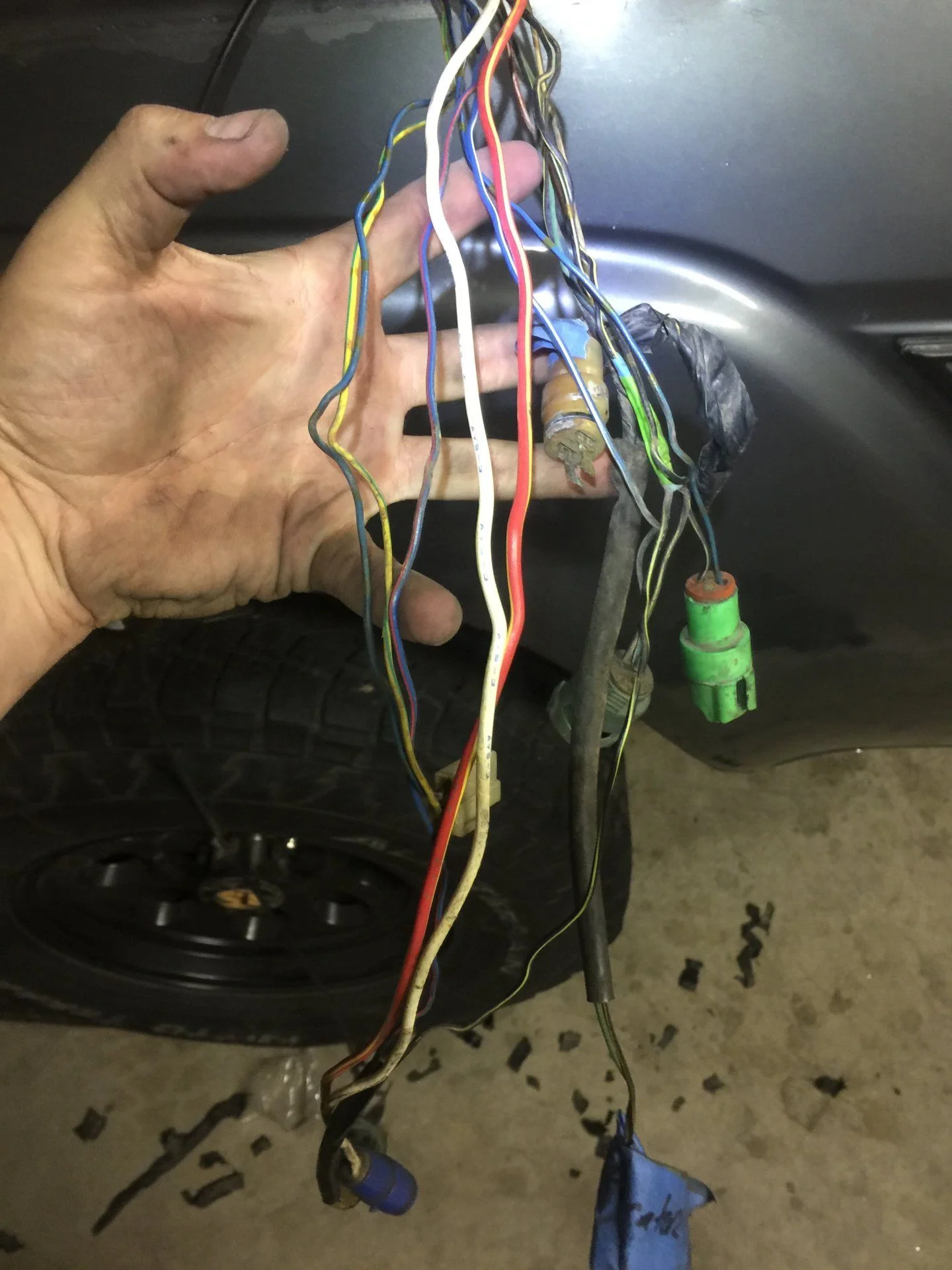

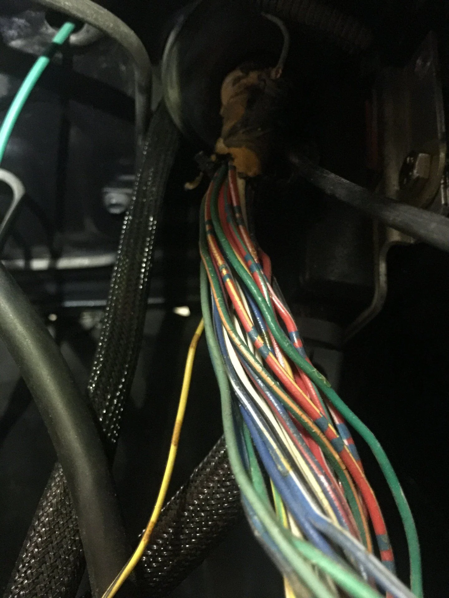

Starred at my old wiring harness for a bit and decided to get rid of all the garbage.
Unraveled the harness and pulled all the unnecessary wire through firewall and deleted em for good.

What is your charcoal canister bolted to in that picture?
I put mine in the same spot but made a new clamp for it.
I just utilized the two bolt holes that hold one of the hardlines to the firewall. Utilized a couple L brackets and tied em in where the old canister clamps / bolts together.

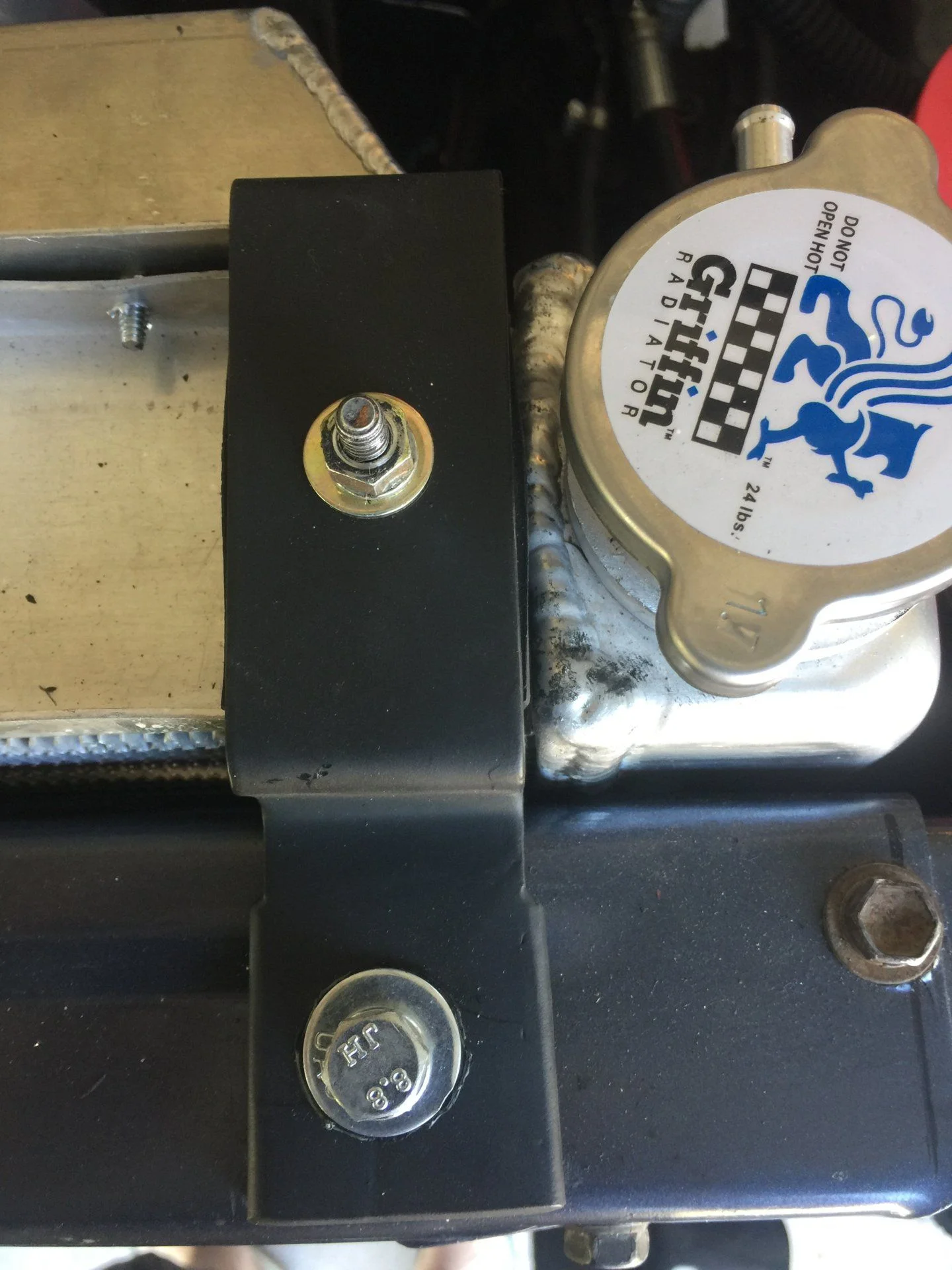

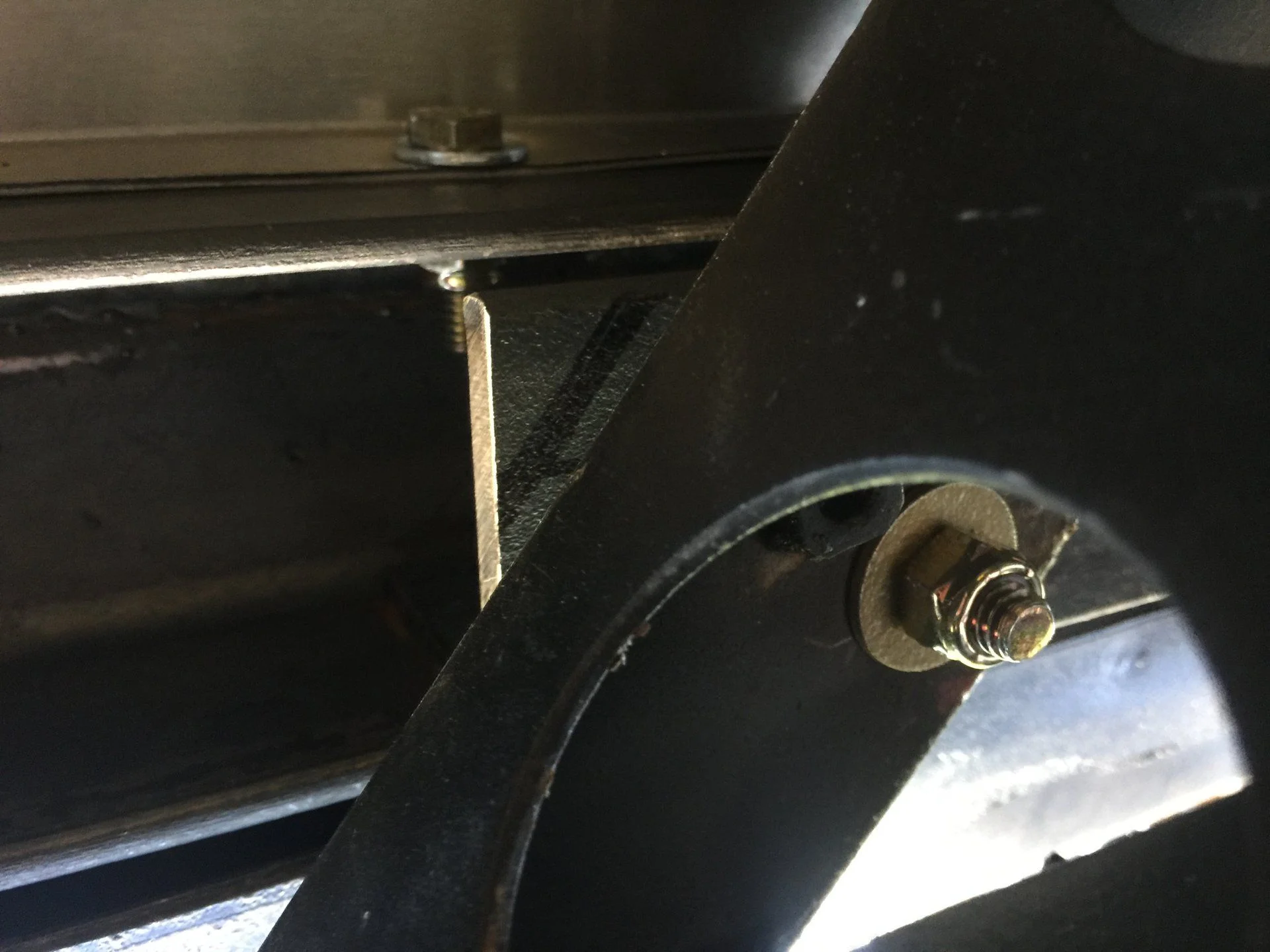

Radiator Brackets - these are the Summit Universal brackets for griffen. Added rubber blocks, drilled and inset bolts into the rubber and through the bracket so it wouldnt go anywhere. The bracket needed about a 1/2 drop to bolt to front clip so welded a half inch of metal plate to em. Then realized where they bolt is actually stamped from factory and has a few offset humps in it so utilized flap discs to shave down where the humps are. The brackets and rubber sit at the far edges of radiator in the valley so they butt up against the actual core to prevent any side to side movement. Its solid!
Underneath i’m running a large piece of channel as shown in previous post. Bolted to frame and the shroud is then bolted through channel 3/4” below core on radiator.

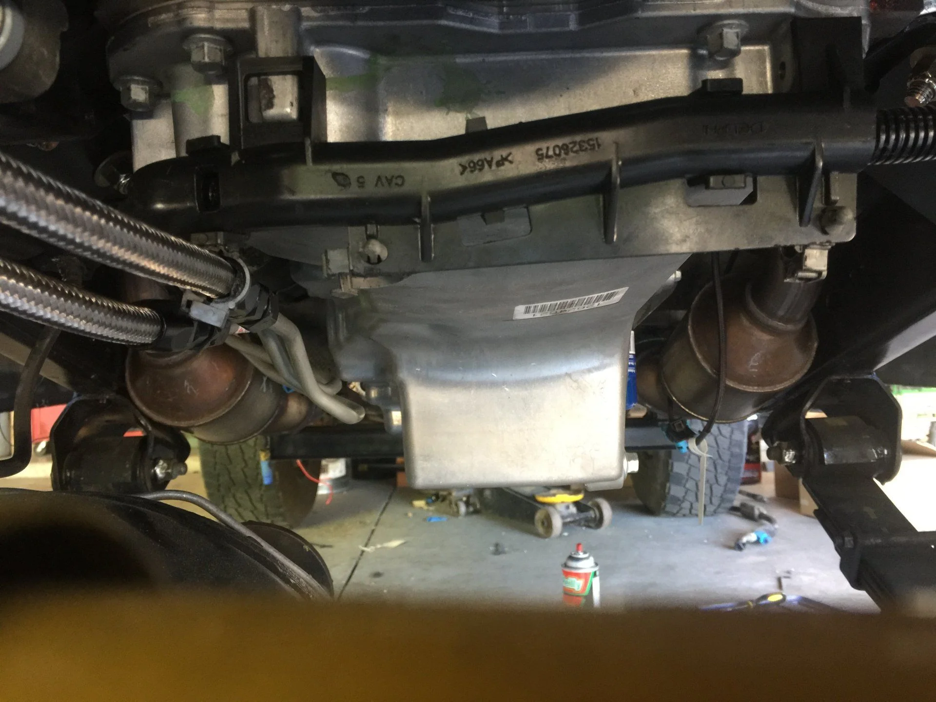

Undercarriage. I utilized a clip on the plastic housing that the battery cable rests in to support my trans cooler lines as the old bracket off vortec no longer works. May come up with another solution but this seems to work for now.

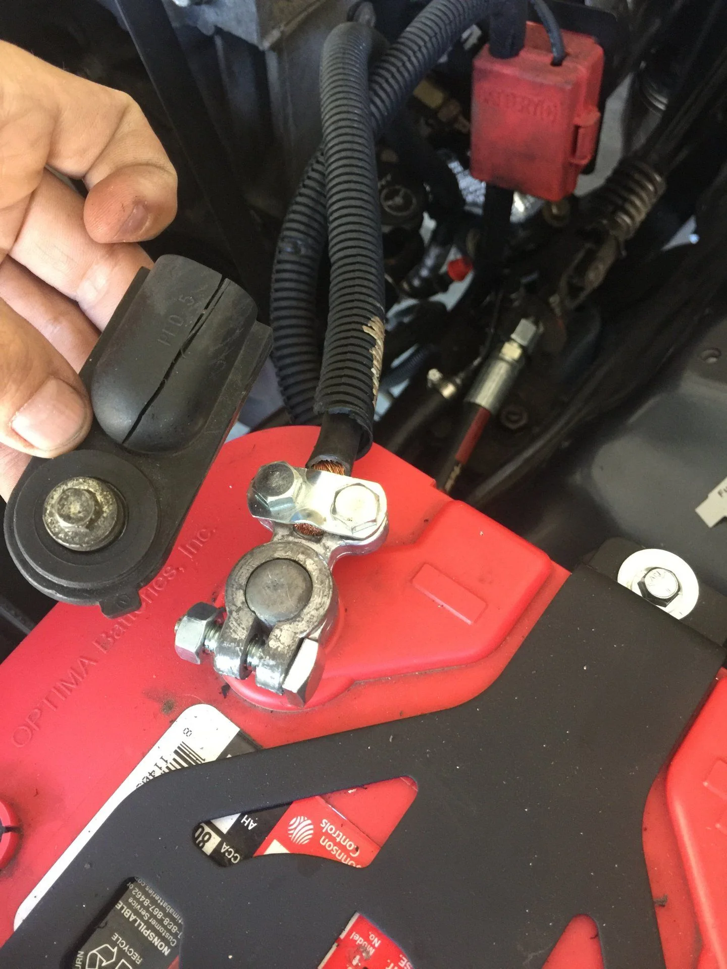

Cut off old side mount system off my battery cables and switched to top post mount. Hate side mounts.

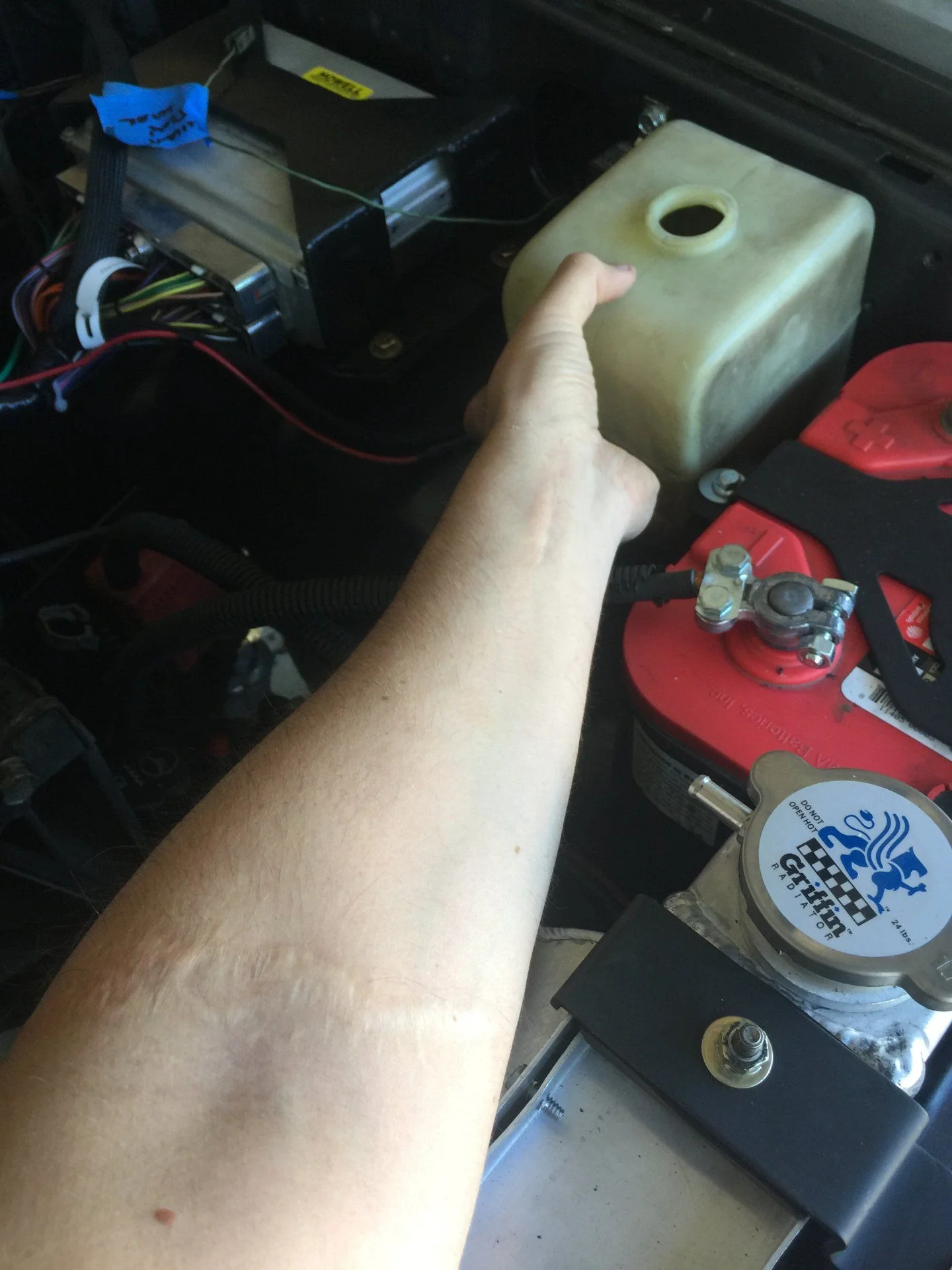

Damn near out of room on the passenger side. Still need to mount the overflow tank for radiator. Guessing it’ll have to go here somehow. Gnarly scar on my arm is from when A dirt bike chain & sprocket decided to eat through it. Glad its still attached to perform this crucial placement. :clap:

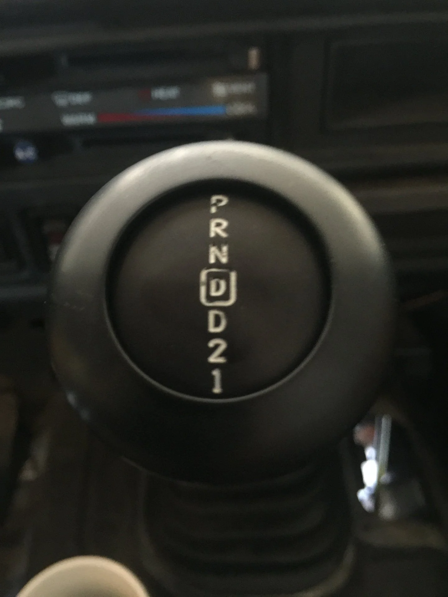

Anyone with a Lokar shifter? My shifter button does not fully retract and lock out in any gear except park. Which allows it to shift without pushing the button. Anyone else ran into this issue or know why it may be doing so. Guess I’ll call Lokar, but I usually find 40% of my solutions on ih8mud, the other 60% of my questions/solutions/parts are derived @FJ60Cam. He prob hates me by now. Haha.
I did... as i had to bent the shaft to get full range on all gears...(tuffy box got on the way)
Decided to gut it, and instead put a piggy shifter on it...
Hmm. Yeah I didnt bend or alter it in anyway. Prob give lokar a call.

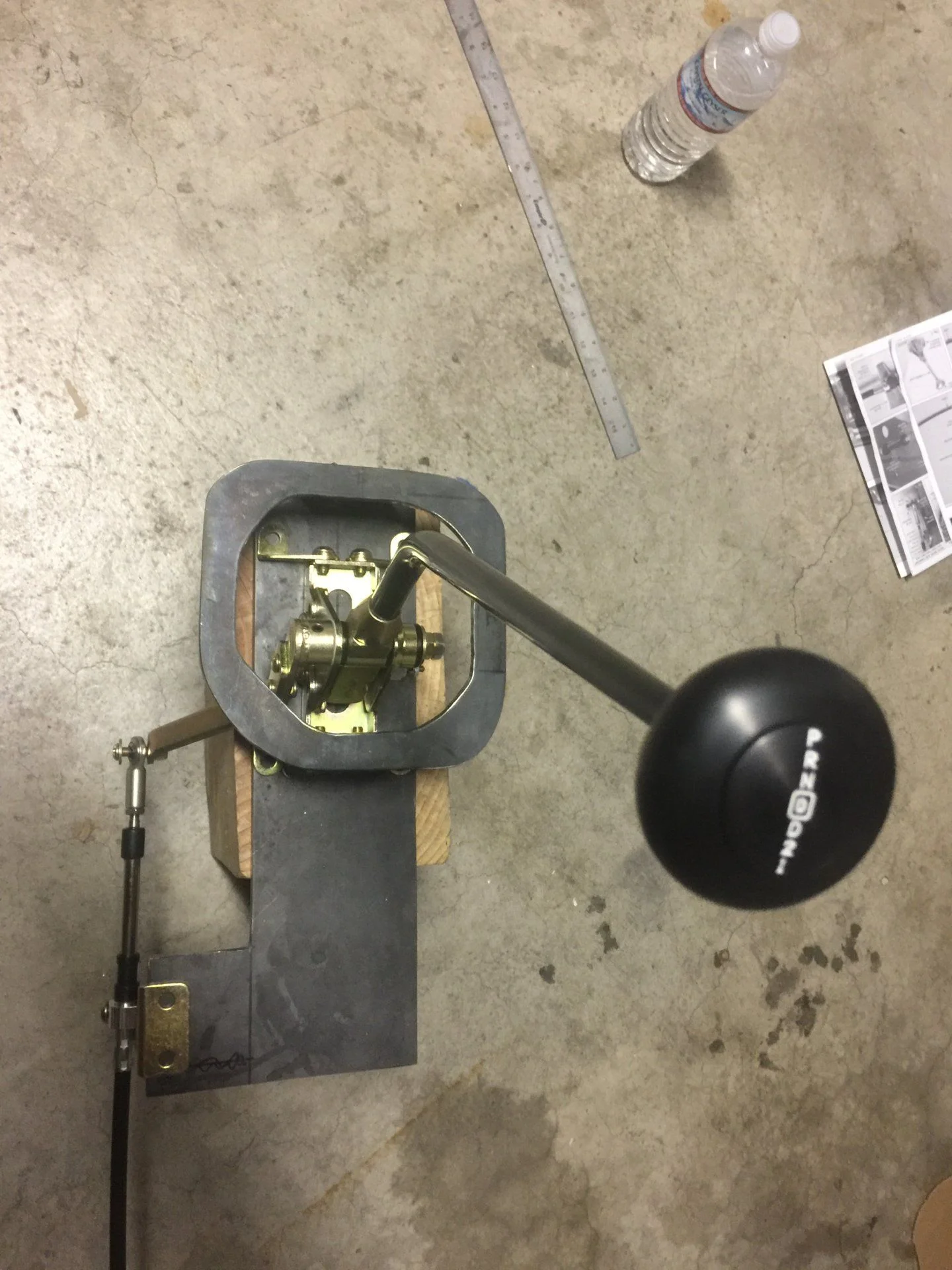

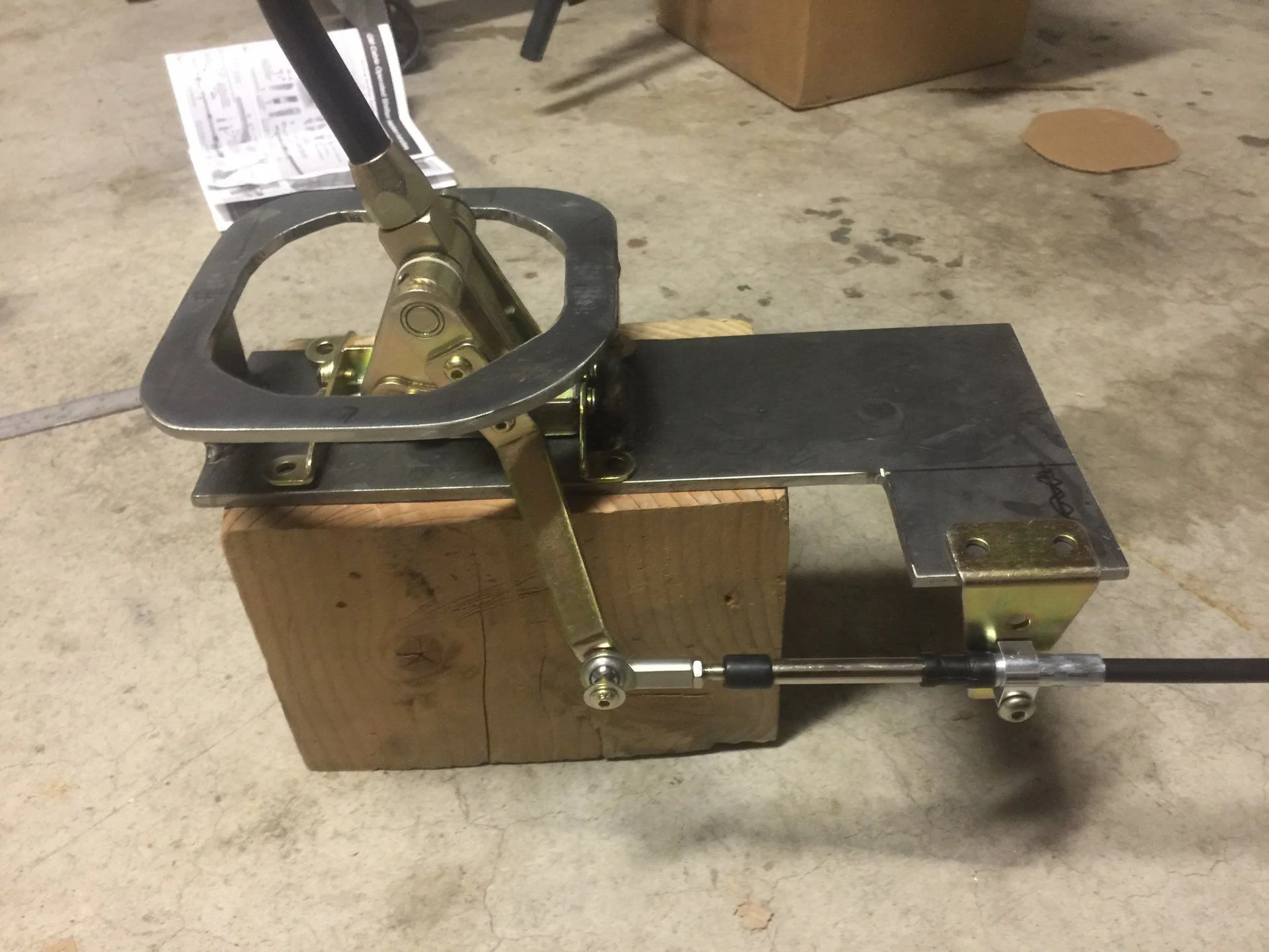

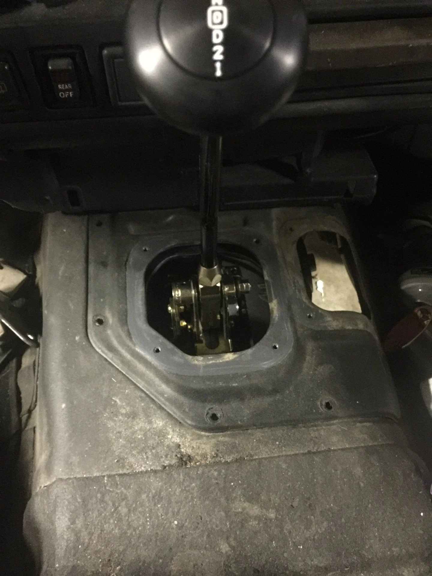

Lets talk Lokar Shifters. The shifter itself looks awesome and essentially keeps the truck looking like a stick even though its an auto (if ya go that route). The one I’m utilizing is a cable driven floor mount shifter.
There is also the option of utilizing a mechanical sub floor shifter. I’ve heard these tend to rattle and are noisy. If ya go this route the 16” model is a good bet.
I went with the 16”, however being that mine is the floor mount unit it actually sits about 3” higher. Making total height at 19” from floor. This poses two problems.
1. The shifter sits high and looks goofy.
2. The shifter actually hits the front console/dash near the cigarette lighter.
Which leaves two options really. Buy the 12” floor mount model - putting it at 15” total height. Maybe about a 1” - 2” shorter that the stock yota stick shifter.
Or

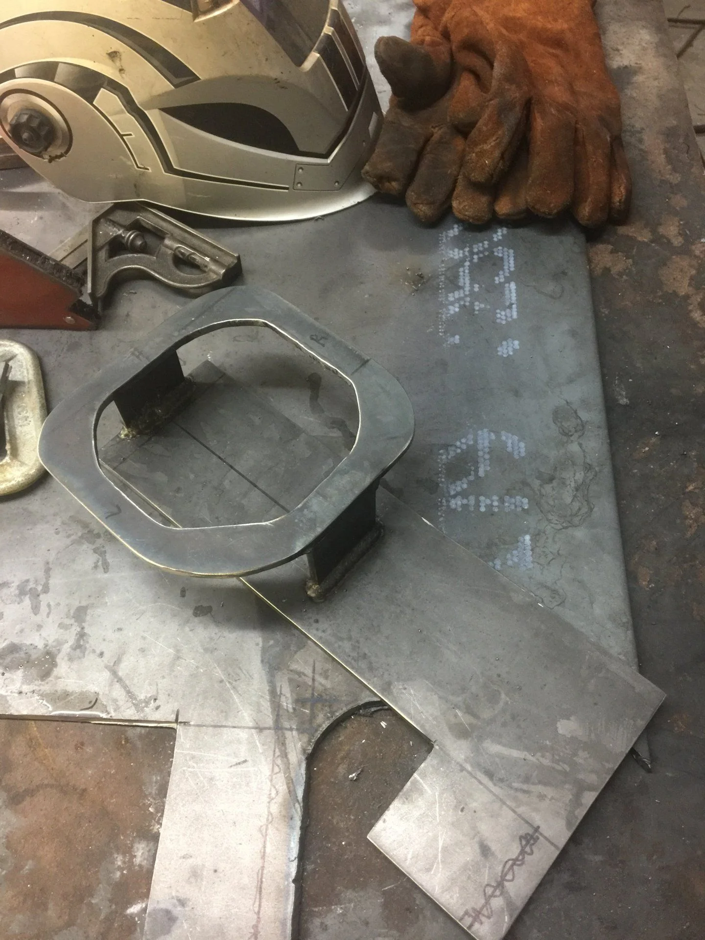

Fab up a bracket that allows the floor mount shifter to actually sit sub floor level. Being that I already bought the 16”, shredded the box for motor mount templating material and generally hate waiting around for shipments this was the route I went.
The brains behind the operation was @FJ60Cam - I just fabbed up a similar bracket. And it works great.
So this is 1/4” stock. Overkill for a shifter? - you bet ya. Nascar approved? Probably.
When ya buy a 2’ x 4’ sheet for the project you’ll be damned if any goes to waste. Didn’t have anything thinner to be honest. 3/16 would’ve been nice.
Dont be alarmed by the water. Got to hydrate in between beers. Plus its 104 degrees here today. Ready for snow & snow wheeling.
You get the Theory. This esentially puts the total height of shifter at 16.75” from floor. Eliminates it hitting front components and puts it realtively close to the stock shifter height. I would be curious to see what a 12” floor mount lokar looks like tho.

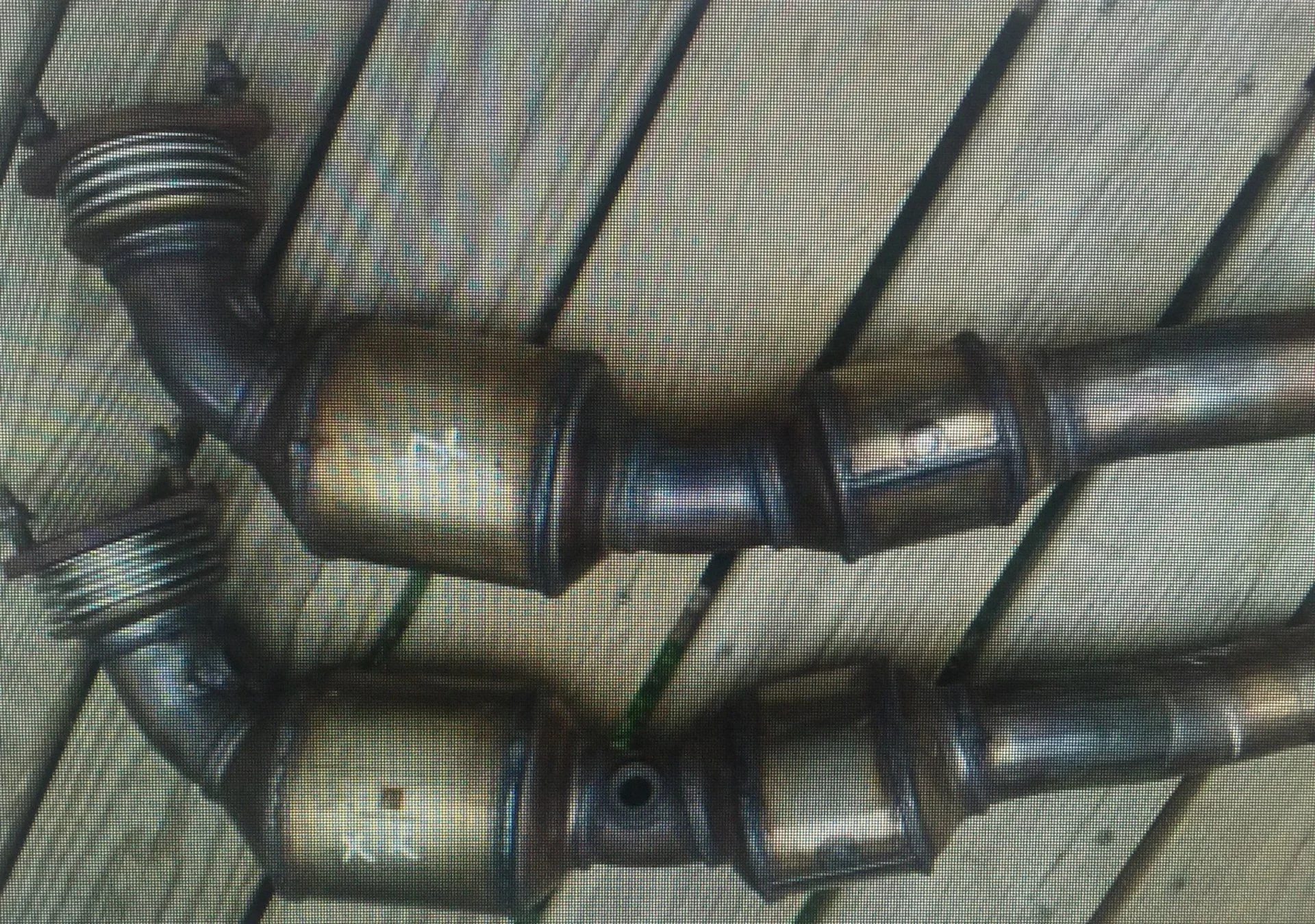

Also ordered a set of Camaro downpipes and cats to match up my Camaro exhaust manifolds. Will they fit between a yota frame or hangup? Who knows. Cut, bend, twist and anything will fit. Just depends on your patience level. Mines running out. Haha

Yukon721,
I've been following along with your build and enjoying your work. I'd like to suggest a different style battery clamp. I've used those in the past and had bad connections over time. Here is the type I'm using now and really like them...https://www.amazon.com/Military-Spec-Battery-Terminal-Post/dp/B00X36RILW?tag=ihco-20
Keep up the good work!
Nice. I’ll give em a look. These were a $4 purchase at Ace Hardware in the bolt aisle. (Where I spend my free time - haha) Plan on implementing a better system down the road. These are the “get the damn thing running version”

UPDATE
Called Lokar - They say that the shifter is designed to only lock out in Park & Neutral. I can't remember if mine locks out in neutral but I know it does in park. Seems like you should have to push the top button to switch in between all gears. Maybe it just feels like that since its feels more like a stick shift. Been a while since i've played with an automatic shifter but maybe that is the way they all are. Anyways, guess there is nothing wrong with the shifter after all. Just don't overanalyze it. heh
Also was pretty worried about having stripped the AC condenser and finding a new fitting / whole new curly AC condenser line as shown in a previous post. Turns out the rubber line that attached to that curly hardline had the exact same fitting on the other end of it. Cut it off and luckily it screws right on to condenser no problem. Which means just need to cut the old fitting off, slide the good one on and re-braze a new barb on the end of the curly hardline. Could've been a lot worse.
Moral of the story - Save every damn piece that comes off the FJ. Some of those parts are worth their weight in gold when ya need em.
