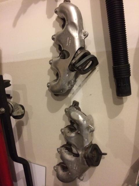

If you are willing to notch the frame rails a little then stock ls3 manifolds will fit. The only reason I didn't use them was because I would have had to make little extensions to move the coupling down a few inches because there would be no room to uncouple the pipes from the manifolds should the need arise at a later date. I still have a set of brand new ls3 manifolds that I didn't use. The nice thing about them is that they have O2 sensor bosses already in place and the match the exhaust port holes perfectly. Let me know if you are interested in them. I even bought a set of laser cut steel flanges to build the down pipes from.
Are you talking about LS3 Camaro manifolds?
I really want to avoid notching the frame for a variety of reasons, not the least of which is the fact that it will turn off a lot of potential customers. I'm hoping that the manifolds off of an early C6 LS2 will fit. They look a lot like the center dump headers that a lot of swaps use and hopefully will be tucked in tight enough to clear the frame.
ls2 and ls3 use the same manifold and are the center dumps you are thinking of. With a truck style intake there is not enough room to position the motor high enough to make room for the ls2/3 exhaust manifolds. Maybe a car intake would do the trick though.
Take a look at ls7 manifolds
Yup, those are the ones I've been trying to get ahold of. Damn, I was really thinking they were the ticket.
Are you interested in getting rid of them? If so, I'd be interested in trying them out anyway.
The LS7 manifolds are funky. I know they flow really well, but the flange on them is monstrous. I would be quite surprised if they clear the frame. I'll see if I can track down a set though. The problem is they're a solid upgrade for the LS2 guys, so they're worth money.
The c7 ones have a weird oval flange that might help with clearance
Yep they are for sale. I finally figured out that they are the stock manifolds for a corvette c6 with the ls3. Apparently other vehicles used the ls3 and have different shapes to the manifolds.
