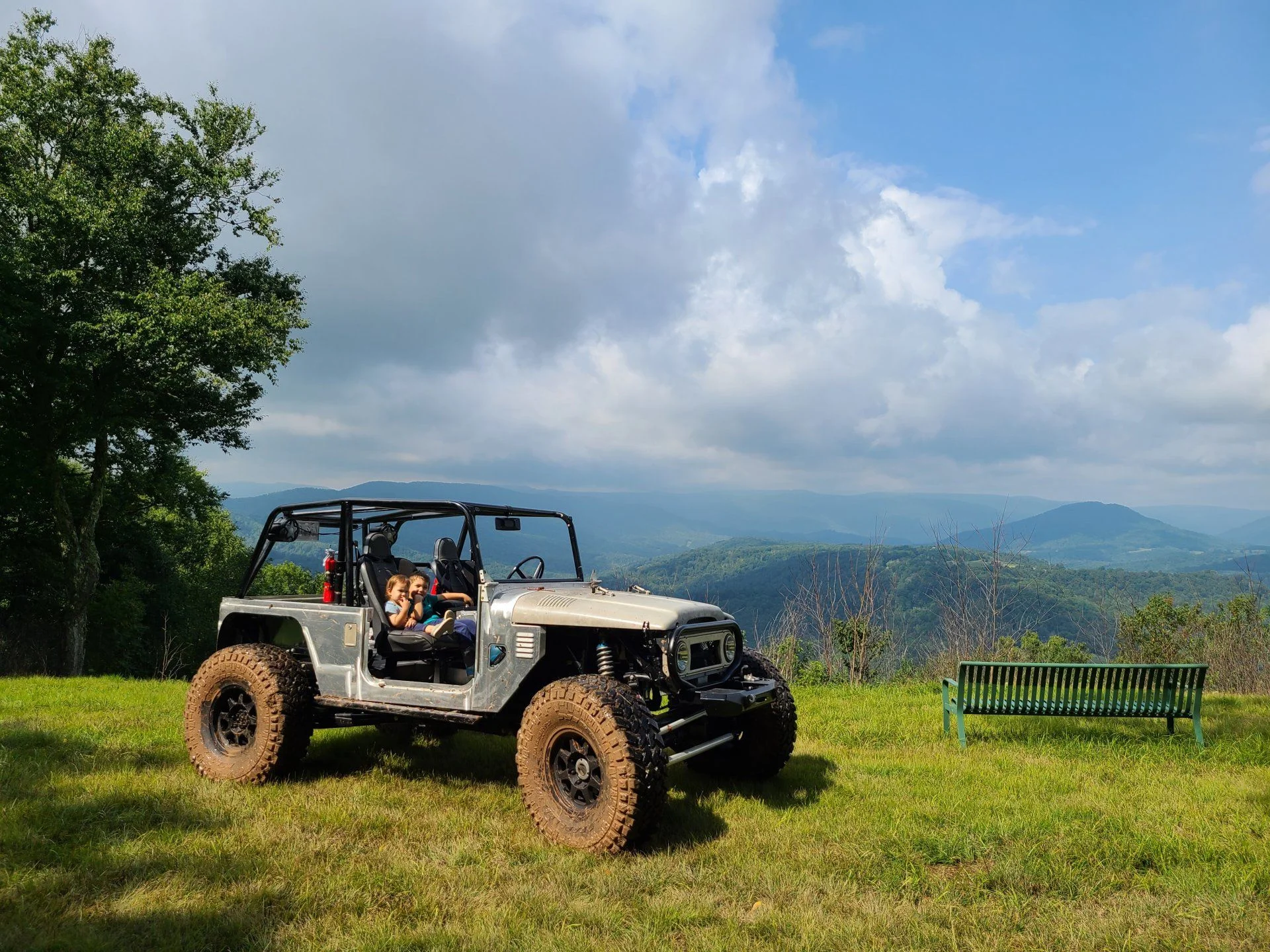

Update: The 6.2 found its way into this 40 instead of the 80.
Sorry to disappoint everyone looking for an 80 kit.
