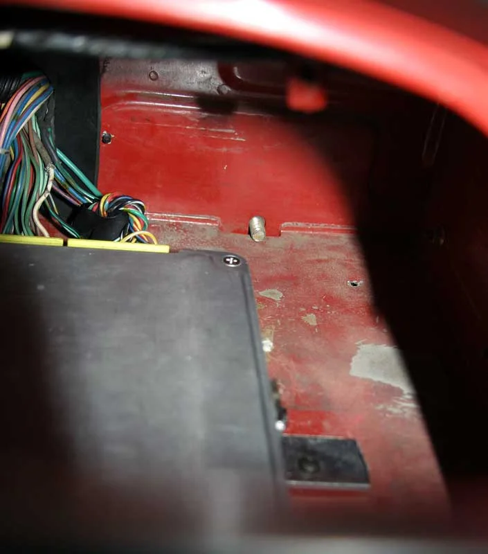

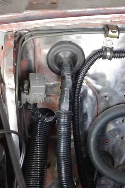

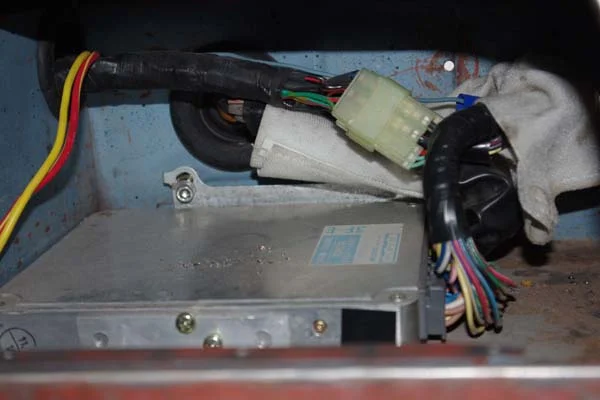

I like how you mounted the ECU 90 degrees different than mine. I might need to consider that.
It's always great to see how other folks do things. I used two small "L" brackets, and a little dynomat under the ECU to dampen any vibrations. I don't know if the Dynomat is needed, but I had a piece laying around.
Iam still jealous of your neat Harness! :D
I am still jealous of your neat Harness! :D
Dynomat. Great idea.
The harness is factory new, unmolested. The second harness that I needed to tease out of the cowl harness comes into the glovebox from the side to the left of the ECU.

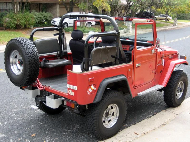

Topless

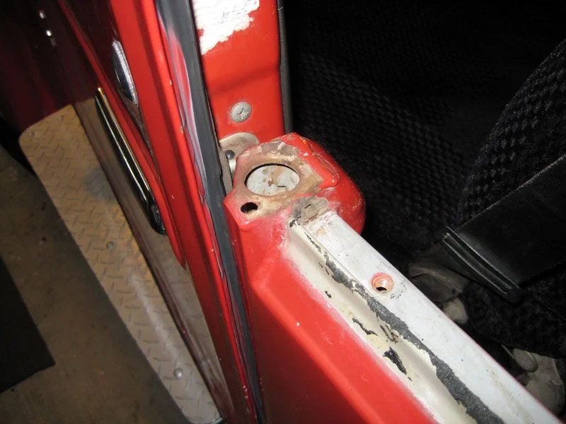

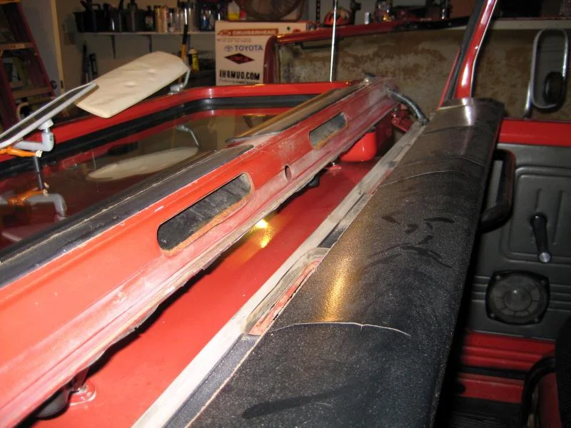

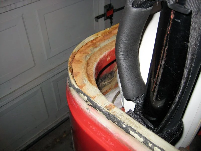

Today I decided to start in on all the weather striping. Last time I drove in the rain, I had water dripping on my feet from the dash. NOT GOOD!
After taking off the top - I found that most of the rubber parts were cracked. No Big surprises, just a little surface rust.
The only problem now is that I like having the top off!! ;)

Just trying to make use of that water in the cab........man you should see the weatherstripping on the red 76 up at CCOT. Unbelieveable. On my 76 tub, some jacques-asz hacked off the hardtop "legs" that sit down into the body thinking the roof was rusted in place, I guess.
Gonna have to figure out how to remove the stumps. Otherwise just grab me a Pilgrim's tub while I'm there................
I've been up to CCOT and taken a good luck at both the trucks - fantasic.
Iam just going to order most of the seals from them, and the windshield seal from Toyota. Unless some one can tell my why not. It's much more expensive OEM...

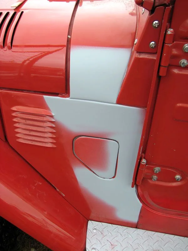

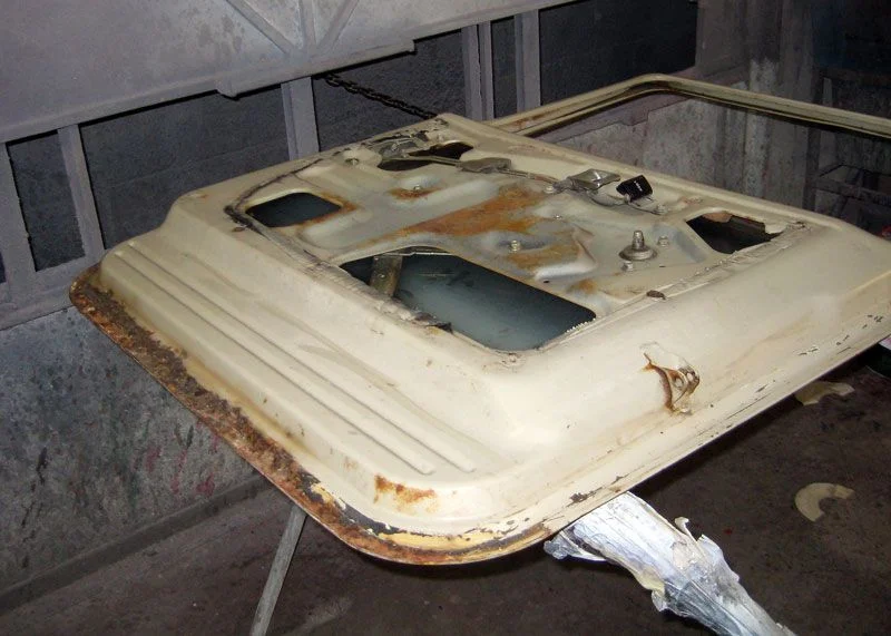

Stella is at the body shop, and here is a few shots of the progress. The front end is being finished. A surprise we found this morning after cleaning up the dirt and old rubber off the DS donor door - is more rust than we care to deal with.
So Iam hunting for another door, or maybe use the CCOT skins??
Hey Mark. My doors are the same but at the VERY bottom. They have to be reskinned someday. Until then, NO DOORS. Very inexpensive solution. I did take a look at the Pilgrim half doors. Sound very light/hollow to me and your wallet will sound the same after the purchase........
