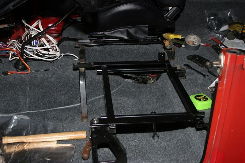

Here is a crappy photo of the PS seat installed. I went ahead and bought the set brackets. Procar did a good job at designing the brackets, and the bolt and threads are even metric. ;) The brackets even have threaded seat belt mounting tabs. It's really a drop in solution.
