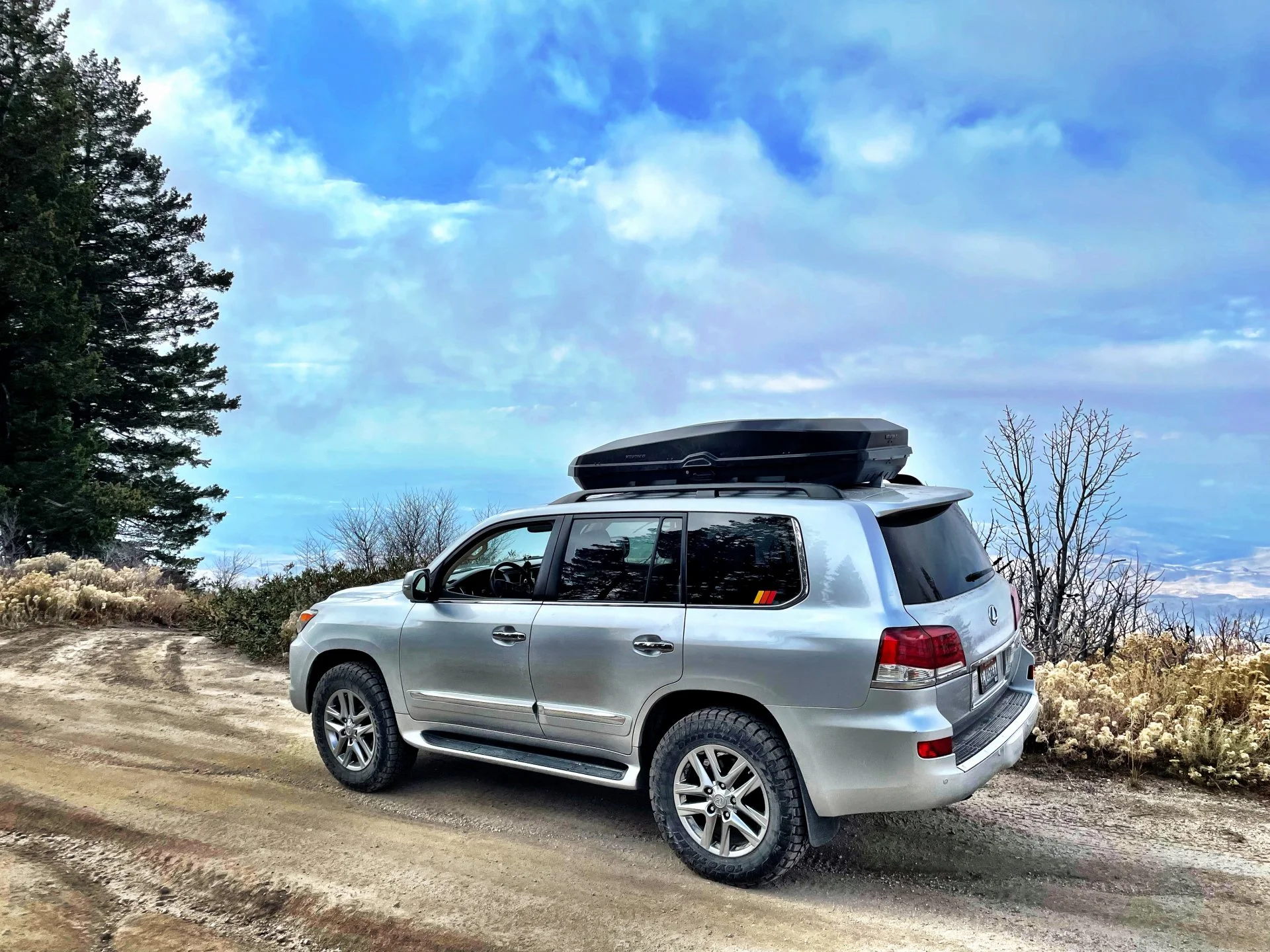

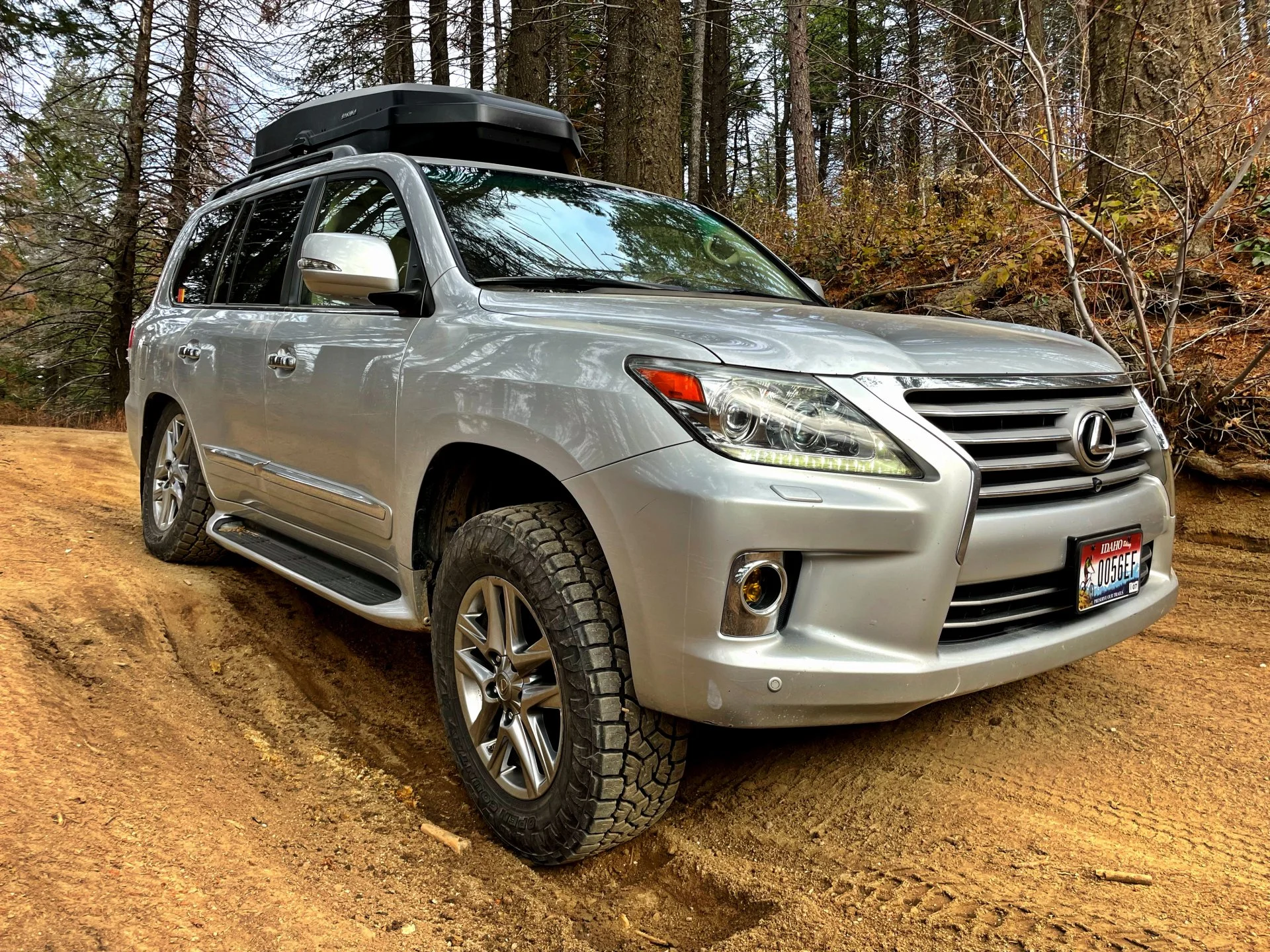

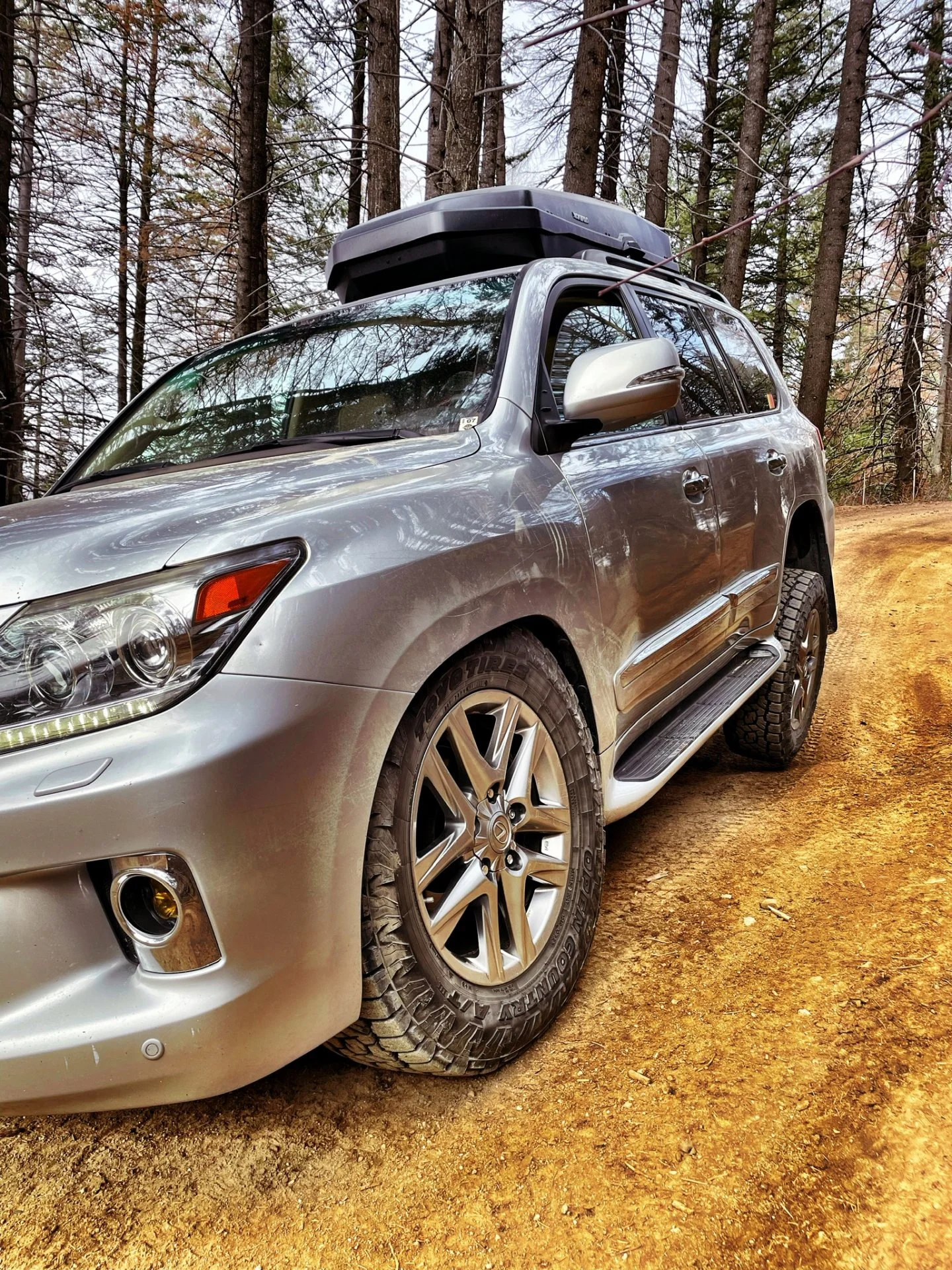

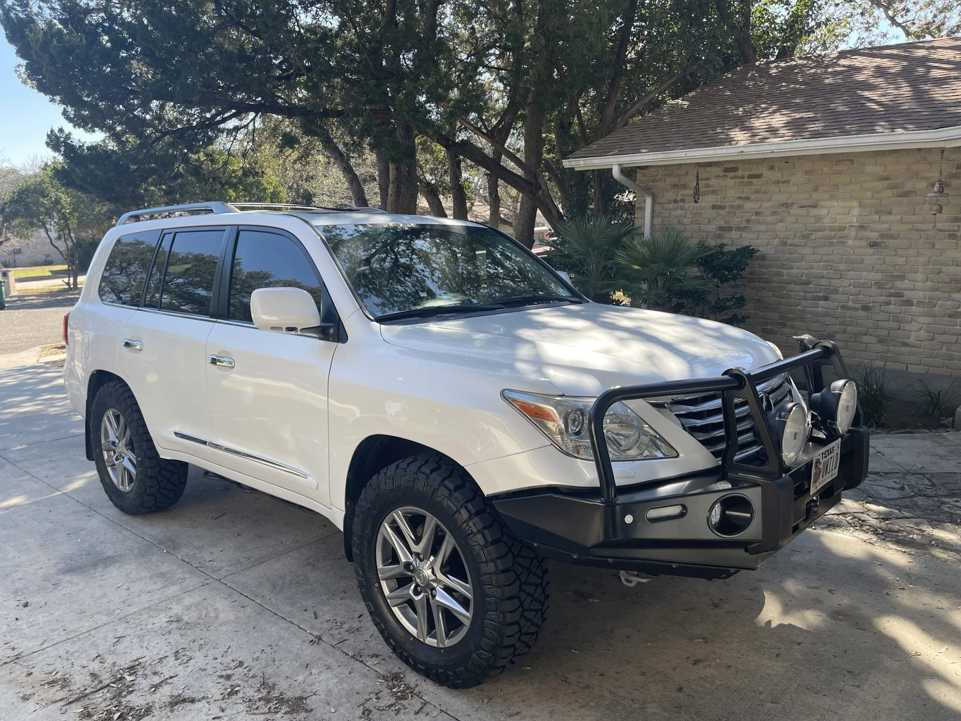

2013 LX 570 with 35x11.50R20 Toyo AT3’s. BORA 1” spacers all around, no sensor lift just some trimming and tucking of the fenders.

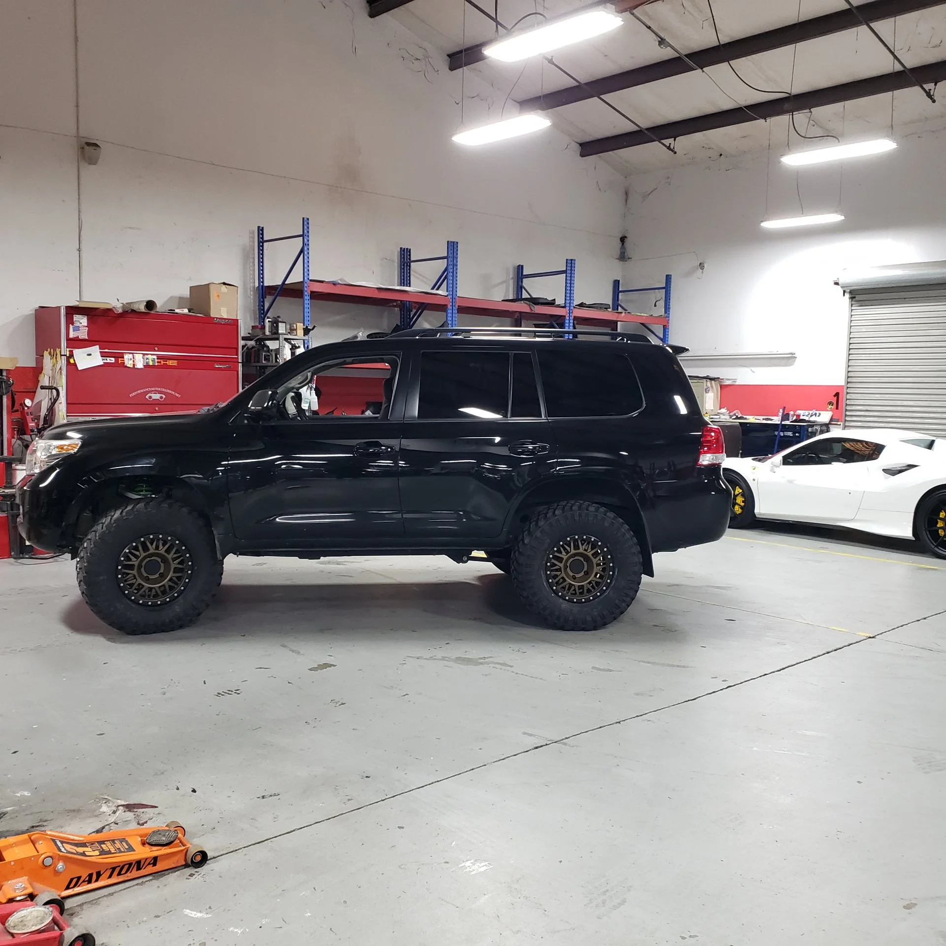

35s on 20s.
Changing up the look this weekend as well.
35s no lift! Madman! No splash guards im guessing? How does it handle and feel? +30 equivalent offset on those 20s if im correct?
Sorry for the questions i have the upsize bug bad.
No splash guards front but the rears are still on. I still have the fronts in the garage and plan to trim and heat shape them so I can put them back on.
Can’t remember OEM offset and what the final was with spacers but that sounds about right. I really wanted to run bronze Icon Vector 5 17’s and 35’s but I waited months only to be told the shipment didn’t arrive so I went this direction and I really like the near stock/sleeper look for the LX.
Handling and feel is amazing. Feels forms but also rolls over small cracks bumps and other road damage with less drama. Driving mine with my buddies 2020 LC HE with stock sized tires back to back really didn’t feel much different acceleration wise. Do notice the extra mass braking. It’s not under-braked or weak feeling it’s just the place you notice the difference the most.
All in all I have zero regrets. Was just in Hawaii with a 2021 Expedition as a rental and the decade old LX feels much tighter and more enjoyable to drive all around.

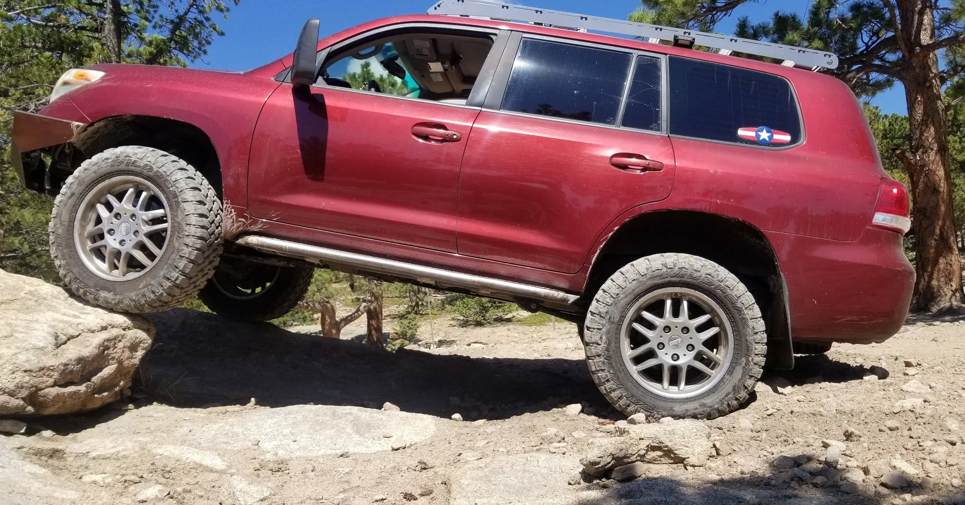

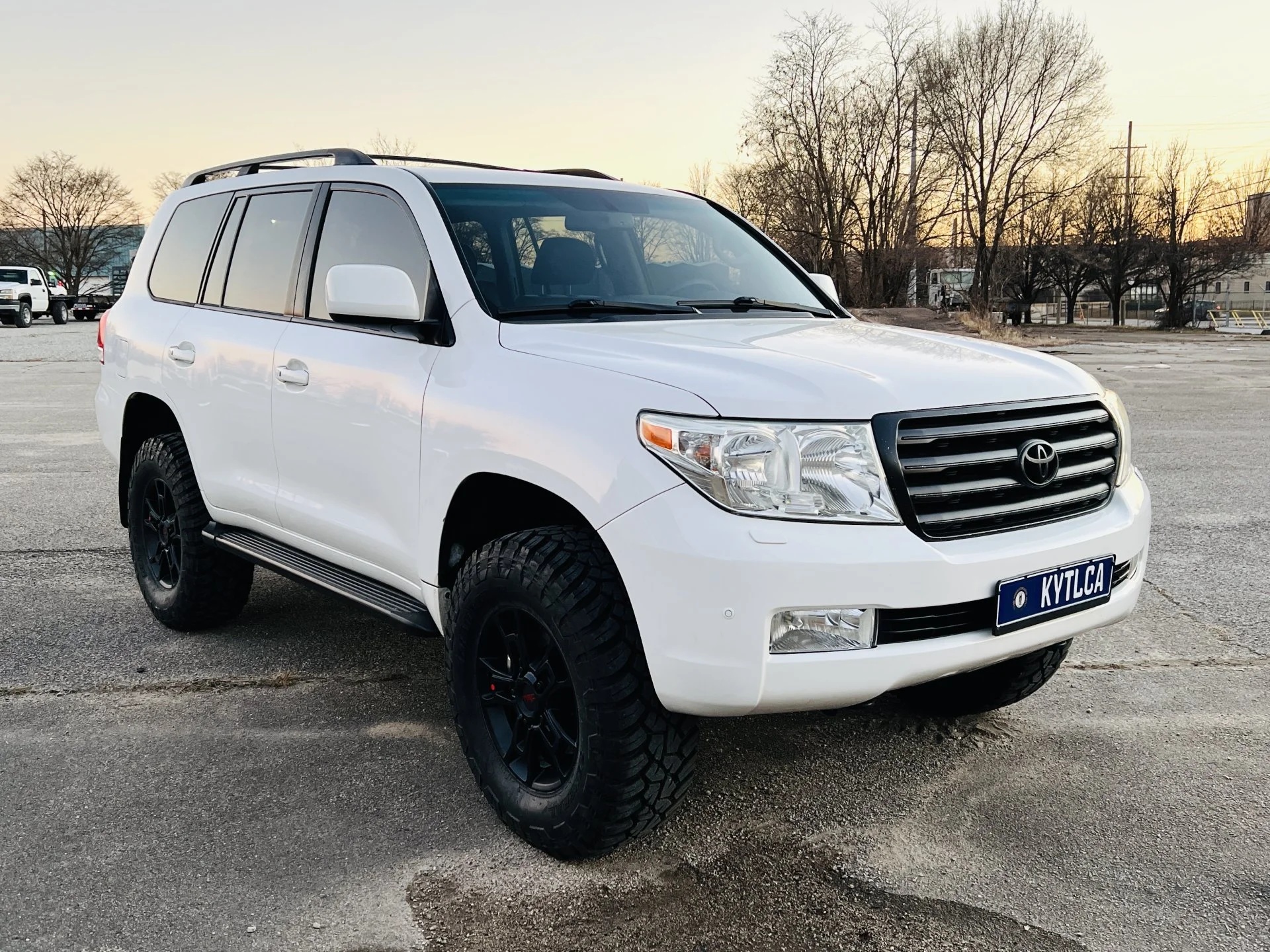

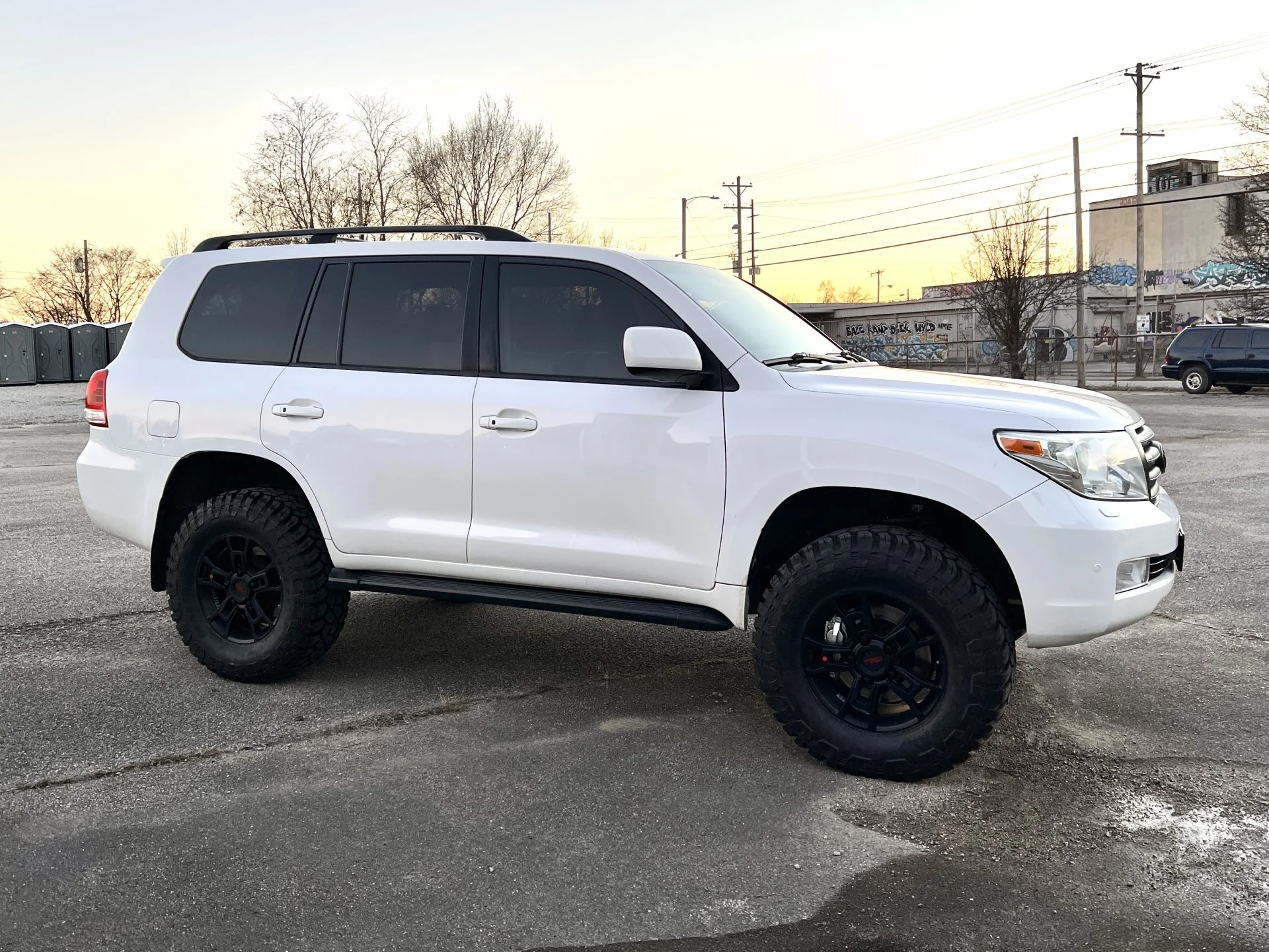

275/60R20 KO2s to 295/65R20 Ridge Grapplers. Gotta do some more trimming and then play around with the levels, probably bump N up a half inch or so.
What did you do about the spare tire? The 295/65R20 lists at about 35.1" which seems a bit large for the stock spare tire location?
Still trying to figure that out LOL. The size tolerance shouldn't exceed 3%, which for my size (35.12") is 1". Thinking running a 34" or 34.5" tire under?

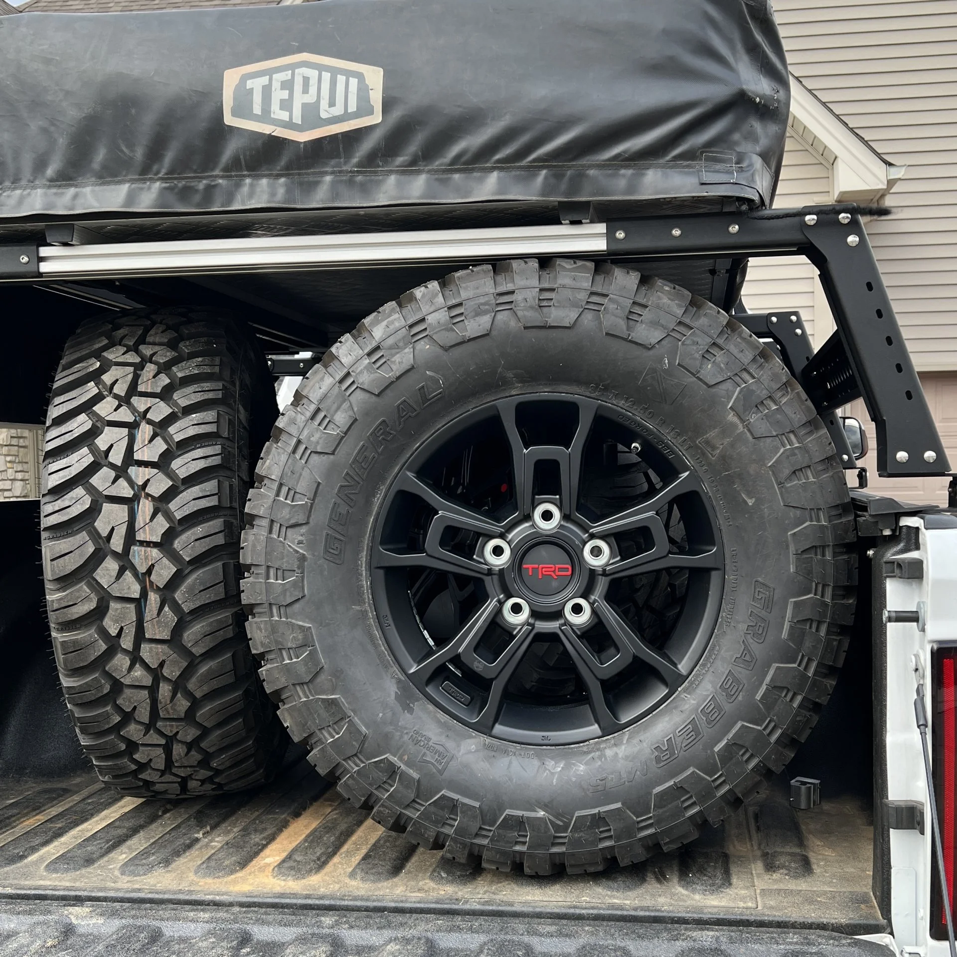

Liking the OEM+ sleeper style!
We need pics of those bad boys mounted!

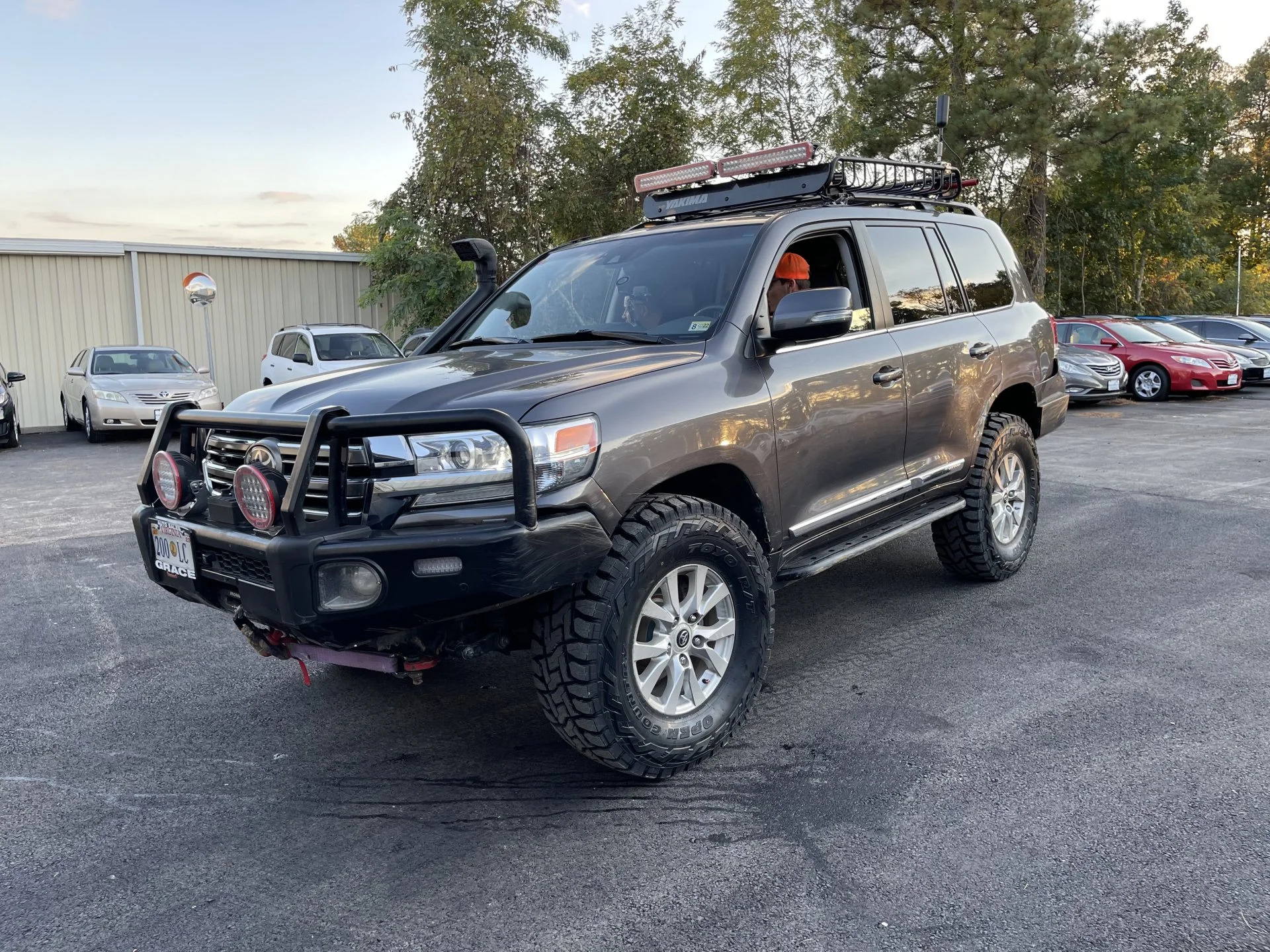

Long weekend in a cold shop but the new Tundra based front end and OME/Fox rear setup is in. Waiting on the alignment shop to get me in before I drive it too much but so far I'm pretty happy with it (minus a missing coil spring retainer on one of the Fox coilovers but that's another story.....). The 35s required minimal trimming of some of the inside lower plastic and they're really close to the SPC Upper Control arm but that hopefully should get better after the alignment.
