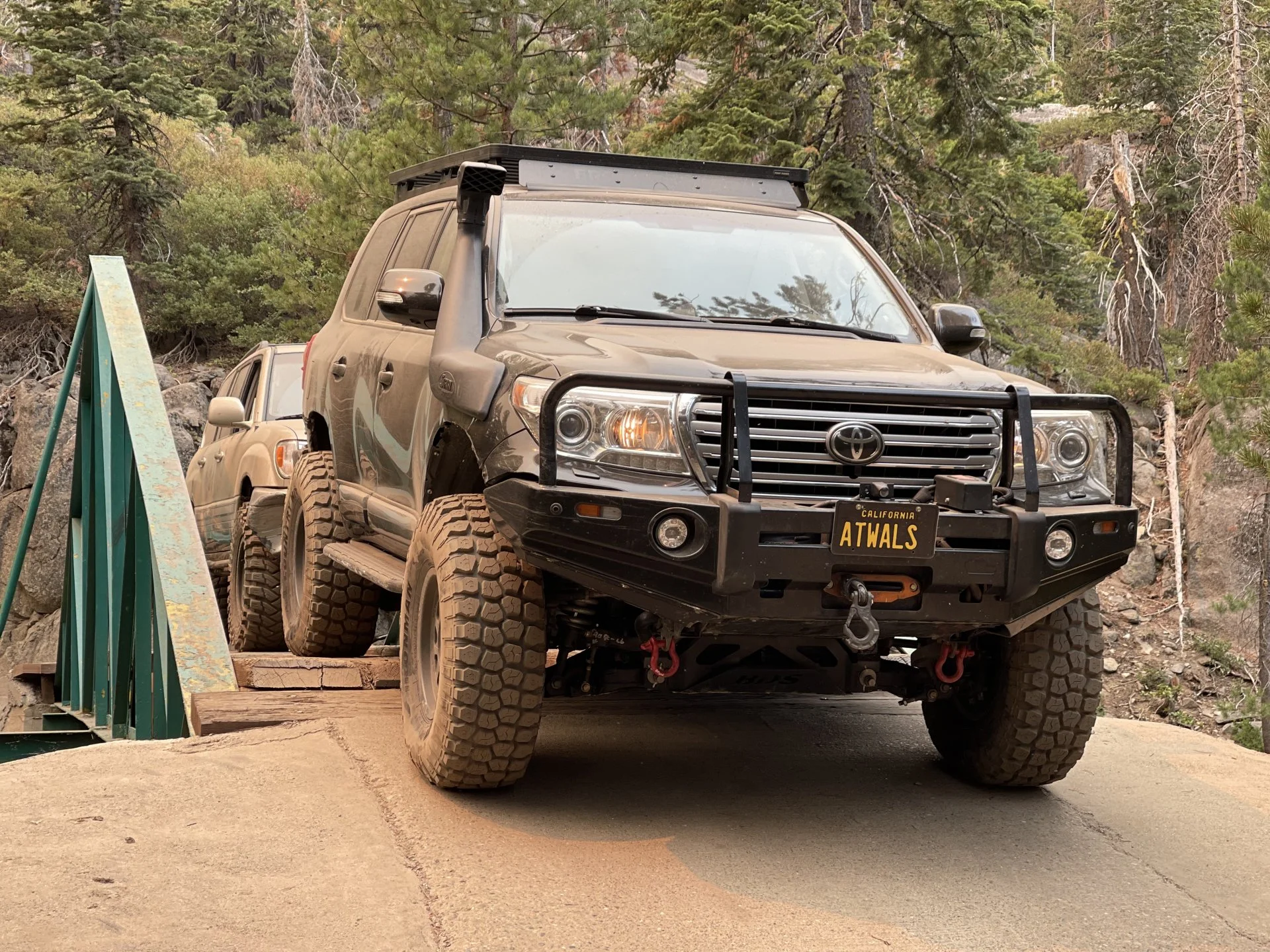

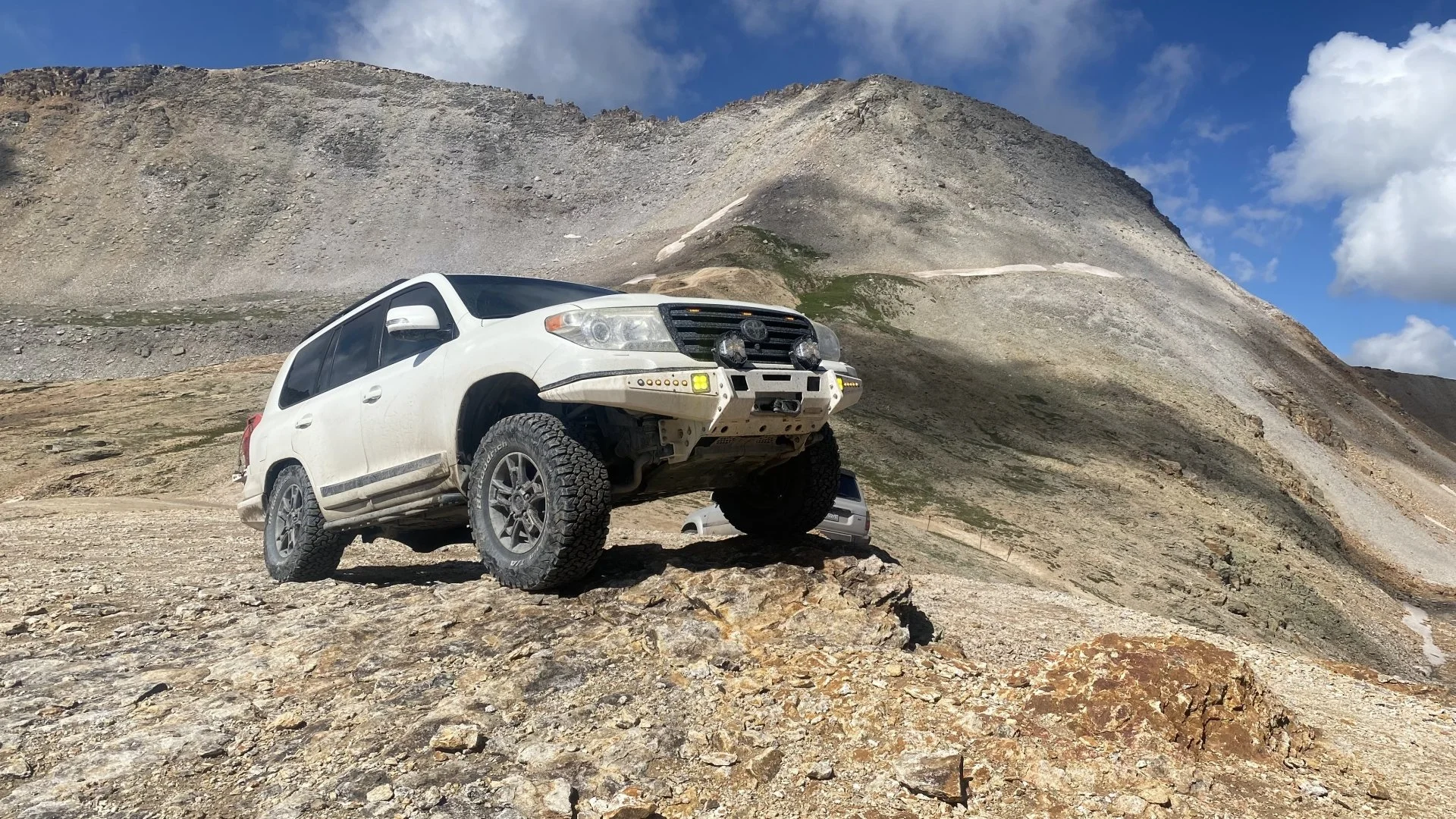

per the OP request…
1. Tires - Pro Comp Xtreme MT2 37x12.5 17
2. Mods - Body lift, metal cutting, body mount relocation, not sure if the following is necessary but I also have the AHC sensor mod, just a bit beyond normal, UCA’s and thicker squishy bumpstops front and rear.
3. So far they seem fully stuffable. It was flexing pretty good on this trip.
4. Wheels - Rock Warrior converted to true Beadlock by OMF Performance.
5. They appear to actually measure 37” front to back.

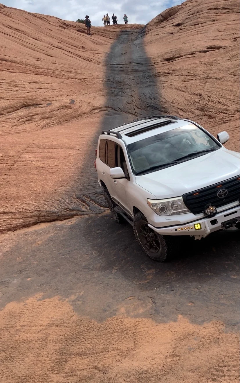

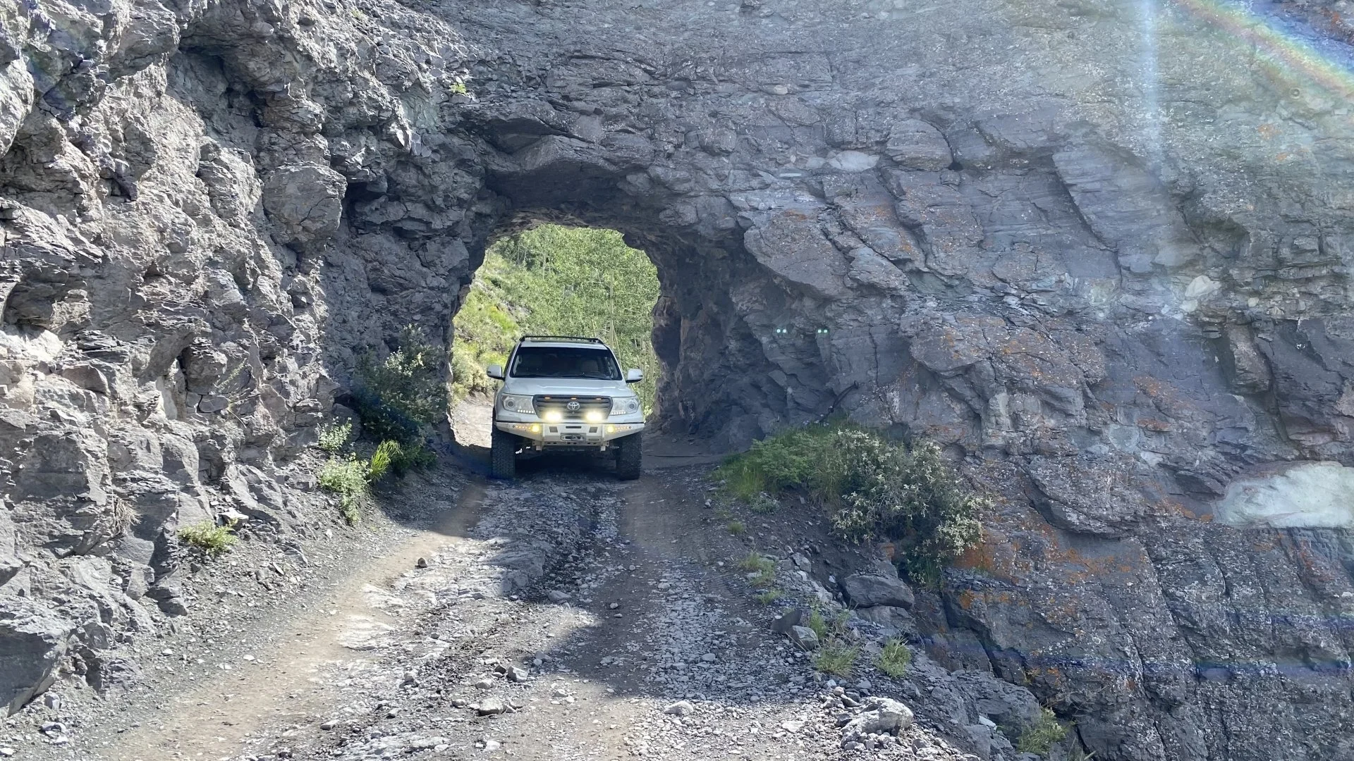

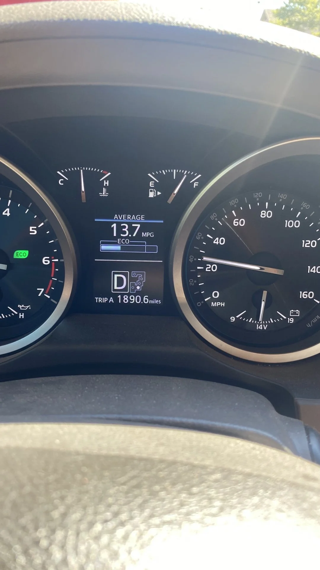

I just got back from a 2000ish mile road trip to Moab and ouray and I can't believe I averaged about 15 miles per gal. Per the onboard computer says 13.7 and adjust about 10% for the larger tires = 15 mpg( am I doing this right?) this was not including wheeling time. It was reset after wheeling before heading home, but on the way there it was about identical at 13.7mpg. I was doing about 75-85 most of the way. With my previous 285/65/18 the best average was about 13mpg on road trips. Around town/ mixed city driving I probably did lose 1mpg. Am I crazy or has anyone else hiway MPG increased with 35's? Also the only time I felt I could have used gears was the really steep stuff In Moab. Even then, I was able to crawl up everything. I'm really happy with my 35's. I wish I would have done it from the start. There will be some practically new 285/65/18 ko2's in the classified section if anyone is interested.

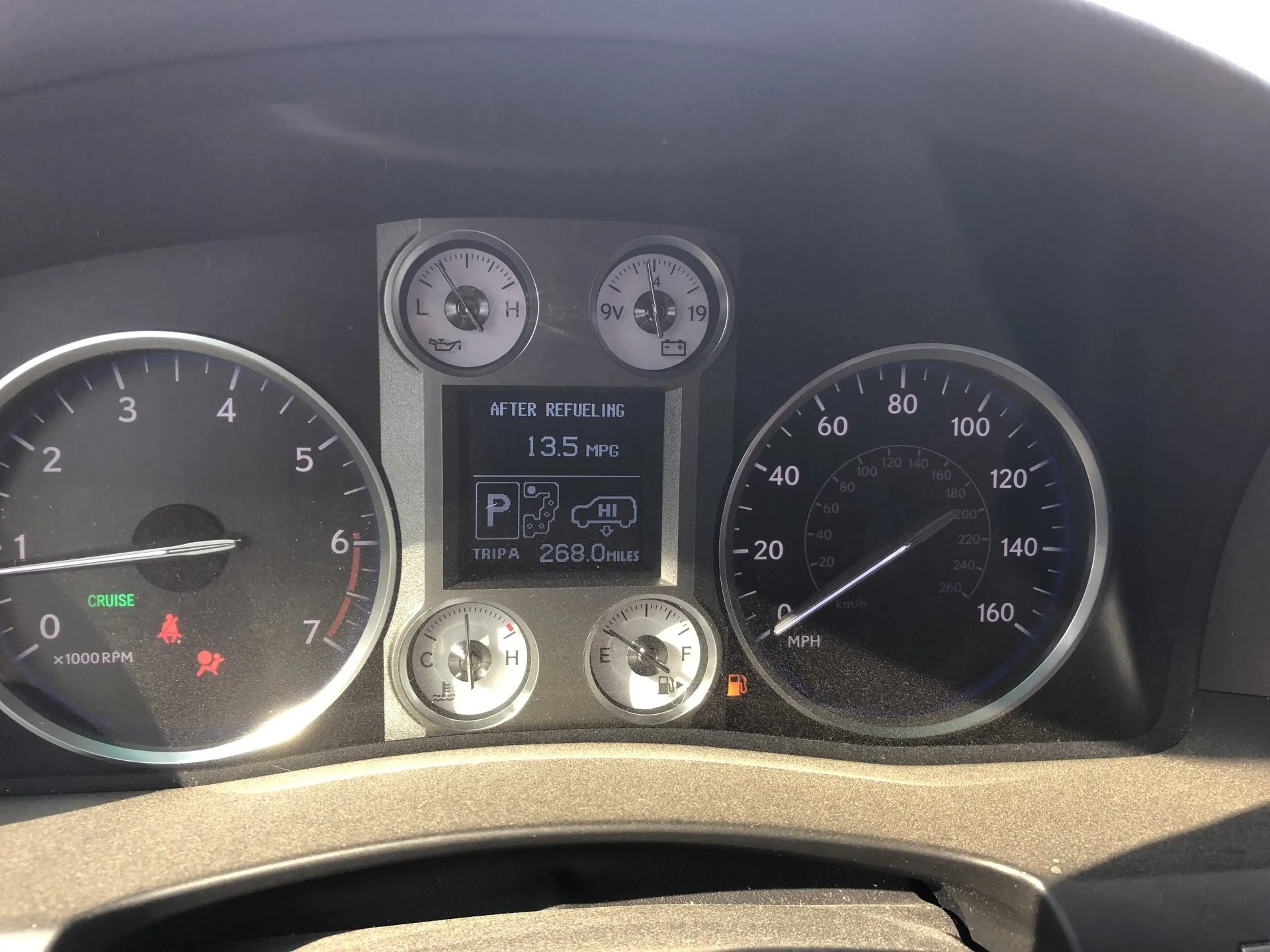

My experience is the exact same, even with 37’s! Worse in town but Highway has improved slightly 🤔
and I think I’m off about 12% so that’s about 15mpg as well on this mixed driving tank. Gears are coming so I hope it improves even a little more. We’ll see 🤷🏻‍♂️

great........ now 37's are the new 35's..... lol that's awesome! add 12 percent miles to that tank and your basically at 300 per tank. none of my past 100 or 80 builds have been able to accomplish that specially stock.

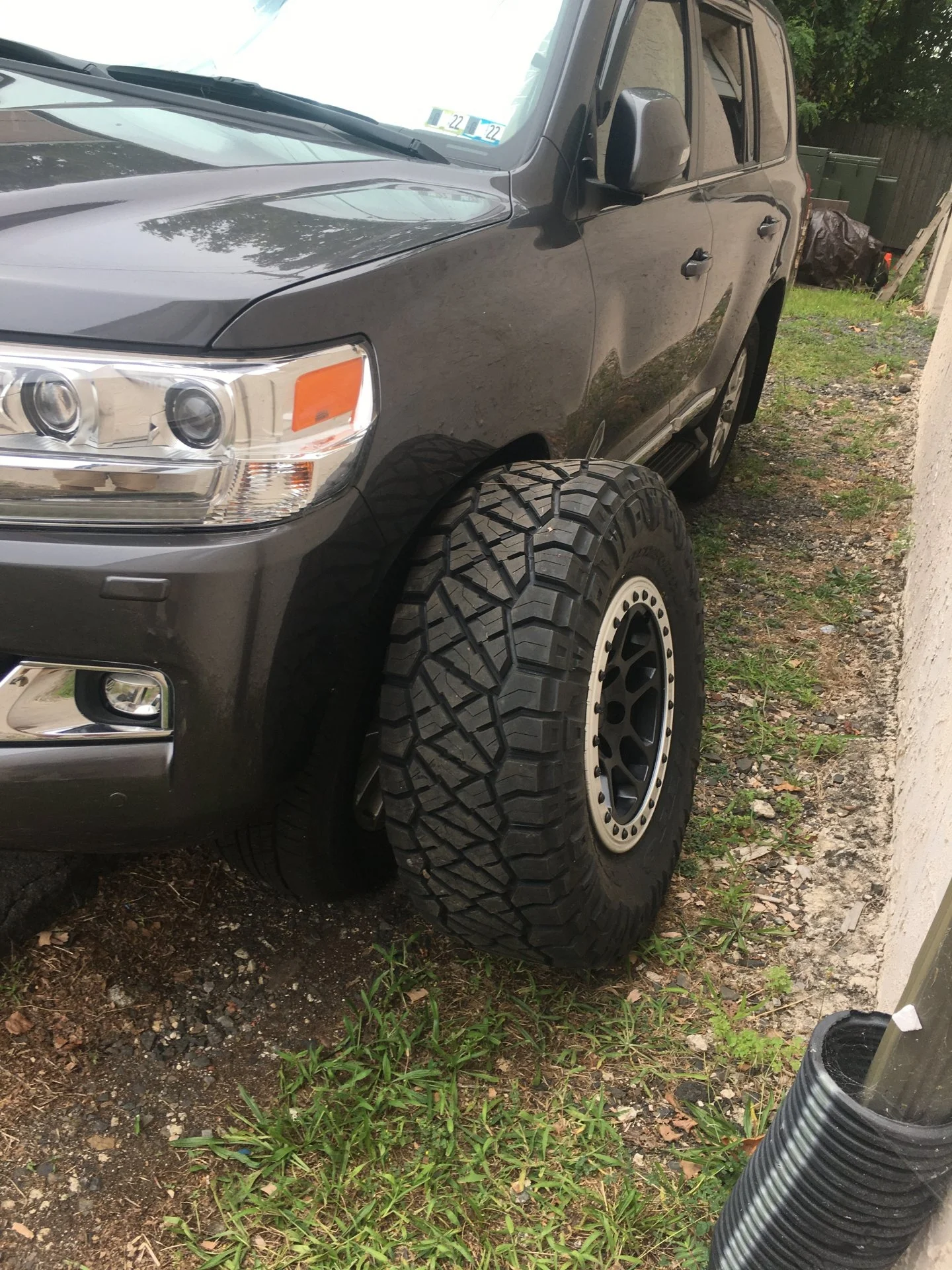

I was gathering parts for my 2019 build and was waiting on a Slee rear bumper was my biggest hold up just because I did order rear springs for the weight , OME BP51s had just about everything even had a set of Nitto Ridge grapplers 35x12.5r17
I ended up picking up another vehicle ,lets say the top comes off … I put the 35’s on that vehicle fit with no lift .

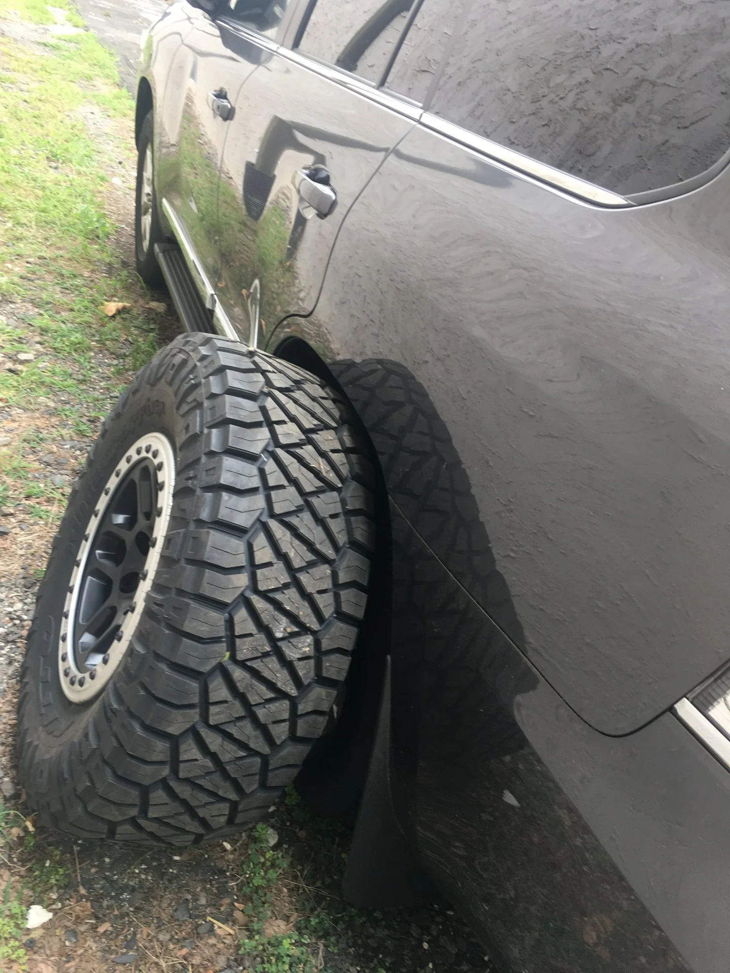

Mounting up the 35’s I got a real sense on how big and heavy they really are , mounted 110 lbs each but the Nitto 35 is one of the best tires I have ever owned .
Sizing them up next to my stock 200 gives you a real sense on how big they really are … 37’s are crazy .
@4wheelgreg congrats on your FJ40 brotha! 😝😂🤣
Coolest thing about Nitto is they now make a 38 x 12.5 x 17! Most 38's have been 13.5 that I had seen, so I think it will be a good option and I don't mind that tread design.
That wheel must be a little heavy though, because I think my 37's weight about the same mounted 😬
If you added an FJ40, well done 👌🏼 I would have put those tires on it straight away also 😉
