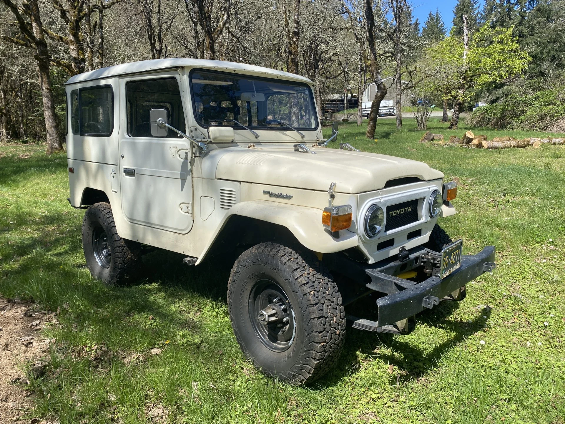

How does it feel going uphill in 3rd gear? What was your top speed on freeway before and after?33x10.5 BFG on 2.5" SOFT OME lift.

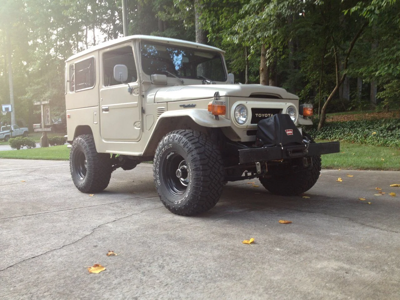

Hi! What rims do you have? Stock 15s? Thanks!With a 2.5" OME lift and 33x12.50x15, so far I have really liked these tires....

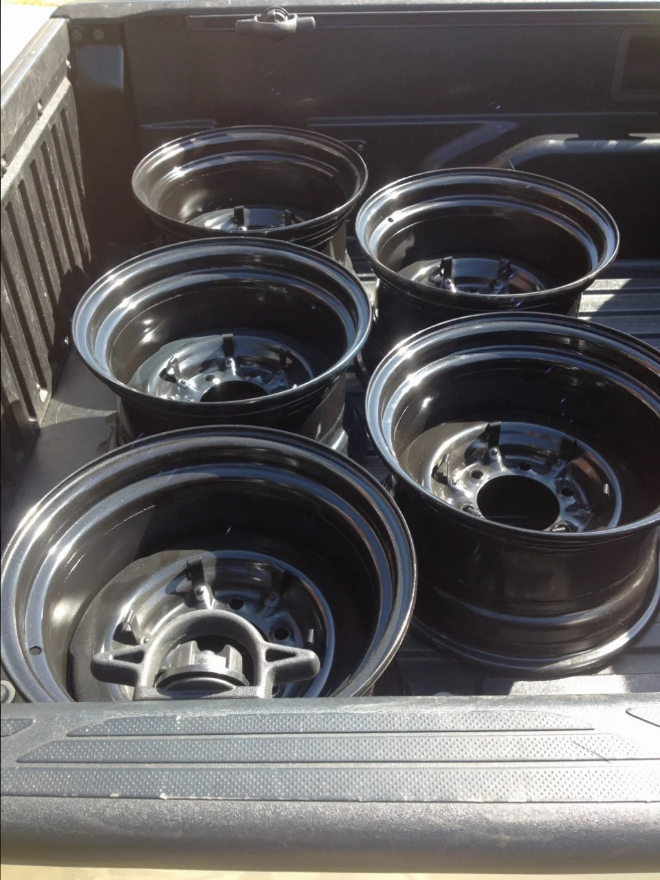

Stock, OEM rims widened out to 9".Hi! What rims do you have? Stock 15s? Thanks!
Love those! Look great. Where did you get them widened? Local tire shop able to do that?
FWIW: Jerry Robbins in Calhoun, GA did mine years ago.Love those! Look great. Where did you get them widened? Local tire shop able to do that?
