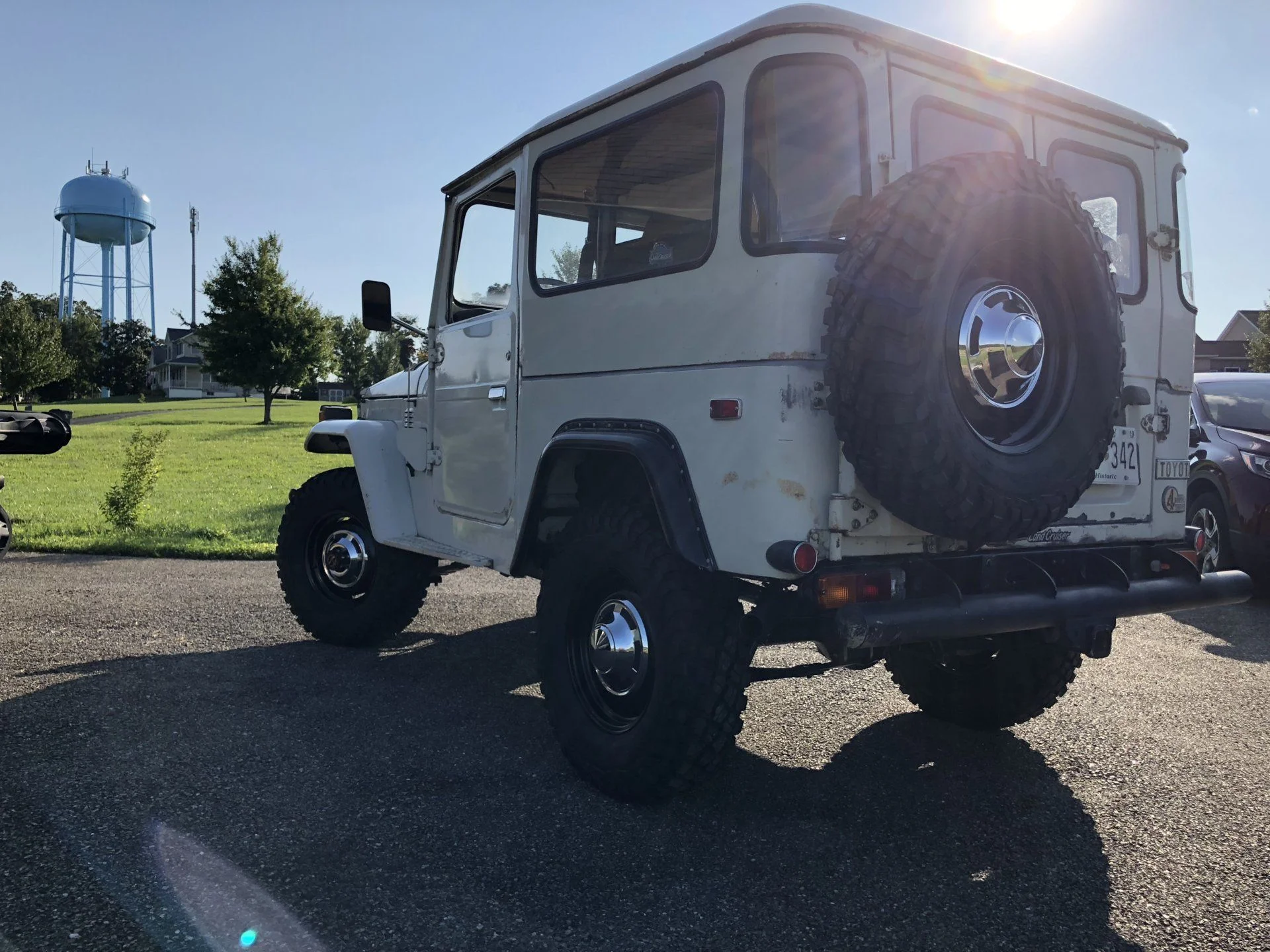

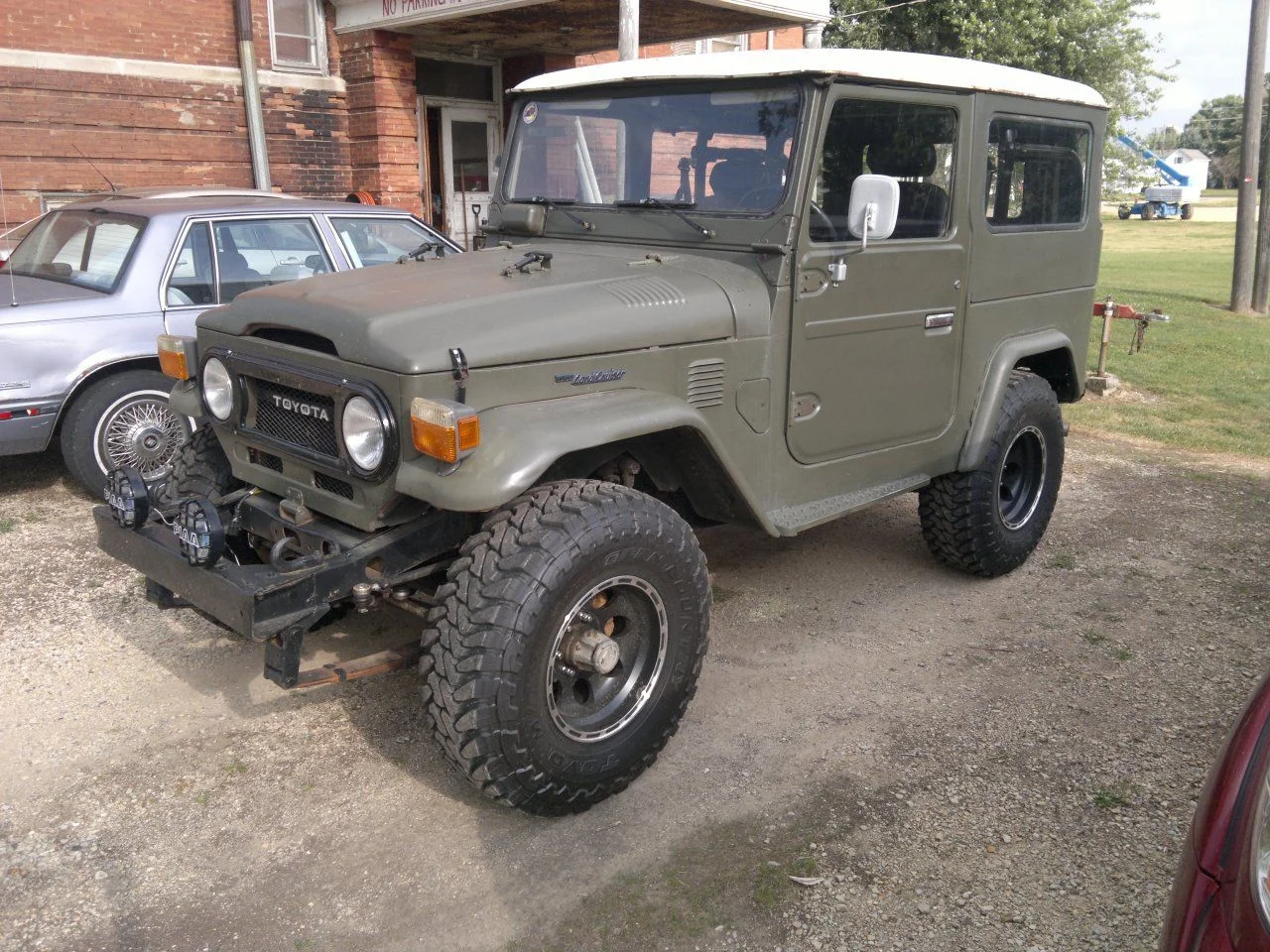

Toyo Open Country 33x10.50x15 , longer shackles and stock springs . Front axle has been cut/turned . No real run unless I flex it really hard . Love these tires , even in wet and on ice - great for an MT .

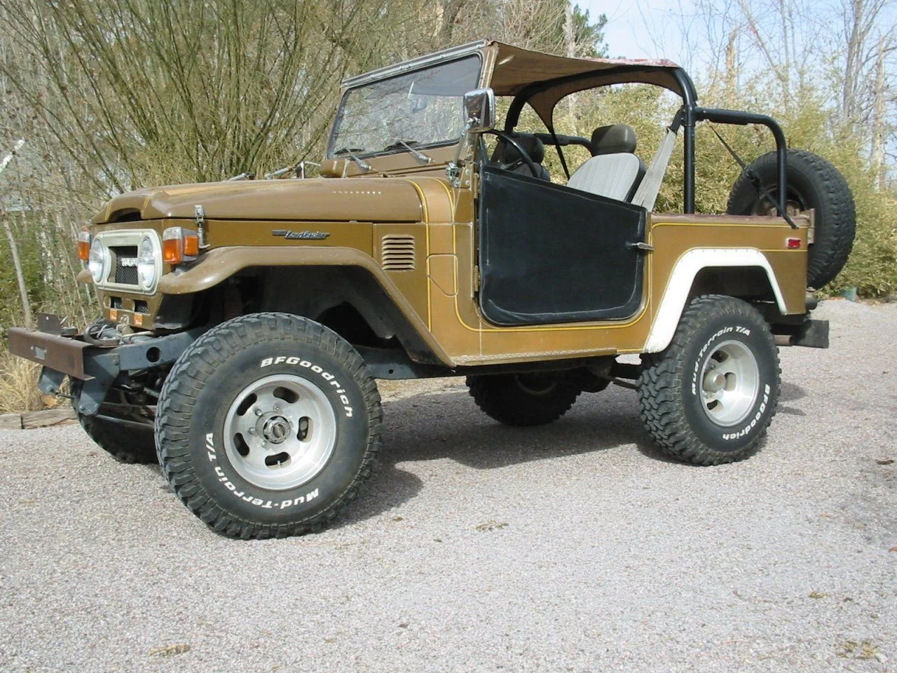

in 1973 i took my then new 73 to get tires i ended up getting 32 mudders ,they were the biggest tire at the time and i took a couple pair of aviation shears with me to cut the fenders because they rubbed just sitting there then went out and got stuck for 6 hours
lol i have 35s on 4.5 inches of lift
rubs like a bitch :flipoff2:

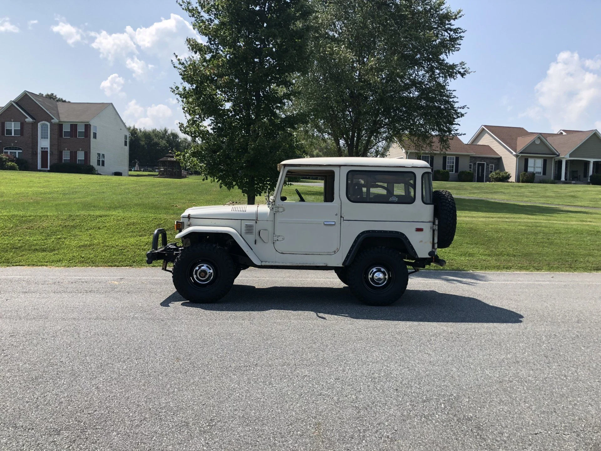

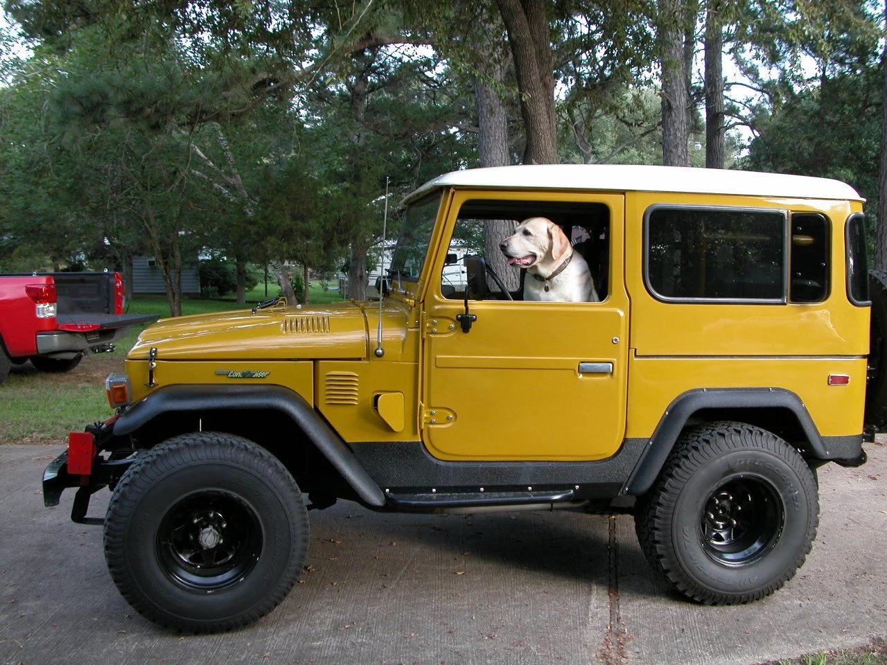

My FJ40 had 31" x 10.5" on the vintage 15" x 8" wagon wheels with stock suspension.
They had beat up & rolled over the inner lip on the back fenders.
On the more narrow stock steel wheels they may have been OK.
I'm now running 235 x 75 x 15s on stock steelies, below, they are functional but not likely to satisfy a need for big & chunky tires.
They measure just under 29" dia.

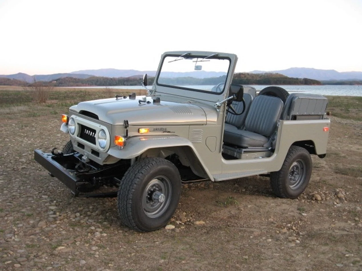

Good looking truck there, Cleg.
You've got close to original sized tires. I think they came with 7.00 x 15 bias ply tires and changed to H78r15 when radials appeared. Yours are probably a little wider than the bias tires but about the same as the old H8's.
Except for a few details (black mirrors and hood latches, Warn hubs..) your cruiser looks like it jumped off the page from the early 1960's ads Toyota ran at the time.

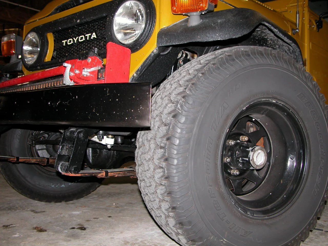

If you plan on doing a fair amount of highway driving the 33's are nice for the extra rubber overdrive. My 45LPB has 33/10.5 all terrains and it cruises right along comfortably at 60-65mph with the 50 year old stock F engine. My 40 has 31/10.5 mud tires and is a decade newer and is much happier at about 55mph. 31's are on stock suspension. 33's fit with an extended shackle and castor shims to correct pinion angle.
