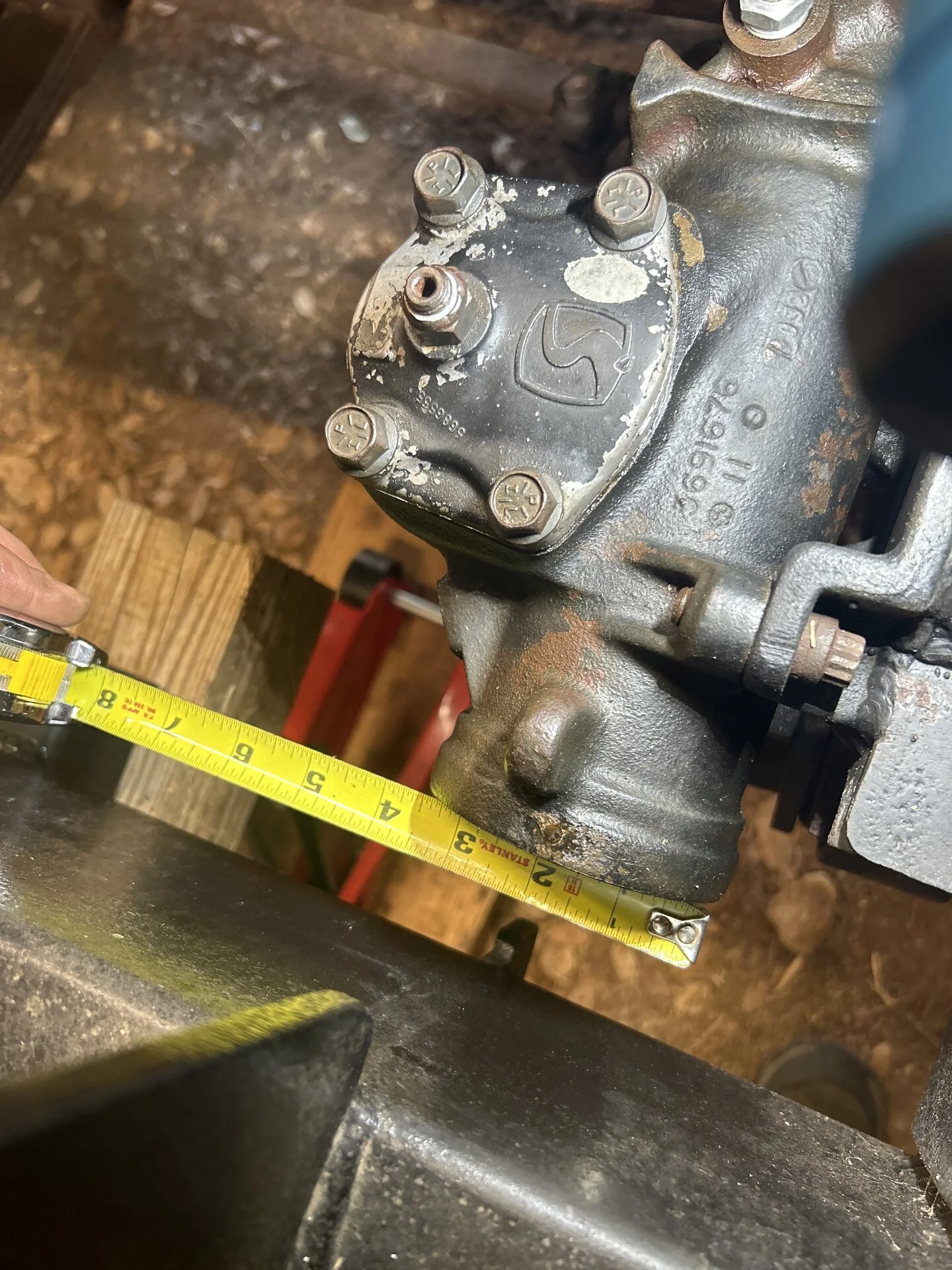

Anyway, that was a very long winded way of sharing this picture of my original 4 turns part number:
My number is the same as above and it’s a 3.5 turn. From what I’ve read, the best way to tell is turn it at the store before you leave
