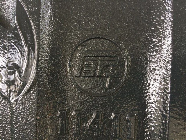

Got most of the tape off the painted parts.
About 4 areas need touching up. But happy in general with the finish. Will let it bake in the sun for a complete day before i start assembly.

So left the parts bake in the sun the whole day. Moving them around to bake all the sides.
Peeled any flakes that didn't attach to the metal, cleaned , sanded and touched up with a brush. Seems to have worked.
So that's paint over thank god.
