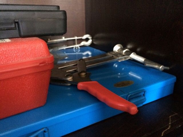

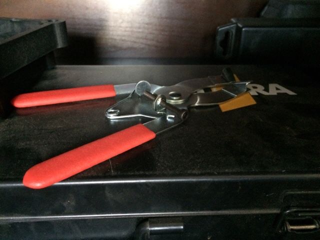

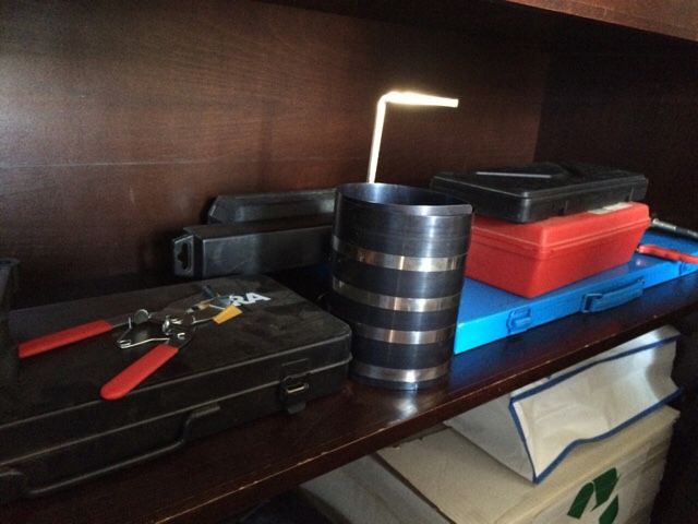

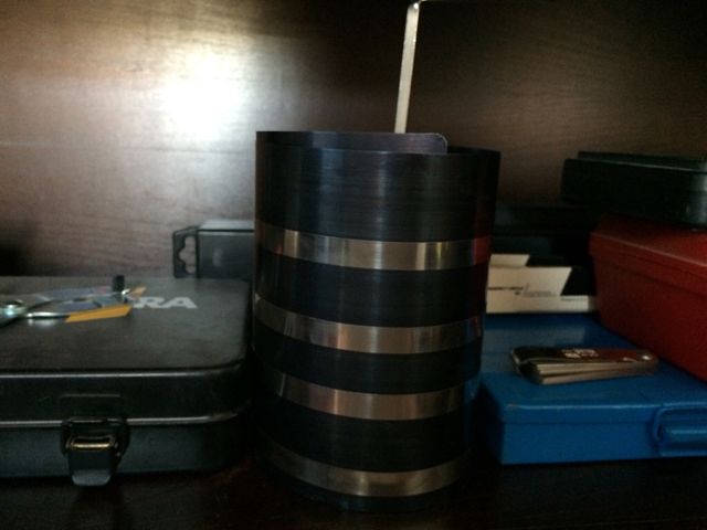

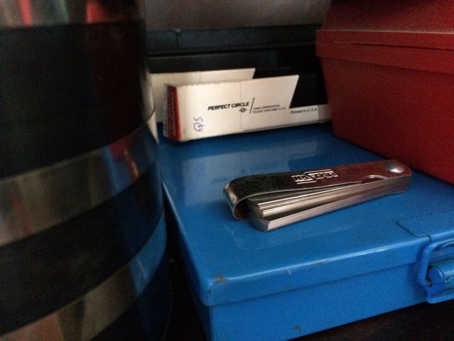

Tools that I'll be using for the build
Will post more pictures on each tool as I end up using them.

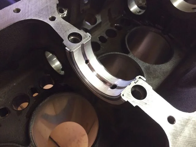

Torqued everything to the first torque pressure and then to the second torque pressure.
The plasti gage Can't read it to save my life :))))
They are all the same. What's the reading?
