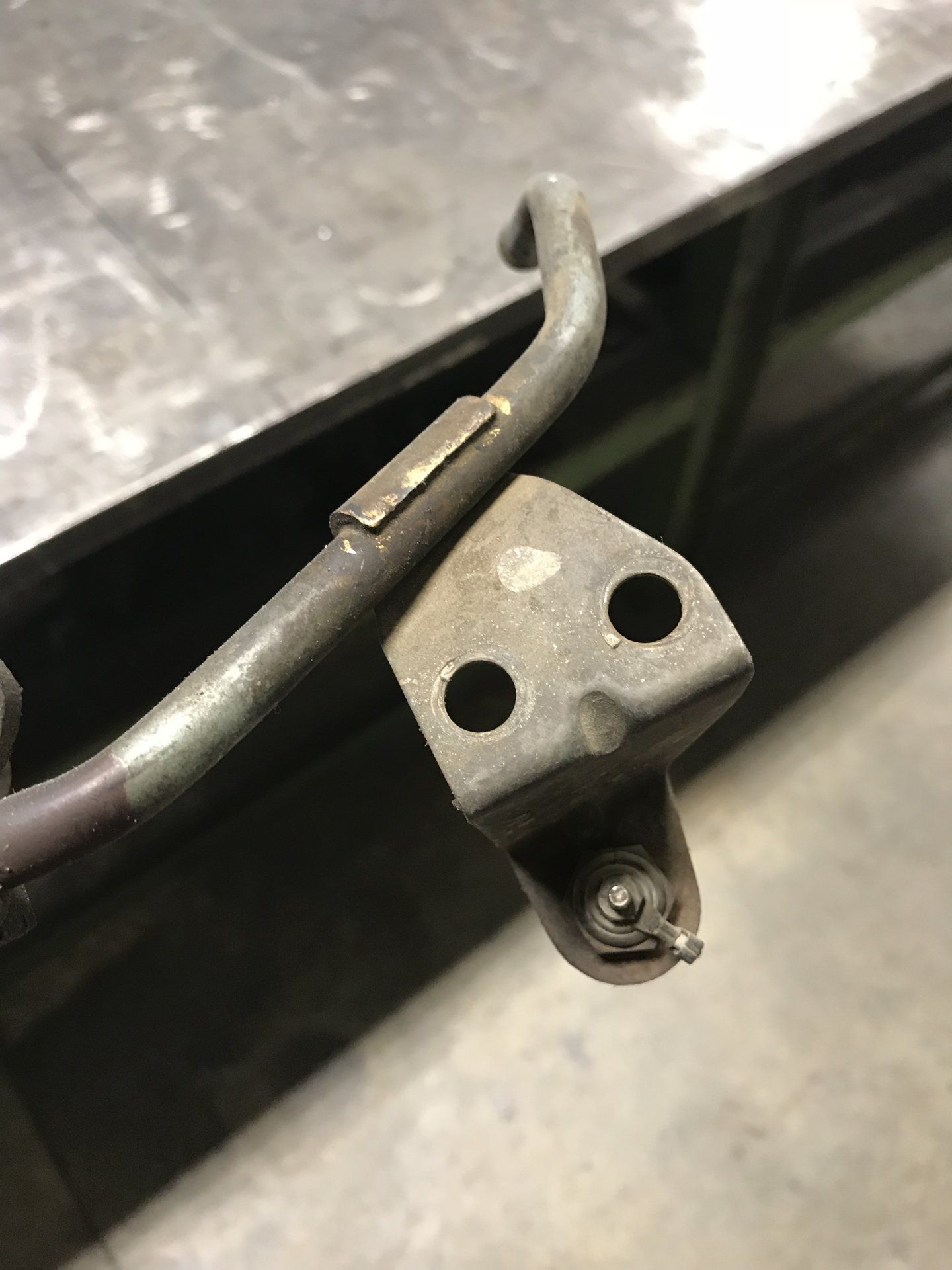

I found this in a box. It doesn’t happen to be a temp sensor does it? It’s pretty small, think quarter sized.
Cut it off the pipe. Use two bolts to add it to the two threaded holes on the intake. The cable will need to be attached to that tiny threaded end. To wire it, you’ll need a piece of bicycle cable, choke cable (I replaced mine so used the junk one), or some sort of insulated cable. Regular wire will fry pretty quick after a few cycles.

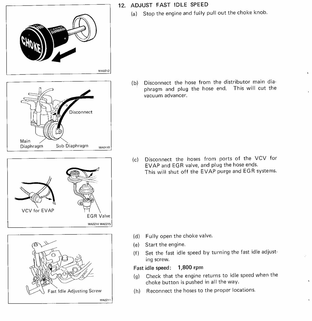

Furthest screw out on the facing right of the carb. Pull the choke handle and get the RPMs to 1800. That’s it.
No instructions. Just a video emailed on the otramm lean drop method of tuning.

I’ll have to find some cable like that. I may temp wire it just to get it working though till I can find some.
So once I do this and bring the engine to 1800, what do I adjust the screw to? Until I misadjusted the screw yesterday (with cars driving around me) I didn’t even have to touch my choke to start it. It didn’t even hesitate to start.
