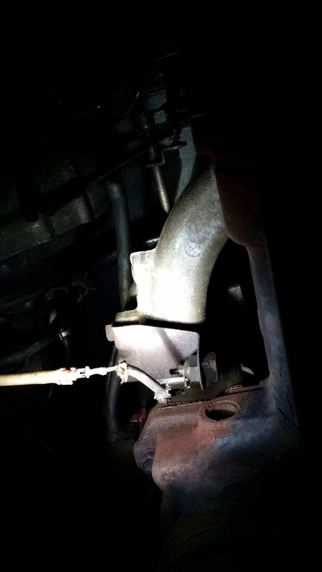

The sensor for your carb fan is under the exhaust manifold. Closer to the firewall. If you get under the truck and look up you may see it. All that may be required is connecting the wire. Attached to the sensor there may be a short piece of wire with white jacketed insulation. I'll take a pic of mine in the morning for you.
It's possible that your timing is still retarded too much if your engine is overheating when you stop it, or you are sitting at a light and notice the temps rising.
For now for the carb fan, add a few inches of 18g to as clean a stretch of what’s there and ground it to the fender. It should come on when you shut the truck down.

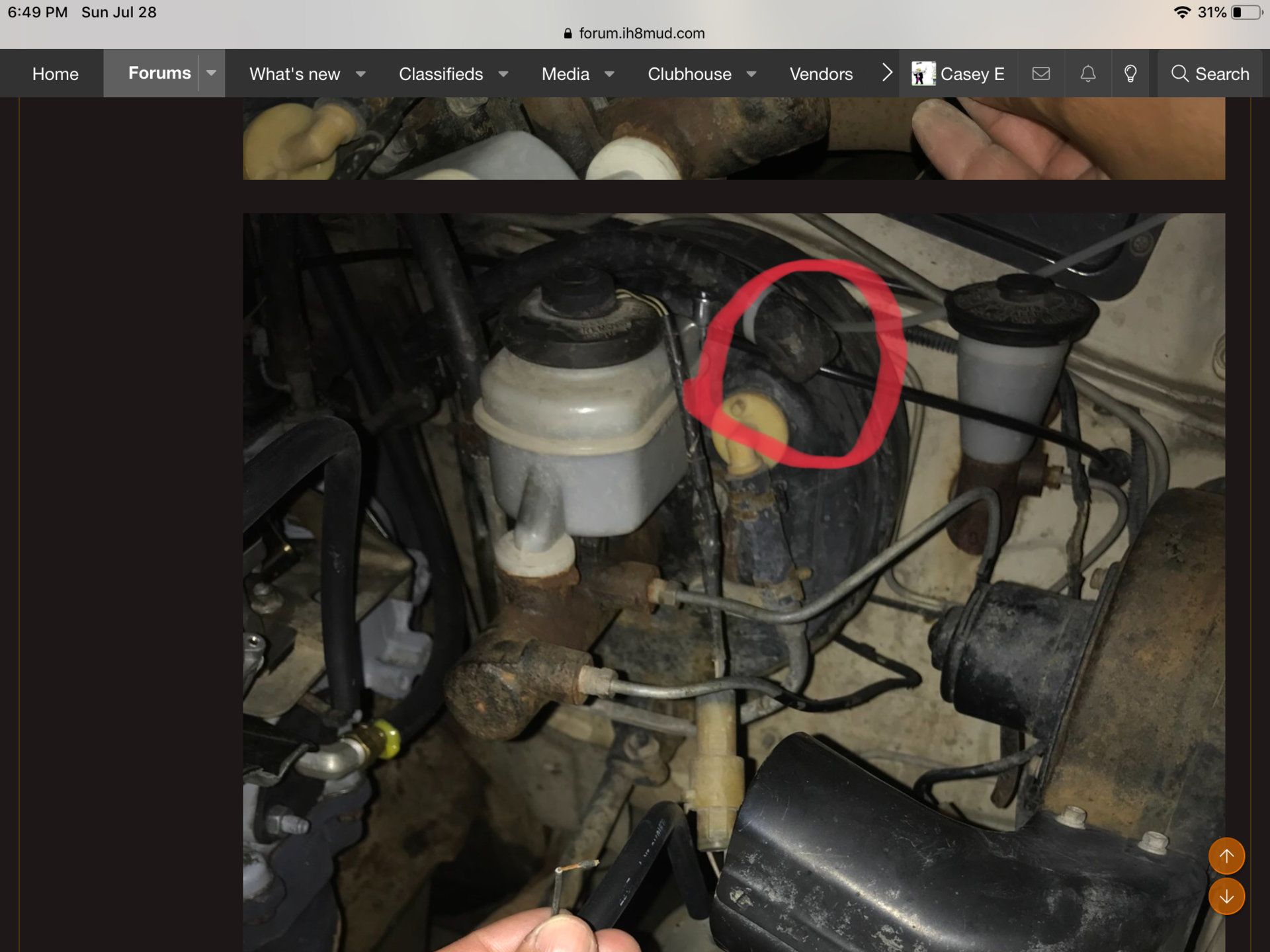

Not sure what you have going on here but this could be the issue if it’s leading too the intake.
I'm guessing the dieseling or run on after cut off is related to the rich condition

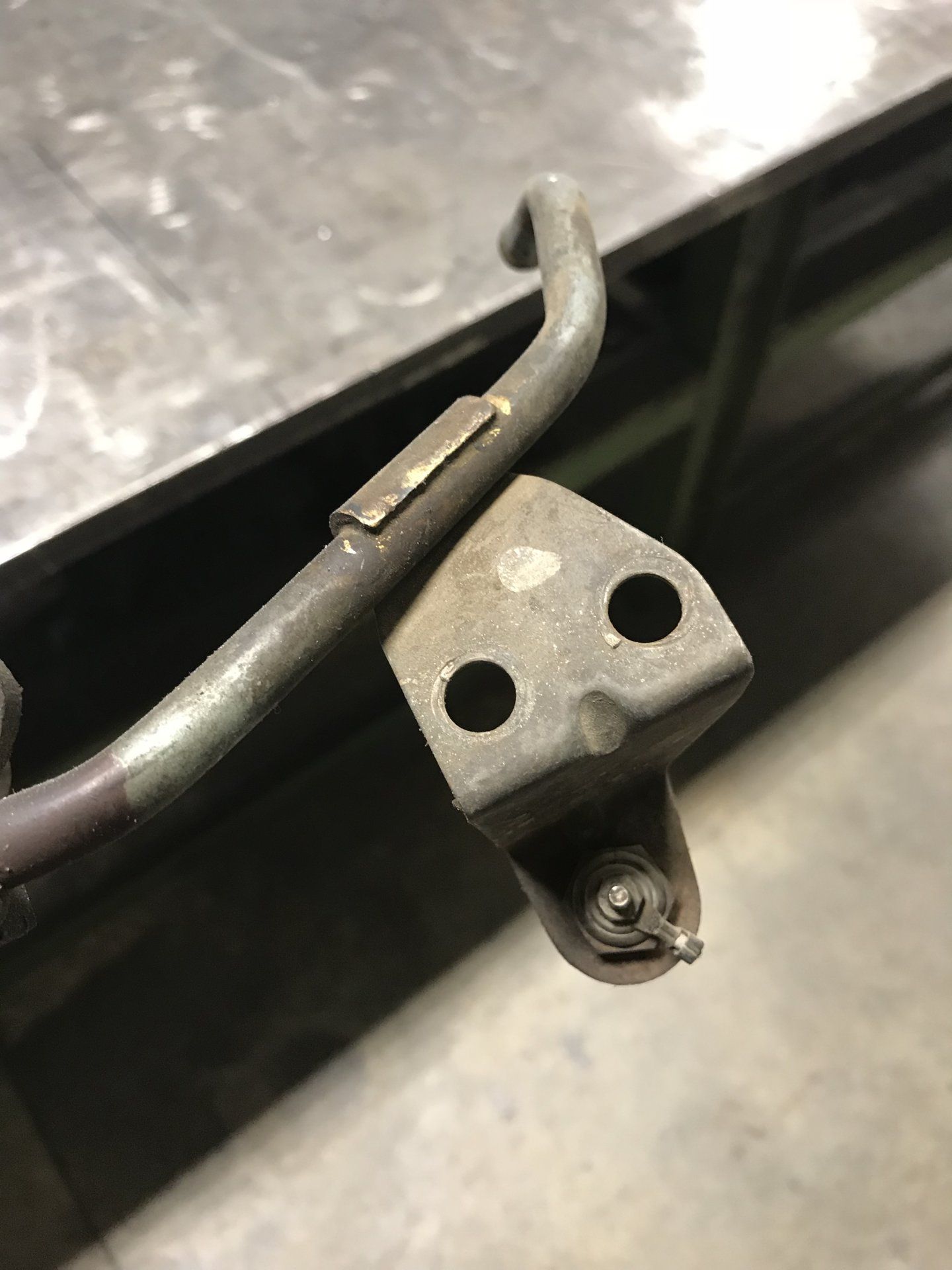

I found this in a box. It doesn’t happen to be a temp sensor does it? It’s pretty small, think quarter sized.
Thats the temp sensor for the carb fan. Bolts to the intake manifold. Just need a small bolt w/12mm head on it. that is the pcv hard line that goes to the side of the intake. Just cut it off the pcv line and bolt it to the intake.
So this sensor just needs to be close to the manifold when mounted.
