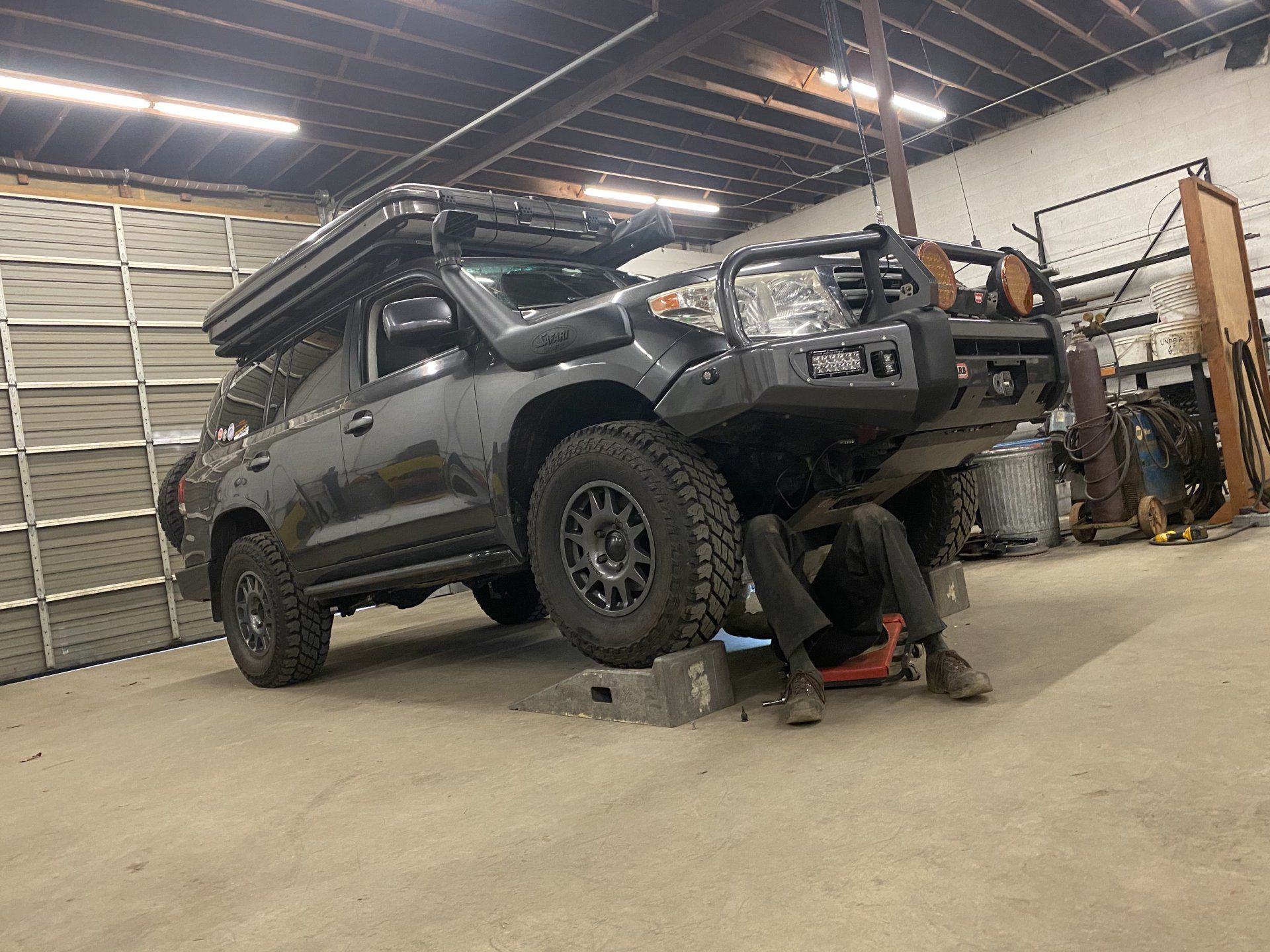

Also, don’t forget if you stay with stock 60mm offset, you will probably need spacers for 34”.
I believe the Evo Corse that jrmudder runs is the dakarzero 17x8 with 40mm offset, which, according to @TeCKis300 from a different thread, should be just about perfect for the 34s. @jrmudder92 is currently running Cooper St maxx 285/75/17 which is just shy of 34 inches (33.8). I’m going to get a look of it in person on Monday, along with the rest of his rig!! While jrmudder is there, I’m going to talk to my parents about possibly buying his set.
