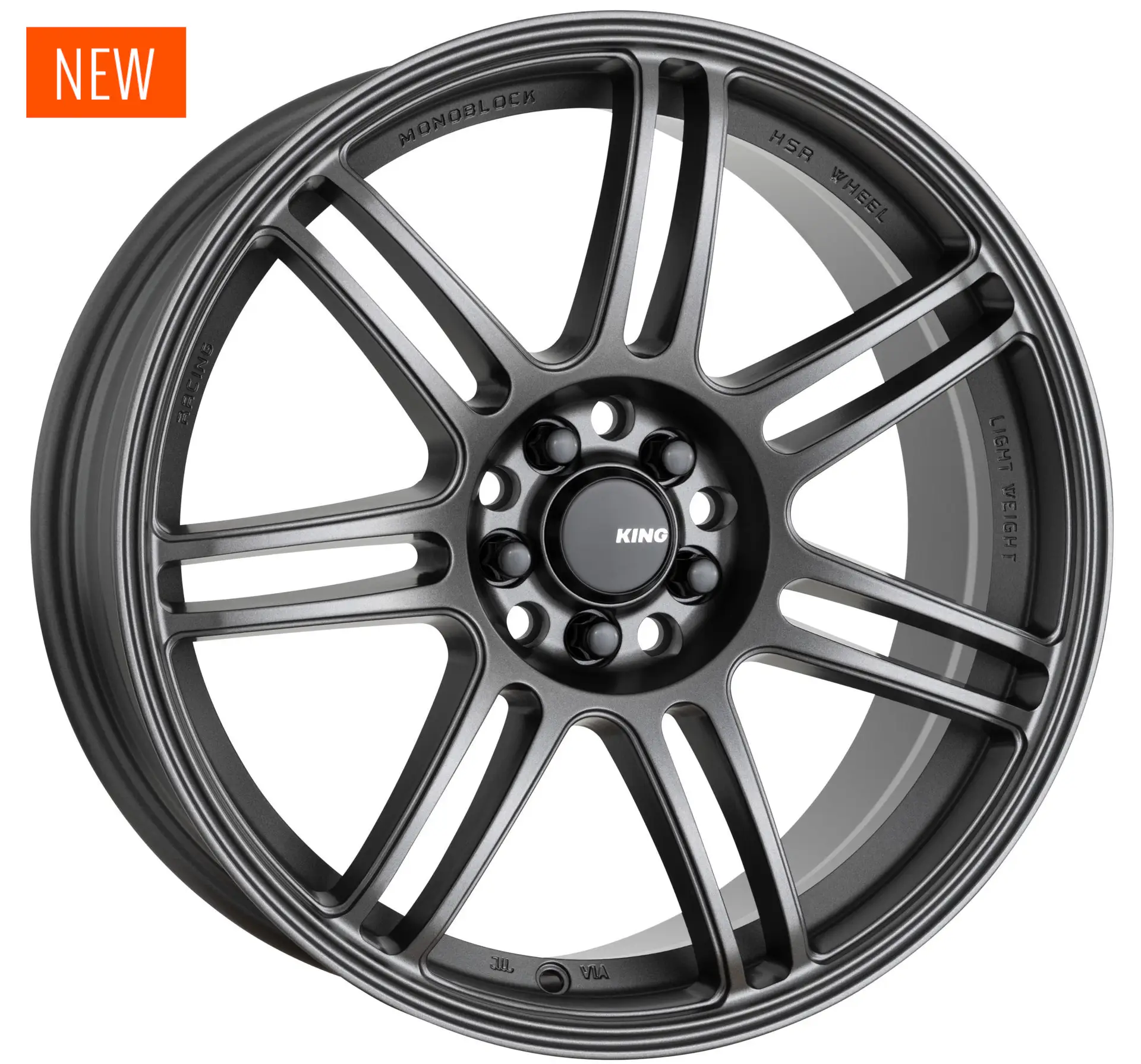

From Kings, which i believe to be a rebrander. I will have a catalog for you guys with exact specs available. For reference.
This is pre production, where we are allowed the most flexibility. They mostly care that we get enough to fill at least 1 20ft container (about 530 17x8s without beadlocks and less if beadlocks involved).
Basically, they will send me an order form and i just put a quantity next to each one i want until i reach a full container. Then i put down a deposit, they produce what isn't already available and then ship it all out at once. Thats my guess.
