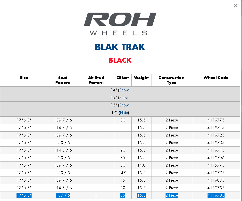

As far as weight, i will have to ask the manufacturers/wholesalers for specifics for each, but here is one of the ones i am eyeing for reference.

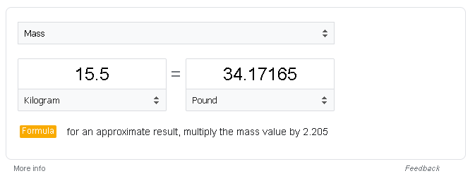

34 lbs, so it's actually even lighter than my current stock 20s! Just another daily reminder to trust the Grinchy. XD

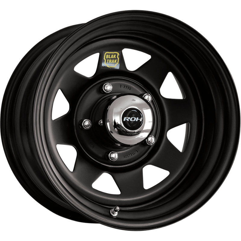

I think this style: 17x8 5 Stud Black Thunder Steel Rim 5/150, +30 suits Landcruiser 100/200 Series Pattern - https://www.huntsmanproducts.com.au/collections/17-inch-steel-wheel/products/17x8-5-stud-black-thunder-steel-rim-5-150-30-suits-landcruiser-100-200-series-pattern
Or the BlakTrak ones in your previous post are the ones I like best.
I think +30 offset is about perfect for the LX.

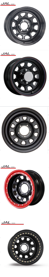

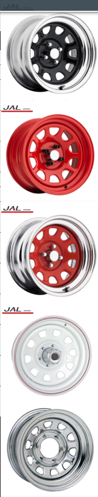

So i'm definitely starting to notice a pattern: either everyone is making the same pattern/style or everyone is getting the same ones from China and rebranding them.
They are all the same design as that one from huntsman, and the only noticeable difference is that they range from +30 to +40 offset. Also the finish on it can vary (different shades of white, black, matte and etc).
This is basically the options from every manufacturer, at least for "17x8 5x150s with about ~30 offset". The triangle pattern is sometimes called a "Sunraysia" style i think, then theres the "D" pattern that @tbisaacs mentioned. Can anyone explain this? Or are the claims that one is engineered to a higher standard than another all bogus?
Basically, do i need to only look at China as suppliers, or is it a coincidence that the Australian ones look exactly like the Chinese ones, as well as look exactly like all the other brand's wheels?

This is what i am trying to decide on at the moment, so they can send me a sample set. That size is available for everything shown in images (minus the first option for fake beadlocks).

Confirmed bore can be brought down to 110 for the bigger order after the sample. Is a 113mm center bore sample going to screw me? Should i just skip the sample then? Also, these are a little more heavy at about 36 lbs (16.5 kg) and the beadlock is closer to 18kg as of right now. They did say that they can custom make some that are 15.5kg to match the other wheels if we wanted, but there is a minimum order for that.

Here's a glimpse. I will share the catalog as soon as i settle on a manufacturer.

This is every model available for the size we requested, from JAL anyways.
17x8
5x150
110mm bore
15.5kg per wheel for non beadlocks (can be heavier if we'd like)
+30 offset
