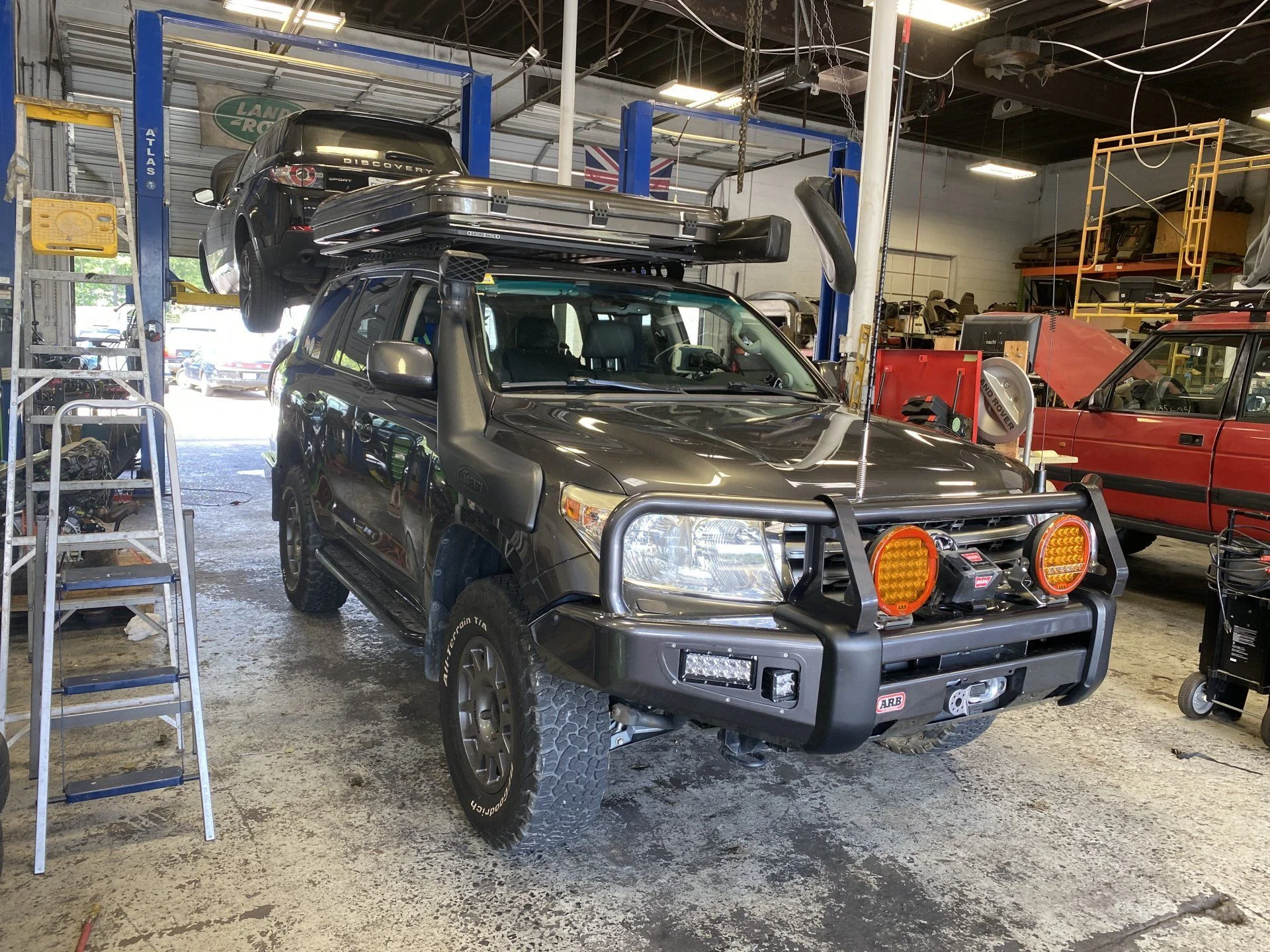

Well I sold my Lexus lx470 (white one) and made the jump to the 200 series back in July. Been kinda lurking absorbing information. I’m 100% satisfied with the change. Getting the bigger v8 is great but going from a 4 speed to 6 speed transmission made the world of a difference. I have no real complaints with the truck. The only big one is no one has made a part time kit for this.

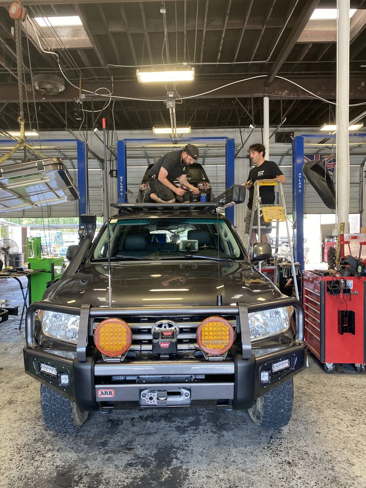

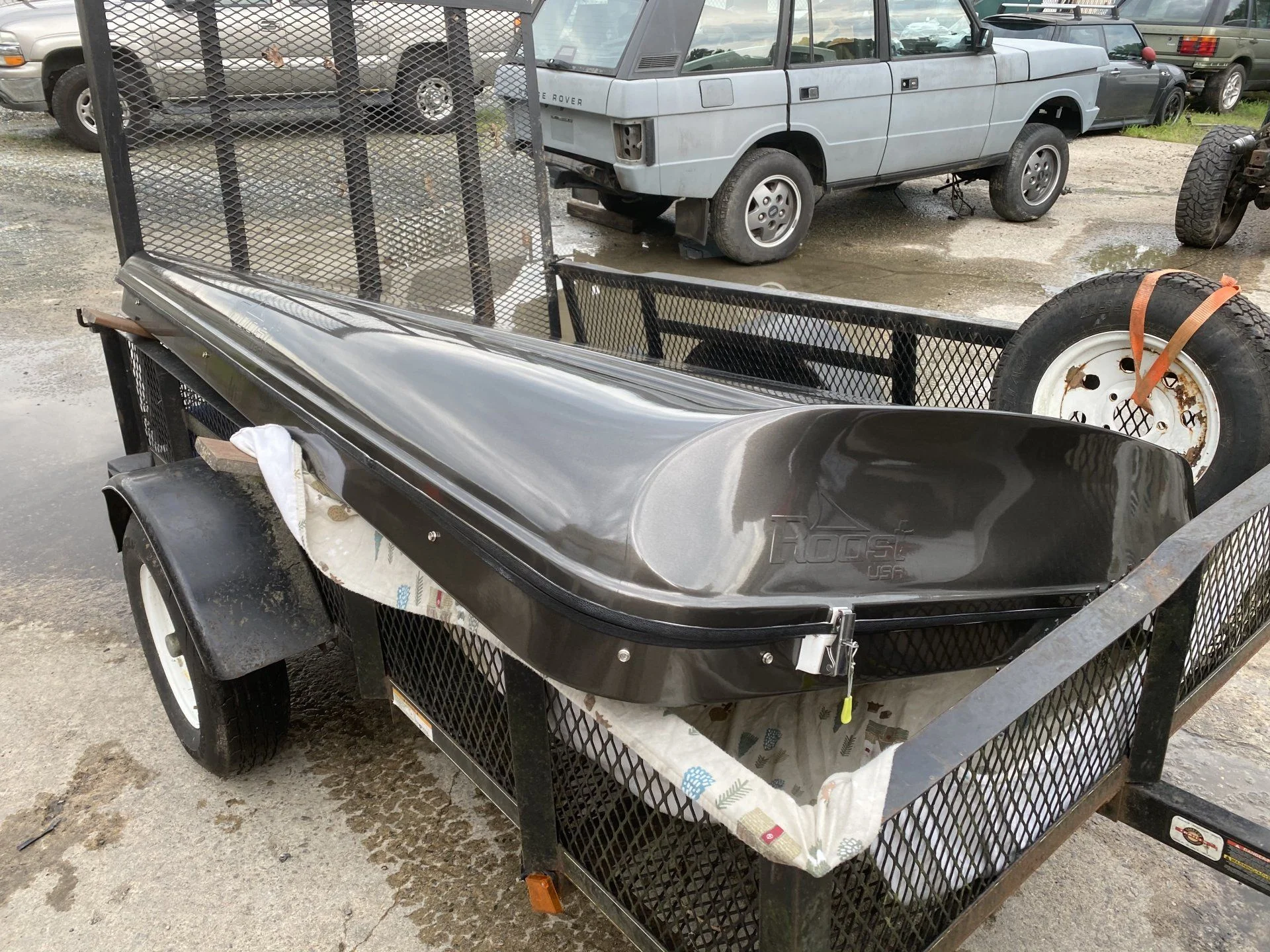

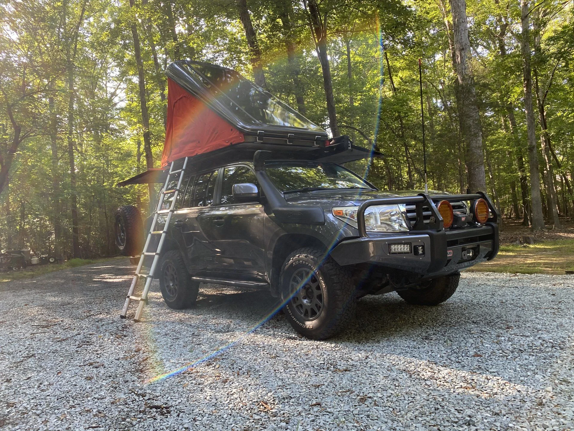

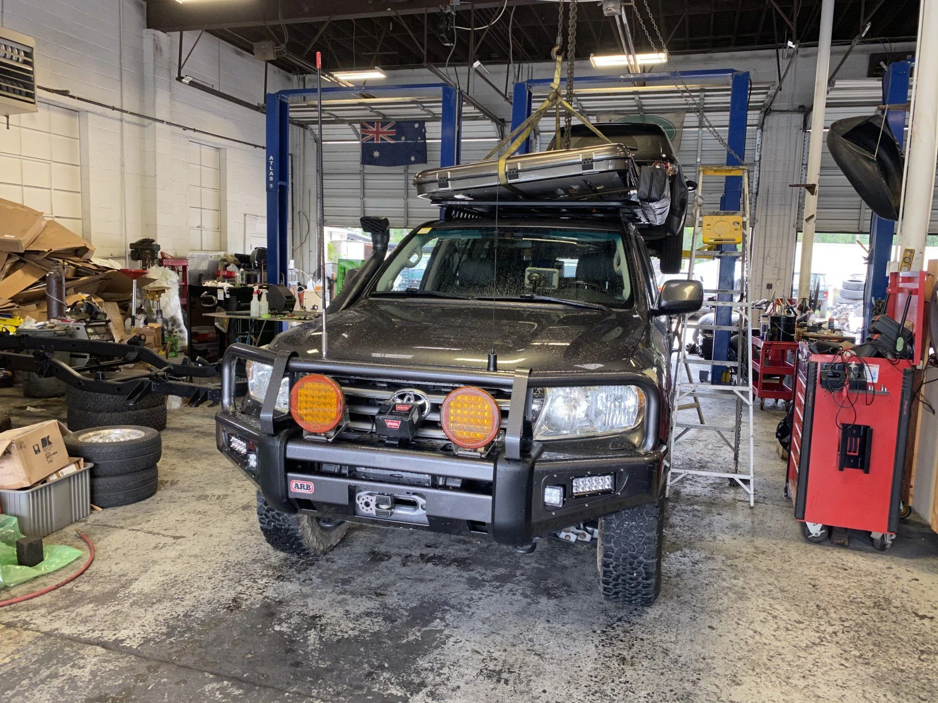

First thing we wrapped the tent the same color and mounted it
Welcome to 200. I know that truck! Congrats on the purchase!

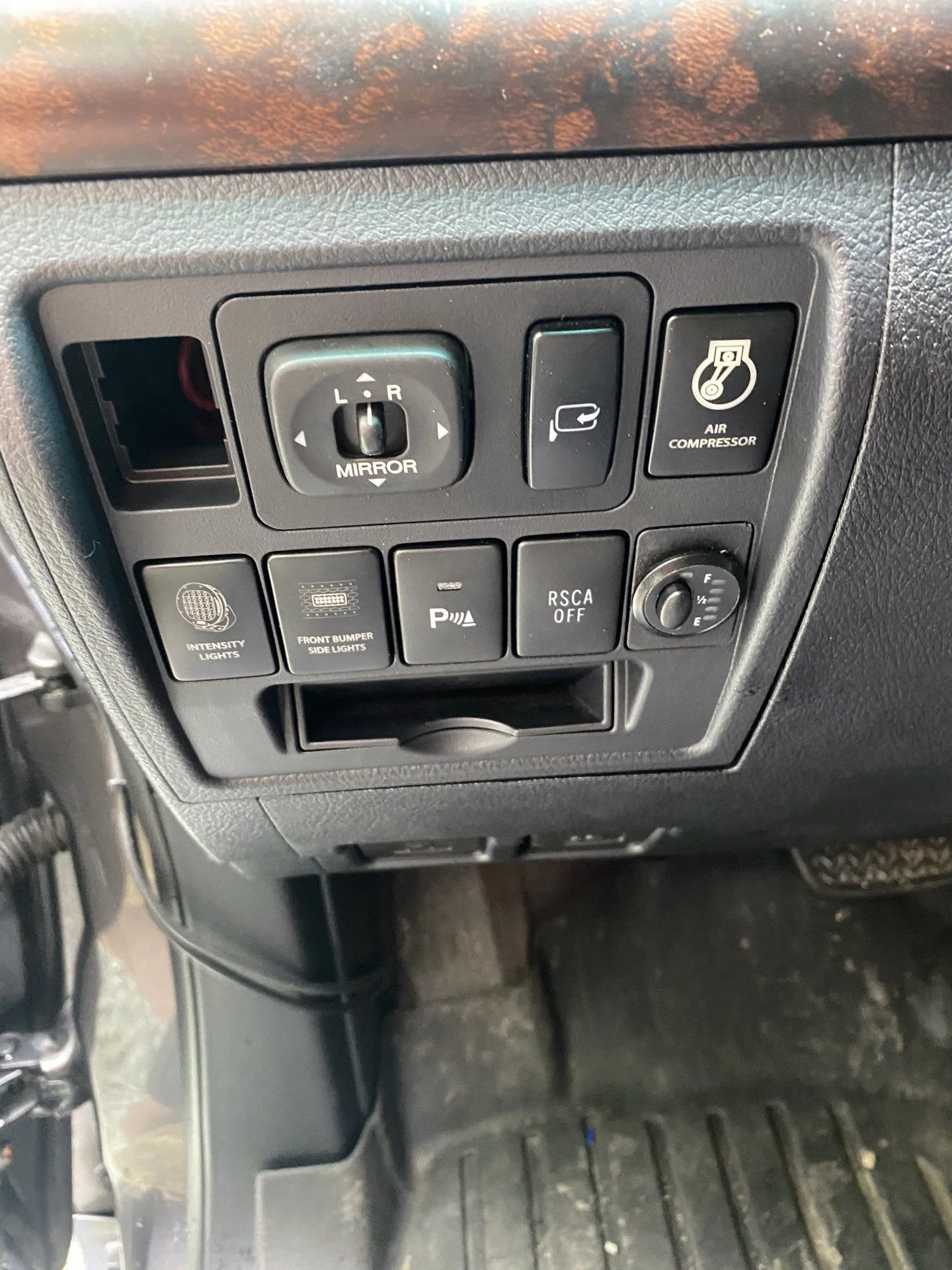

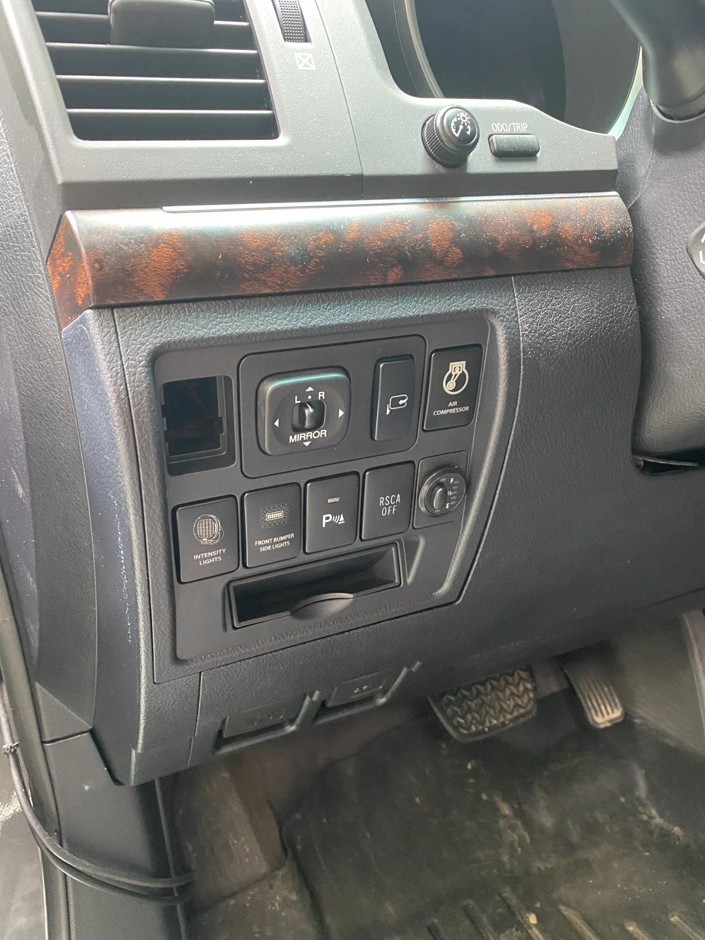

Cleaned up lot of wiring. Made everything look factory.

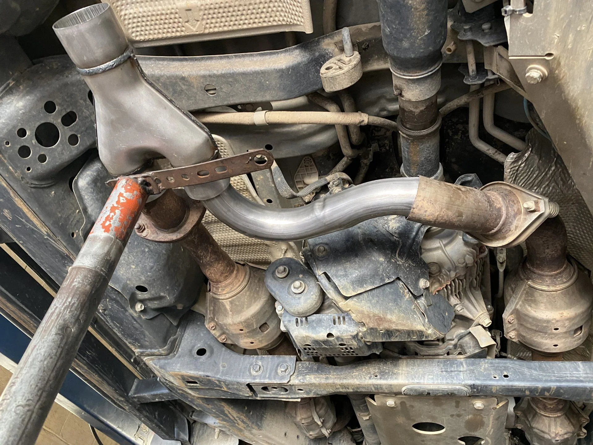

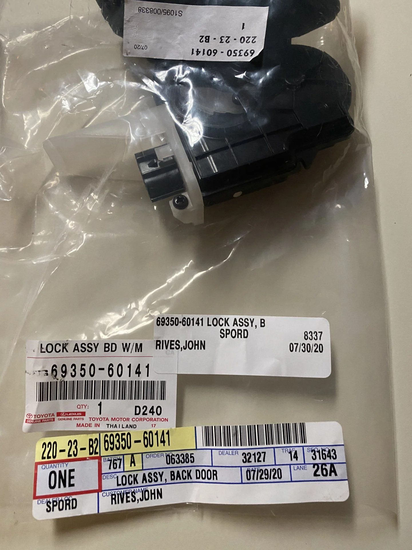

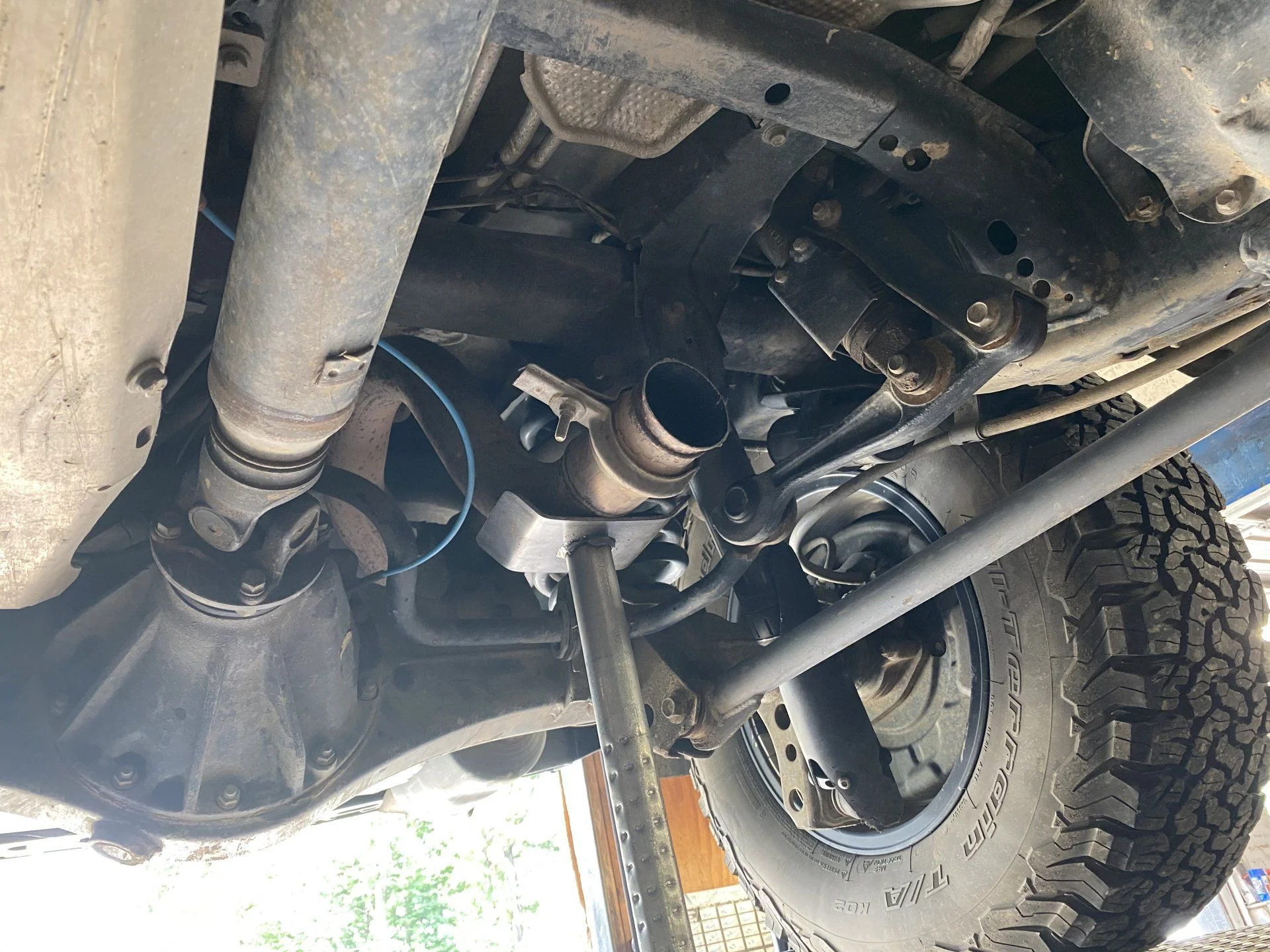

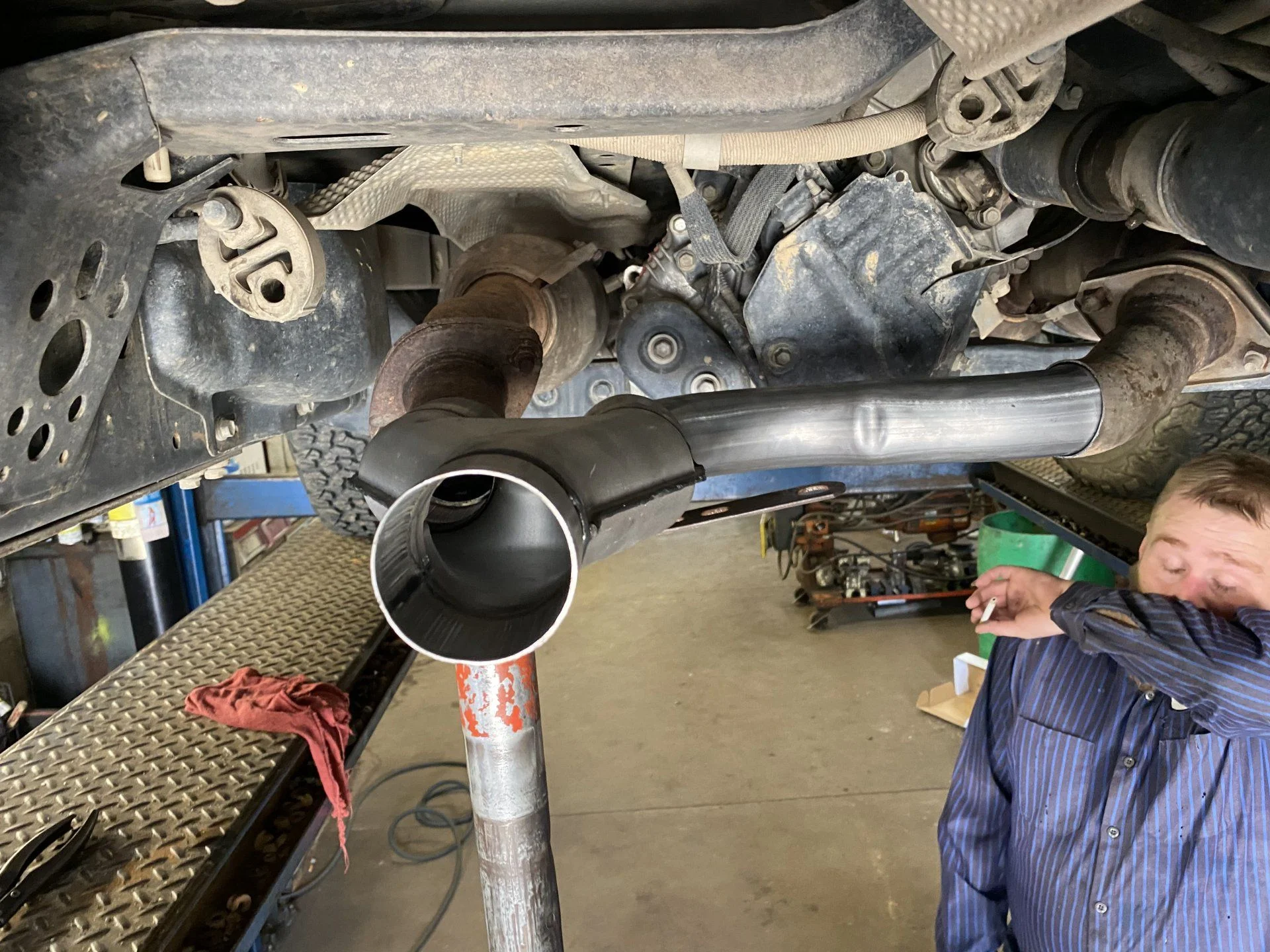

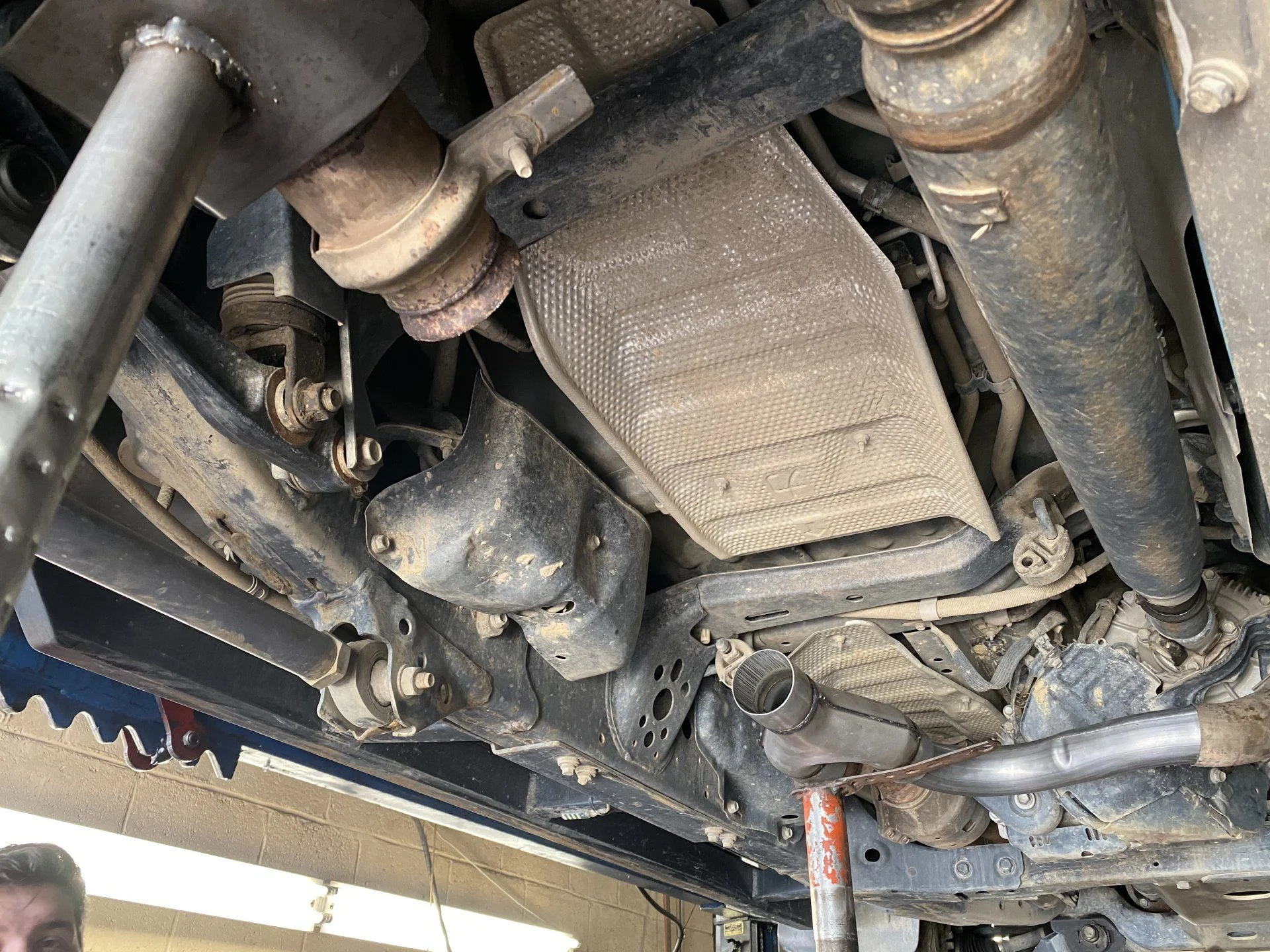

Had to replace the the rear hatch sensor thing. Also exhaust.

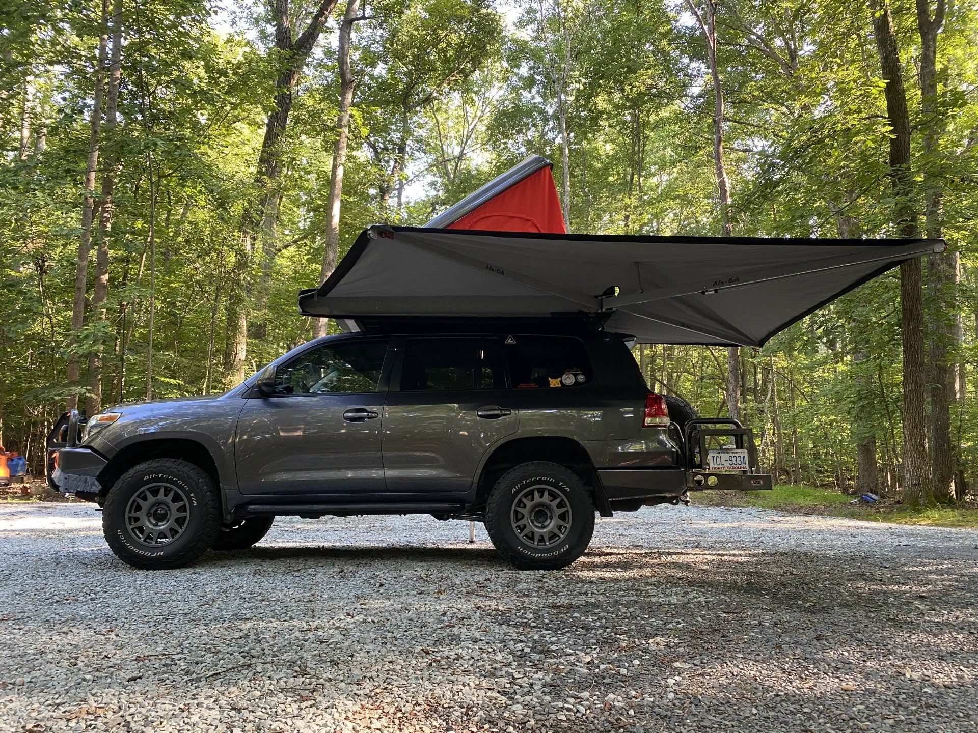

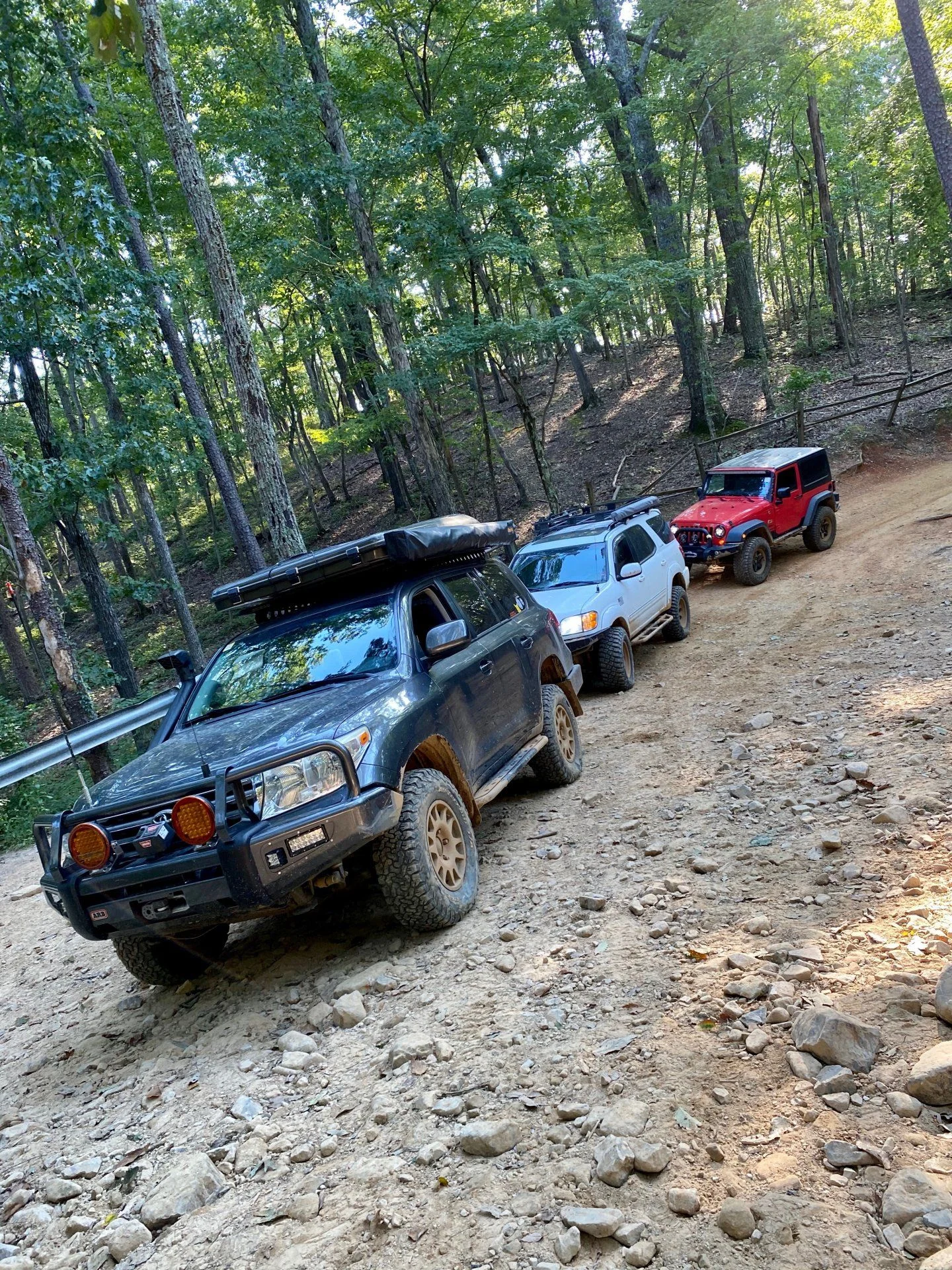

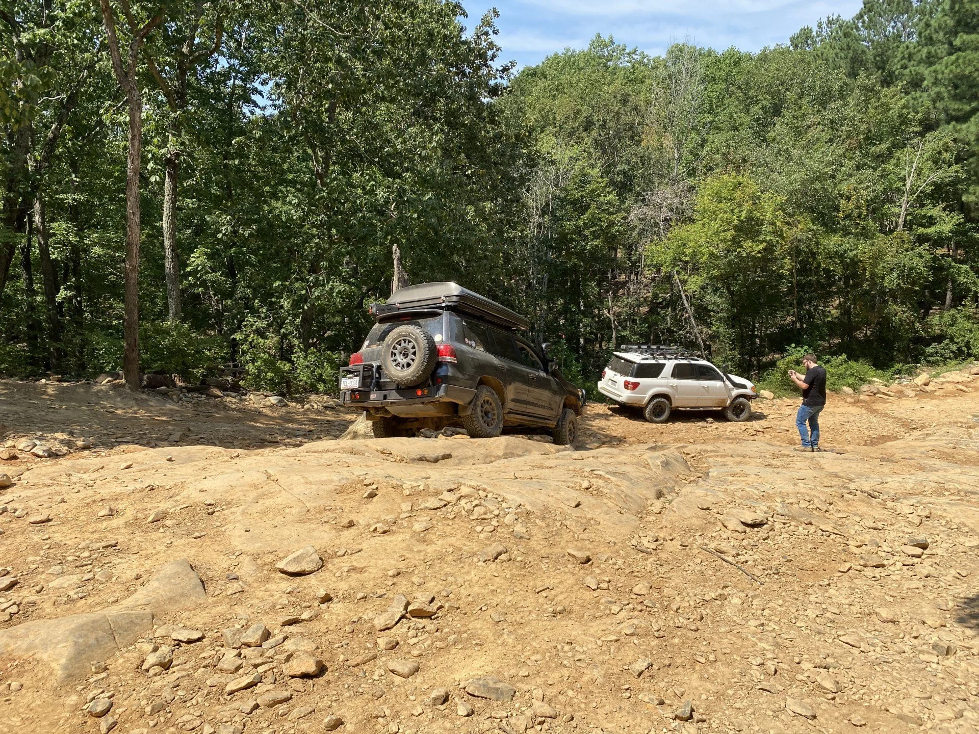

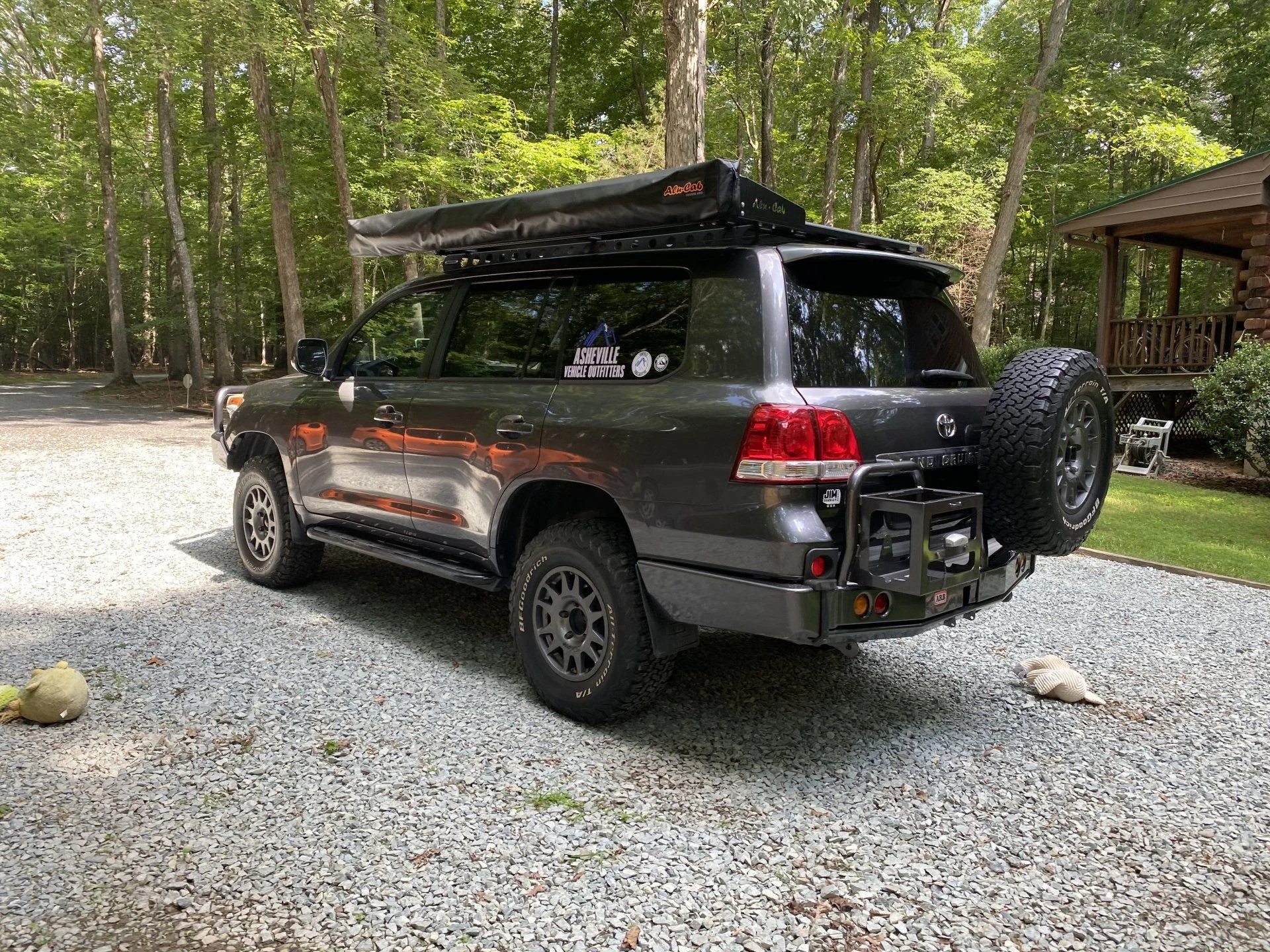

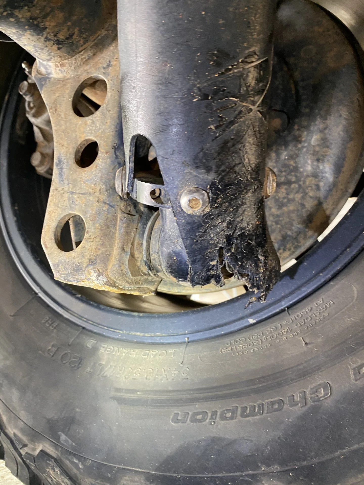

My first camping/ off road trip. Was a huge success. Definitely different wheeling this then the 100. But we made it new bumps and scrapes but definitely worth it.

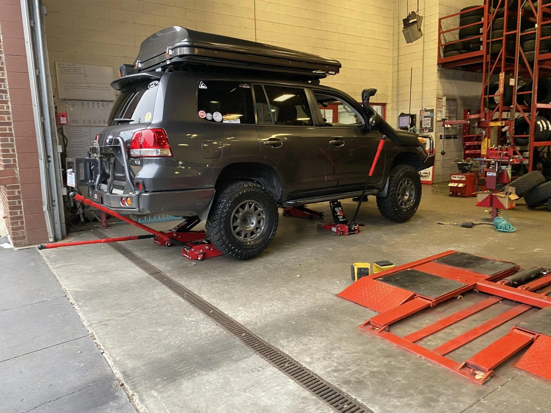

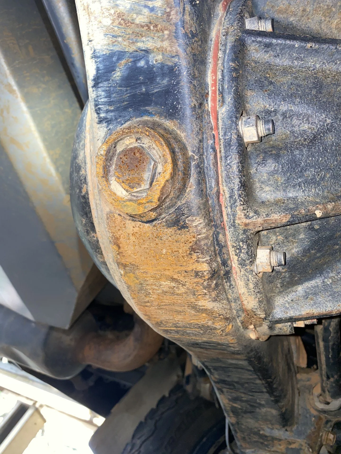

Oops just some rash. And a tire. Gotta pay to play

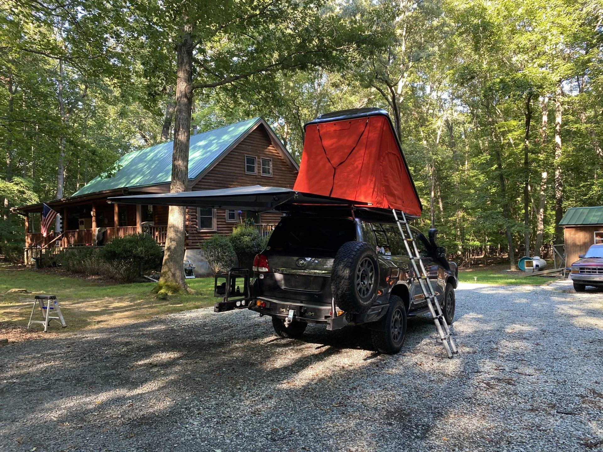

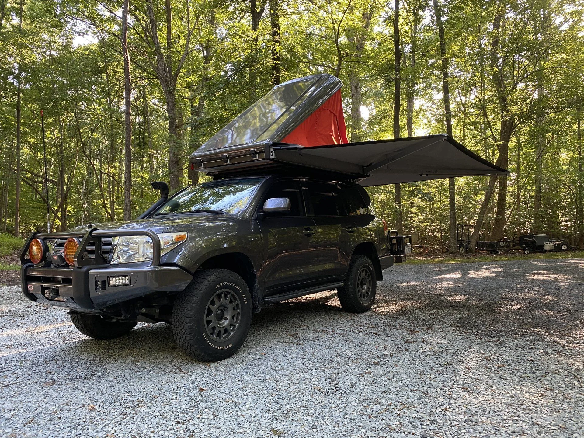

Here’s everything set up.

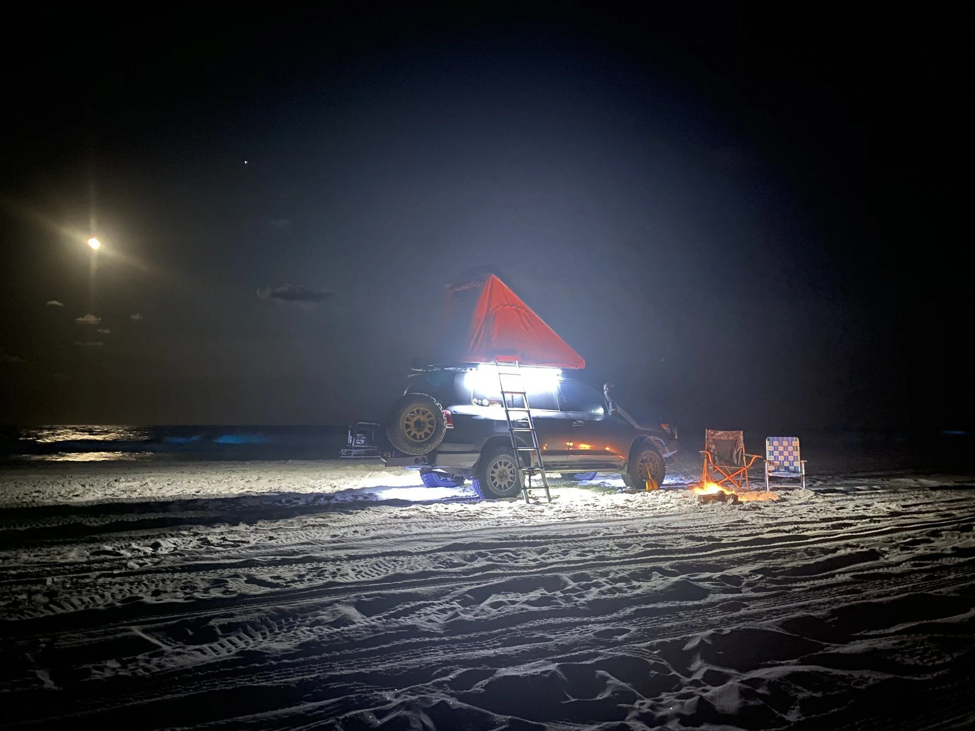

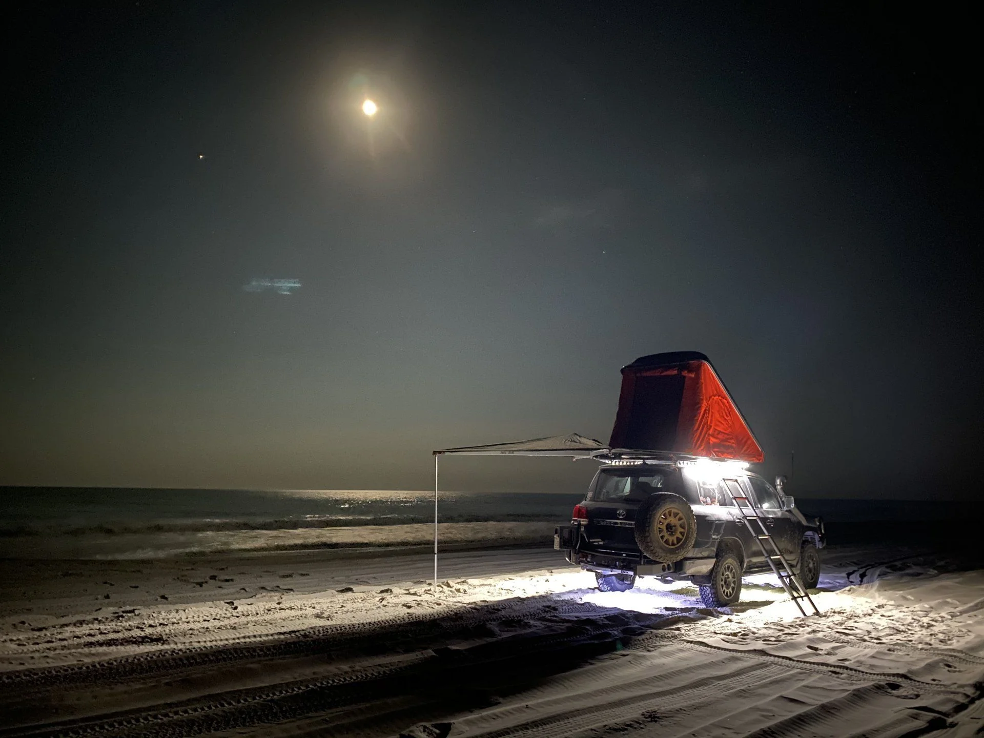

This past weekend went to obx and camped. What an amazing trip put almost 1k miles on her.
o_O Not supposed to get these trucks dirty!

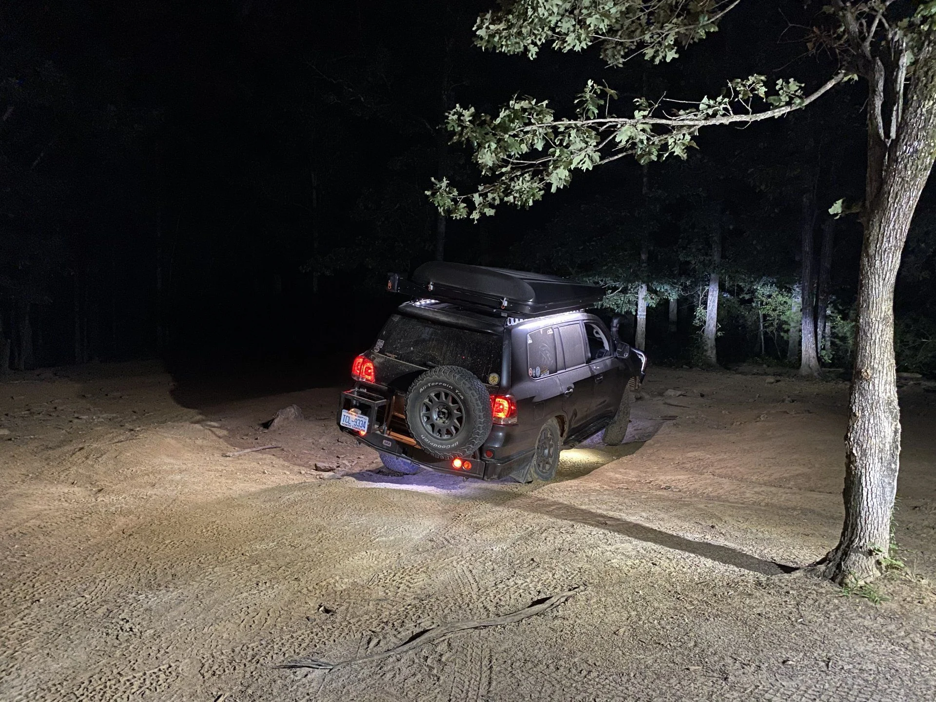

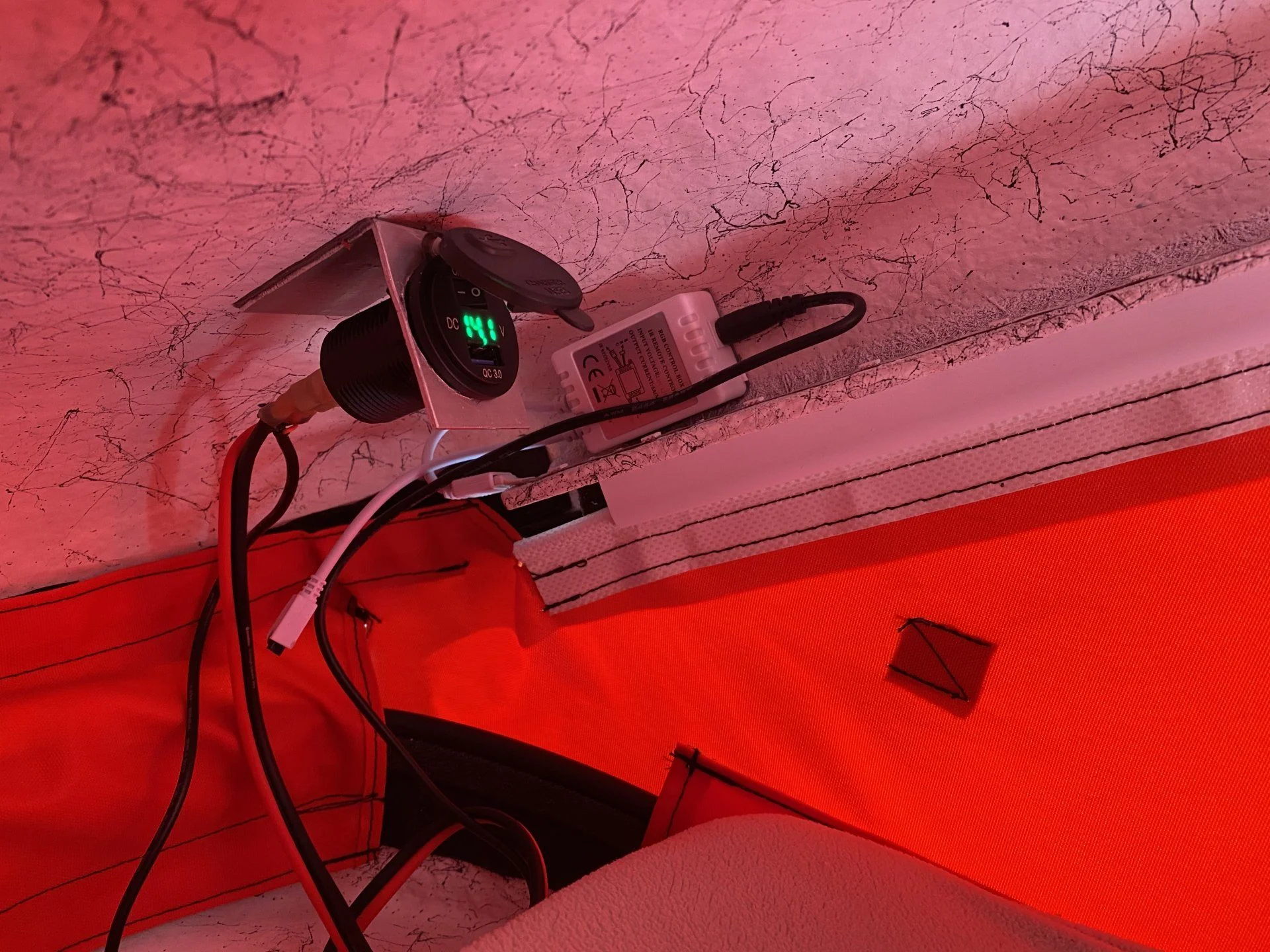

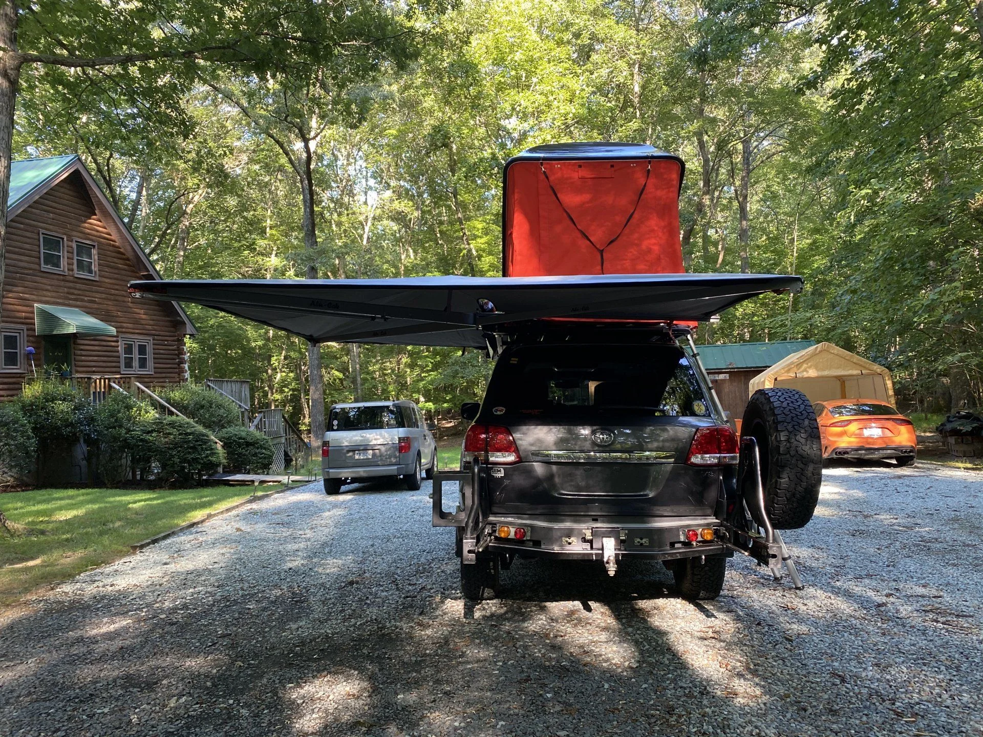

Worked on the RTT added power inside and RGB lights. So I can now charge my phone at night and have a rave. Just have to loom it up and it will be ready.
Nice! What LED light strips did you use? Were they set up for 12v already? I have a couple projects in mind for using LED light strips in the interior, but I hadn't made time to put it together.
did you camp on the beach? we were out there for labor day in an RV. couldn't drive on the beach which was bummer!
I bought these. No I cut the plug off for them.
DAYBETTER Led Lights Kit,20ft RGB Flexible Led Light Strips with 44Keys IR Remote 12V Power Supply,SMD5050 Color Changing Led Strip Lights for Bedroom, Home, Indoor,Kitchen,Party DIY Decoration Amazon product ASIN B089Q5YJTS
Yea we camped on the beach. I was there Labor Day weekend. Yea a rv would not be good out there 😂😂😂

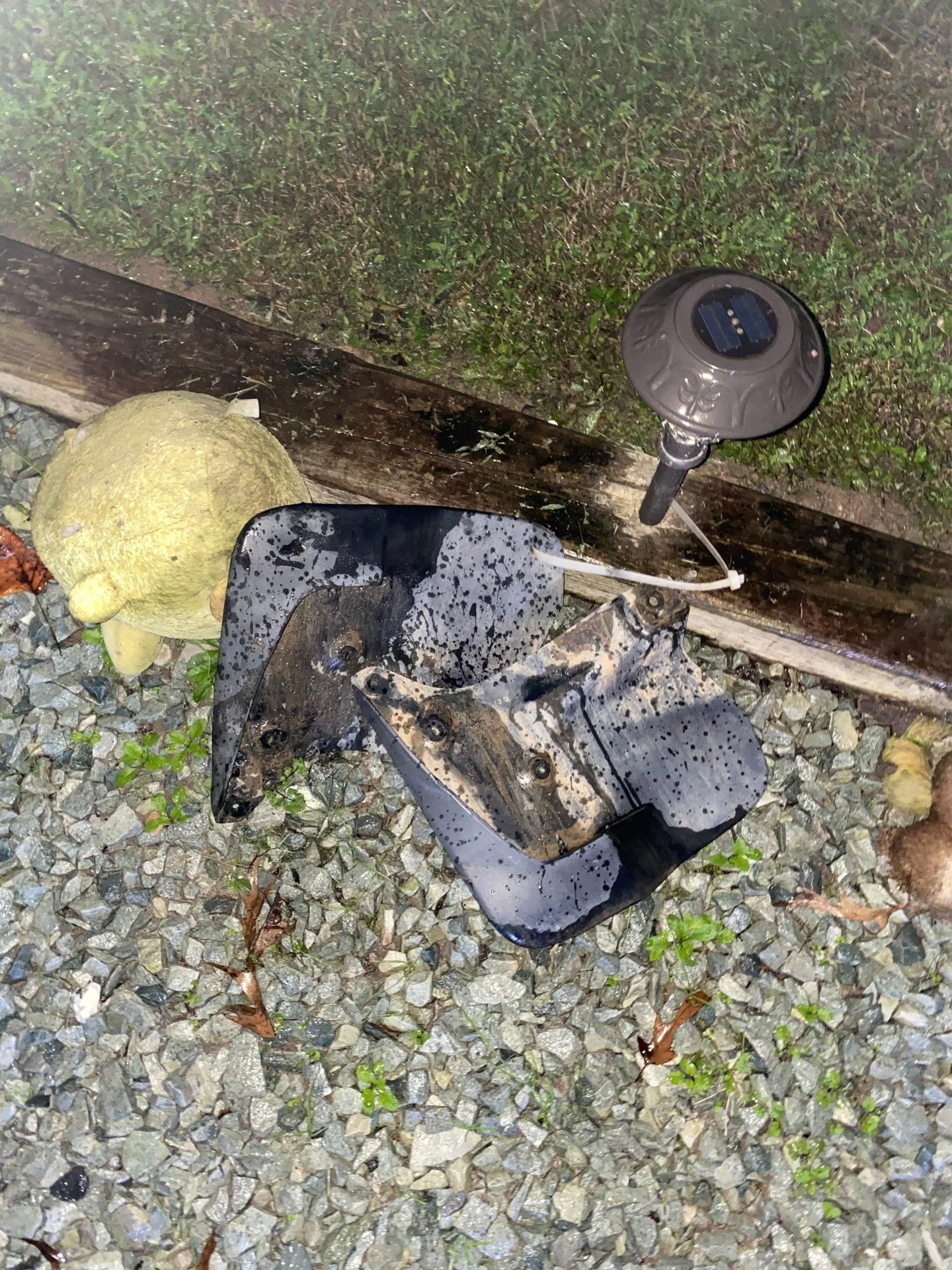

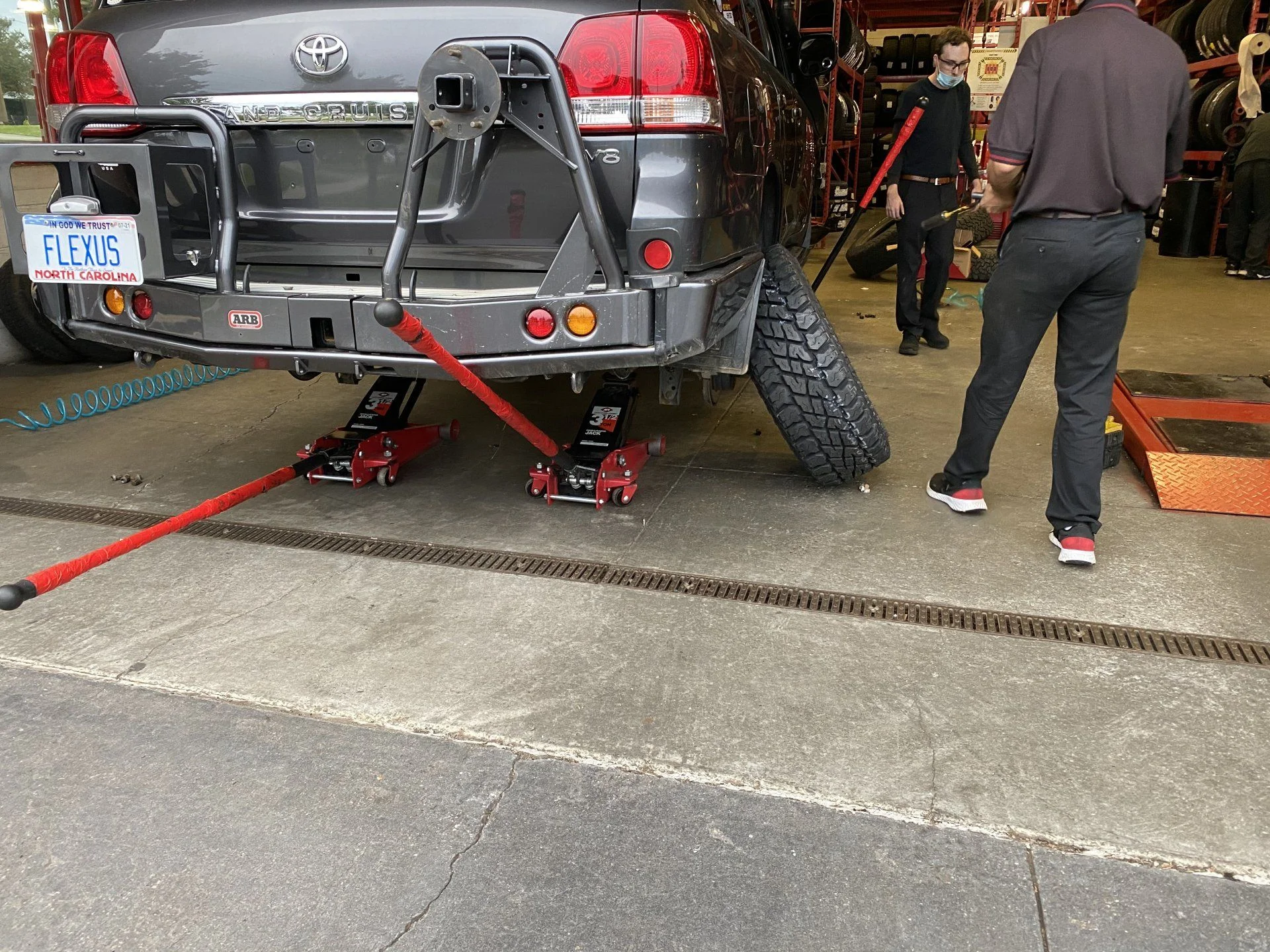

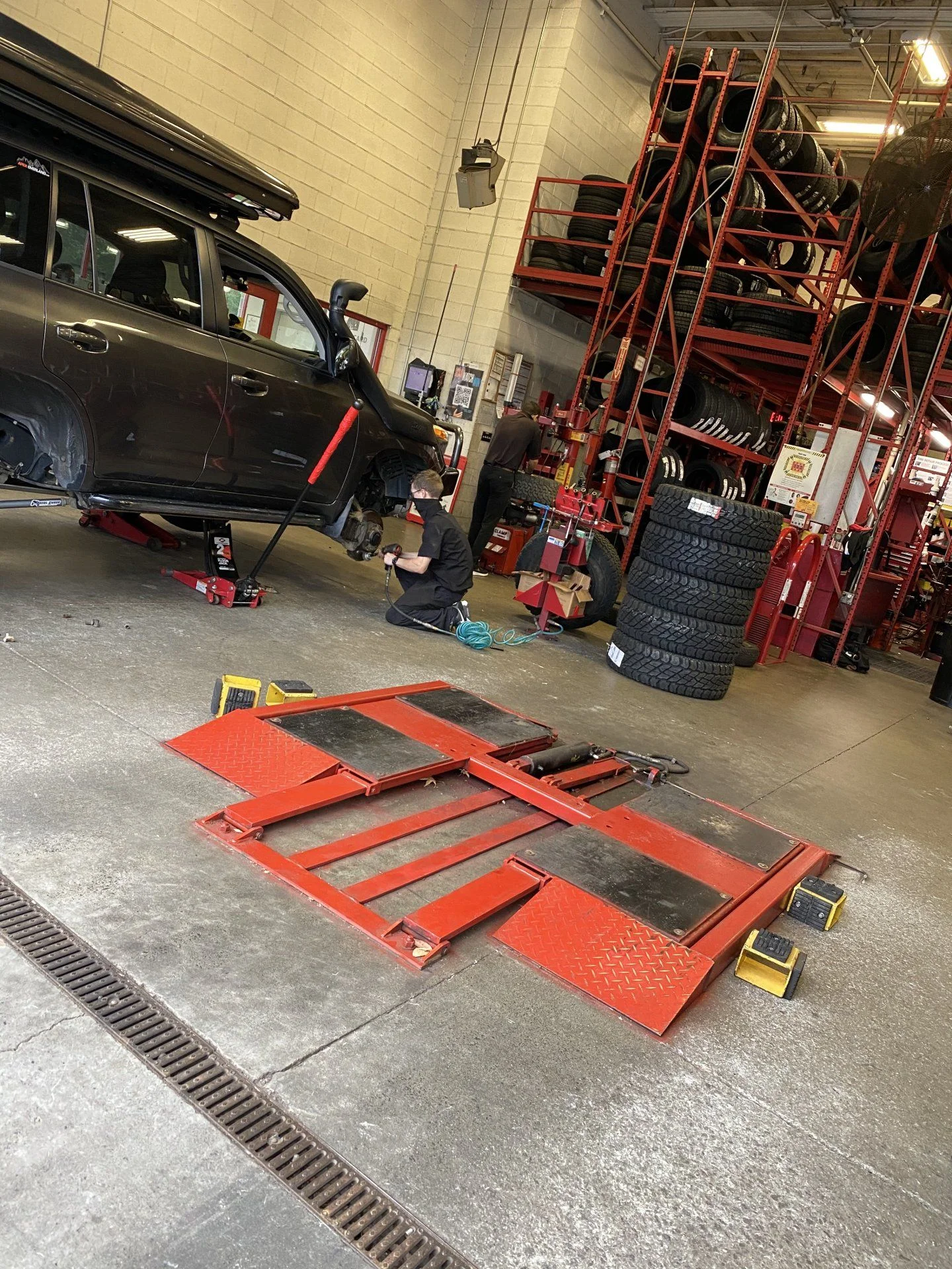

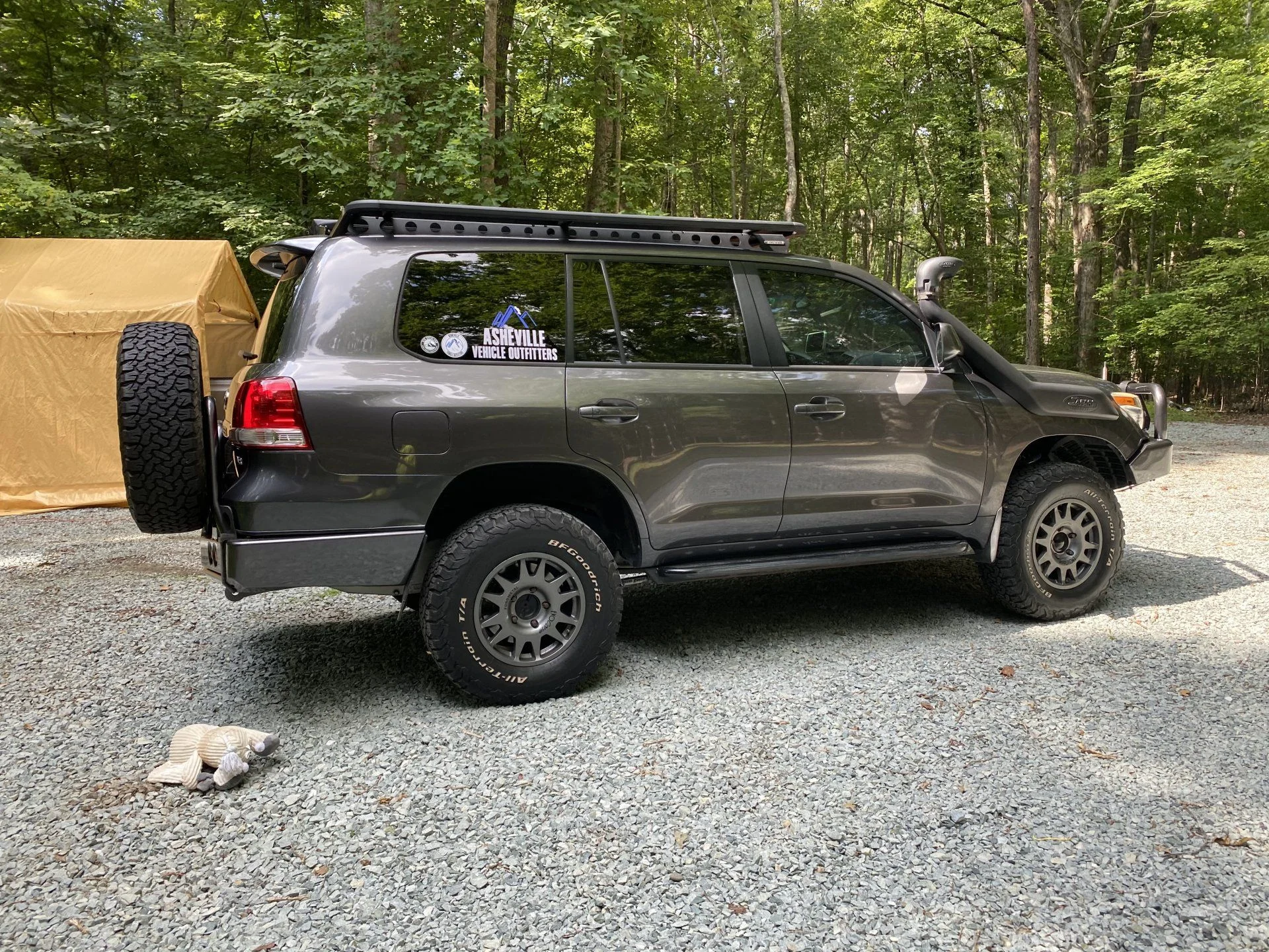

Got new meats cooper st maxx. 285/75/17. Had to take the front mud flaps off and just trimmed some plastic off. So far it’s good.
