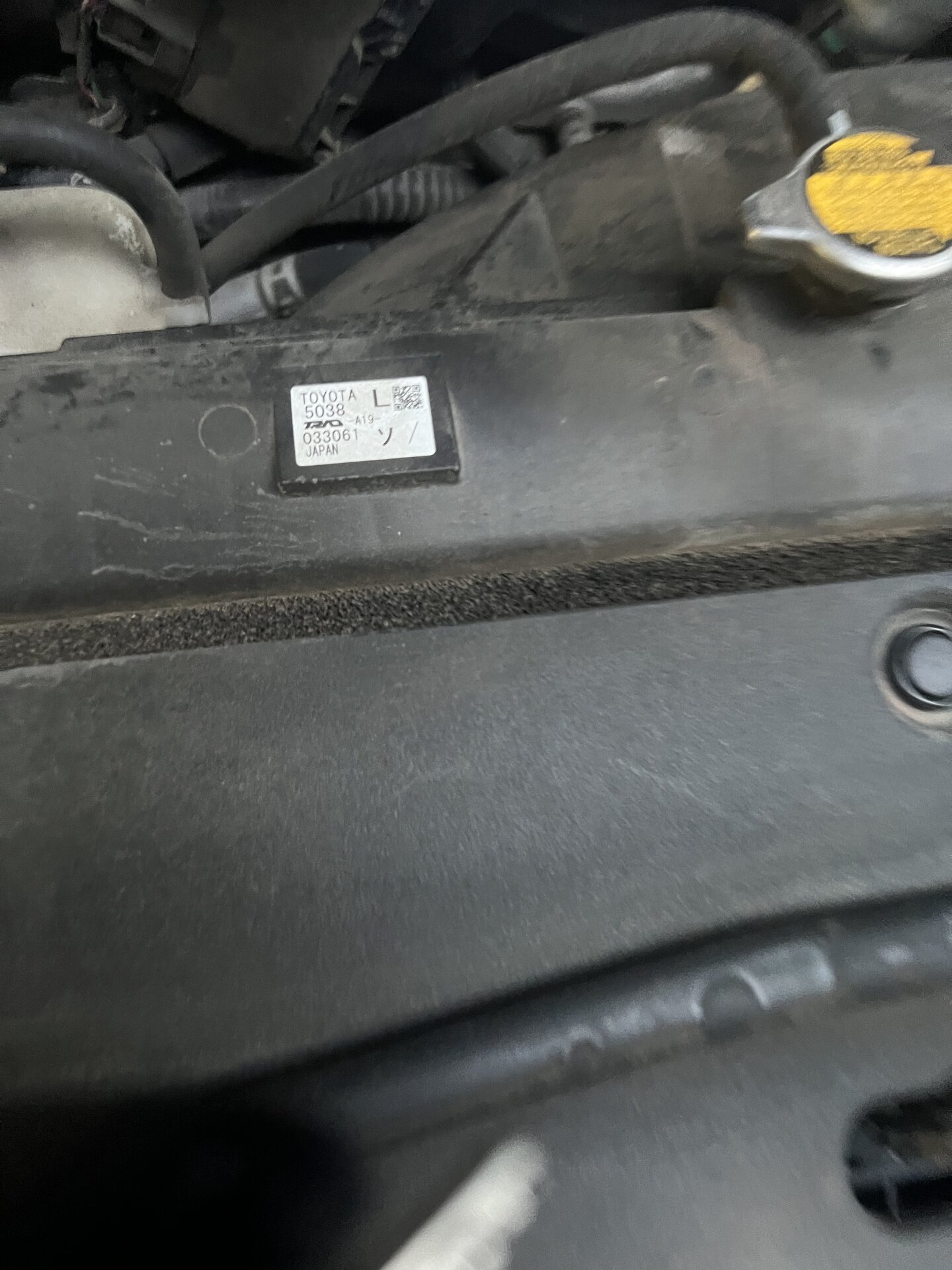

I’ve read through the post in its entirety once and thought I saw pics of old vs new radiators but wasn’t able to find it again when I skimmed back through. Anyone know if this is an updated model?
If you pan the camera down front face the lip, you will see its a hard square edge. Thats the problem area.
The new design looks like a recessed pillow.

New radiator from the dealer. Looks to me like a new design. More fillet material and an overall lower profile. Hopefully lasts a long time.
