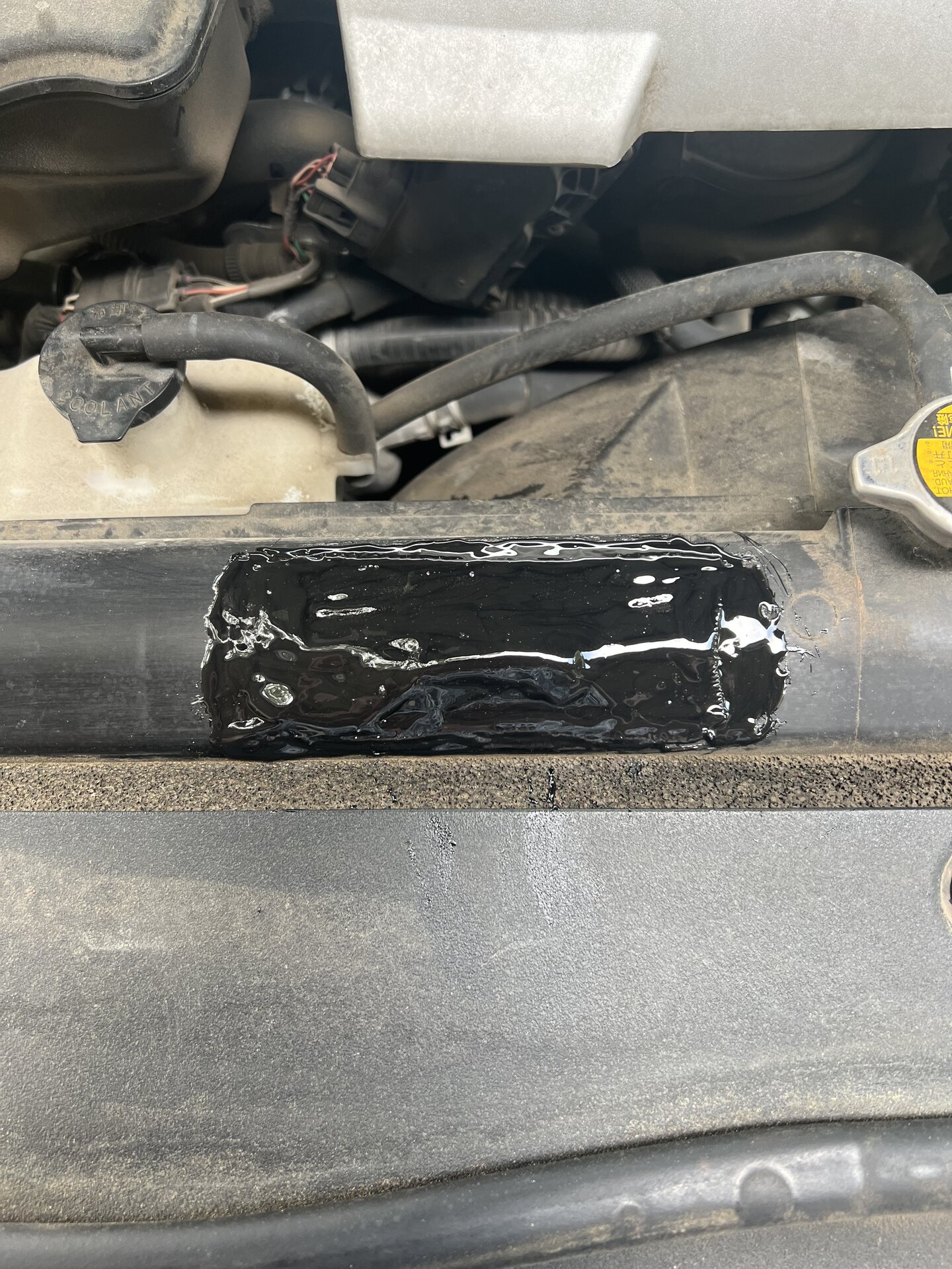

I did this, and am also monitoring. Crack wasn't through the wall yet.
After cleaning it up I could not find any cracks, guessing the spray was from the last top off. Either way I did the JB Weld/Patch/JB Weld and will monitor accordingly.
Reading through the thread it seems as if basic JB Weld was the preferred patch.
Possibly. I read threads across the internet and saw various opinions on what product to use. The temperature rating isn't as high for what I used but the radiator temperature band is under the limits of the plastic bond. Obviously the best solution is to simply replace the radiator, but I was willing to experiment.
Based on the various materials listed on the back of the plastic bonder I had some good confidence in the adhesion properties. I was very meticulous with the installation of the patch.
It will be a good test case for this product.

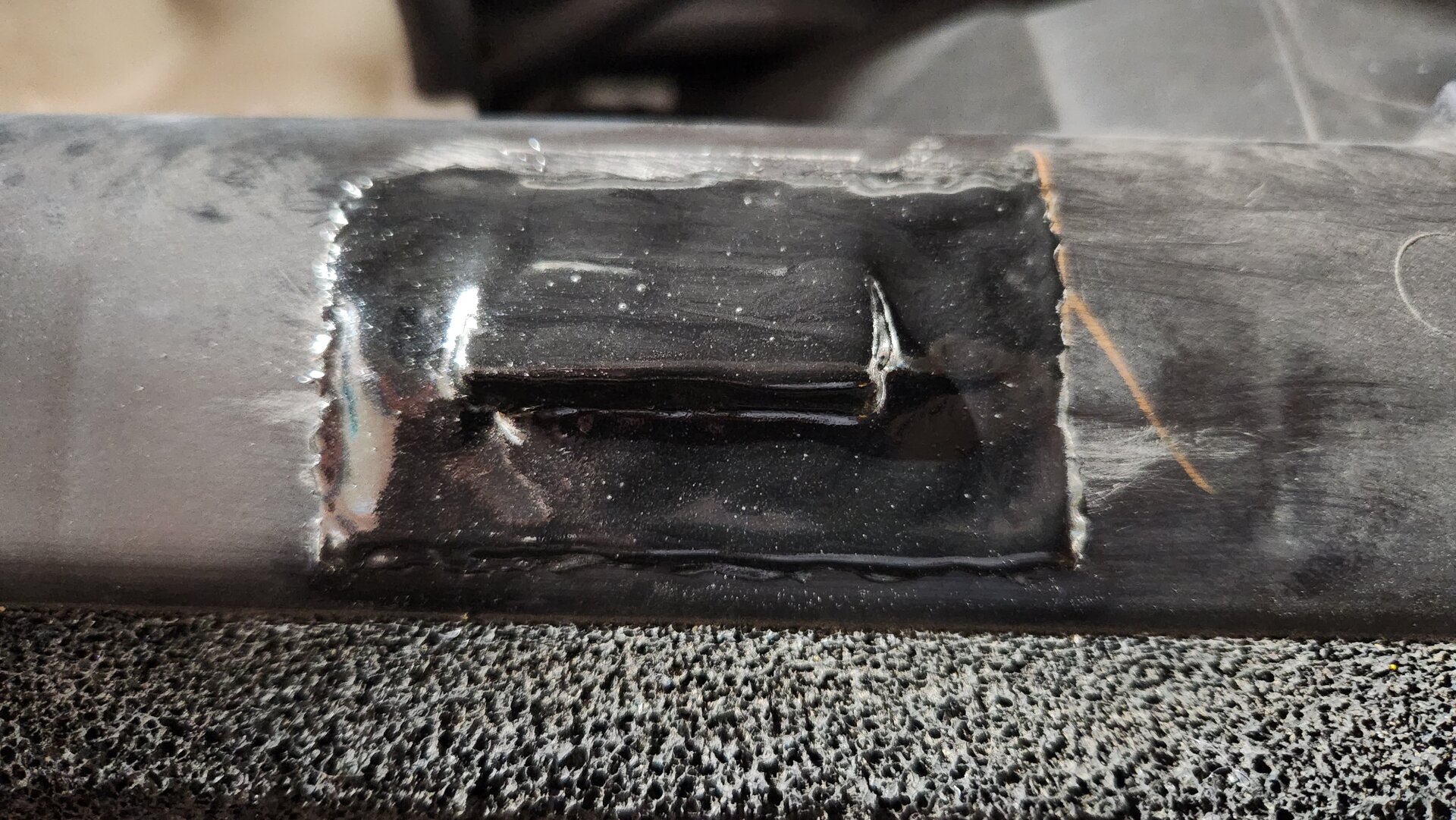

For context, I JB-welded a developing crack on the radiator a few months ago. It's holding just fine, but I want to be able to travel cross-country in our LX without worrying about any of this stuff.
Ordered all these parts. I guess I also need OEM radiator fluid, hose clamps, etc?
PS: I was required to provide my VIN for the radiator (p/n 16400 50384).
I once fixed a giant crevasse of a crack in a buddies 100-series radiator with JB Weld. A 12" crack that opened up 1/8" in spots after some serious flexing off-road in 100*F heat. It held for the mountainous drive home and many days after until the new radiator came in.
Just saying that JBWeld maybe all the insurance you need if you're in a pinch to getting the radiator replaced. I keep a tube in my emergency kit.
