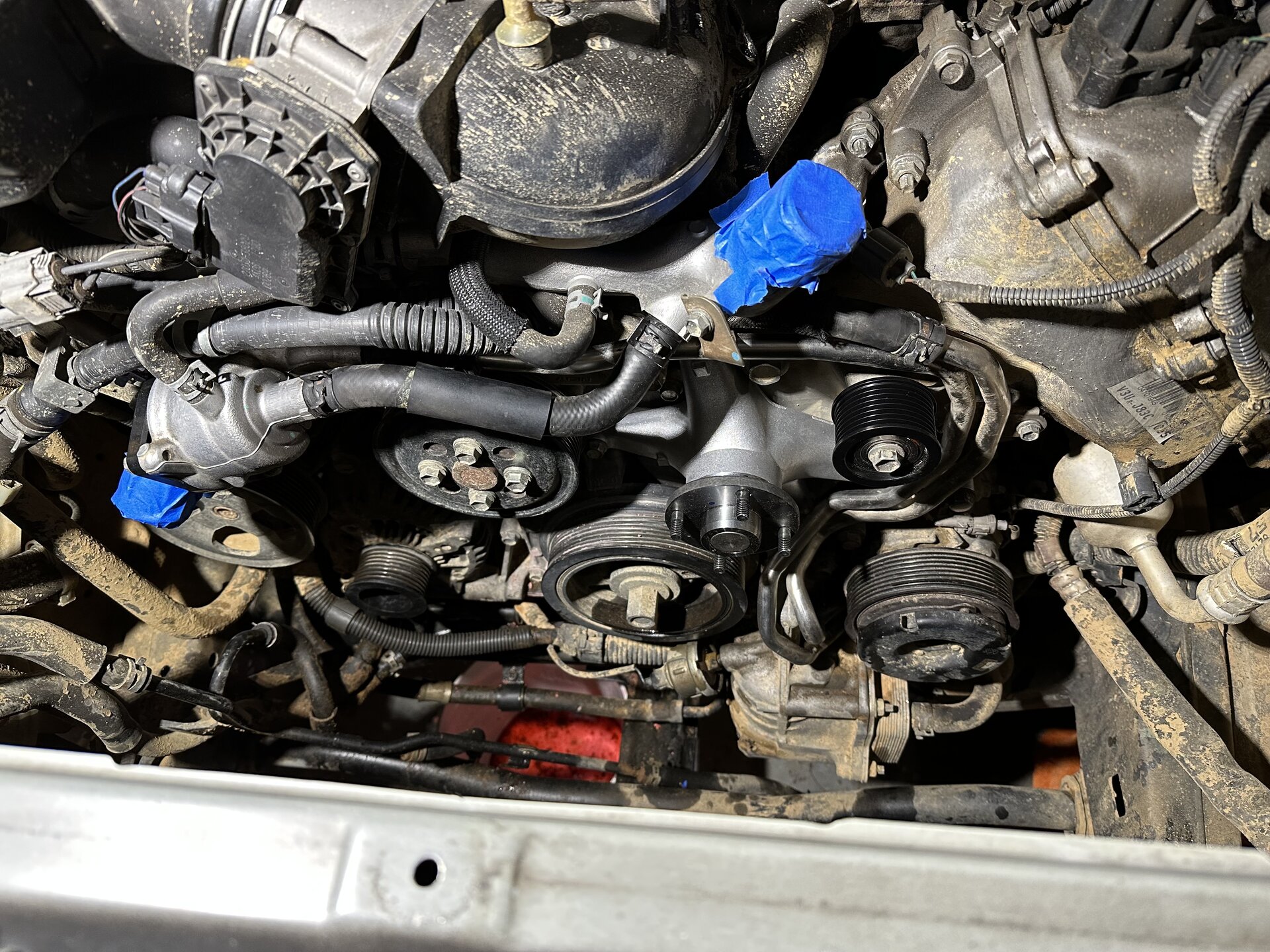

After 4 radiators, I finally have mine fixed!
#1 - 2008 OEM w/ infamous crack
#2 - Damaged in shipping
#3 - Damaged in shipping
#4 - Good to go (Requested dealership to double-box it)
While I was in there, replaced:
1. Radiator
2. New upper & lower radiator hoses
3. Serpentine belt
4. Tensioner pulley
5. Fan Bracket
6. Fan clutch
7. Water Pump
8. Idler Pulley
9. Thermostat

Nice! Total time?
2013 with 160K miles, I don’t see any cracks in the usual spot, but this looks to be the old style radiator not the updated one. Maybe previous owner replaced it with the older version or could be original
Nice! Total time?
If you don't factor in having to wait for new radiators and random stuck bolts, about 8 hours taking your time. I tend to be a perfectionist.
A few tips that helped me:
1. Use a long flat blade screwdriver wedged between the fan bolts to hold the assembly in place when removing the other bolts.
2. Make sure to connect the lower radiator hose BEFORE installing the new radiator
3. When installing the new radiator, detach the passenger side bracket and install the bracket to the LC/LX first. Then install the radiator with the driver's side bracket still installed.
4. When installing the new radiator and it is halfway in, carefully spin the fan blade to allow the radiator hose attachments to slip past
5. Once you've installed the new radiator 90% of the way, climb under the rig to push up on the fan shroud to get it past the hose attachment points.
6. Long needle nose pliers are your friend

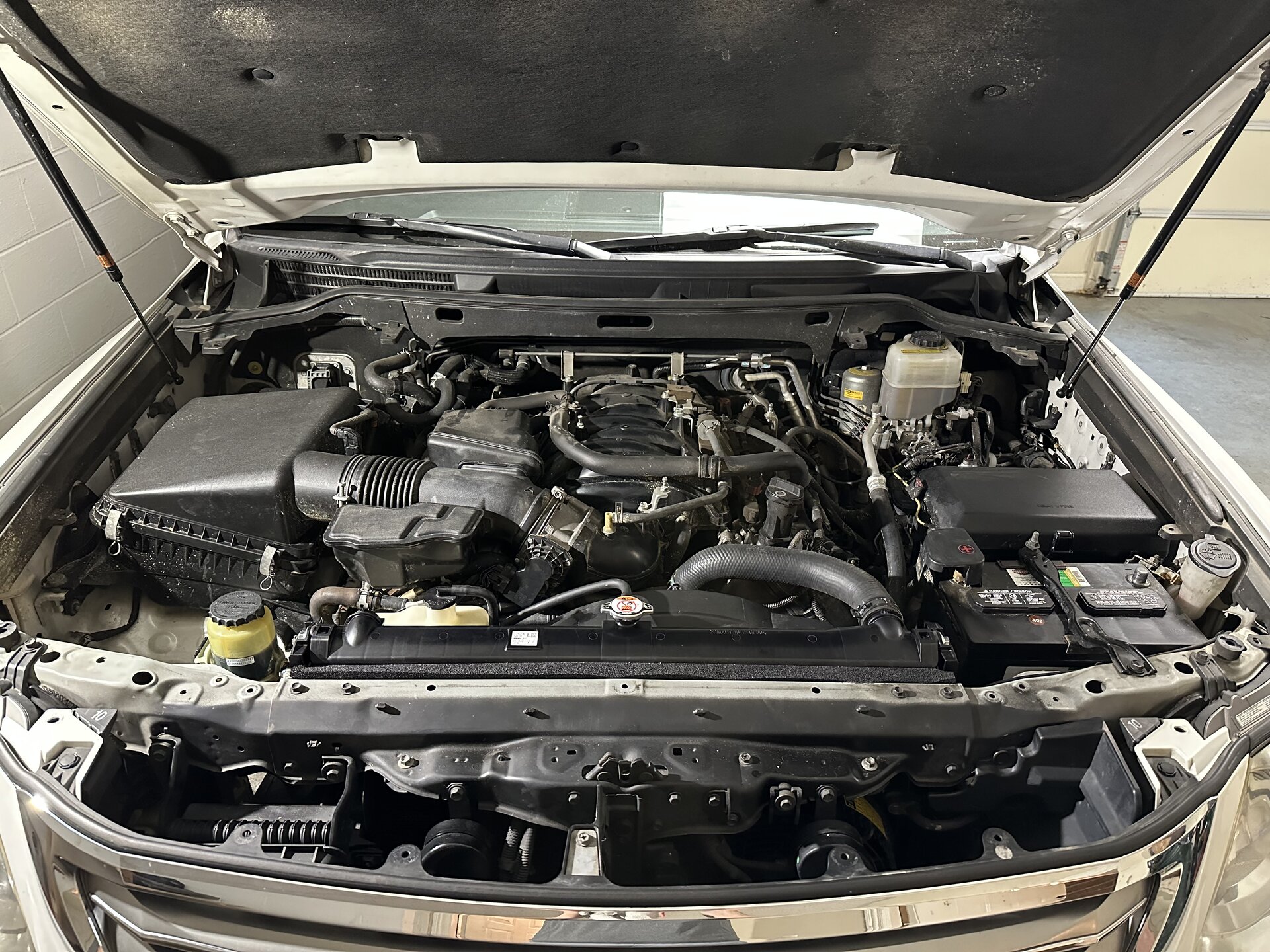

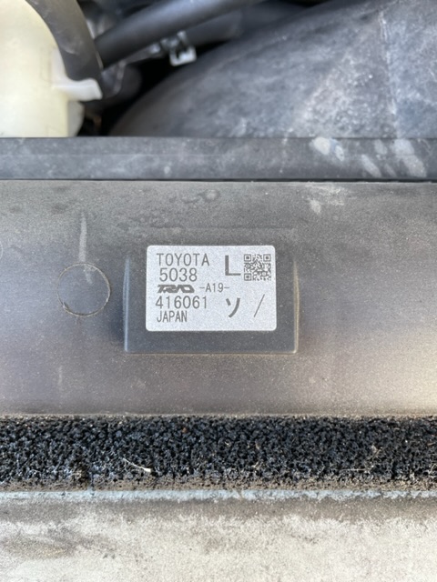

I’ve read through the post in its entirety once and thought I saw pics of old vs new radiators but wasn’t able to find it again when I skimmed back through. Anyone know if this is an updated model?
That looks like the old design to me. I think the new design softened those hard edges on the bottom corners which is where the weak spots are.
I agree.
