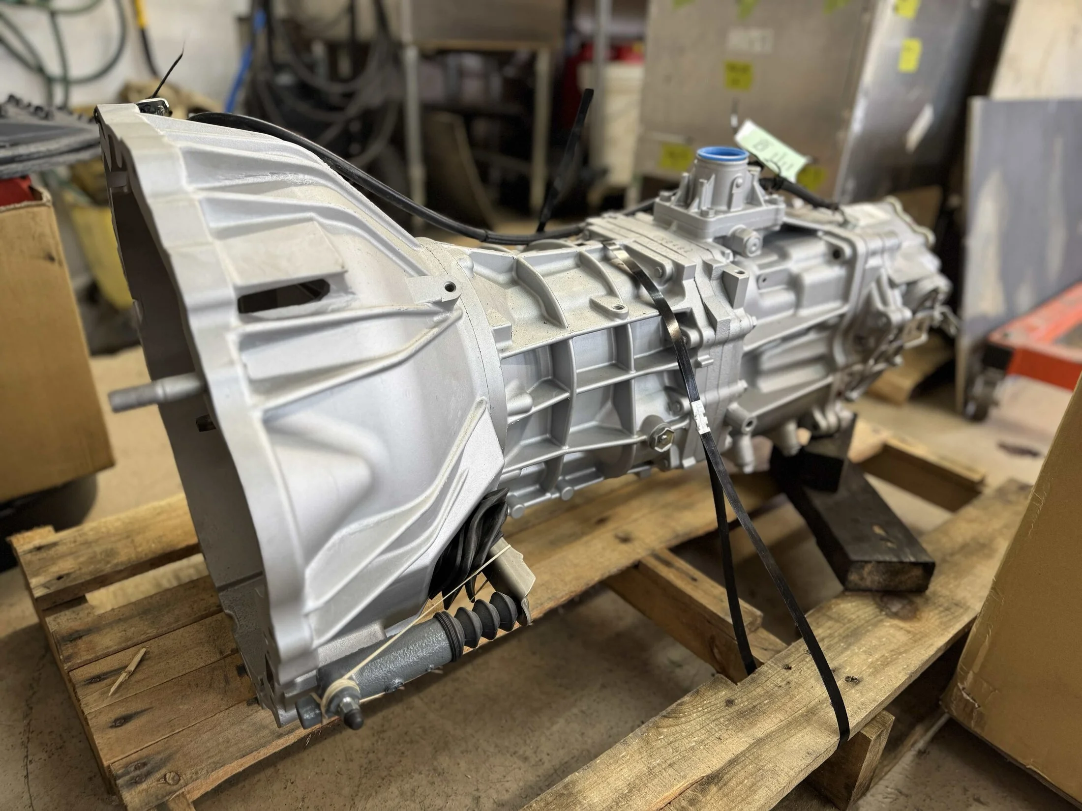

Yesterday went to the shop 1200KM back and forth and drop the 1HZ spare block for assembly and pick up my newly rebuild Trans with tamer terrain 5th gear
I'll be going back to drop the turbo and other items to test on the bench... I might to the swap there before winter... I'll be left with another 1HZ spare block complete transmission... and also HZJ79 T-case...

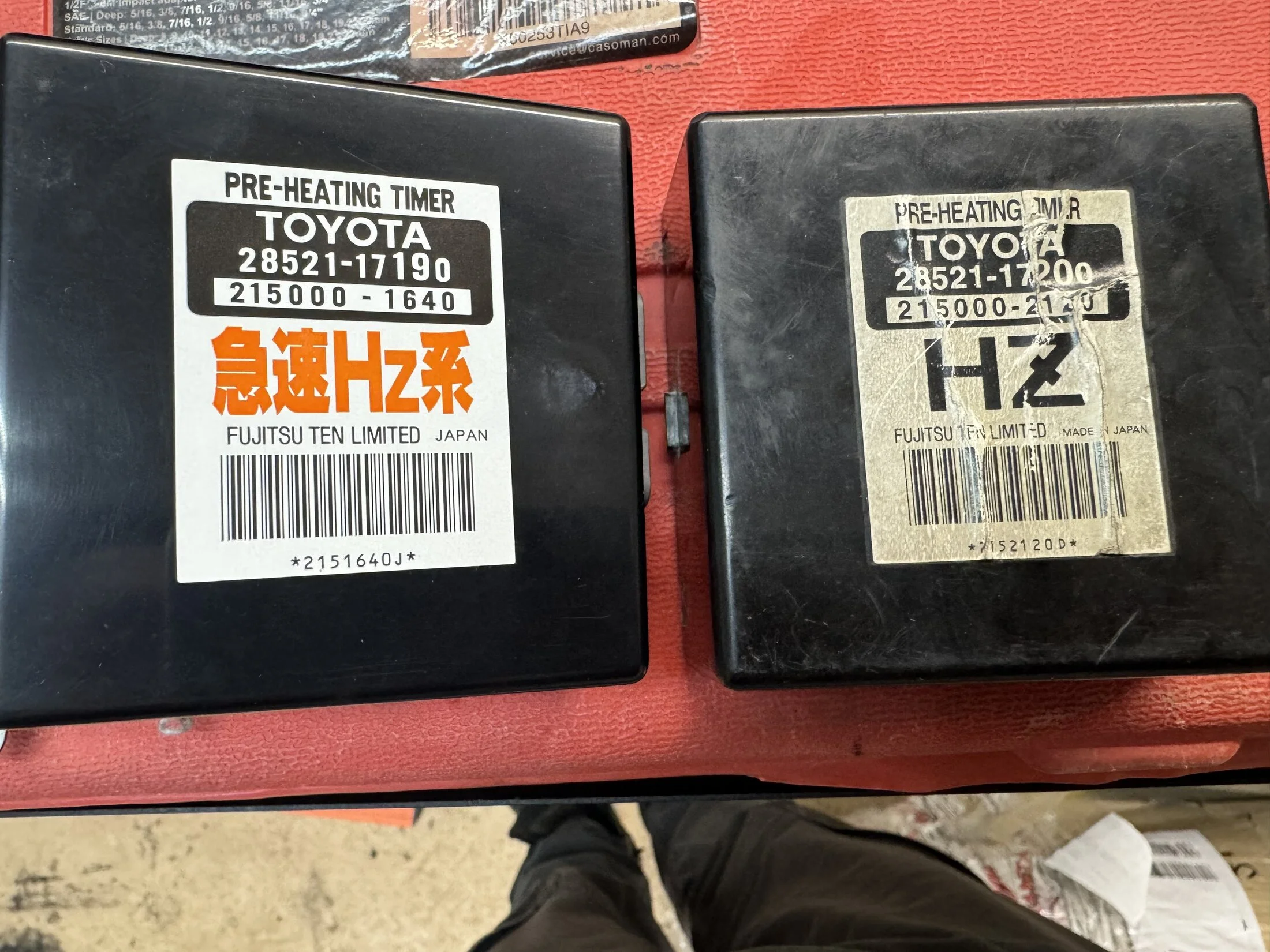

I had some spare time this afternoon did a continuity test they came out 100%! Double check the pre-heating box part number and realize it's not the exact same one so went head and purchase the new one... Change all fuse too
Toyota2852117190
Swap those 2 pre heating boxes the light in the dash is full glow now but no real difference on starting.Still takes about 5-7 cranks

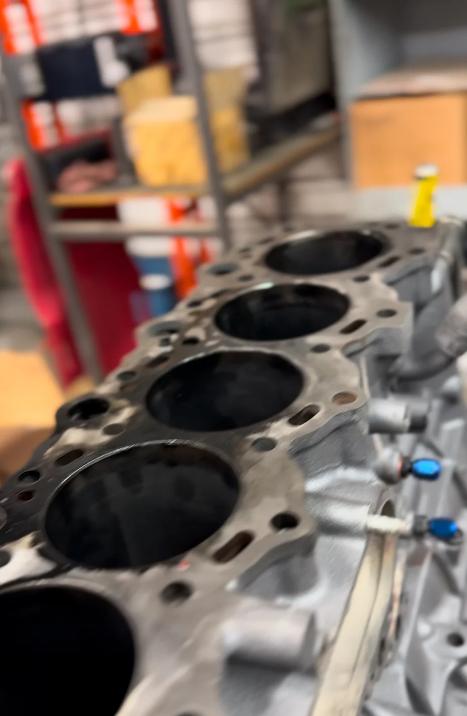

Gold nugget bottom end cracked and cylinder sleeve dead..... Got a new short block

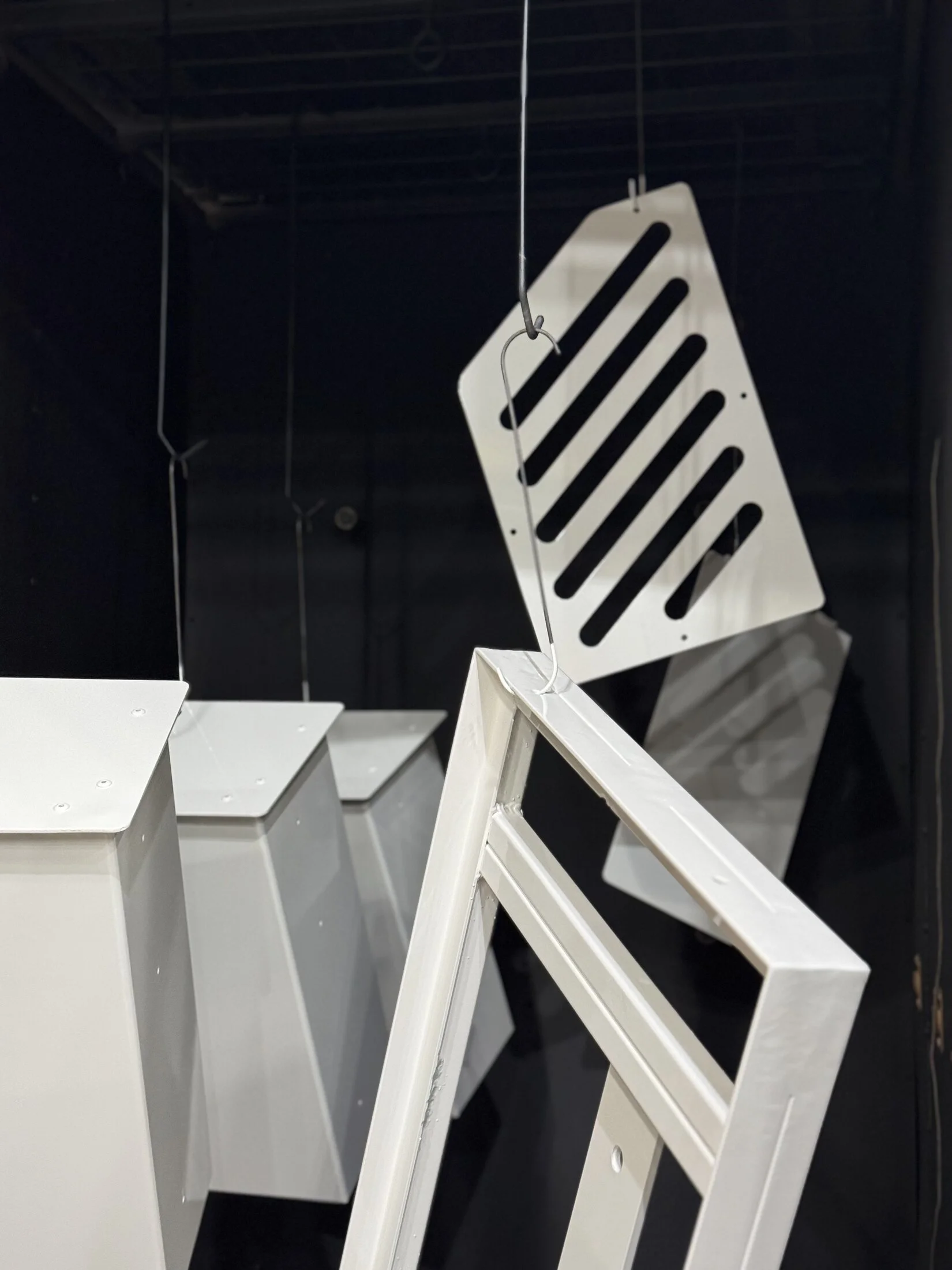

Good news cabinet are almost finished powder coasted
