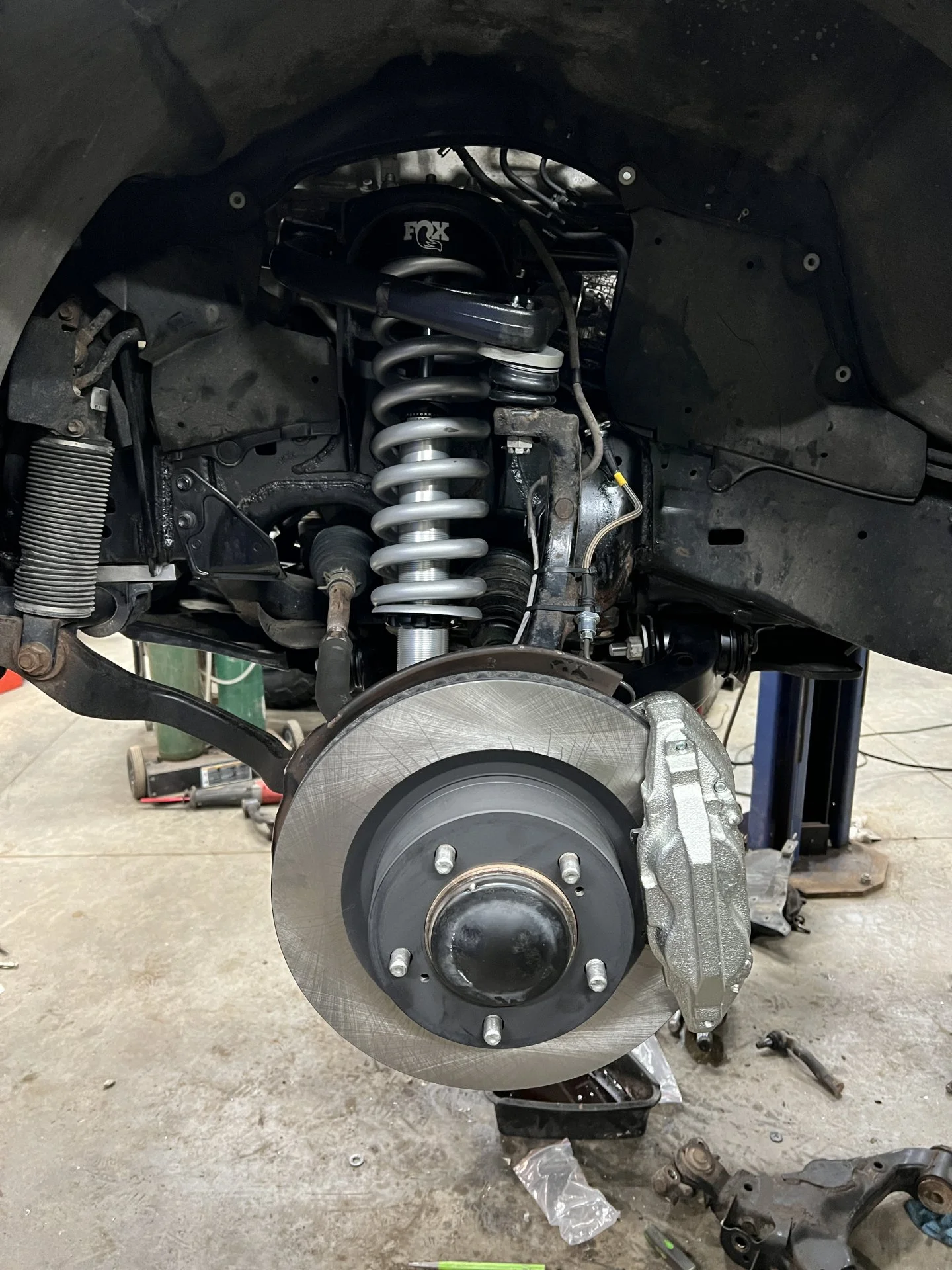

Here's the front end put back together with the Tundra components, SPC uppers and Fox Coilovers

So one of the coilovers made it past Fox's quality control (and me) with a missing coil spring retainer ring (this part sits on top of the preload adjuster and keeps the spring in place from the bottom). If your coilover is missing one of these and you go over a bump, it can dislodge the spring and send it past the preload adjuster leaving you at full bump.
I was able to borrow a coilover part from a buddy's shop that works in the meantime and got it back to a safe place while I wait on the missing part from Fox. Fortunately there was no damage to the fender, just a scratched up spring and some scuffs on the shock body/decals. I've parked it for now, will swap in the missing retainer and then look forward to getting it aligned.

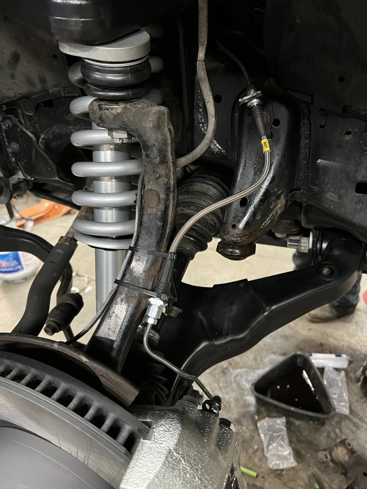

I did the Tundra brakes as well and utilized soft lines from Stoptech that go between the stock hardline of the 200 and a OEM Tundra hard line that I ordered from Toyota. I found them mentioned in another thread and they worked great. Here's a pic showing them in use as well as my fancy zip tie brackets.
