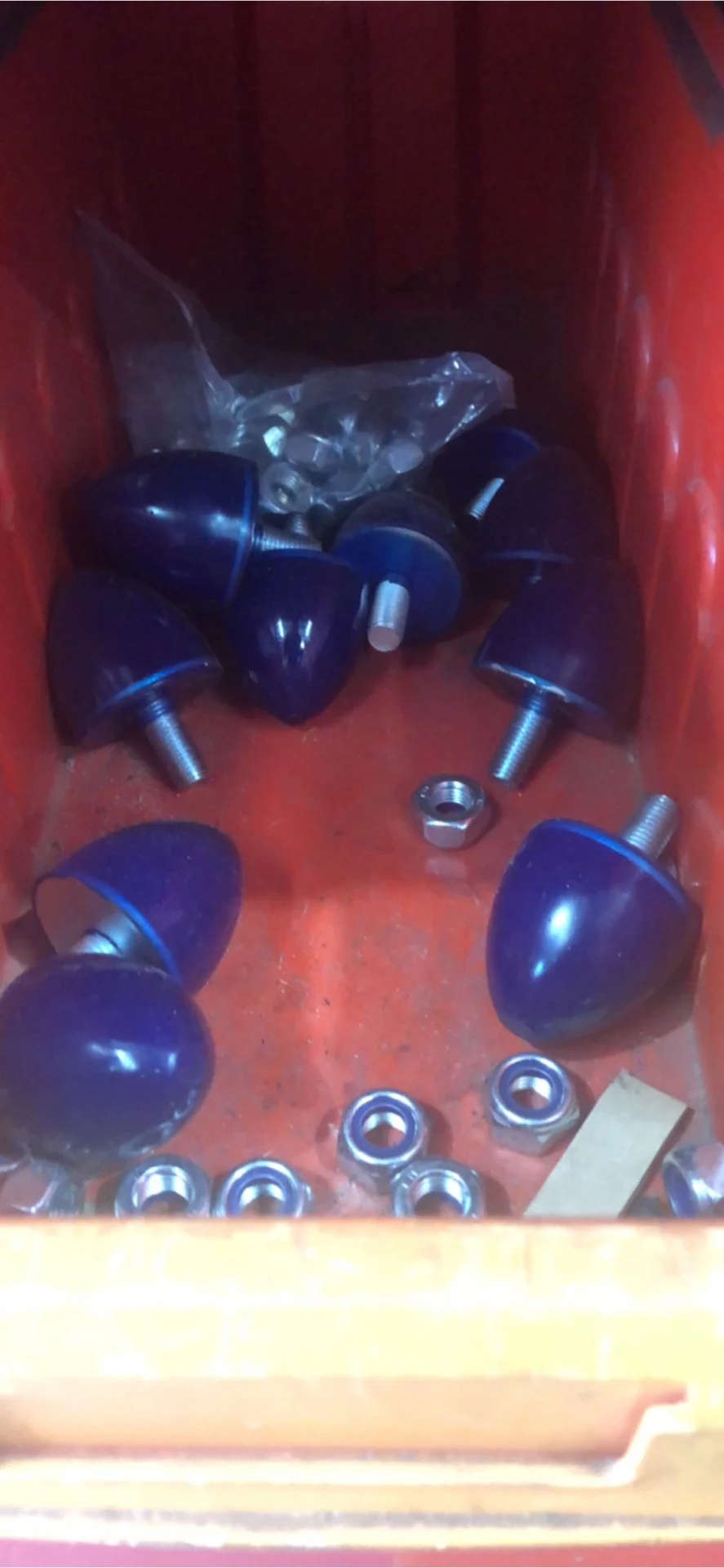

Aussies use these bumpstops. Progressive and better clearance for 3.0 front struts
I'm guessing Superior Engineering just based on the color (?), but I don't see them listed on their site. Do you have a link for them? What do you like for a replacement bumpstop for the rear?
Superpro not Superior Engineering. We use airbags for rear so no bump stop in the spring
These ones?
Judging by the part number, I'm guessing there are different durometers available, but that's the only one I can find listed.

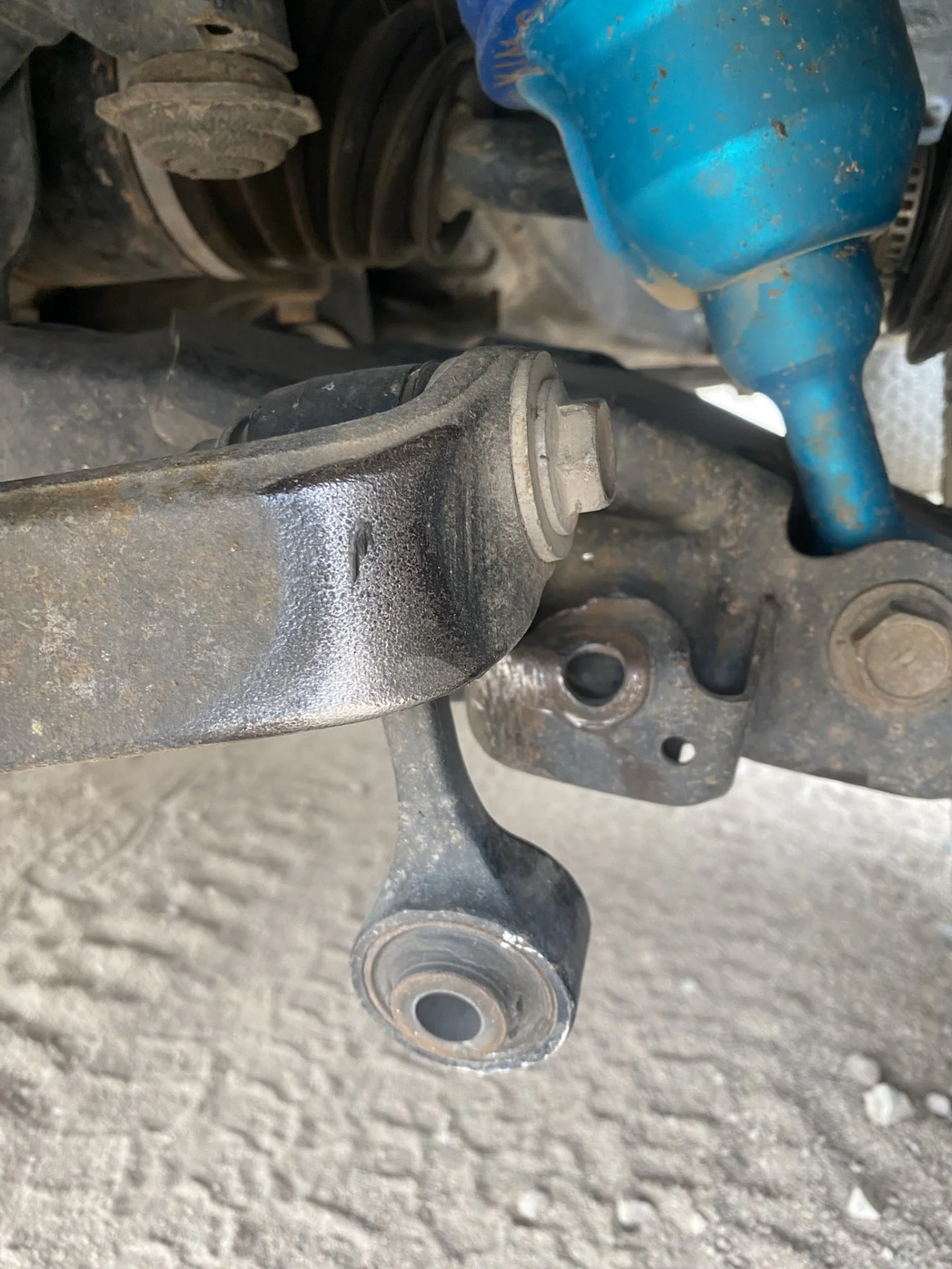

Well gang, i did it. I broke my lower sway bar link bolt on the drver side that was mounted outside the bracket. I checked back and for some reason I only used a class 8.8. I also did not have a sleeve inside the mount. Time to rectify both of those while I get time to fab up some better brackets. The 40 is stealing all of that time at the moment.
Did it snap outside the mount or inside?
Were you able to get the rest out?
That is a problem for a different day! As soon as i get my dad's 100 on new cvs and out of my garage, I will start trying to extract the bolt. I drove it home on the windy roads of Big Bear and it wasnt too squirrly, but need to get it fixed before any more driving.

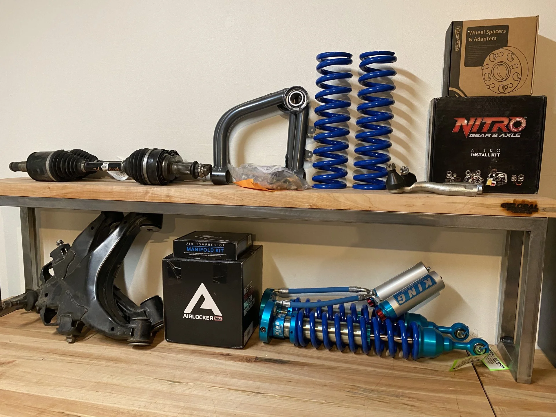

View attachment 2836131So close to having all the parts collected. Still waiting on the 4.88 gears. So while I wait, may try and get the parts for the tundra brakes.
-King 2.5 adjustable
-King 700lb springs
-Camburg UCA
-Craigslist OEM LCA
-OEM tie rods
-EBay OEM CV axles
-Spidertrax spacers
And the
-arb lockers front/rear
-nitro 4.88 gears
Going to be quite the transformation. Thanks to all who came before me.
Do you happen to have the part # for the King 700# coilovers? I have the Tundra spec Kings but they came with 600# coils and will likely need to bump it up to 700#'s. My Tundra spec Kings have 16" 600# coils on them (SPR3-16-600 C22).
I suspect the lack of an inner spacer is what did you in. I used a 1.5” aluminum spacer inside my cradles and with about 15k miles on them they still seem fine.
