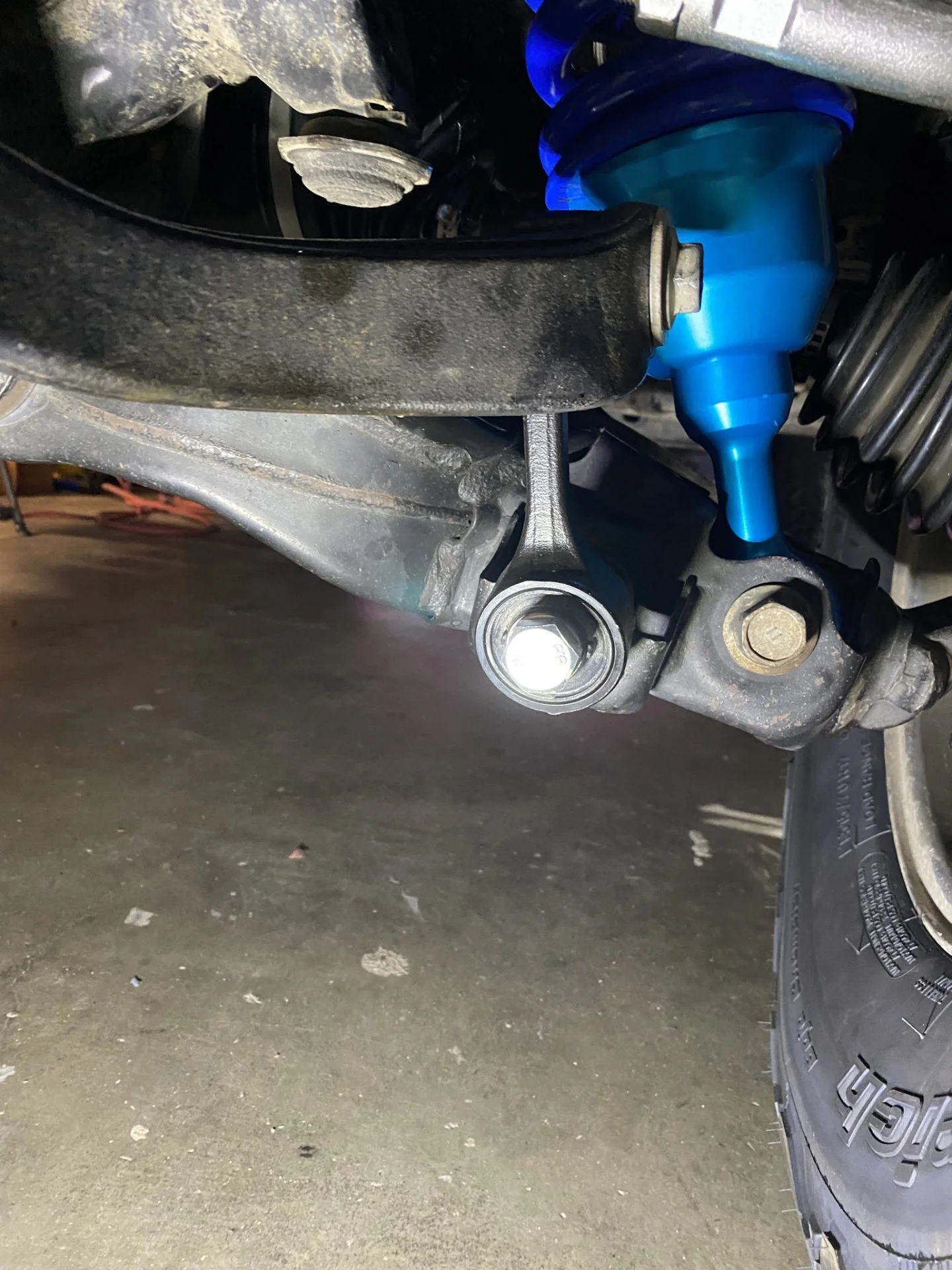

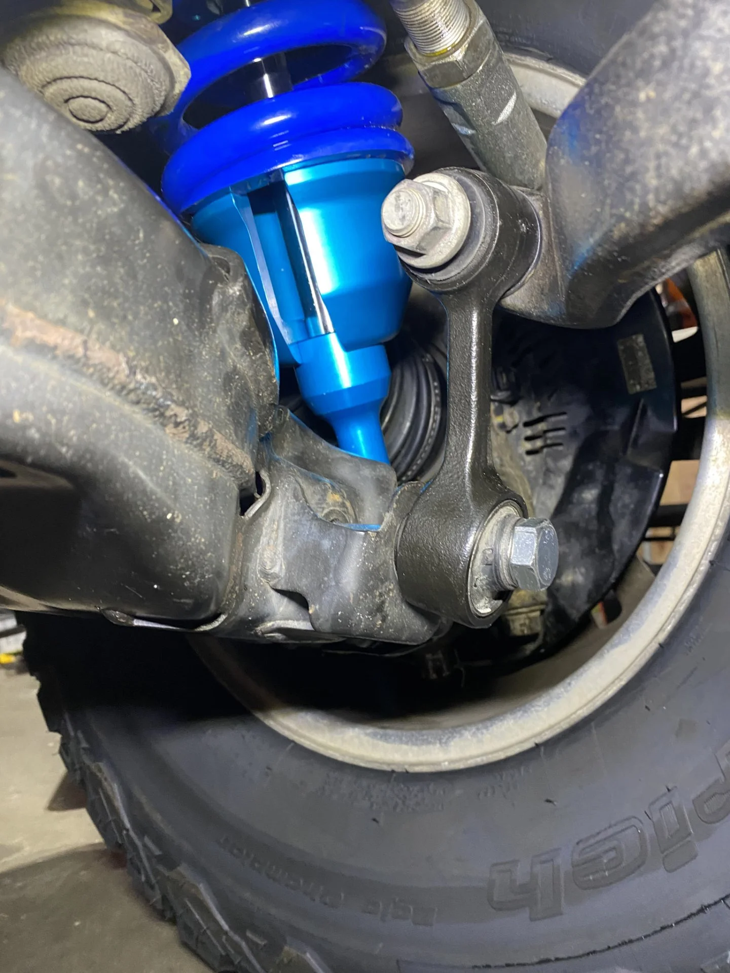

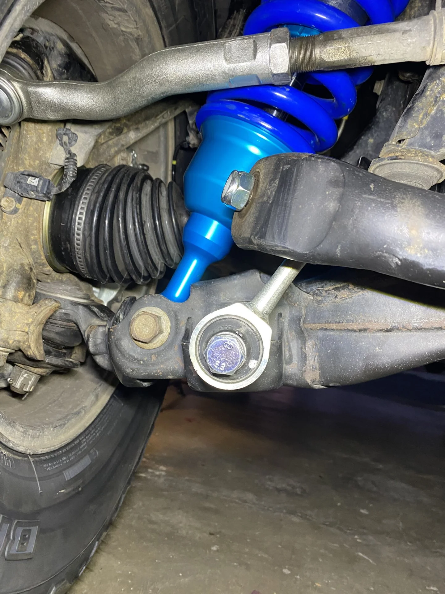

Got the sway bar links in last night. Decided to try outside the bracket for now. Maybe I am under playing the forces involved, but not terribly worried about the single shear. But I do think at some point I may weld some reinforcement and make it a double shear. I will say though, being outside the bracket made it pretty easy to get the links mounted as the long bolt gives you a lot of leverage to get it lined up. loosely connected the upper mount, jacked up the sway bar, and then leveraged it into place. Driver side looks much better than passenger, but I completely forget what stock looks like. This also includes the KDSS relocation bracket.
What links are you using here?
I'm almost certain they are stock links. I ordered a bunch of different ones and somehow this was the longest passenger side, so i must have mixed up tundra part numbers.
That nylon lock nut is not stock.. though that doesn't necessarily mean it's not a stock link otherwise.
Correct. Should have said stock length. Accidentally ordered a non OEM one off of partsouq. it also was tightened at the time of the picture. I now have way to many random sway bar links haha.

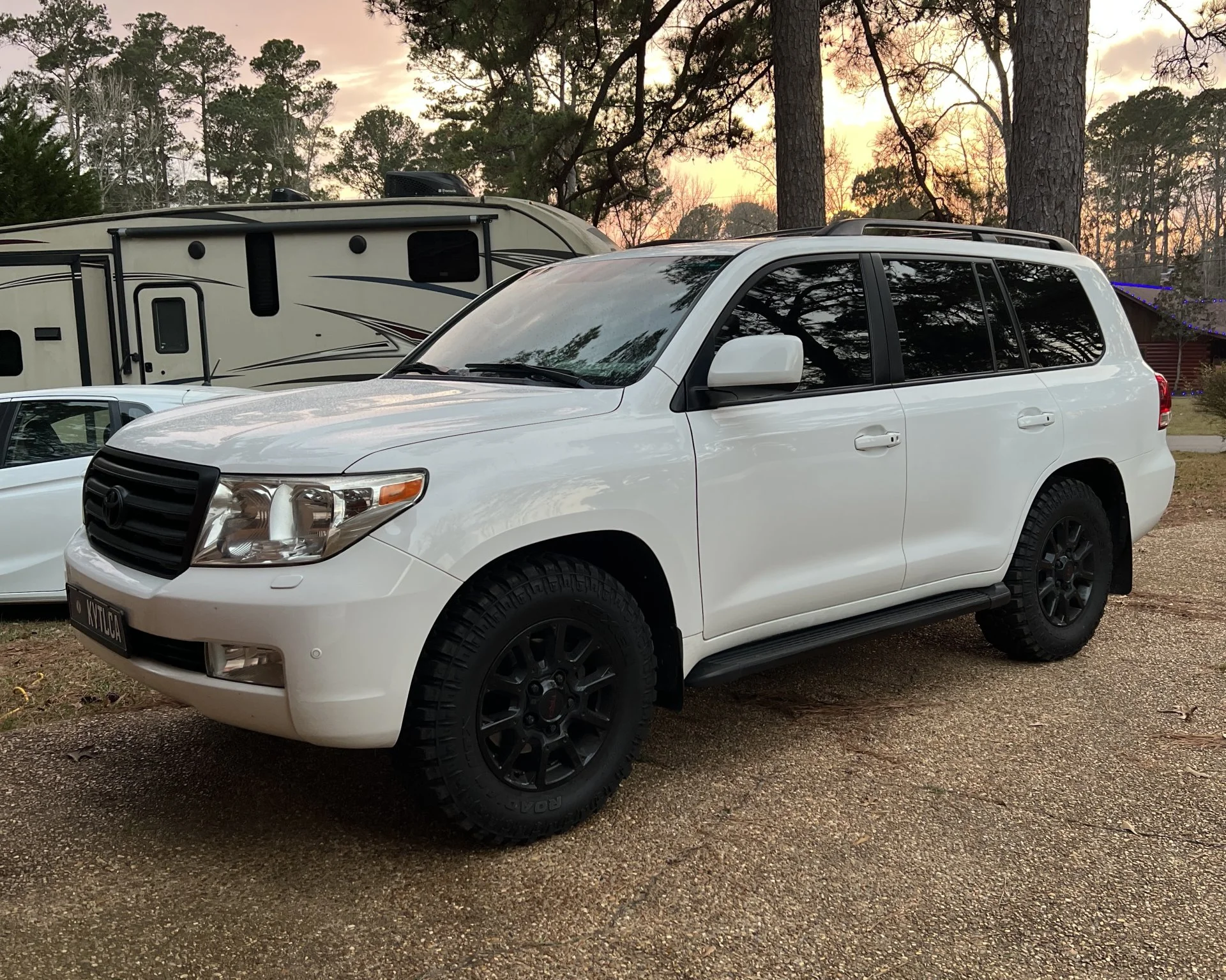

Last little bit of work was to trim up the fender well and modify the Bud Built Skid to clear the KDSS after relocation.
Had it next to my buddies Raptor on the same tires, love the look and it drives great, really cant wait to get it off pavement for a shakedown trip.

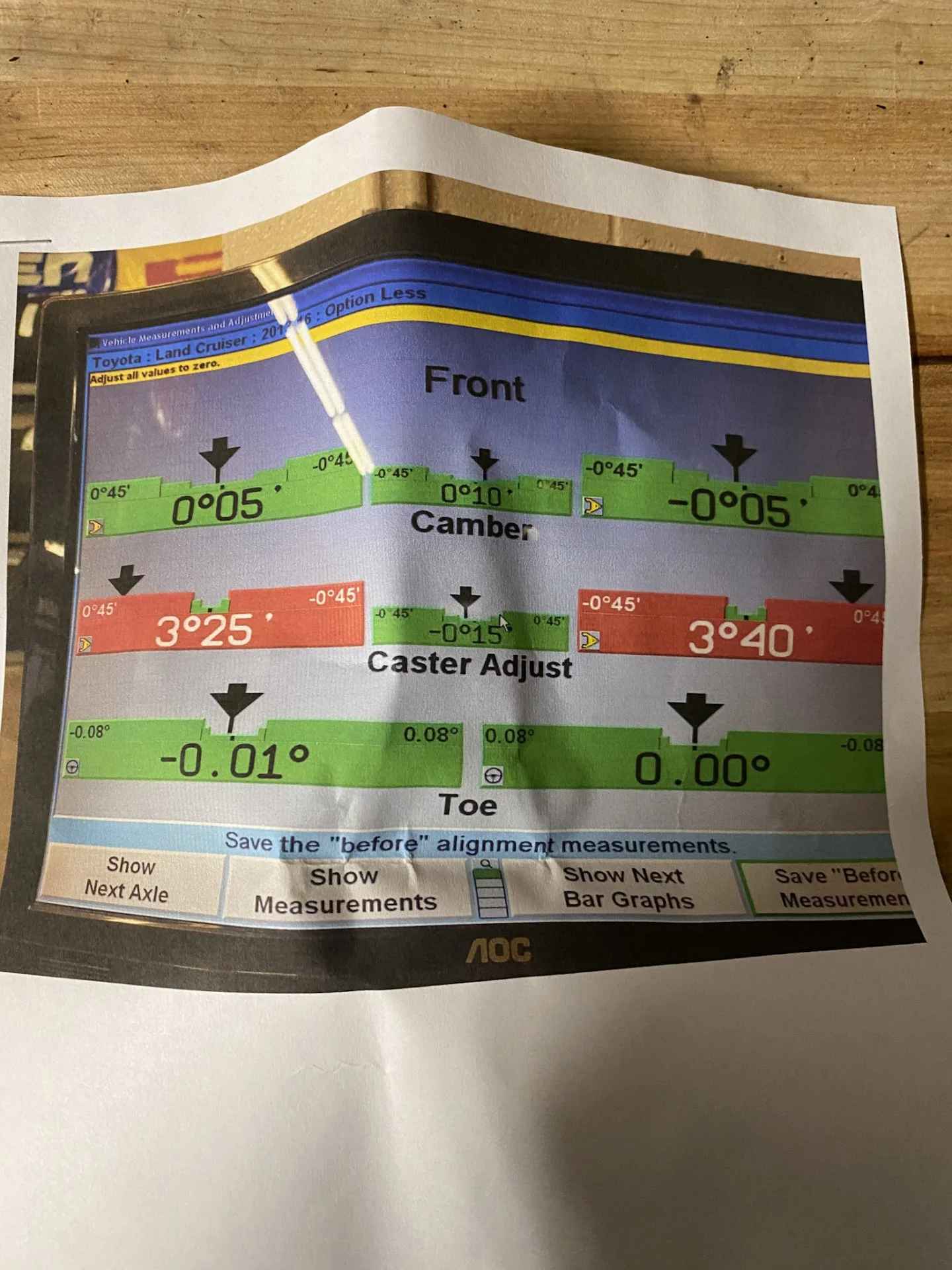

The only thing I am not happy about is the fact I went with non adjustable UCA's. Alignment came in as shown below.
I am rubbing the KDSS at full lock on the inner tire as well as very minor rub on UCA. And will need to remove more fender as I flex it out more. In general I need the axles moved more forward. Obviously this has more to do with the wide tire than the tundra swap.
I am not an expert by any means, but think I could get it more forward without adjustable UCA's? Or just bite the bullet, and get some SPC's and give someone a killer deal on the Camburgs?

@linuxgod has written about the default caster specs in alignment machines not being correct per the service manual, but I don’t remember the numbers.
Thanks, I’ll try and track that down.
Your alignment specs look really good. The only way you’ll reduce kdss rubbing via alignment will be to reduce your caster a lot, which will make you track less stable on the highway.
My $0.02 is buy the kdss relo kit and install that. The kit will move the KDSS arm and the sway bar on the passengers side forward 1” so with 34s or smaller you won’t rub at all. You might even fit 35s without rubbing. The only downside is that is ours your sway bar end links at an angle which will wear the rubber bushing much faster. However I posted some info about how to mount the sway bar end links on the outside of the LCA cradle. 10k miles and I’m very happy with that solution.
