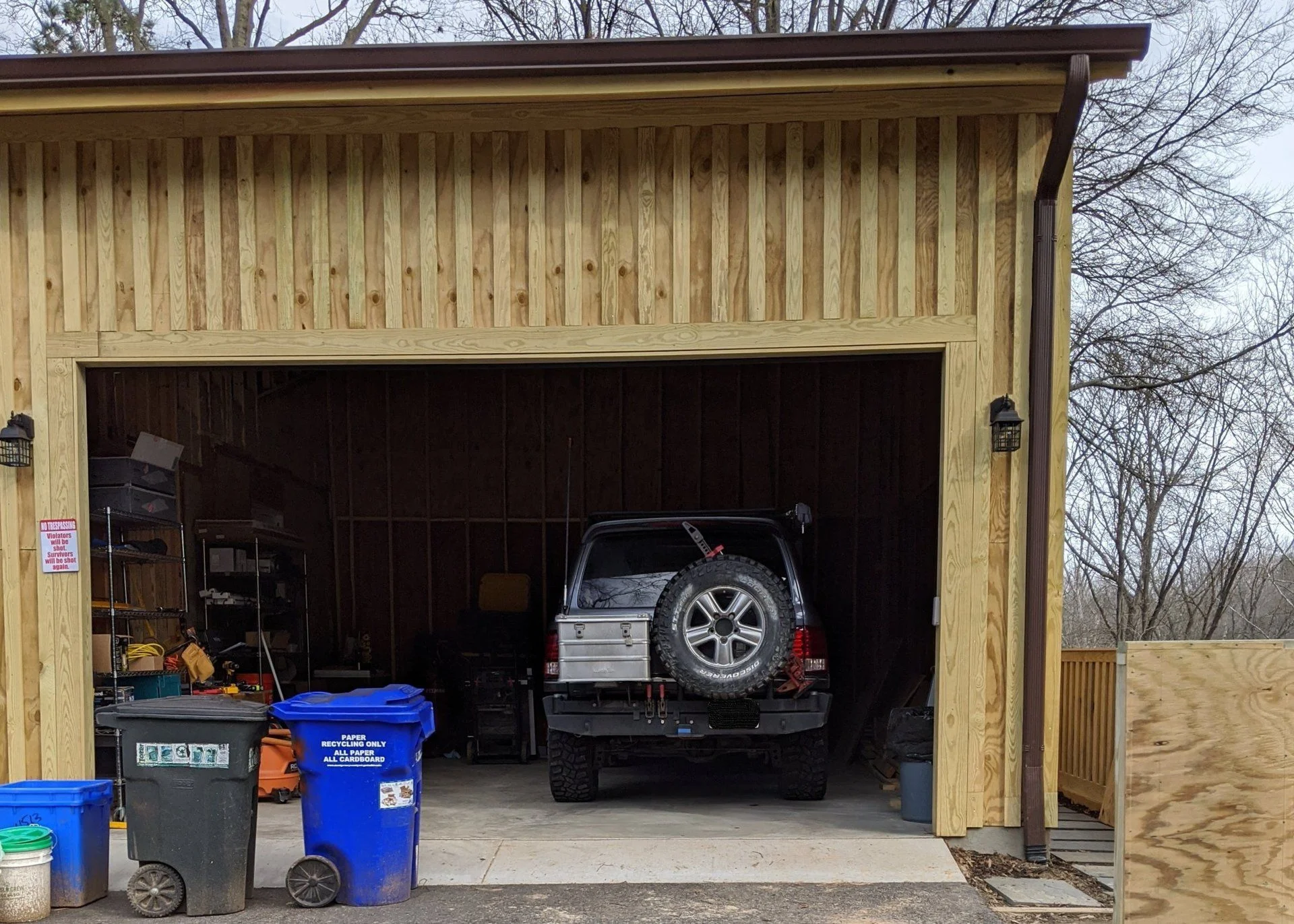

Recently remodeled my garage and now have room not only to fit my truck in but to put in a lift (15' ceiling). My ideal plan is to buy a good used lift and install it myself. Looking for suggestions or leads on anything local. Also welcome any insight from anyone who has done this themselves, from how you transported to install.

Finally fits inside with room to spare...

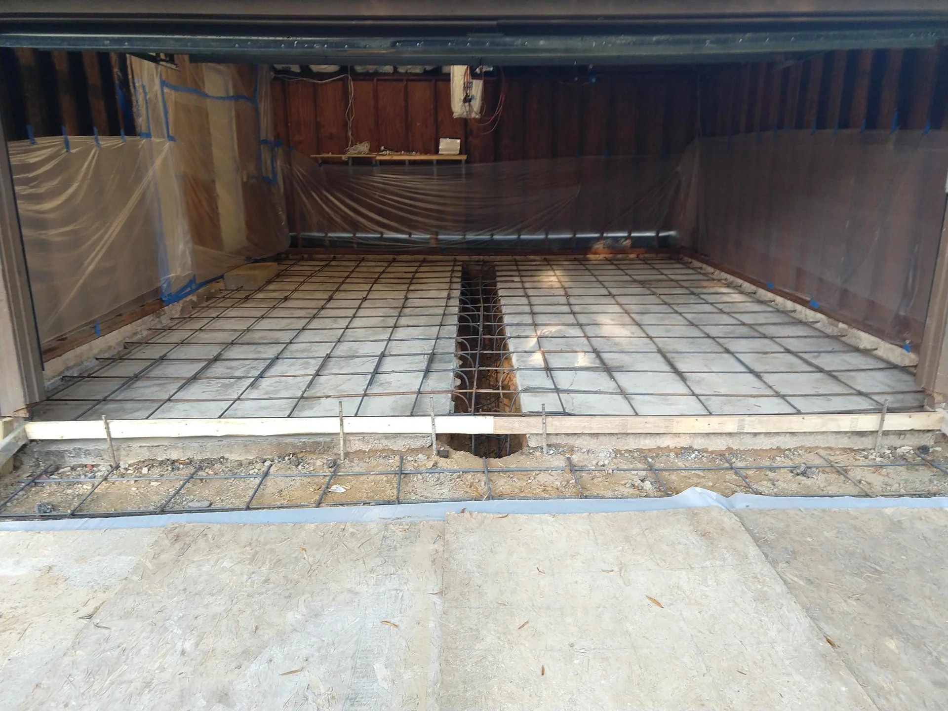

My lift ended up costing me twice as much due to thin concrete in my shop. Had to have the old concrete torn out, and a new slab poured. I forget what the actual specs are for recommended thickness.

Can't you just have appropiate sized squares repoured for the lift uprights?
Yes. Normally a 4x4 square tied in and under existing floor under each post min 4" thick. I always do 6-8". Drill your holes all the way through the concrete. That way is you take the lift out, you unbolt and knock the bolts below floor level. If not you have to cut them off flush.
Original slab was 4". One side had settled and had a crack. The solution was to dig a center trench to solid soil, use rebar to secure and pour new concrete on top. The center trench is 18" wide and 2' deep, I want one of the lift posts to sit on this (at least 2 bolts). The other side of the lift will be on ~7-8" of combined (new & old) concrete.

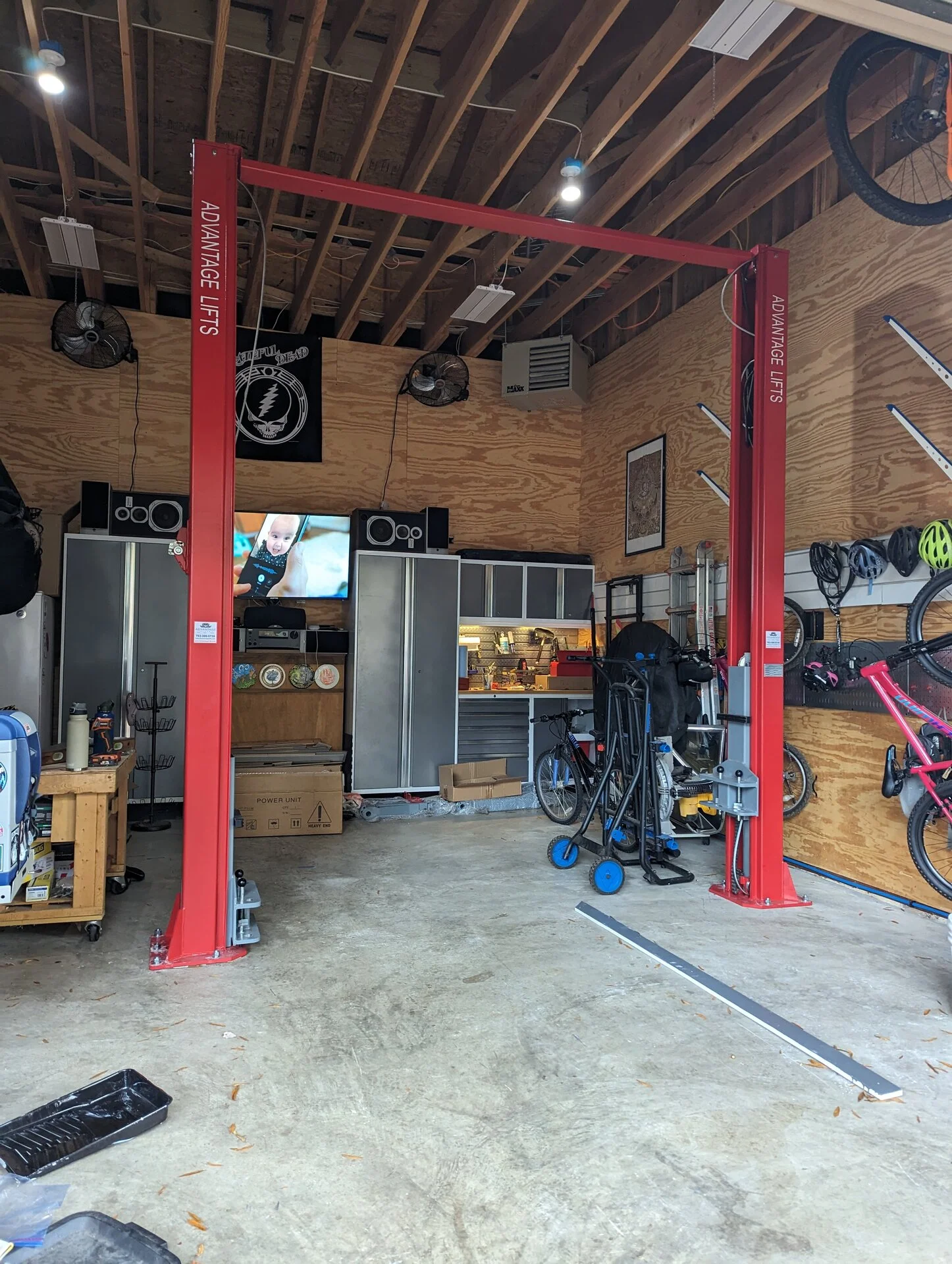

@frogers935 what 2 post lift did you settle on? Thoughts?

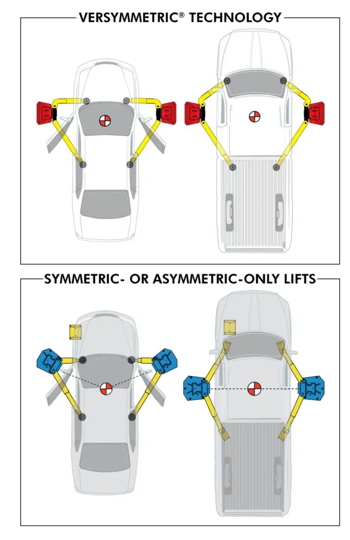

@OTRAMM - Do you prefer to lift the 80 and 100 symmetrically or asymmetrically? I am looking at an Advantage AL-SC10 and a Challenger CL10V3 as options. Big price gap between them two. The Challenger uses their "versymmetric" system allowing a hybrid of symmetry.
I have the 9k lb from these guys and really like it. If I remember correctly, I paid $3600 installed. Great warranty and North American parts used.
