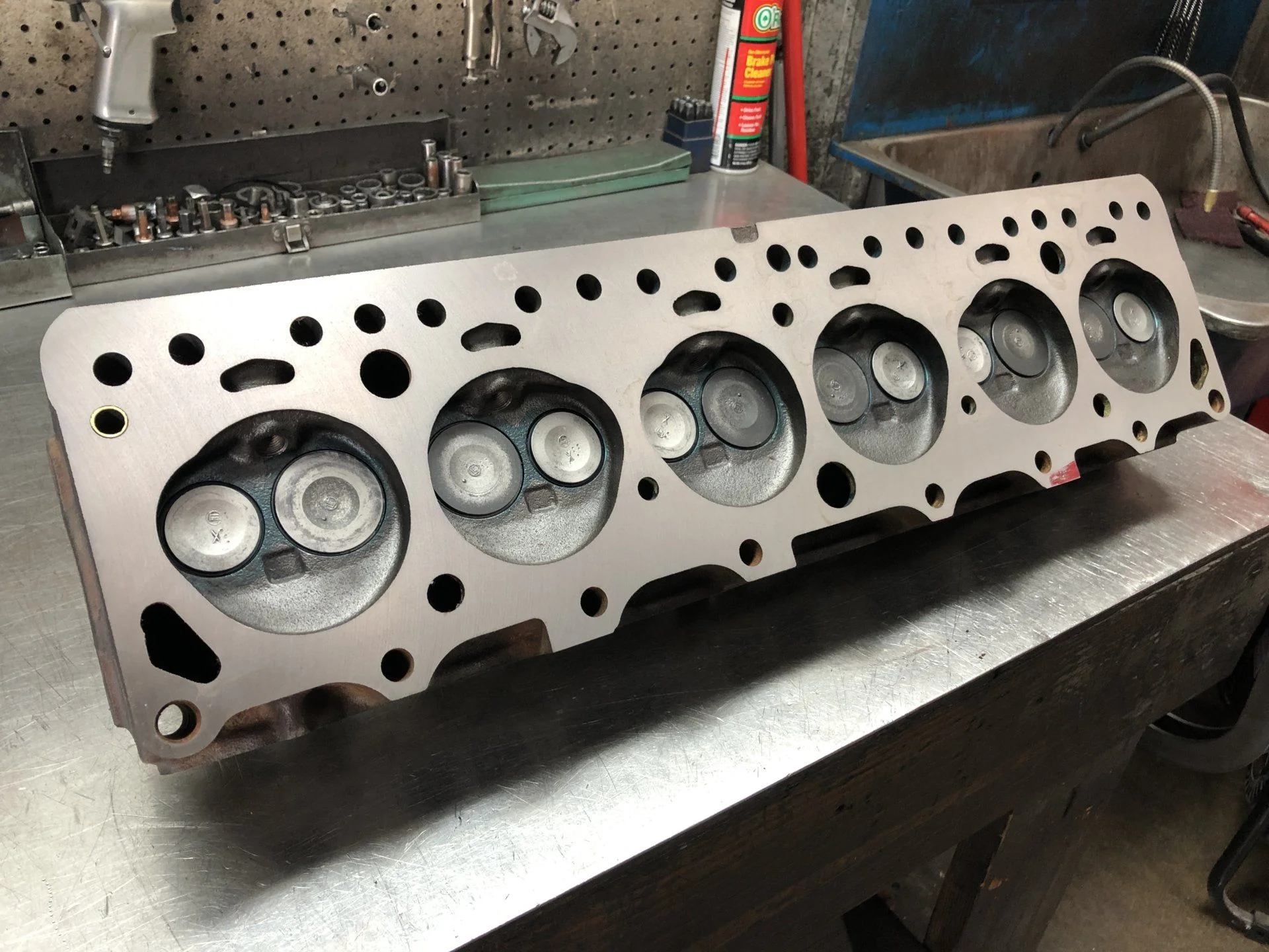

We whip the head off and its back to Knights Machine shop for round 3!
3rd times a charm, she's a go! (said in my best Australian 4WD Action accent! ):hillbilly:
1905663
Magnafluxed, exhaust valves reground, new seals, and while it was there I had them mill the head 0.40" so as to increase the compression for hopefully a little more power.

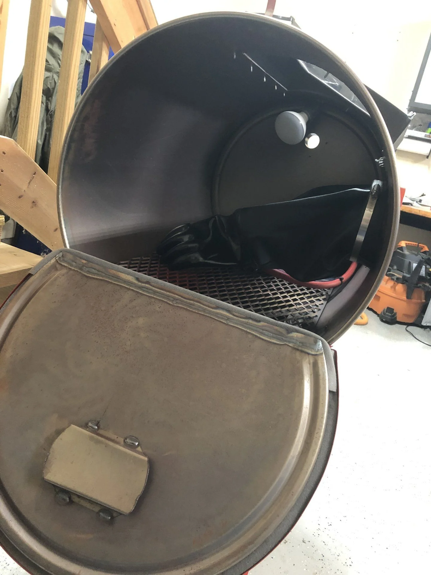

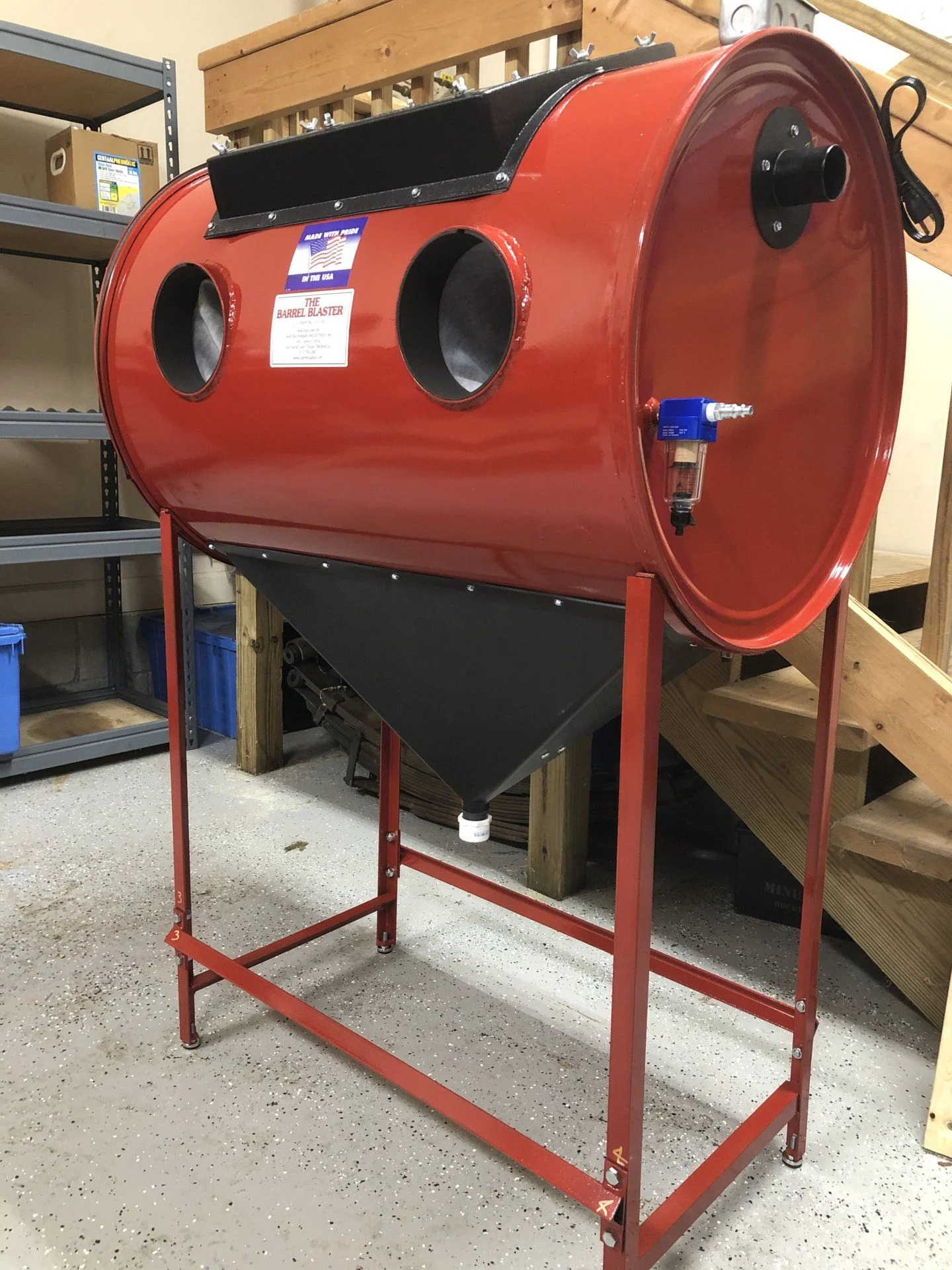

Ive also been looking for a sandblasting cabinet for a while with no joy. Ive read some great reviews on the Barrel Blaster in other enthusiast forums. Called the number down in Texas, and the owner picked up. Super helpful, family run company, made in the USA and a good price. What more can you ask for.
1905673
1905674
Really well made product, instructions all in legible English, had it together in about 30 mins.
1905675
MURICA!
Put my son to work building a stand for it to sit on with wheels so I can easily move it around my 2 car garage.

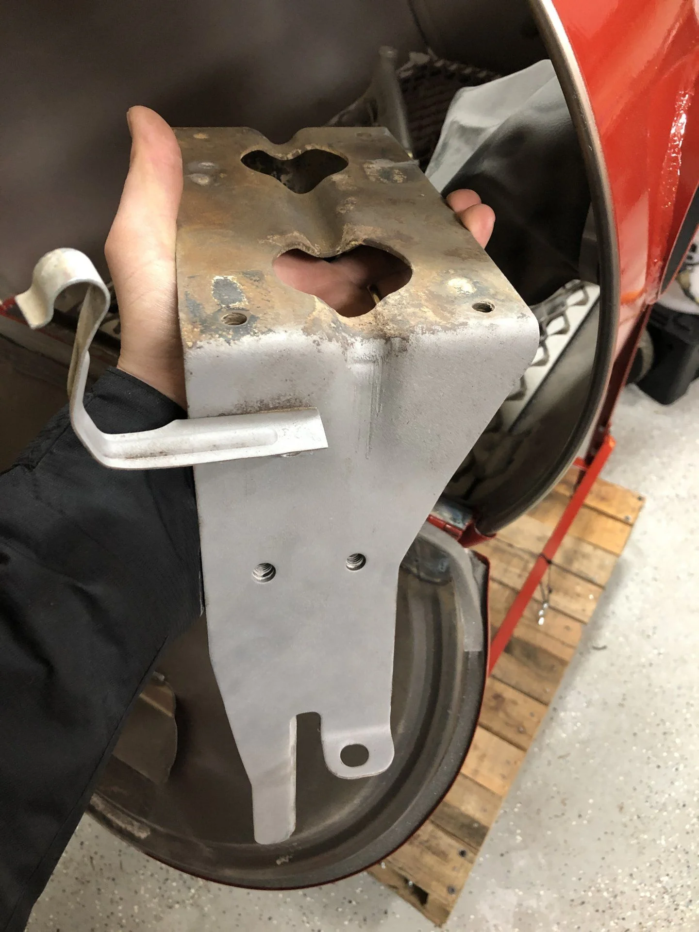

I don't have a parts washer (yet), and wanting to get stuck into it I have 2 plastic containers setup. 1 full of purple power, the other full of evaporust.

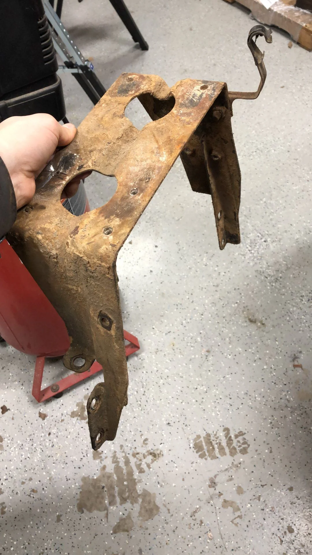

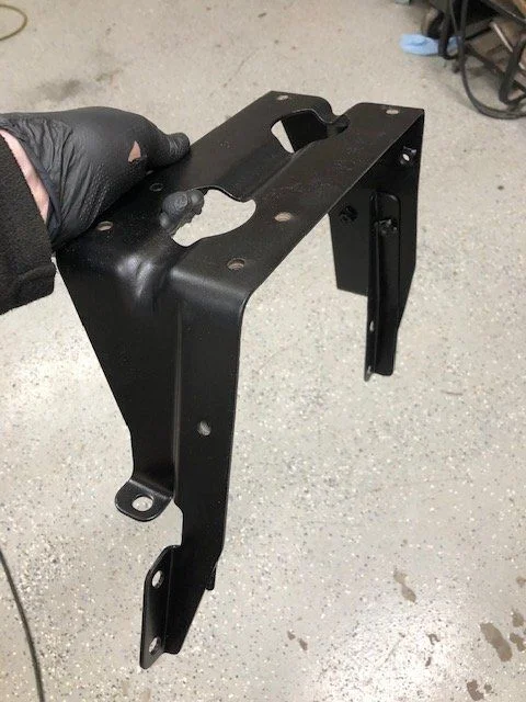

Starting scrubbing, soaking, sandblasting, prepping and then powder coating.
Its a really rewarding process giving old parts that have served us well for the past 4 decades a new lease on life.
I'll let the pictures speak for themselves ...
BEFORE
1905678
DURING
1905679
AFTER
1905680

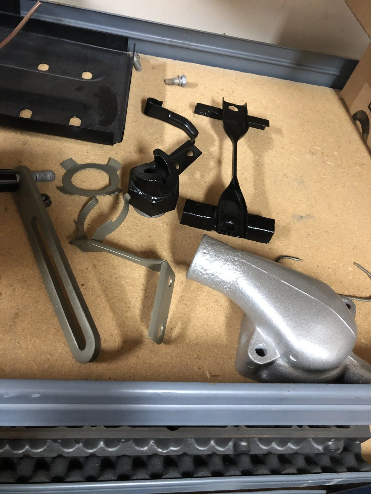

Some 3B parts after sandblasting waiting to go in for powder coat ...
1905681
After ..
1905682
1905683
Misc parts
1905684

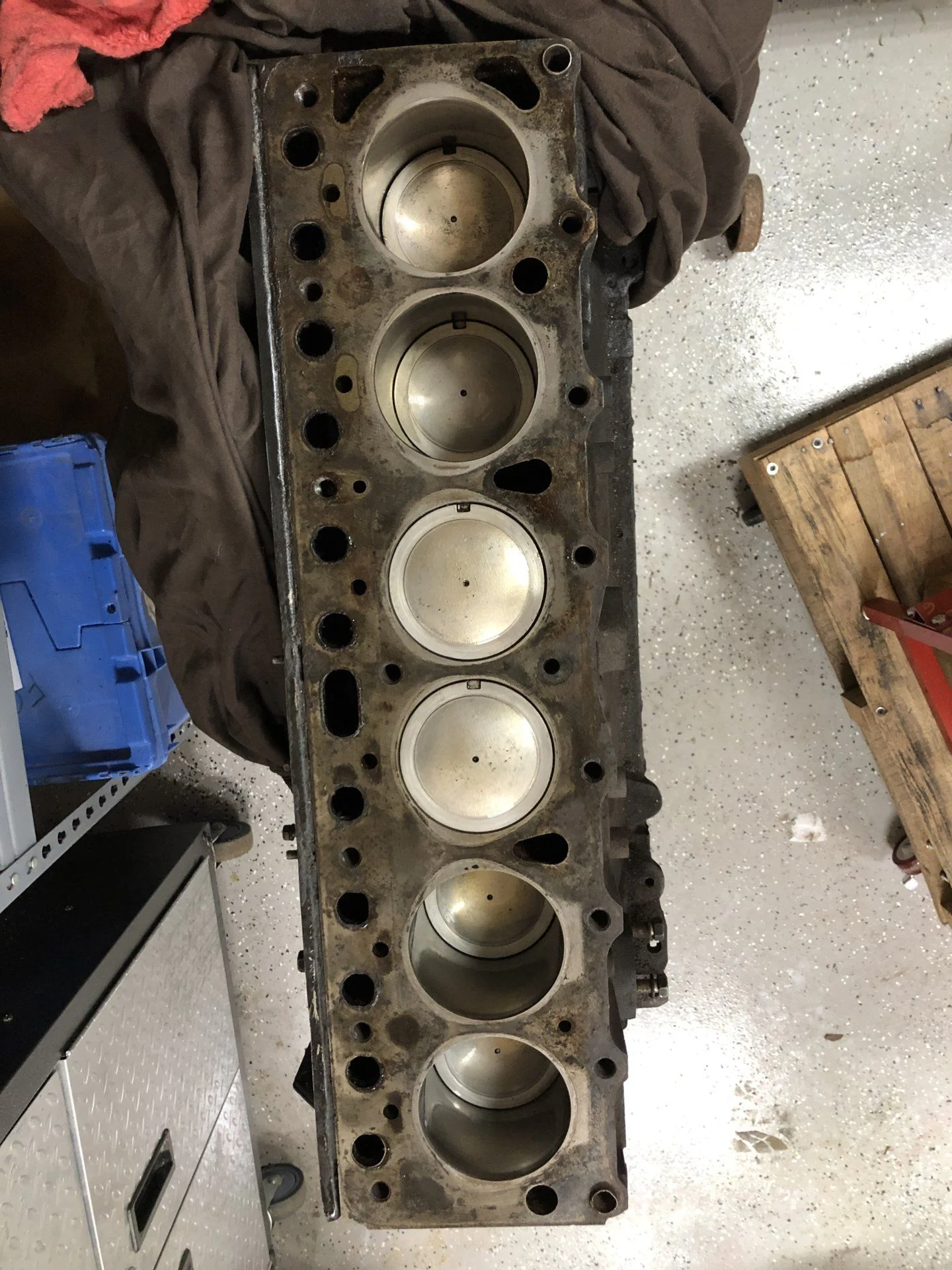

A little history on the engine from what we know. Its a 1977 that was pulled out of an FJ40 with 89k on the clock. At the time it was pulled its previous owner said the compression numbers were 120 across all 6 cylinders.
My plan is to tear down the engine and install a new set of piston rings, all new seals and gaskets, clean it, paint it, and slap the H55 I have sitting on the garage floor behind it.
Once the engine is out of Lucille, I'm going to clean up the frame and POR15 it, address the vague steering, and tidy up the wiring.
I can't decide if I want to paint the engine bay the factory color, or do a Lizard Skin coating.
They both have their advantages. I do like the idea of the heat and noise shield properties the lizard skin provides.
What do you guys think?
Anyway, cleaned all the carbon deposits off the top of the pistons, pulled the timing cover off, removed the crankshaft, took the side over off, removed the lifters. Flipped it over and removed the oil pan and thats where we stopped until more parts arrive

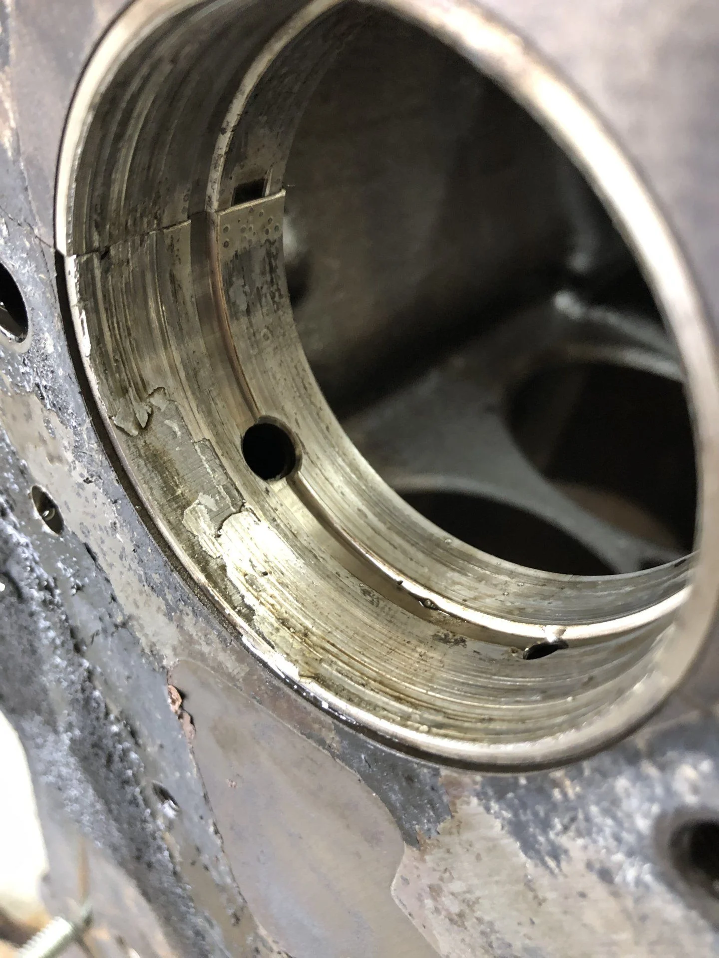

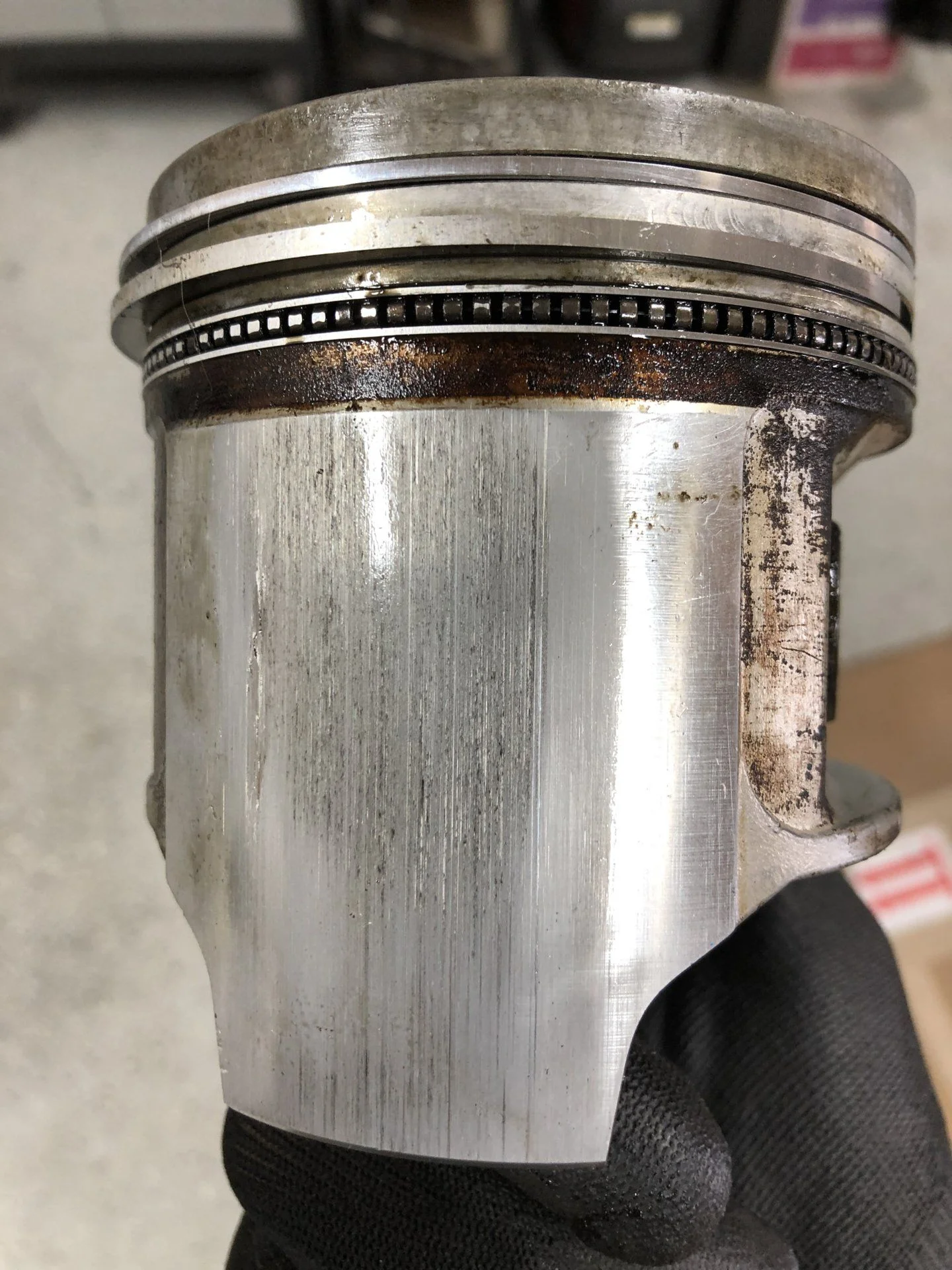

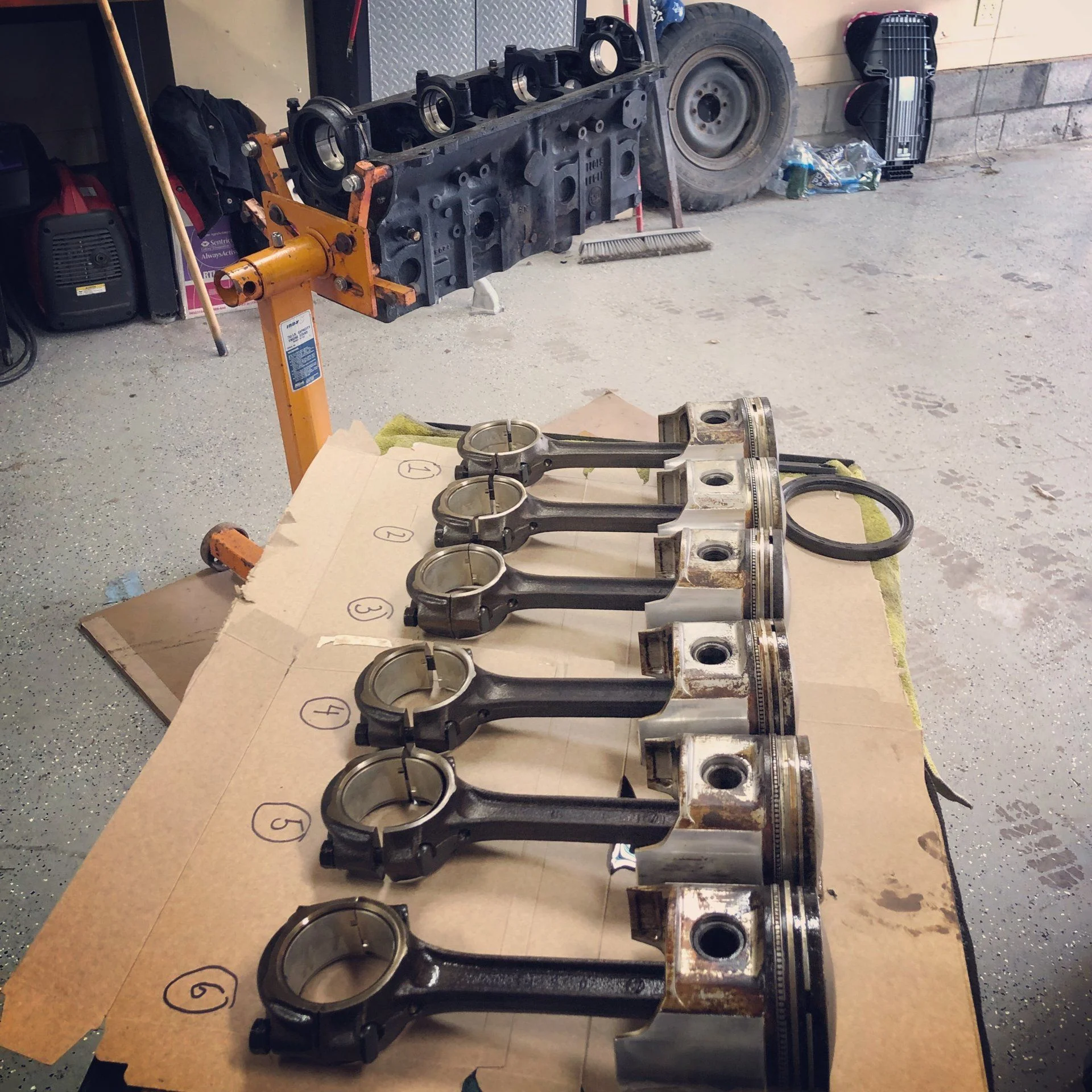

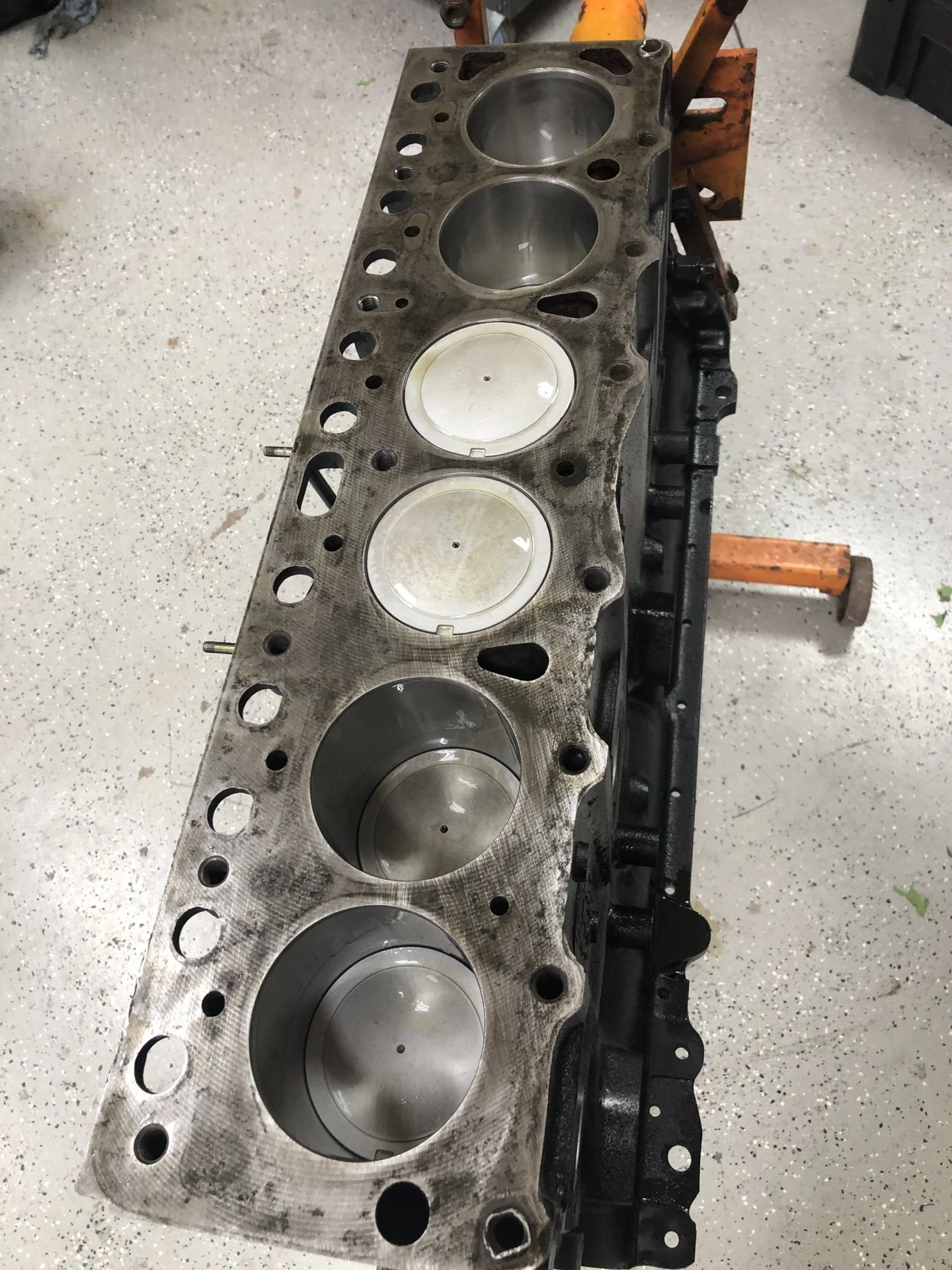

Today was engine tear down day.

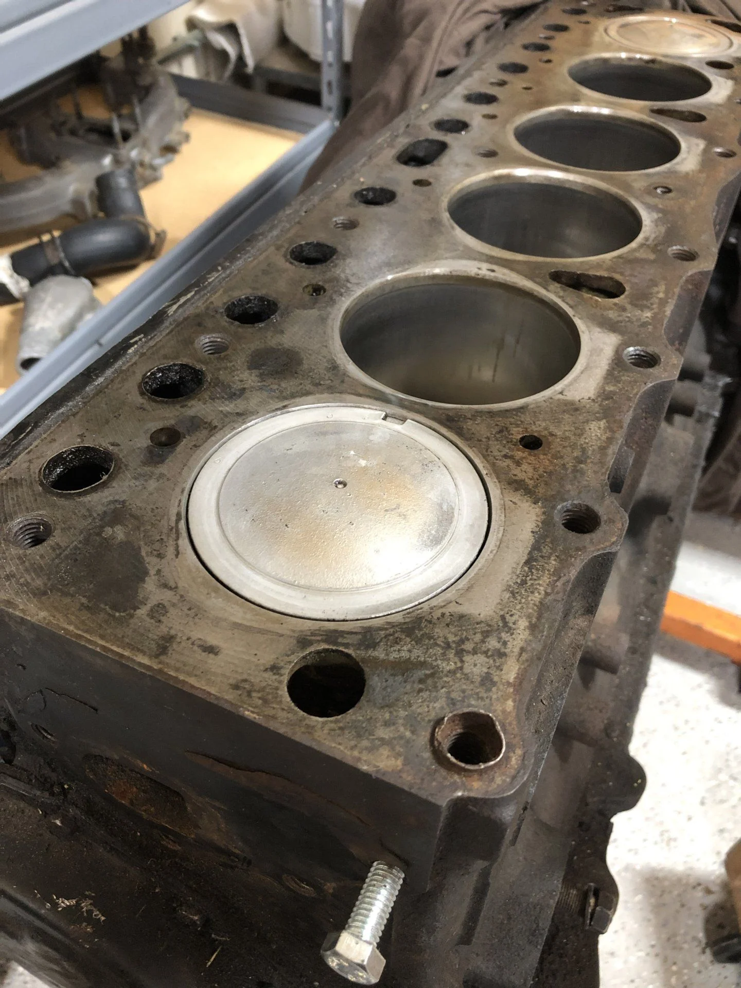

Was hoping to open her up, pull the pistons, hone the cylinders, install new rings and put it all back together ..... but .... as we all know when you open pandoras box things can get ugly
Score marks on Piston #5.
Cylinder walls seem ok though
1915315
1915317

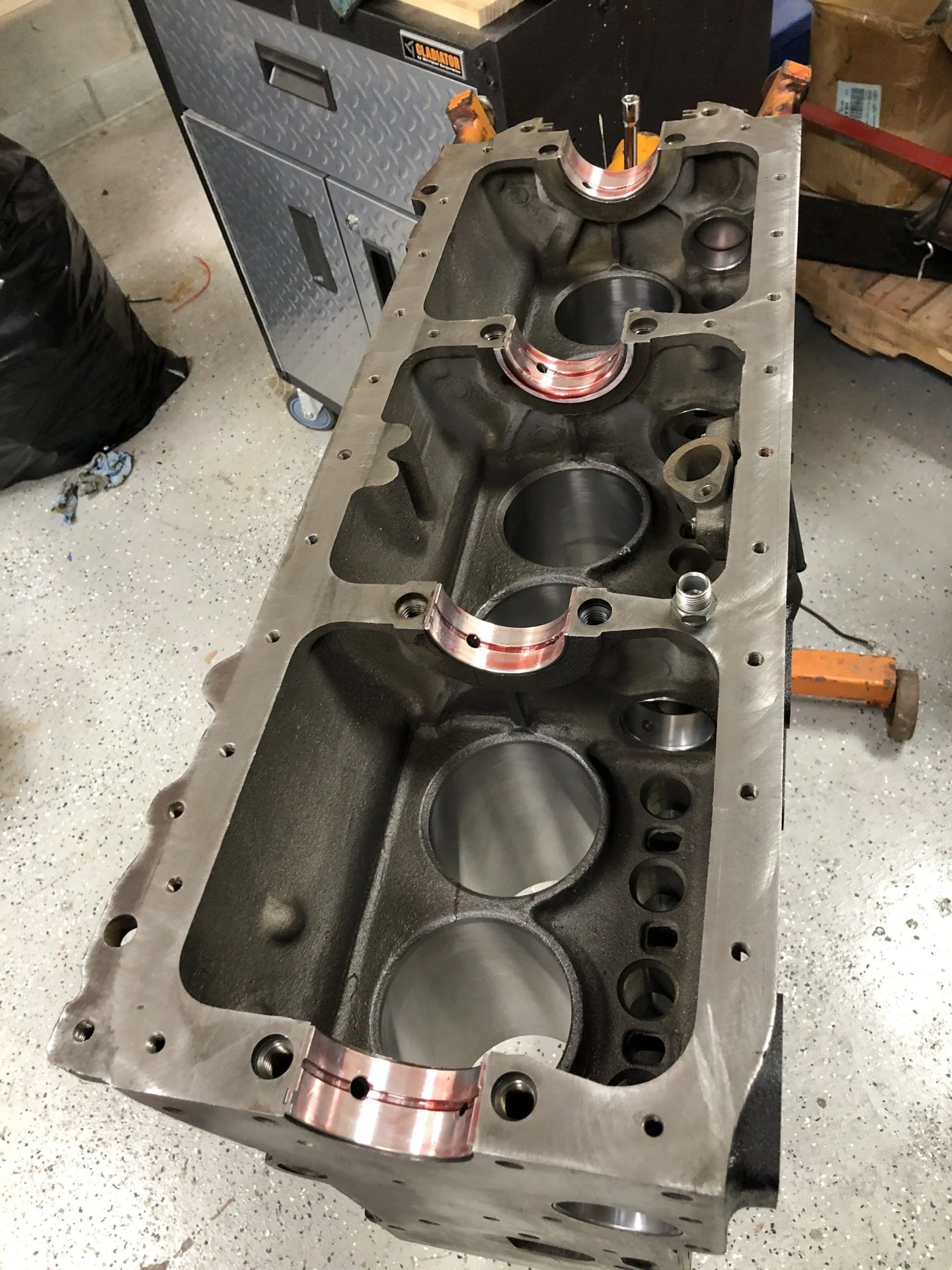

Then we discovered that one of the main bearings the crankshaft rides on to be bad. But again the crank itself "seems" to be ok
1915319
Decided that seeing as this was the case and they needed to be replaced anyway, Ive dropped it off with the machine shop to be checked for spec, new bearings and then hot tanked.
I really hope this engine isn't toast :rolleyes:

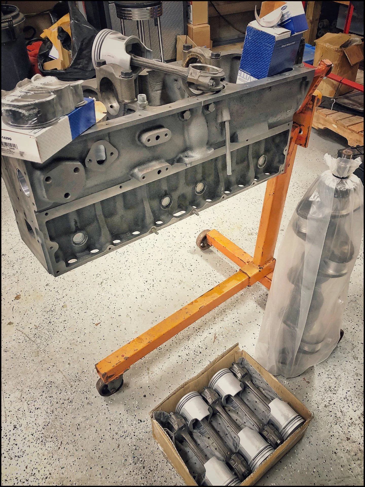

Its been a while since i updated this thread. Been making some steady progress but slacking on the updates

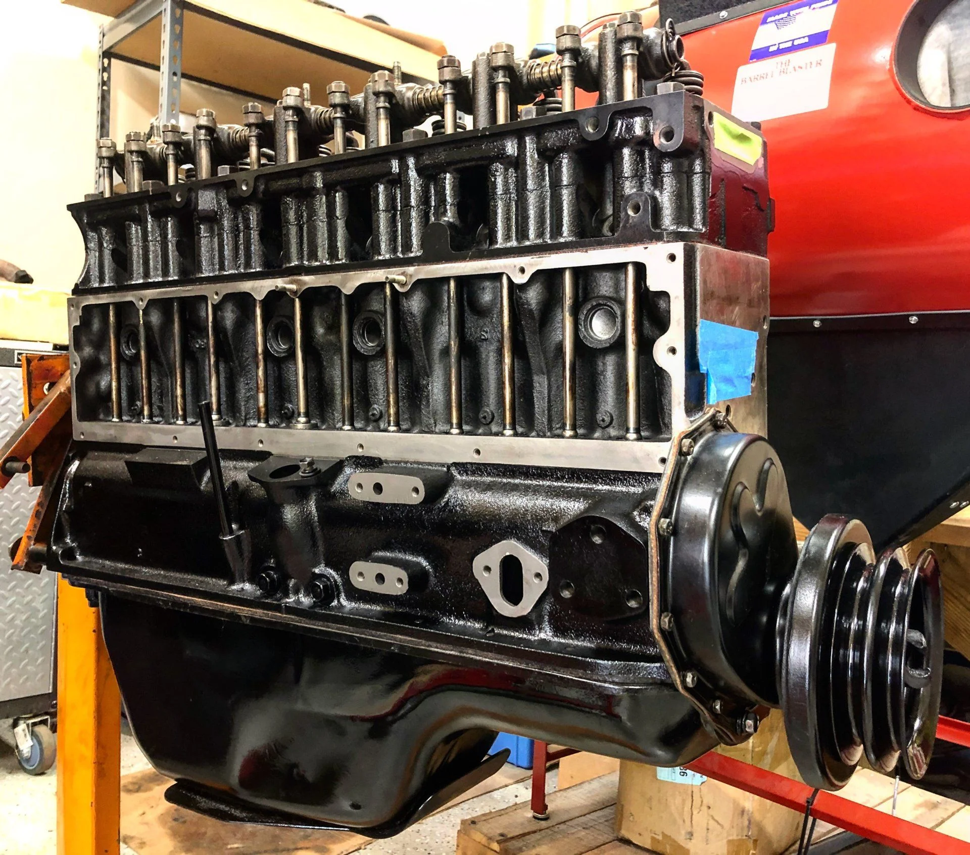

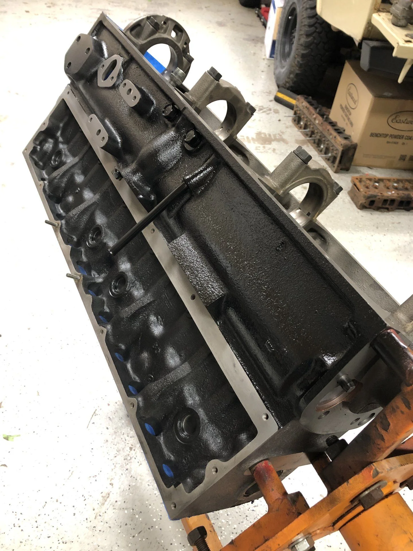

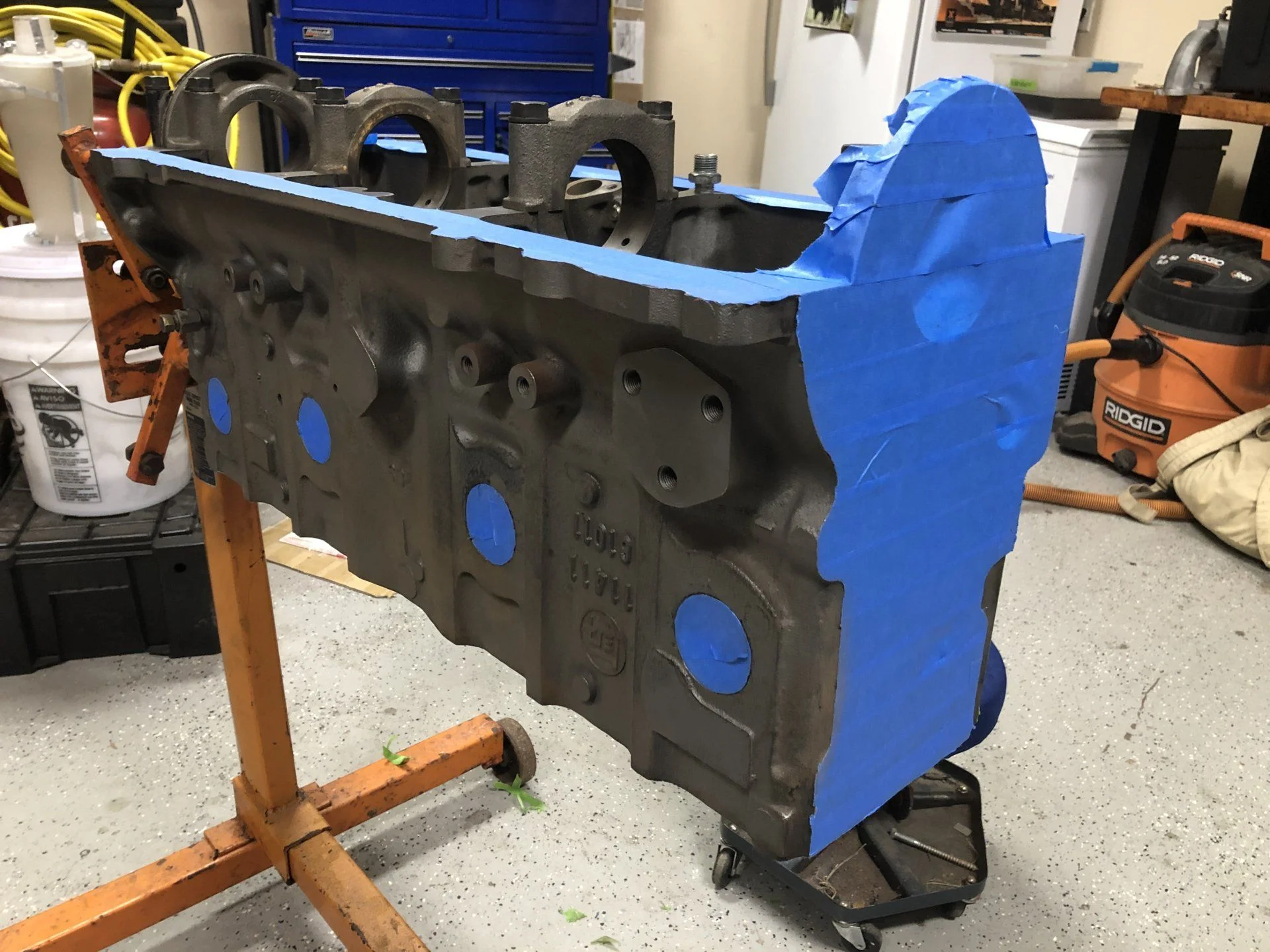

Good news, the engine came back all within spec and the pistons were cleaned and blasted, so re assembly has begun
1999104

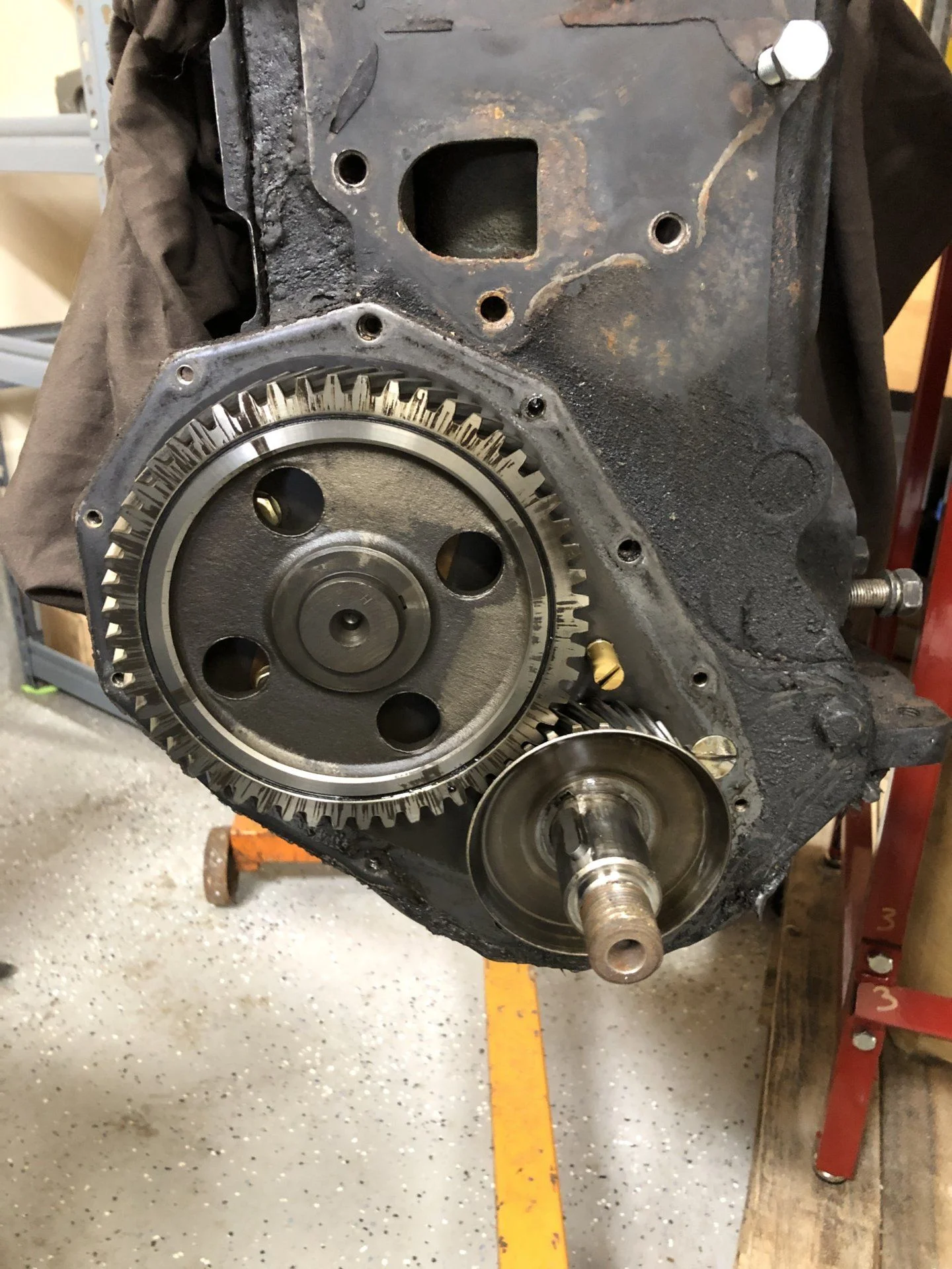

Started off with a little VHT engine paint, then new cam bearings, piston rings, cam and crankshaft
1999107
1999109
1999111
1999115

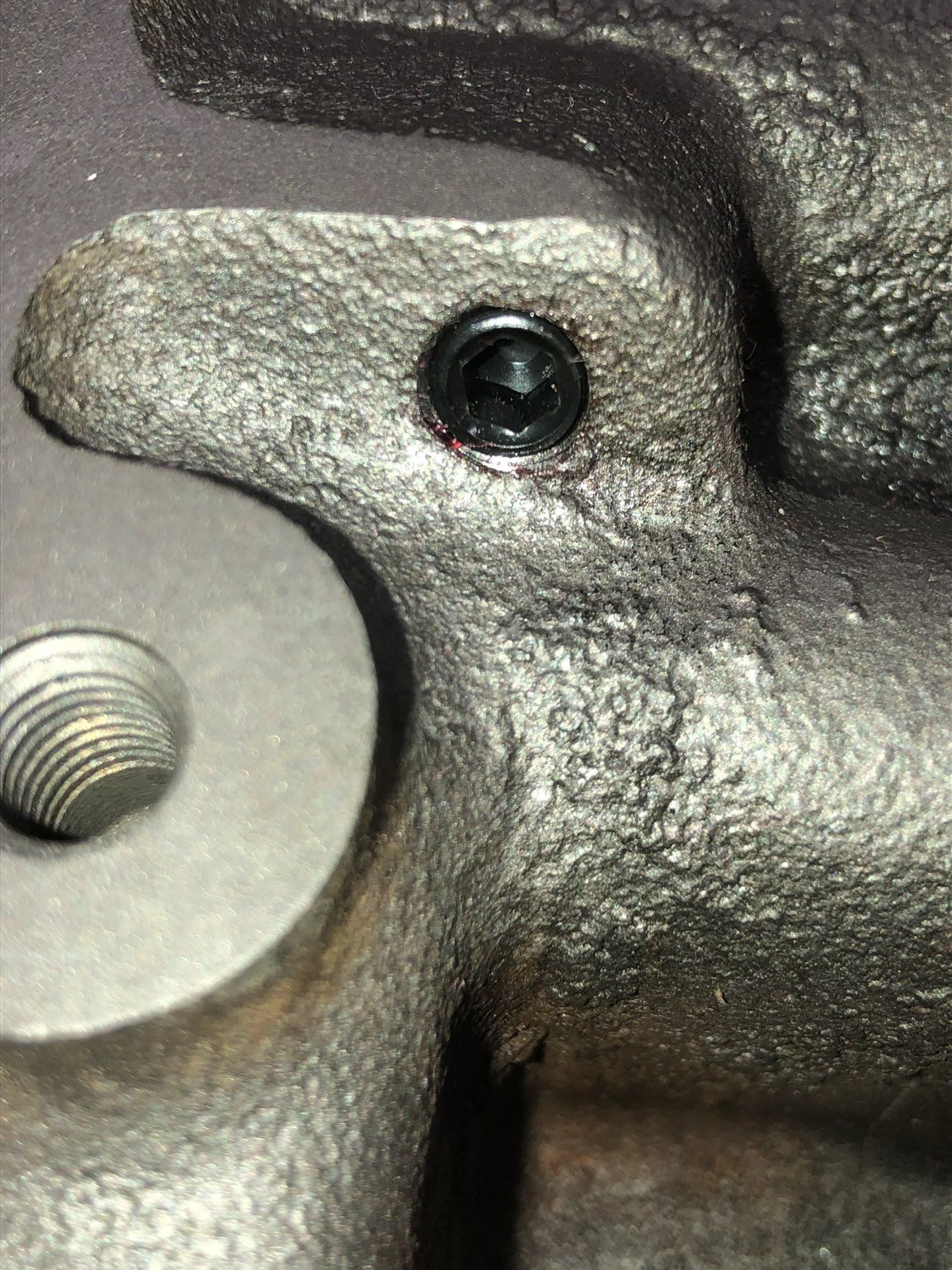

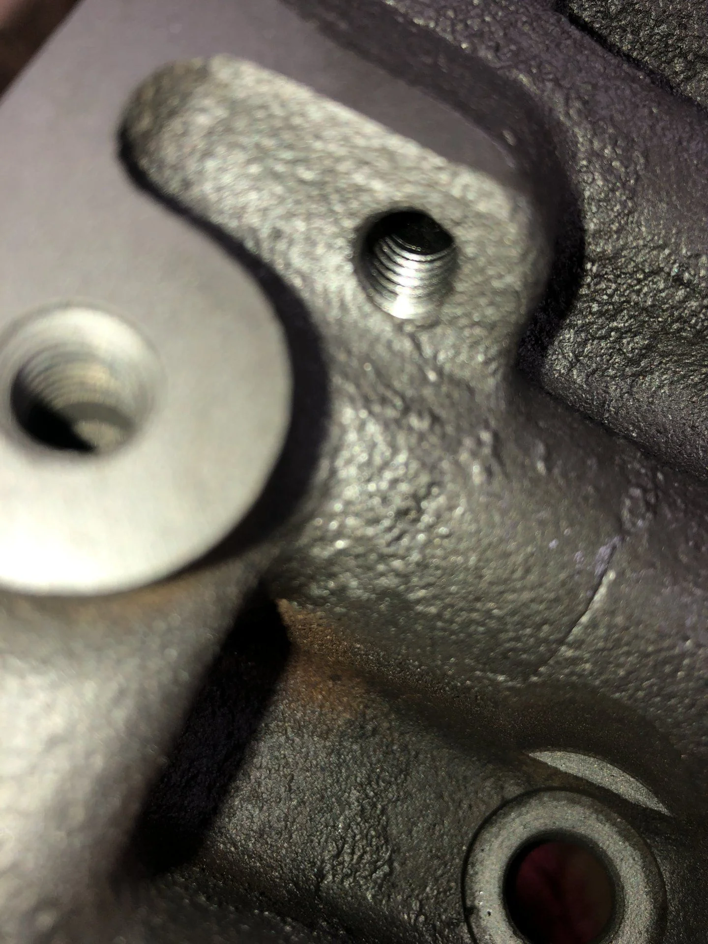

I also drilled, tapped and inserted a plug into the oil galley plug. Added a little red Loctite for peace of mind
1999123
1999124

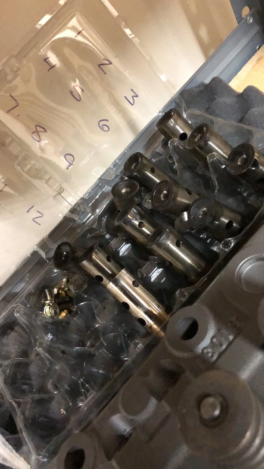

Timing gear in, new crank pulley key in, timing cover on, oil pan installed, pushrods and reground lifters in, head on and valve train torqued down ... she's starting to take shape
