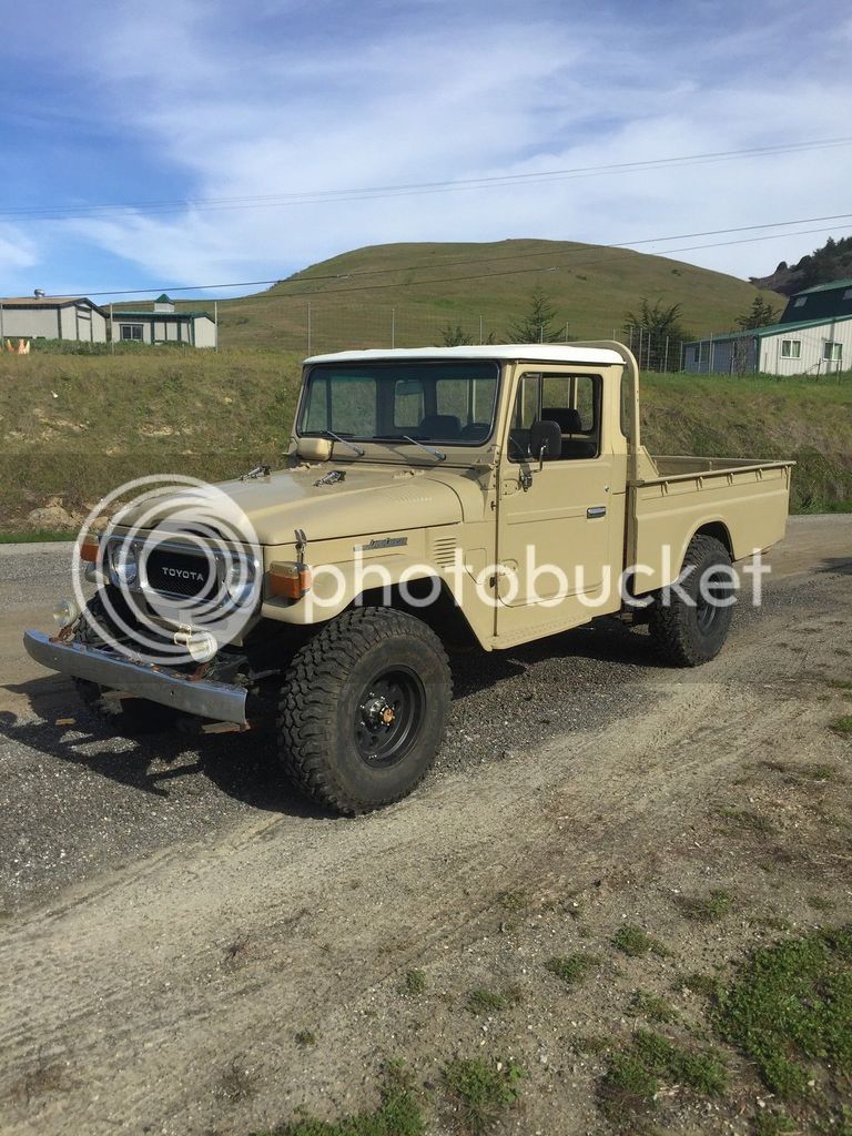

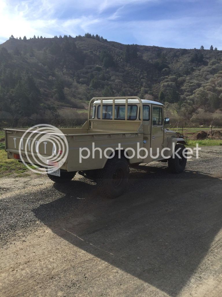

Then popped up this 1982 dune beige long bed at a price that makes you ask yourself “whats wrong with it?!”
Spoke with the seller on the phone, turns out he’s a cruiser addict too, owns another FJ45, FJ40’s and has too many toys.
This one was imported from the middle east to Tennessee of all places, sold to this guy in California who was having trouble registering it due to all the smog and emission regulations over there so decided to put it up for sale.
We came to an agreement on price then @Tennessee80 and I jumped on a plane West bound!

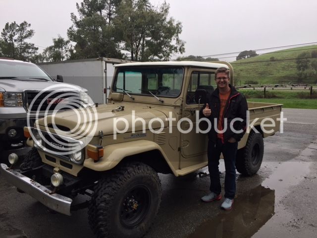

It was great having Joel there as another set of eyes. We both liked what we saw and did the deal.
Joel and I got to hang out at Fishermans Wharf that night eating seafood, drinking beer and talking shop, it was brilliant! What a day!

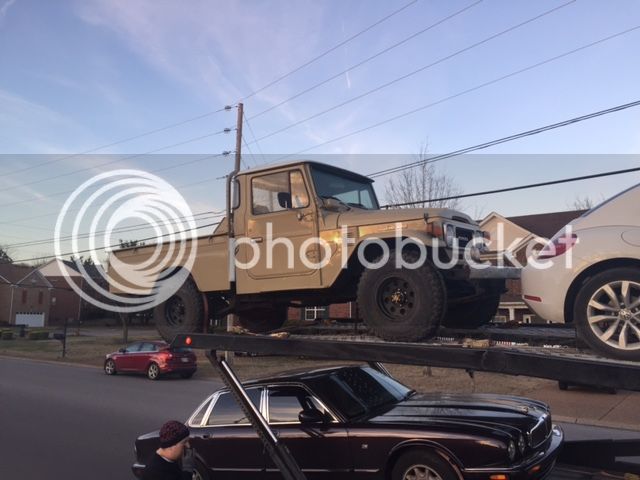

We airlined back the following day and a transport truck showed up at my house just 5 days later.

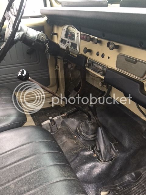

She needs some love here and there, but overall for a 35 year old truck its solid with very little rust in running and driving condition. The 2F seems strong and purrs like a kitten
Aside from the factory power steering its completely bare bones - no heat, no A/C, no radio, no seat belts and I love it!
Plans right now include going through it front to back (compression test, fluid flush) doing a refresh, putting gas in it and just enjoying it.

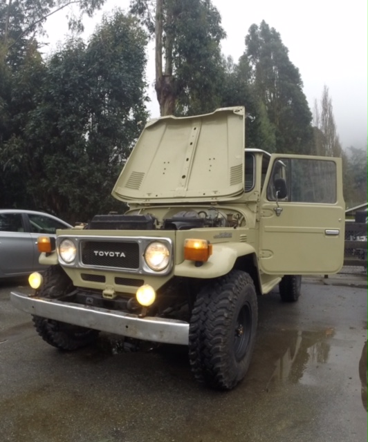

Did the deal! :bounce:
Being unloaded

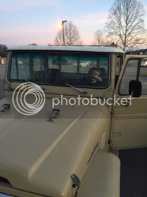

My 8 year old jumped in it and wanted to drive it the minute it rolled off the transporter!

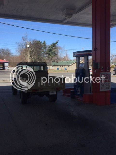

1st tank of pure gas! :hillbilly:
I drove 70 miles the first day, couldn't get out of it or wipe the grin off my face!

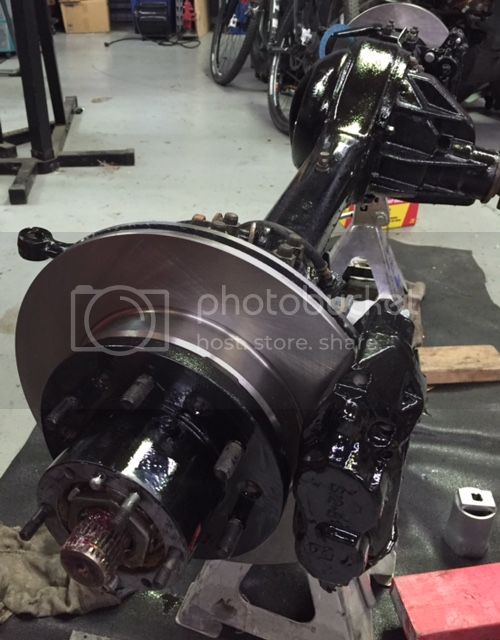

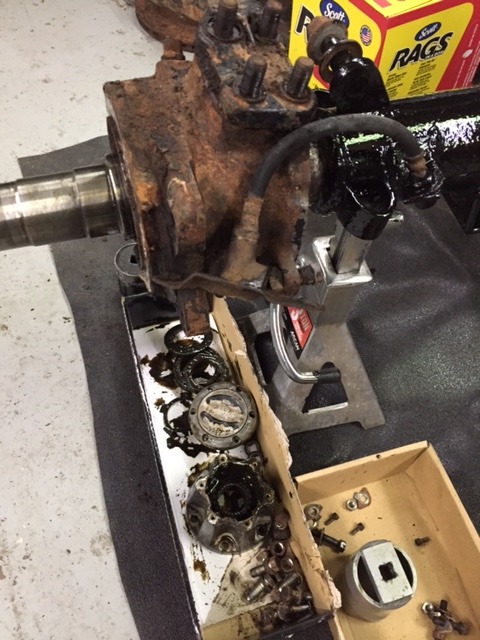

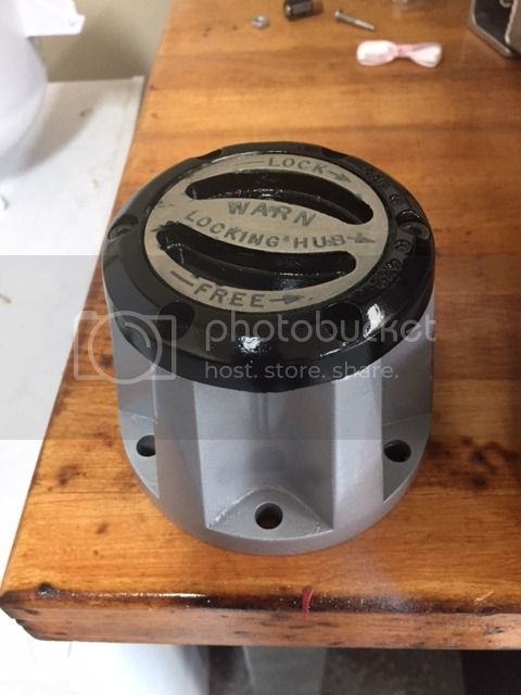

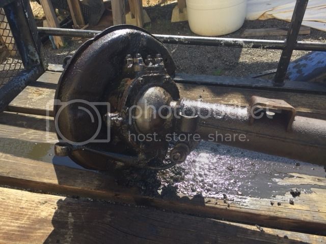

Havent updated this in a while so here it is ... after fixing the trans seal I decided to look into the brakes as she was pulling to the right when braking. Pulled off the front wheels only to discover it has 4 wheel drum brakes :confused:
I decided to pull off the front drums to see what was going on, and thats when I really opened pandoras box!

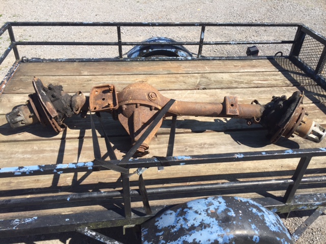

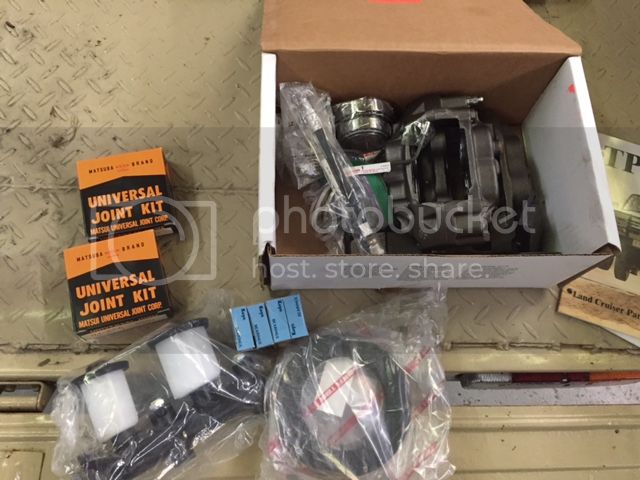

Got the idea in my head to do a front disc swap so set about looking for a conversion kit. Ordered one from JT outfitters but after messing around with it and talking to Bobby at TPI as well as other cruiser heads we agreed this wasn't the route to go.

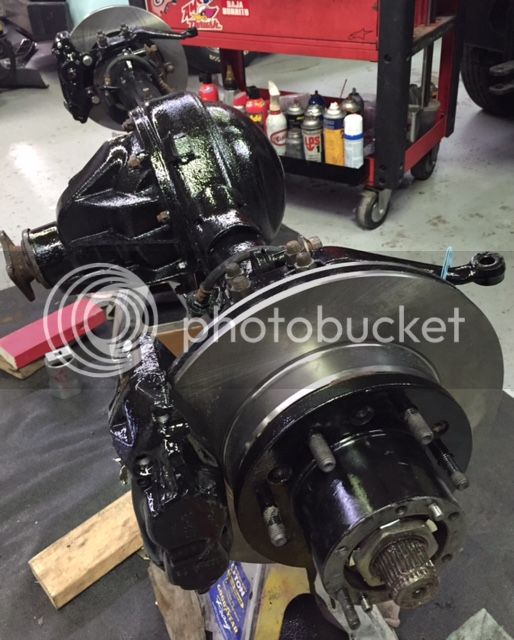

I found an FJ45 front disc axle and then spent the next month doing a complete tear down and rebuild. Hit a few obstacles along the way (like discovering my truck has 4.11s and the donor axle 3.73 amongst other things) but Im happy to say this was a worth while upgrade. I swear it stops better now than my hundy!
Here are some pics ...
You should have seen the look on my wifes face when I brought this home! :rofl:
Just a handful of new parts that went on
Before...
After ...
Done
