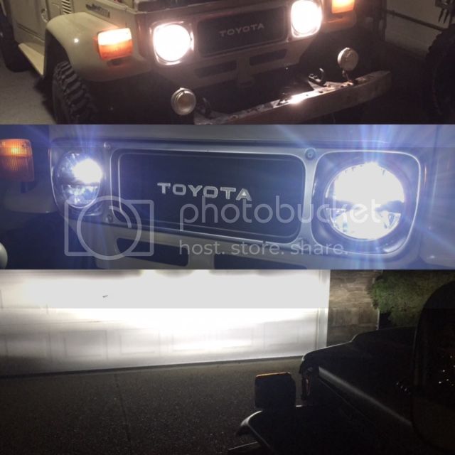

Ive lost count of the worn out parts I've replaced in the short time I've had the truck but one of the easiest was this one ...
I was working on some wiring when the back of the left headlight just fell off!
I think it was held on with hopes and dreams LOL
Went with these from city racer. For only $129 the light output compared with stock can't be beat
