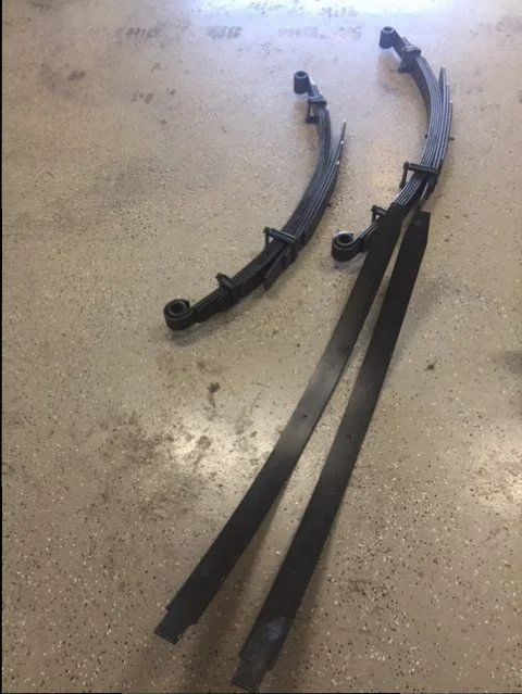

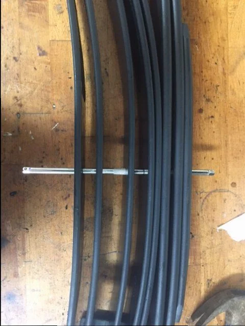

Had some time after work today to remove a leaf from each of the rear spring packs to get ready for the rear install

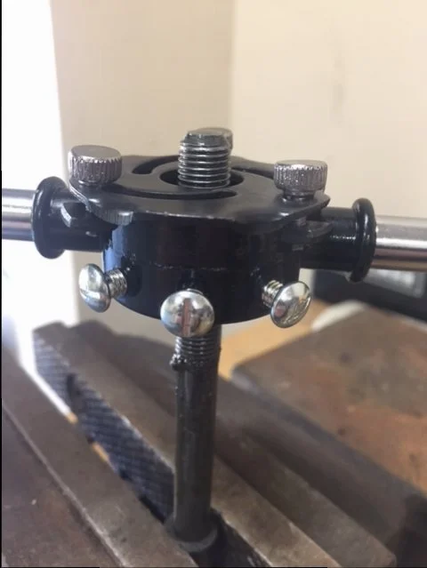

Somehow managed to strip the threads on the center bolt getting it out of one of the packs. Not sure how as i wasn't beating on it .. oh well trusty harbor freight tap and die set to the rescue!
It would appear I now own a set of Old Man Emu skis if anyone needs to borrow them this winter! :p

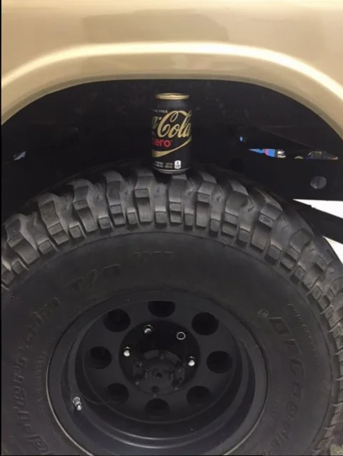

Got the drivers side rear off and about killed myself in the process! Damn these things are heavy!

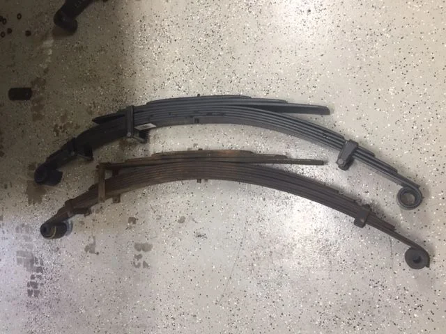

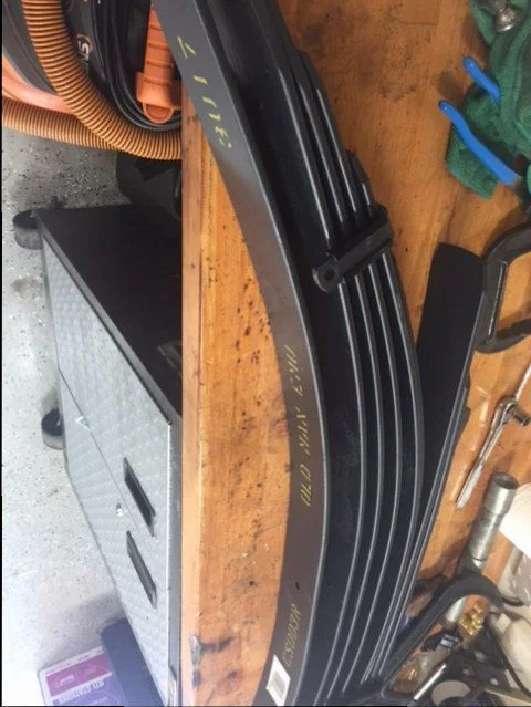

Old vs New -- 10 leafs in the old pack! :eek:
Do you think these needed replacing?!?

I don't need them, just don't want you to throw them away. I got a buddy that does some black-smithing. He makes knives and other trinkets out of them and Japanese spring steel is some of the best around for knives and such. I keep an eye out for stuff he can use.
If you can't get rid of them, let me know, I just wanted to make sure they weren't going to scrap.
Amusing switch. I added a leaf to the OME springs I have on the rear of my BJ70. They were the heavy duty models but needed a little more help for how I load my truck.
Also, I have found that keeping old springs around can be handy. The spring on my FJ40 were drooping under load, so I pulled two leafs from old packs that I had. After rebuilding the spring with two leafs added to each pack, the springs don't droop and flex well on the trail.

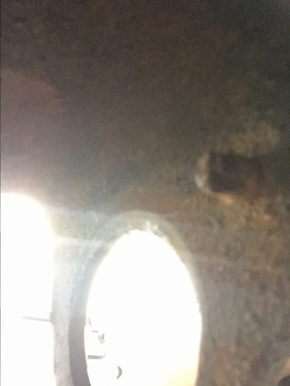

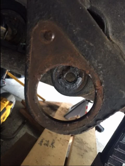

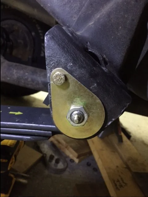

On the passenger rear fixed shackle, the bolt that locates the hangar pin was sheared off some time in the trucks history.

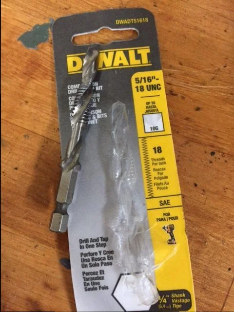

Spent about 45 minutes trying to drill out the old bolt and re-tap a new hole with my trusty harbor freight tap and die set before I broke down and picked up one of these combo drill and tap bits from Dewalt for $9.
Got to say these drill bits are brilliant. 10 seconds after loading it into my impact I had the hole tapped for a fresh grade 8 bolt.

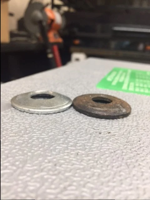

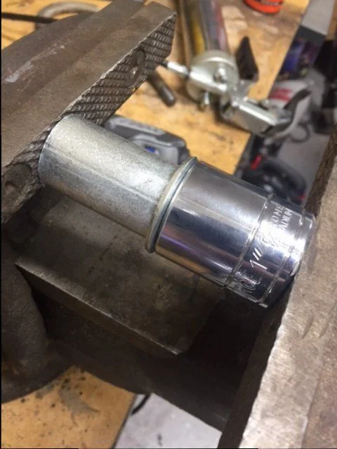

Next issue: Somehow i managed to loose a shock cup washer for one of the rear shocks so set about making my own using a 1" socket and a bit of pipe I had laying around. Havent finished it yet but looks like it will do the trick

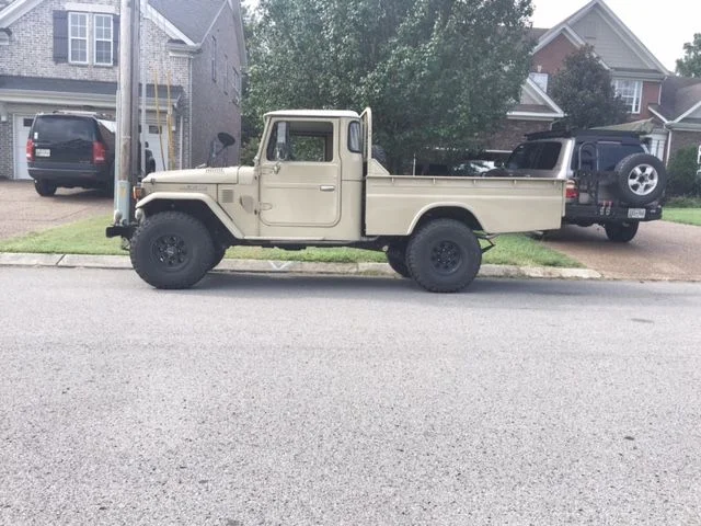

So I rolled the truck outside after finishing everything up ... here are some before and after shots
BEFORE:
AFTER:

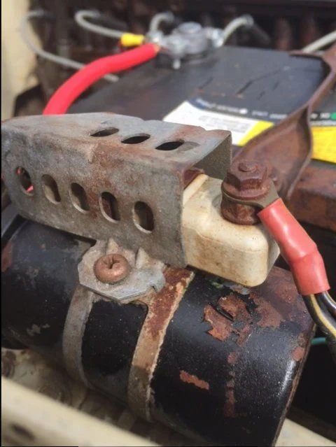

Went to take it for a test drive and it wouldn't stay running long enough to get it out the driveway ... opened the hood and this little white resistor was smoking
I have another used one that is sitting in a box Im going to switch it out for.
What coil system do you guys recommend?
Again Im not sure what direction I want to take this truck yet so don't want to spend a whole lot of money. TPI recommends their Firecracker ignition, others a DUI unit.
What say you fellas?
You can use a 6 cylinder gm hei with a little modification. You have to use the Toyota distributor gear. It's a all in one system. Just have to connect one wire.

Thanks for the responses guys. I switched it out for the other one I had and no joy. Put the old one back on and now it won't even fire.

Here's some dizzy information I used before. Also, there is some info on bypassing the ballast resistor, too.
Dizzy FAQ
There are also many good threads in the 40 section on getting the dizzy sorted out.
