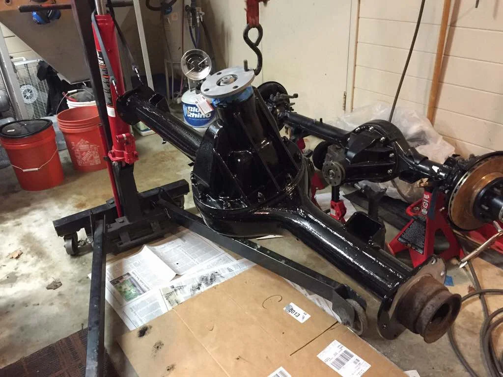

Building up parts for the rolling chassis. My wife gave me an early 23rd anniversary gift Friday.

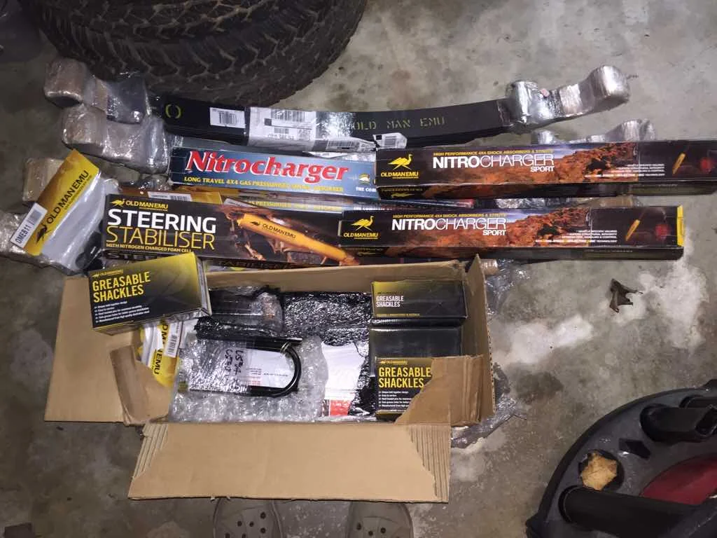

OME kit, soft. Greaseable shackles.

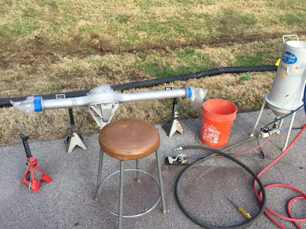

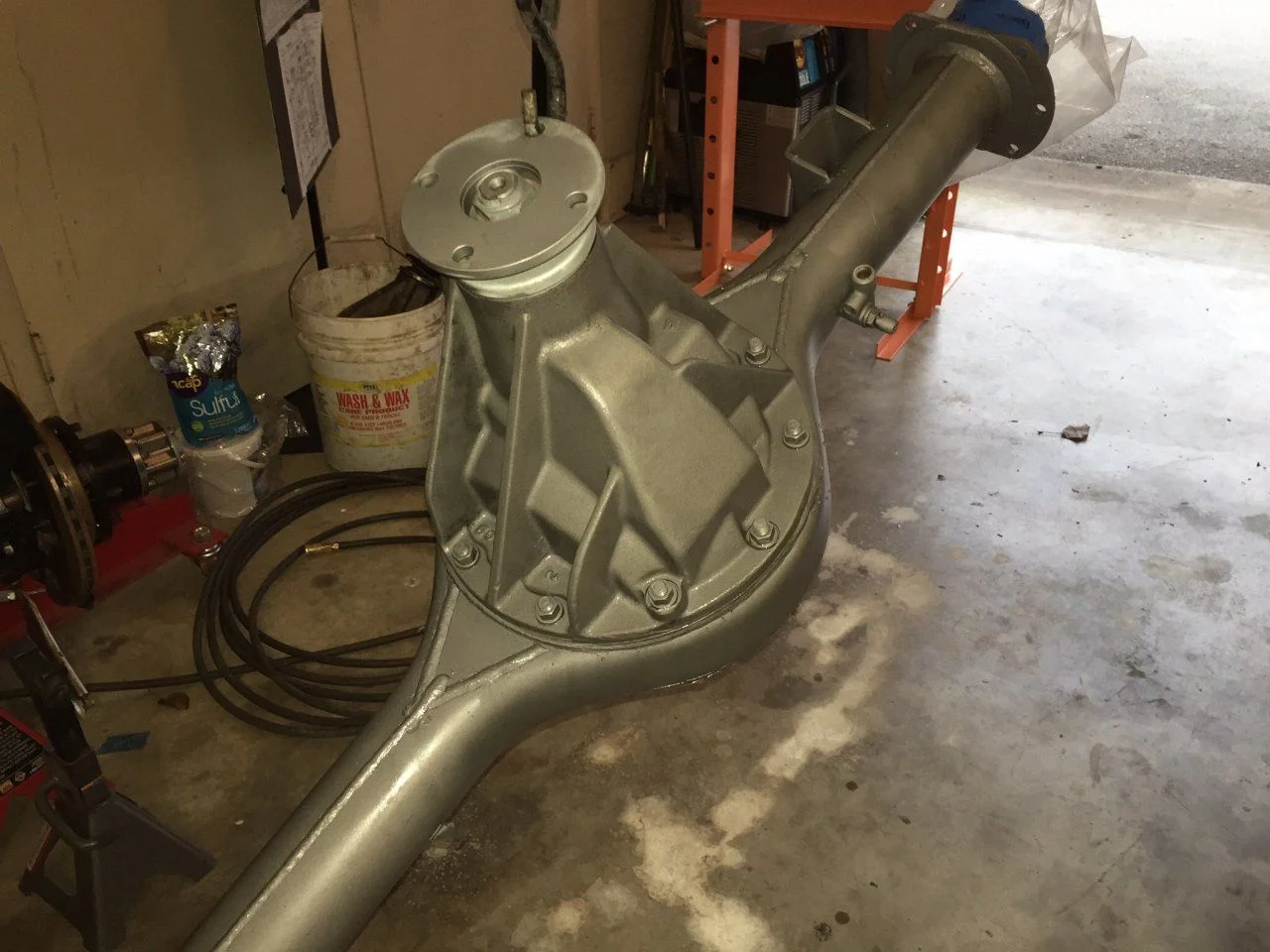

I finished the rear axle blasting this PM. Looks better in photos than in real life, but it's clean and ready to be painted.
I put the first coat of phosphoric acid on it to keep the rust at bay. I'll wash it, sand a bit, recoat again and let it dry, wash it off, dry it, and POR it 2 coats, then overcoat with Rusoleum brushed on.
Next, rebuild the rear diff, clean the grit that got into the axle while blasting even though I taped and covered the ends. VtgBeemer kept warning me about this - "Don't blast rotating parts." I wish I'd listen.

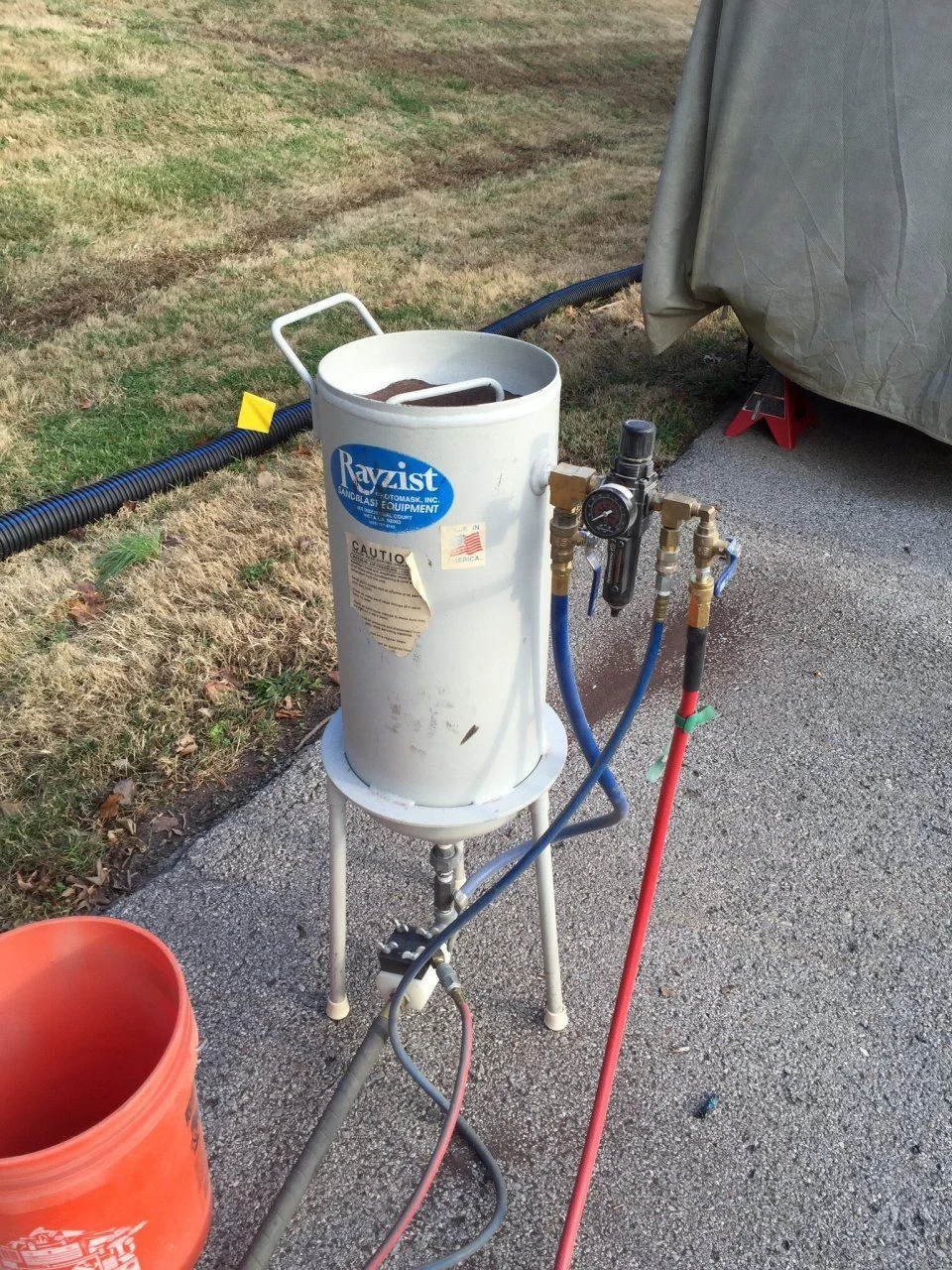

This little Pot blaster is kinda slow, but I can blast all day without stopping (except to refill about every 45 min). The air from the compressor keeps up nicely though I'm blasting at around 80 PSI. Took me about an hour today and about 1.5 hours previously.
You don't want to do the frame with it, but I only used about 30# of media, and was able to sweep up about 10# though I wasn't trying to save it.

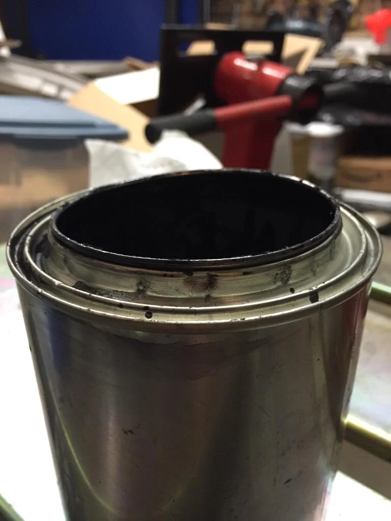

I'll try that. I've been able to use the same brush 3 times now, but I do keep losing paint cans due to adhesion of the lid, even though I'm pretty careful to clean the rim. Mineral Spirits cleans it up well, and thins it well.
Ok, so maybe that one isn't so clean!
Next time you open a fresh can of POR do not allow any paint to get on the can rim. I always dip out what I need instead of pouring. I also lay a piece of saran-wrap over the opening before pressing the lid on. It keeps the lid from sticking. If I am using quarts, once I get down to under a half full can, I transfer what remains into a fresh pint can eliminating as much air space as possible. As expensive as POR15 is I try not to waste any.
You can preserve your leftover POR if you have a welder or access to inert gas like CO2 or Argon . If you use the welder's nozzle or torch to fill the can with gas - please be very careful and do not ground the can to welder in any matter - the stuff is flammable and can ignite if the welder tries to start an arc . Argon works best and is heavier than air so it will push the oxygen out of the can . Use plastic wrap under the lid and hammer it back down tightly . I've stored mine for over a year and the leftover is just fine .
