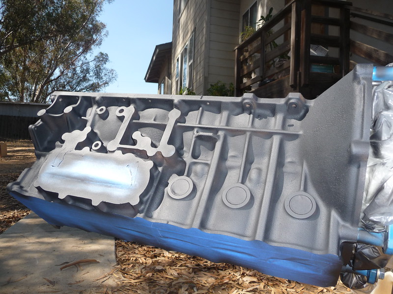

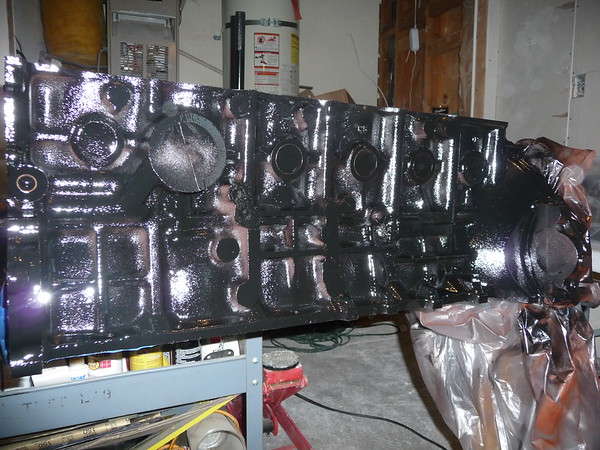

Returned the pistons, took the block down to have the timing cover bolted on and surfaced to match the deck. They set the big end rod bearing clearances to the value I wanted, and had it all ready for me while I waited. Can't ask for better service. Now on with painting, cleaning up and starting assembly. Plus an order for Cruiserdan on Monday, need me some pistons.

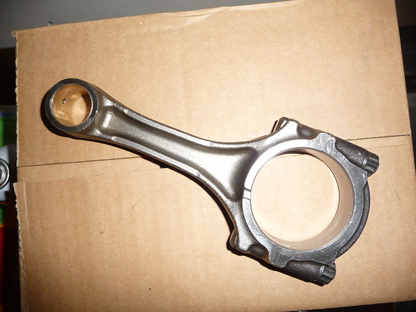

Thanks for the post. Can you explain rod journal oil clearance/maybe post a pic with the explanation? Thanks!
