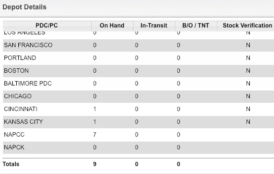

I’m just throwing it out there... you can always get a NEW OEM short block from Toyota.
Yessir. Though there are pros and cons with this direction as well, depending on whom you speak with.
Nine in the country. Not bad for an engine that was last in the US 21 years ago.
This is the direction I took last year after spinning a rod bearing. After calculating the local cost of machining, bearings, rings, buckets and gasket sets along with rust in the water jackets, I decided to go with a new factory short block. The cost was just a few hundred more. Onur set me up with everything.
