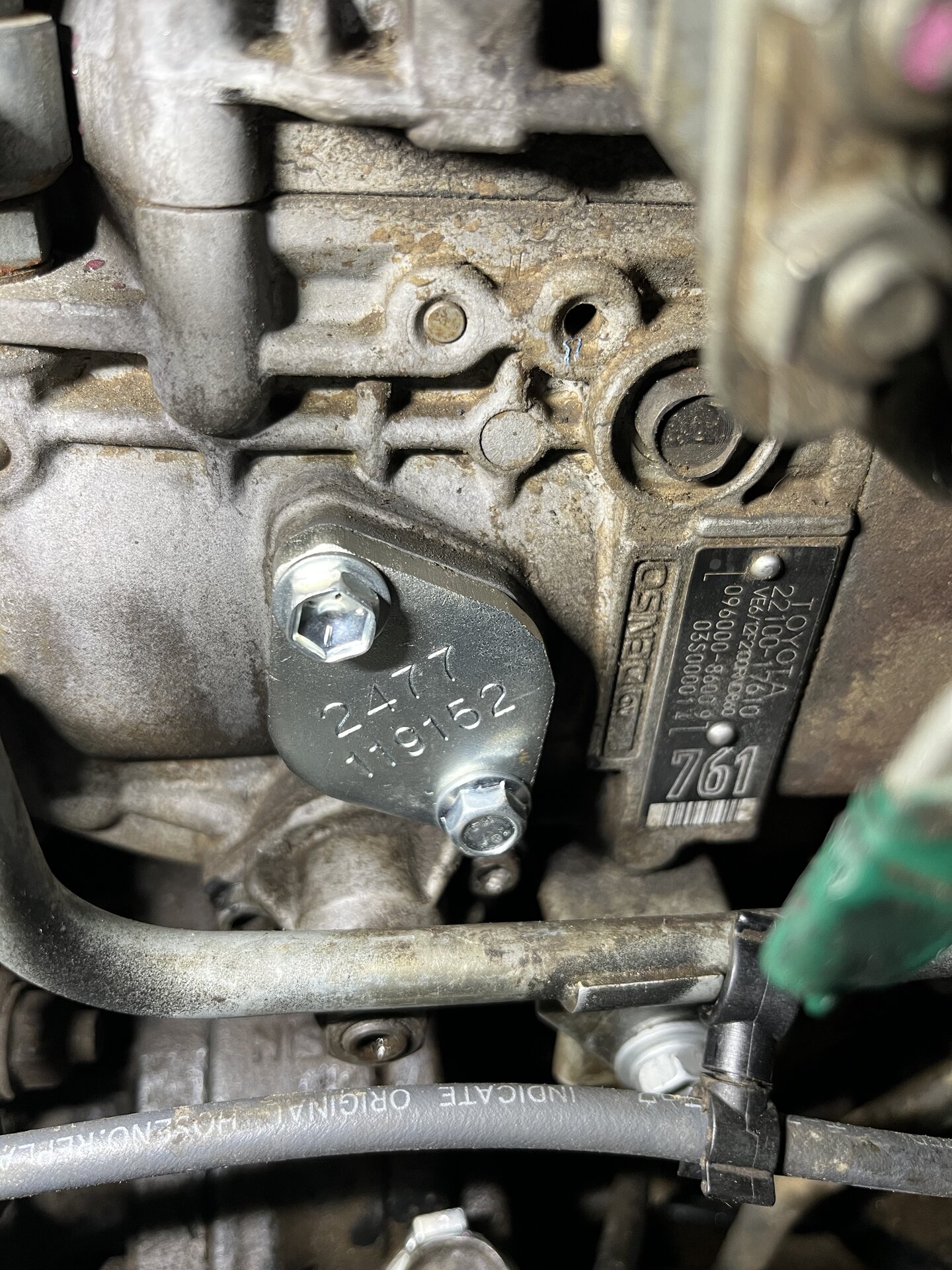

I did a ton of research on how I could possibly time the ACSD correctly with the pump still installed on the motor after replacing it with a new one. I could not find a way that it can be done accurately. For that reason - I removed it and put the blank on. Whenever the pump gets rebuilt, I will consider installing it.

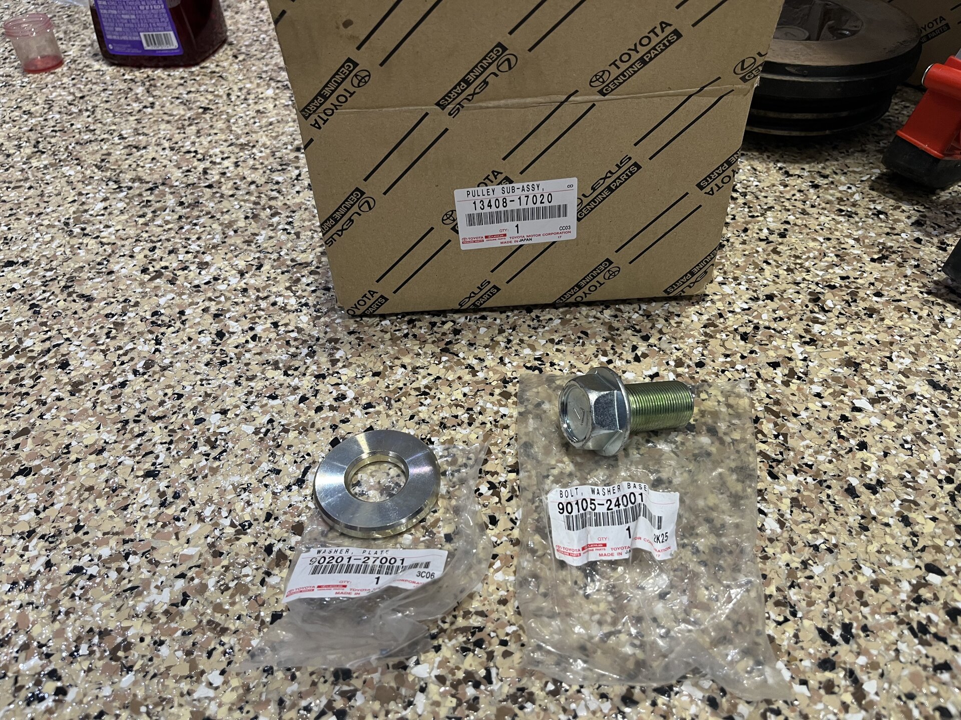

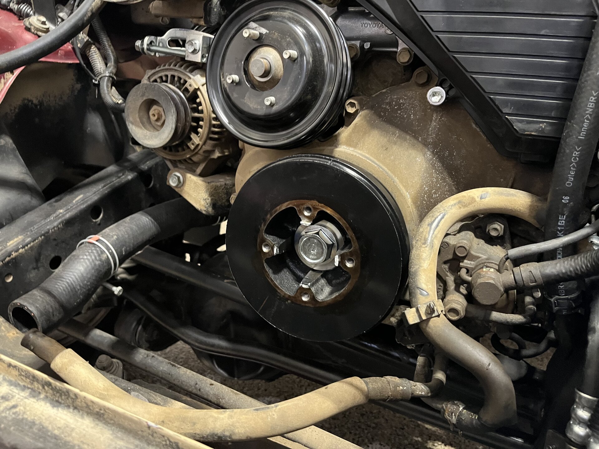

Next, I worked on the radiator, condenser, and receiver replacement. Since the engine was in "service position" I took the opportunity to remove the crankshaft pulley (harmonic balancer) to replace the seal, the harmonic balancer + o-ring, and new bolt with washer. Thanks for the suggestion to do this @SNLC !
I am just waiting on a torque wrench that can go up to 362 ft-lbs.
I don't remember reading anywhere that the @OTRAMM 1FZFE crank pulley holding tool will work on the 1HDT - but it does. I had to use 2 washers to stand it off a 1/4" because of the #2 crankshaft pulley centering extrusions. I had a set of 1FZFE head bolt washers from a previous job that I used for this.

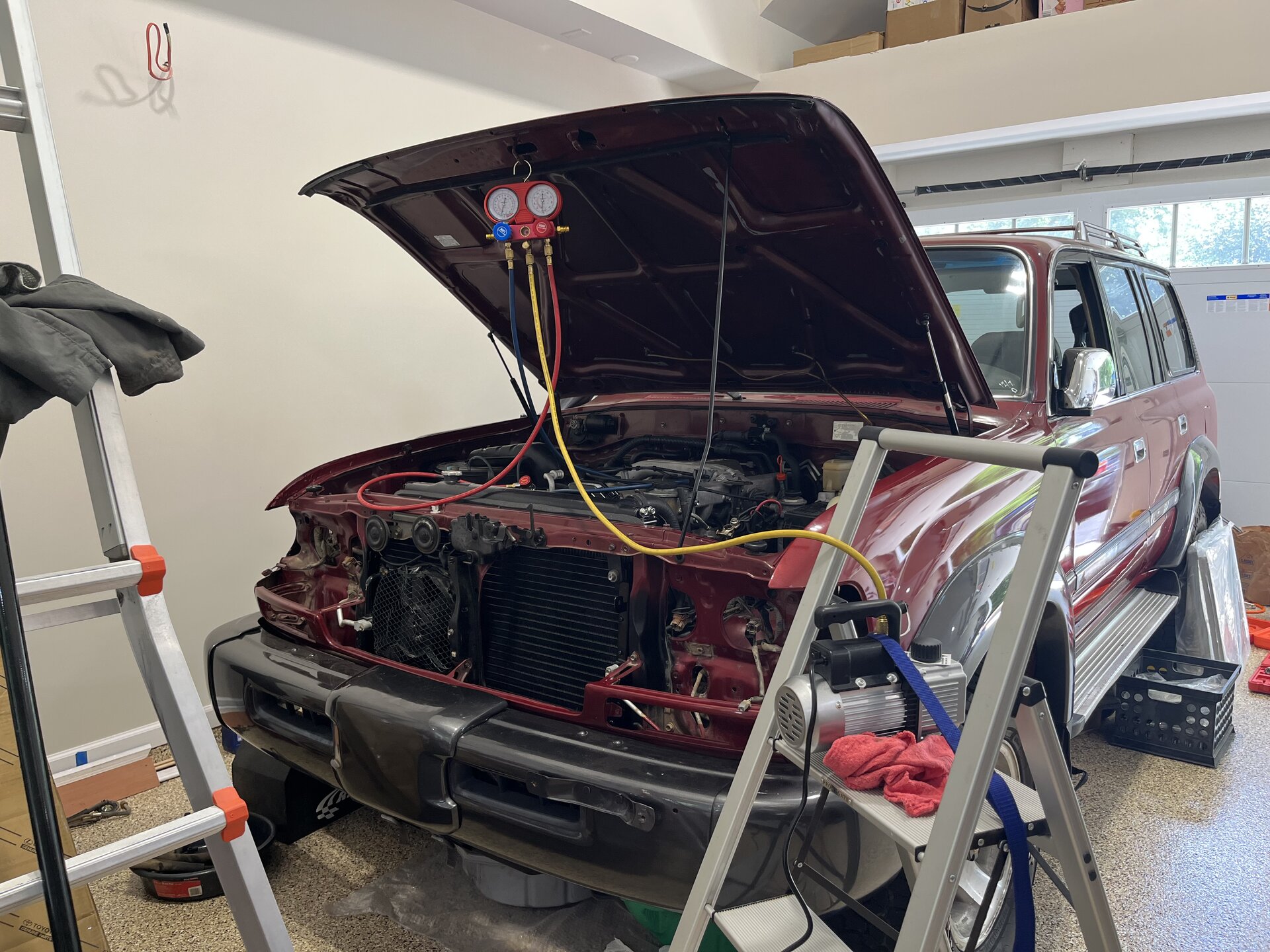

The crank bolt has been torqued to 362 ft-lbs and the ACDS removed and ports capped. New radiator, condenser, and drier installed with added PAG oil.
I borrowed a rental tool from AutoZone to pull a vacuum on the AC system. It held but I think that pump is weak as I could not get a near full vacuum. Gauges could be off too. 24in-HG is all I got.

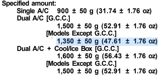

Took it in to get the refrigerant charged per FSM volume below.

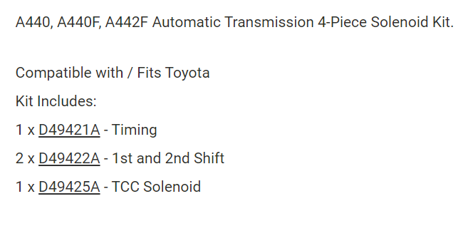

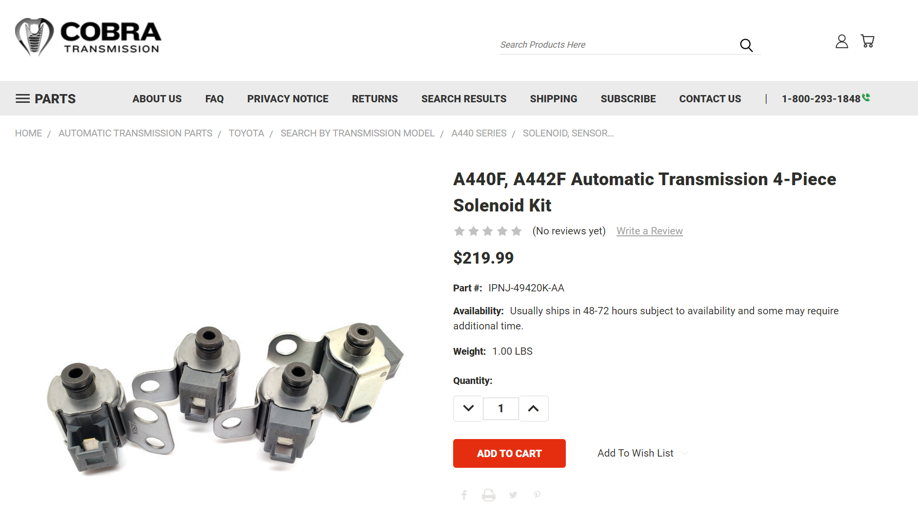

I verified fluid level - it was low by a quart or so. That seemed to help some but not 100%. I am considering swapping the solenoids as the next step. So far the ones people have found on Amazon/eBay are out of stock and a full set is available for $220 from Cobra Transmission.com

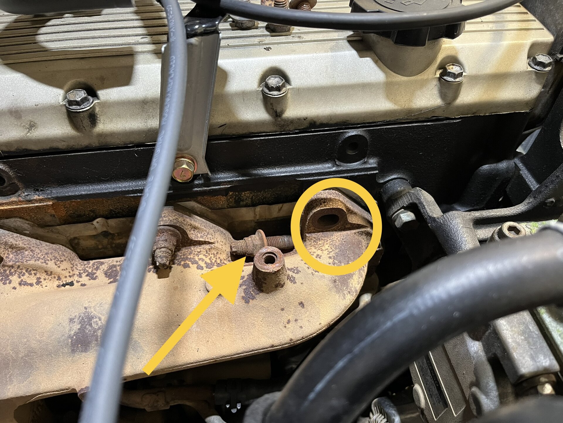

I got a surprise while working on this - two of the exhaust manifold bolts were out. One was just sitting on top of the manifold and the second missing. They were sheared. No visible leak at this time. I will need to address at time of turbo upgrade.

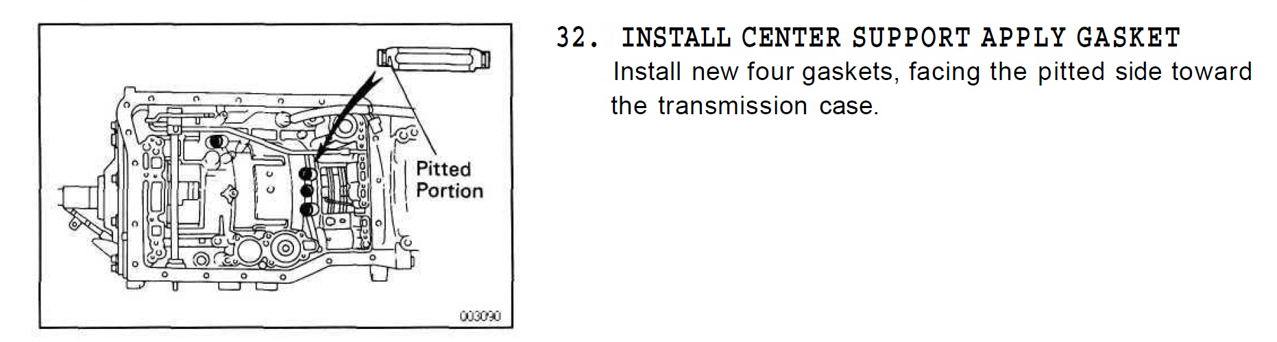

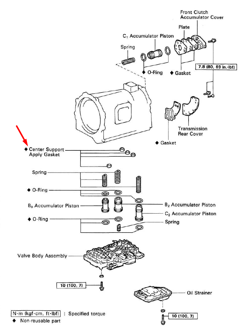

After I replaced the transmission (A442F) solenoids the shifting improved but a 2-3 shift flare remained. Like everyone else says - if you give it lots of pedal there is no flare.

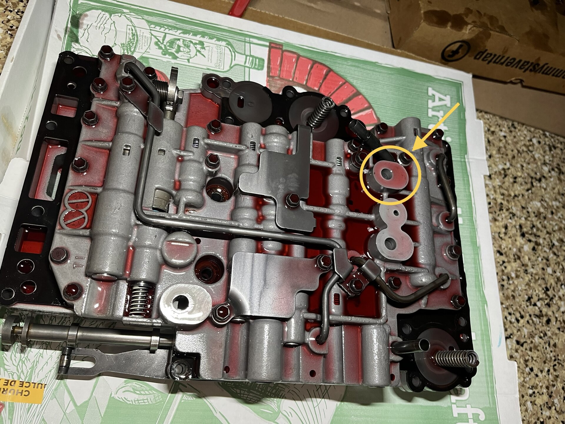

I saw a YouTube video where someone replaced the center 4 support gaskets, part 35893-36010, and resolved this issue. I decided to give this a shot.

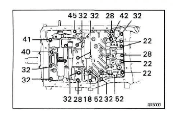

Dropping the valve body is not very hard. I took some cardboard and drew up all the bolts and their positions and popped them in as I removed them. They are all different lengths so you need to keep track.
Once the valve body was out I added some large washers and bolts to hold the cylinders in place. Only snag was one of the solenoid clips broke as I was removing them. Toyota still sells the complete harness for $22 (2023) - part 82125-36010. Will wait for it to arrive to button everything up and test.
My observation was that it seemed like from the imprint on the valve body that at least one of these gaskets was not fully seating. I took that one out and compared it on the bench against a new one. There is a visual difference and the old one is very very hard. I will update the thread once everything is together and I have results.

Valve body removed
Interface where I think there was a bad seal

Here is a snapshot from the FSM showing the 4 gaskets. I will replace all as well as the o-rings on accumulators. View attachment 3451480 Orientation of the gasket: View attachment 3451490 Lengths of each bolt in mm. 10N-m torque. View attachment 3451491
Great
