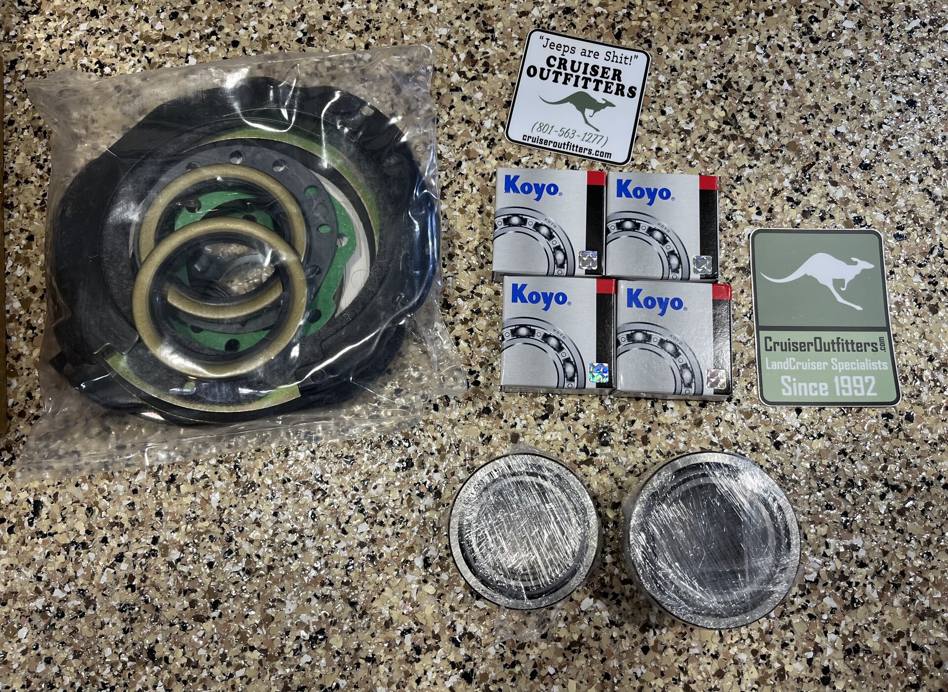

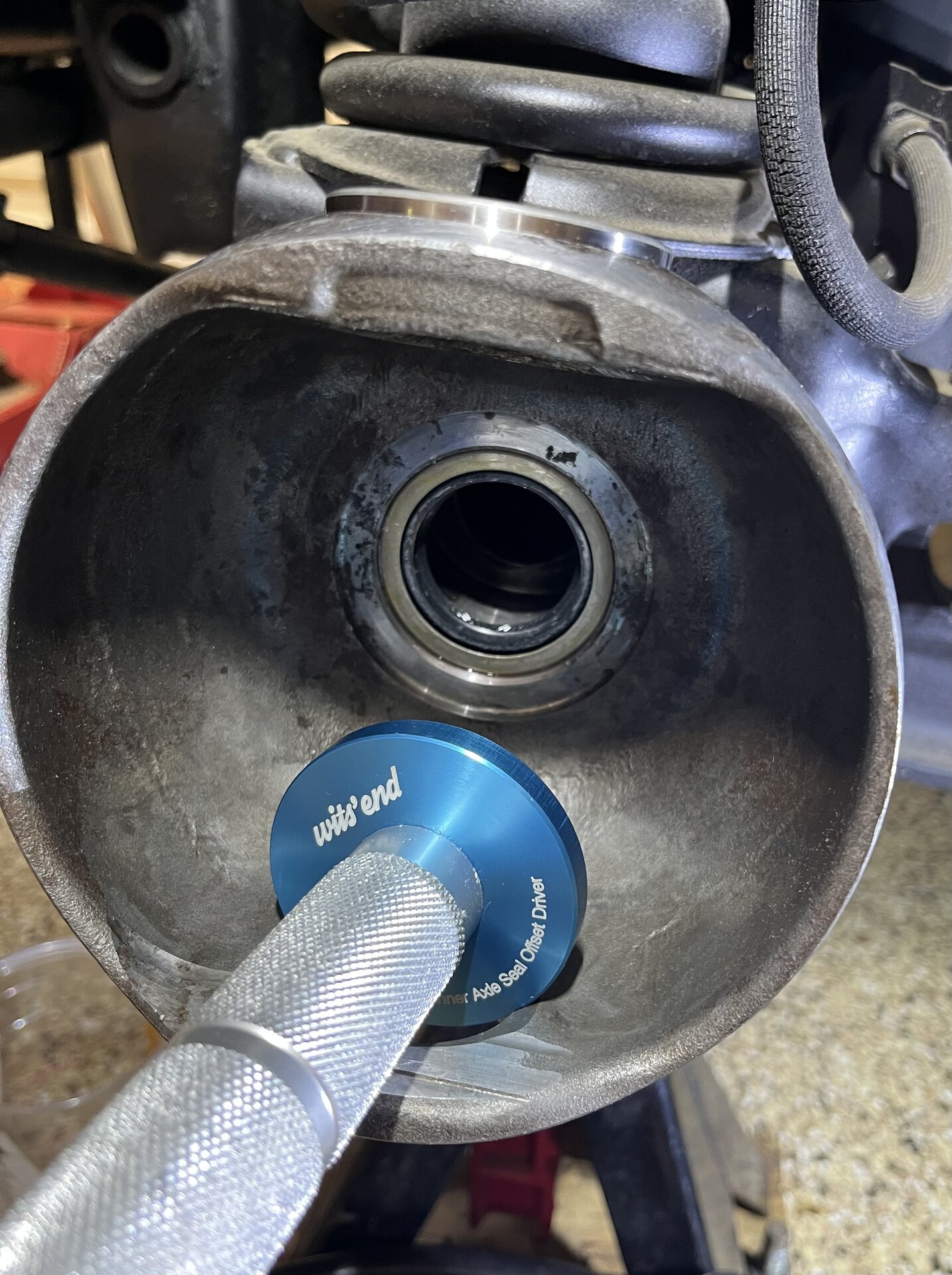

I started to work on the knuckle rebuild. Standard mess. Bearing races show wear and will be replaced with new KOYO from @cruiseroutfit. @NLXTACY seal driver came in handy and worked well with existing driver kit I had.

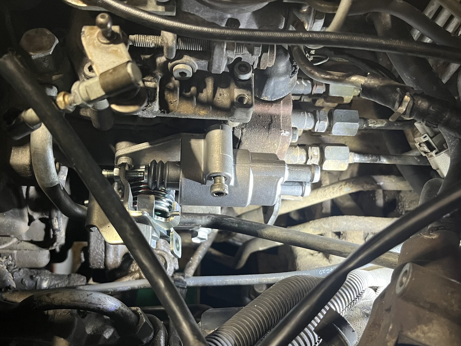

I’ve freed the 80 from the anti-theft gear shifter lock device! Took 10 minutes…
I will drill out the holes, touchup with paint, and fill with correct size rubber grommet plugs.

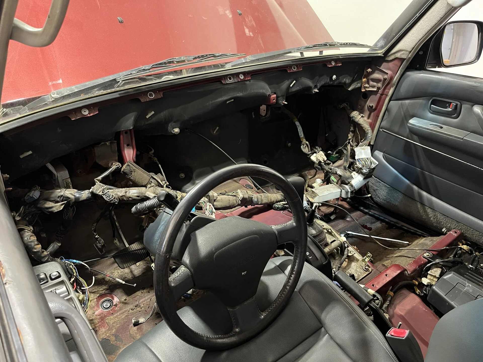

Also, time to take apart the dash to replace the heater core. Great opportunity for a full scrub and familiarization with this one.

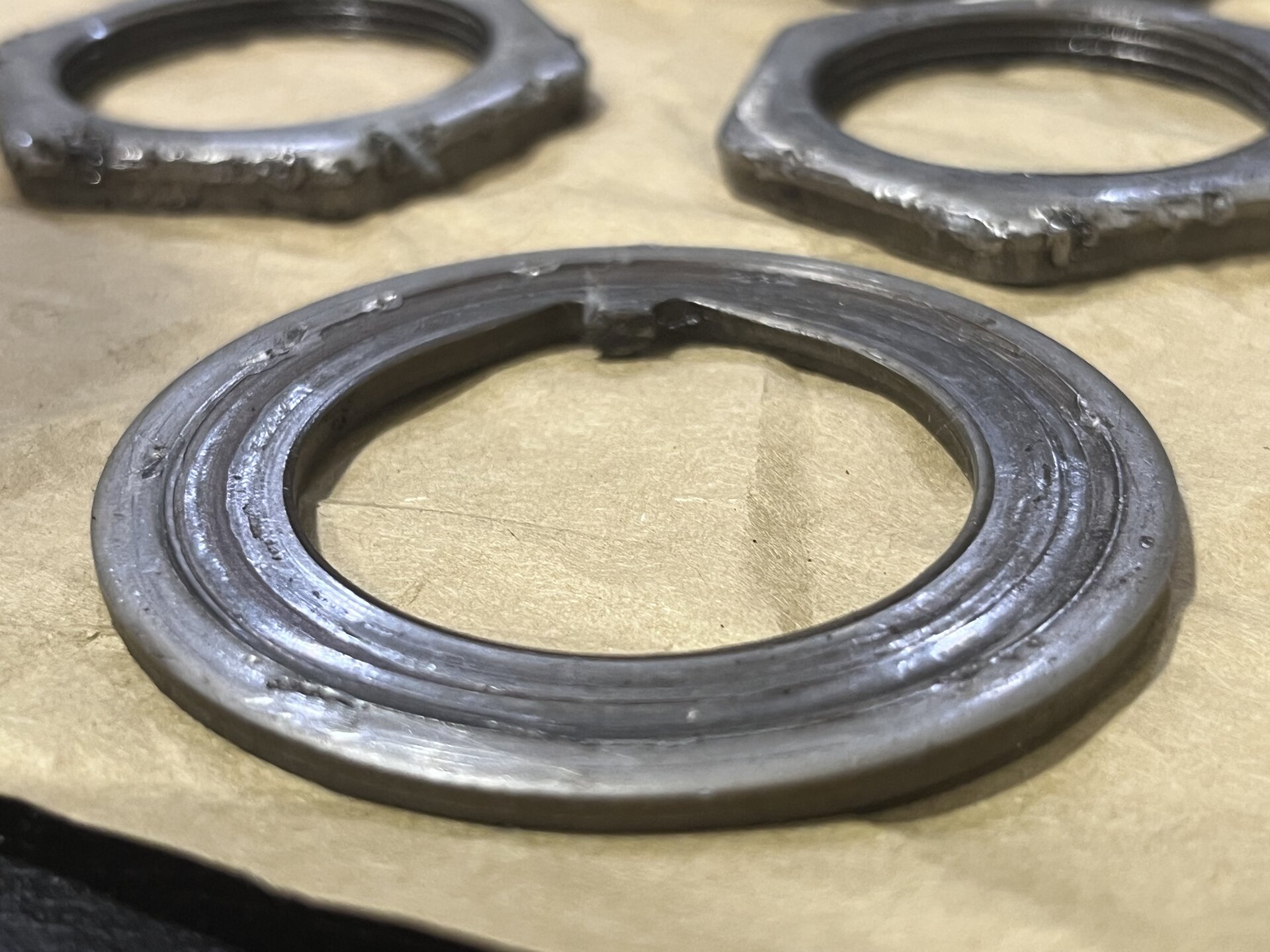

Axle thrust washer and lock nuts were chewed up and replaced with new.

Old chewed up hardware.
Worn groves into thrust washer

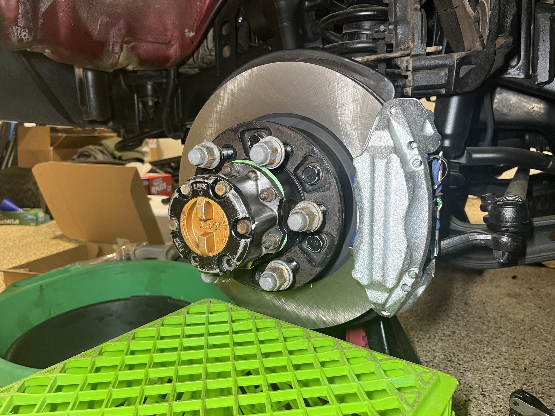

New OEM rotors, calipers, pads, and hoses. Locking hubs were serviced.

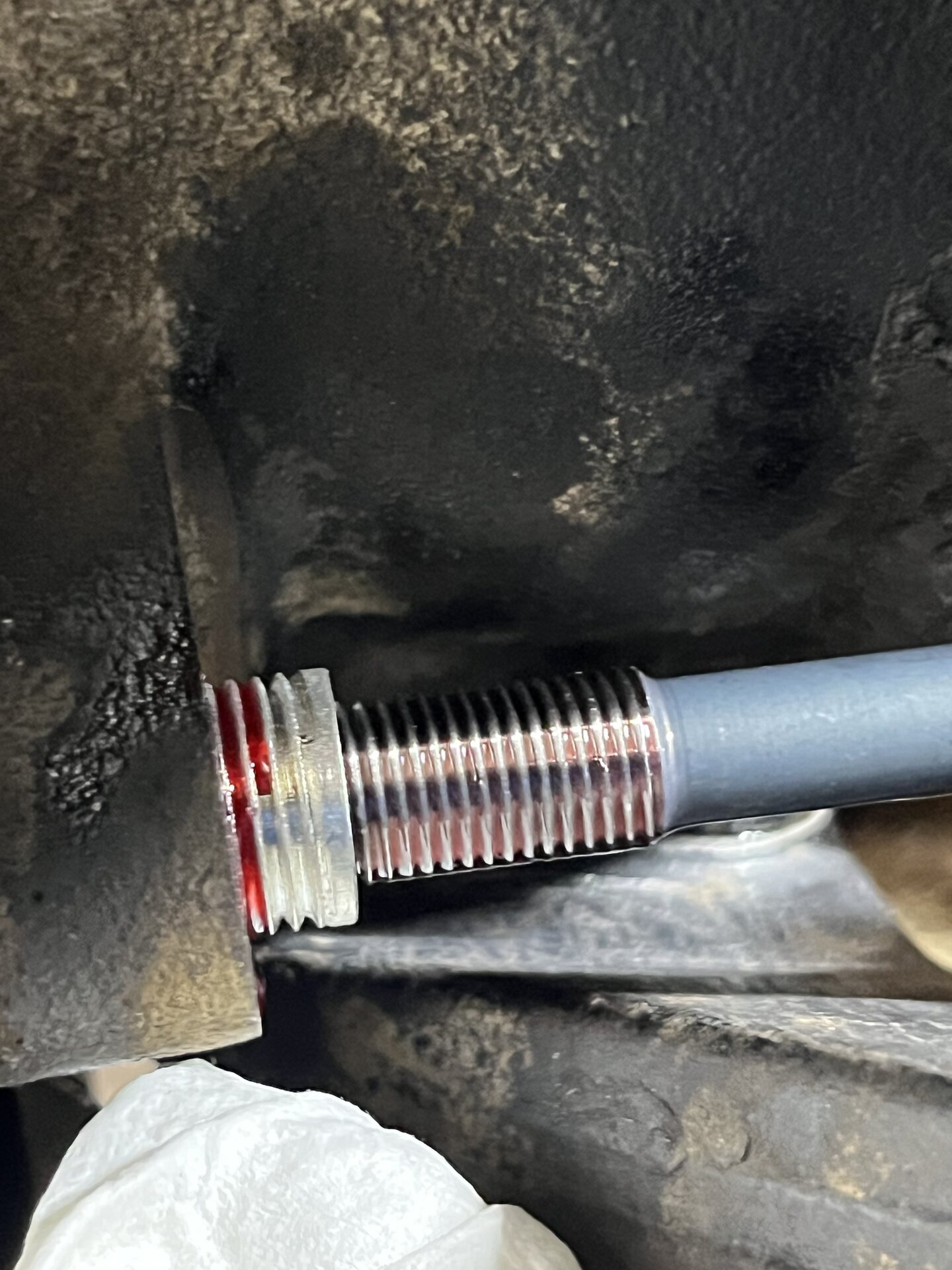

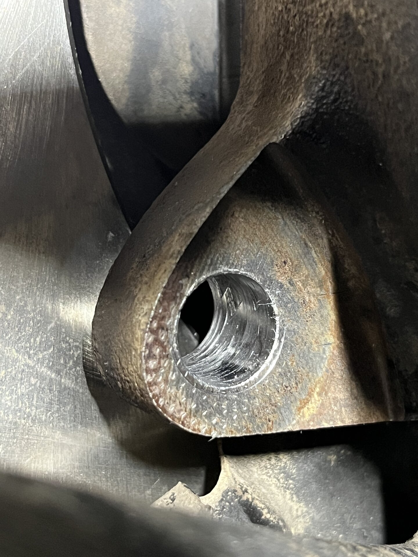

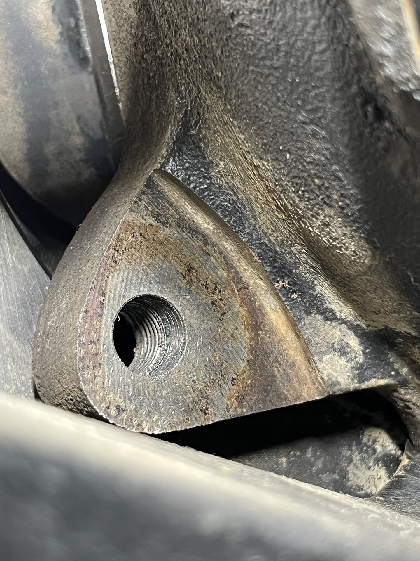

While I was torquing the caliper bolts to 90 ft-lbs, one of them did not come close to reaching that value. After a closer look, the threads were stripped and/or previously repaired with a heli-coil.
I used an oversized Time-Sert to restore the threads to maintain oem bolt.
Damaged threads
Drilled out
A shoulder is cut into the hole via provided tool
New threads are made for the insert.
Insert is driven into hole with provided tool. I applied Loctite to insert threads

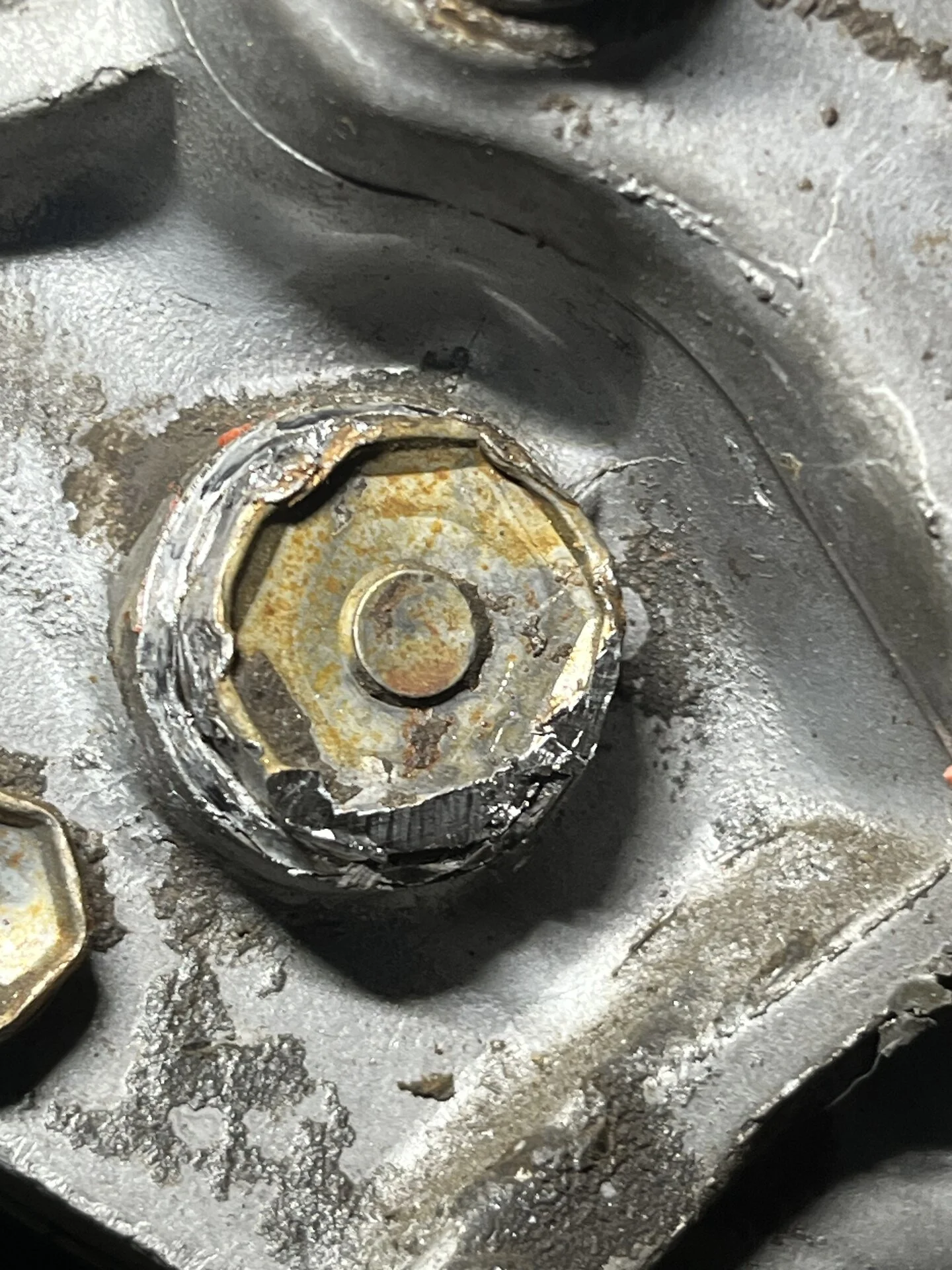

The last fluid to change was the transfer case. I started with removing the fill plug but that proved to be difficult because it was partially rounded and really on there. My 24mm rounded the plug even more. To remove it, I chiseled a notch and beat it off with a flat punch. It took some efforts and different positions to finally get loose. You can see in the photos below how many times the material failed and I had to start in a new location. No signs of using any RTV. I think the metal gasket has been reused too may times that it turned into a locking mechanism. I will be replacing both filler and drain plugs with the magnet and Allen key.
All of the mauled material is part of the plug and metal gasket.

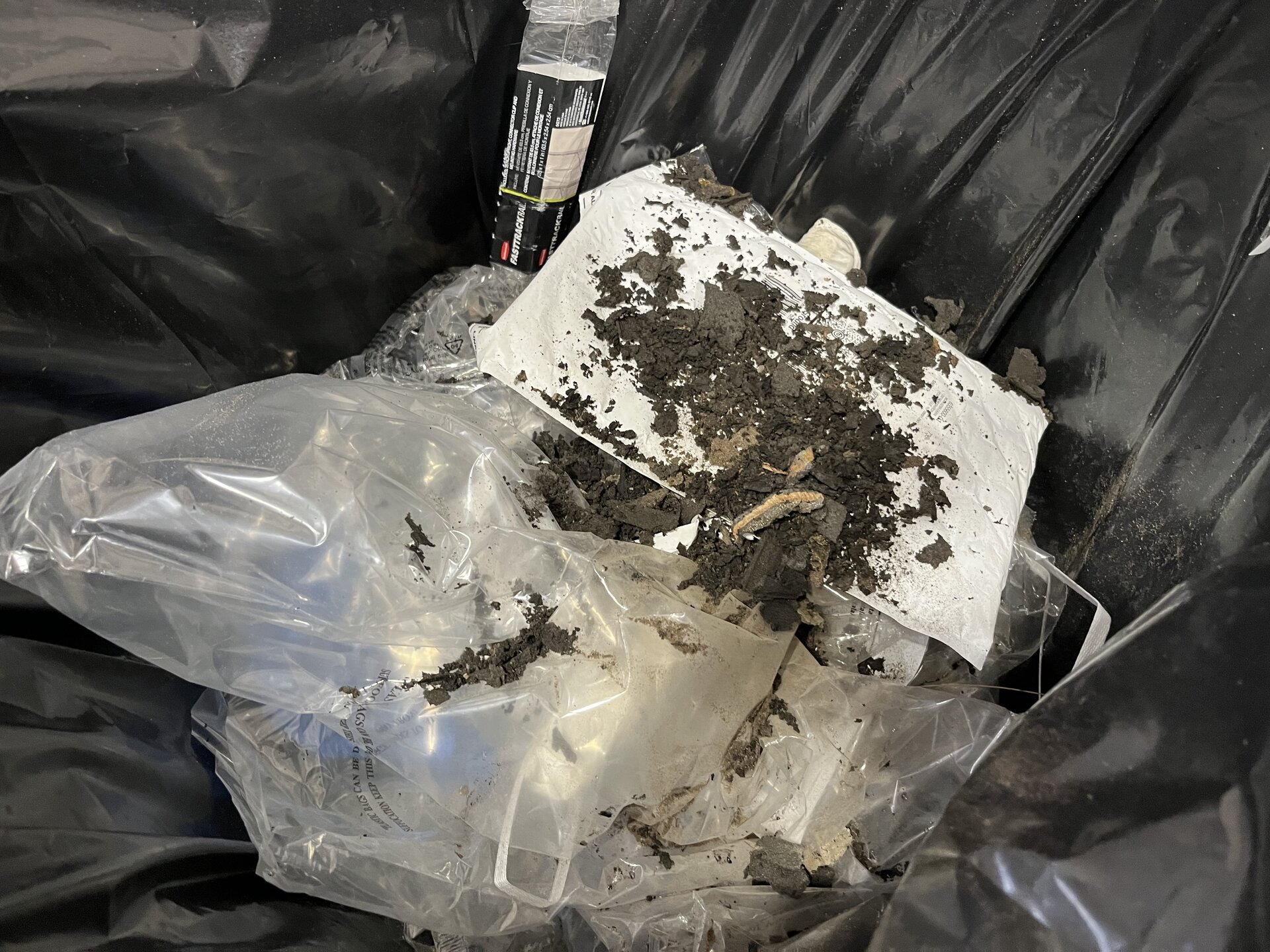

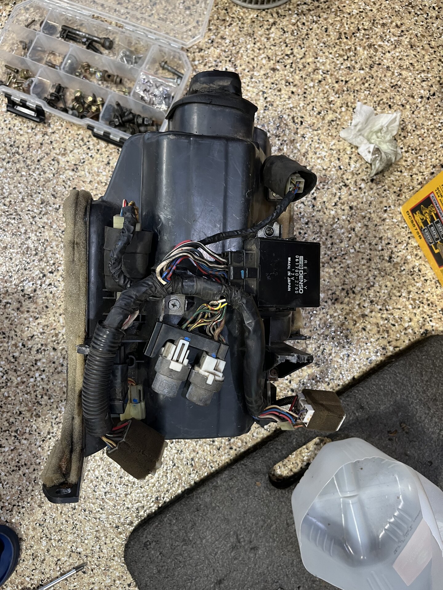

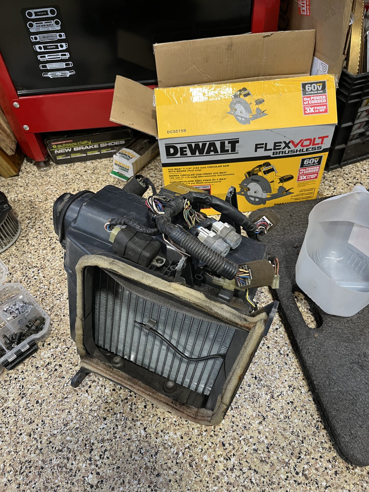

I removed the HVAC system from inside the cab after having a shop evacuate the refrigerant. I was expecting 3.3lbs (1,500g) of refrigerant to be evacuated but only 1.2lbs was recovered. It's a dual AC 80 without the console fridge. Will pull a vacuum after this is done to confirm system is tight before recharge.

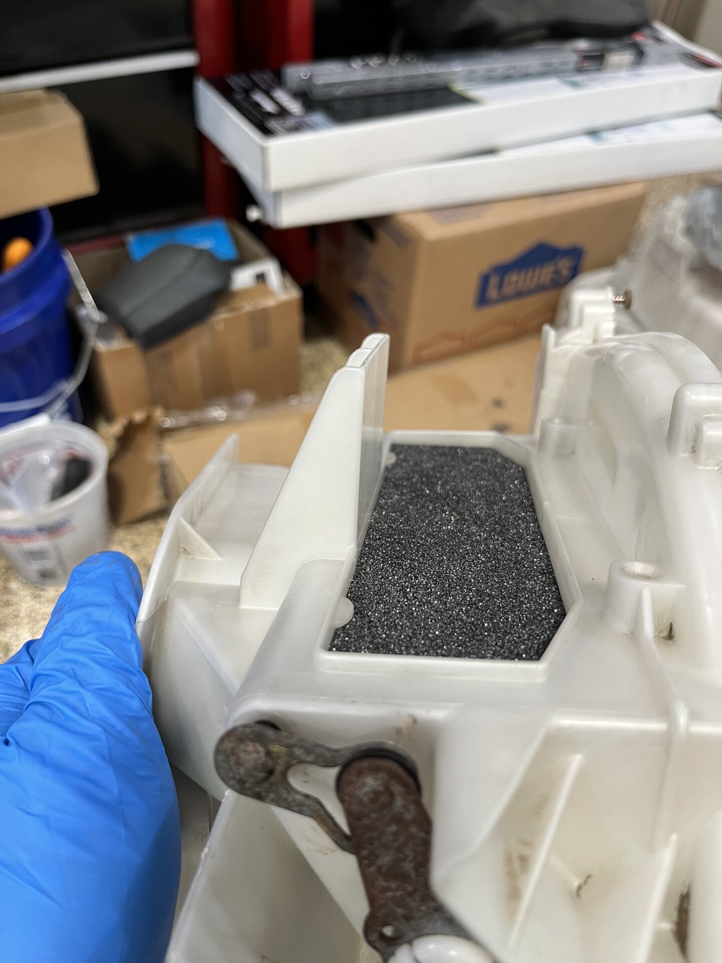

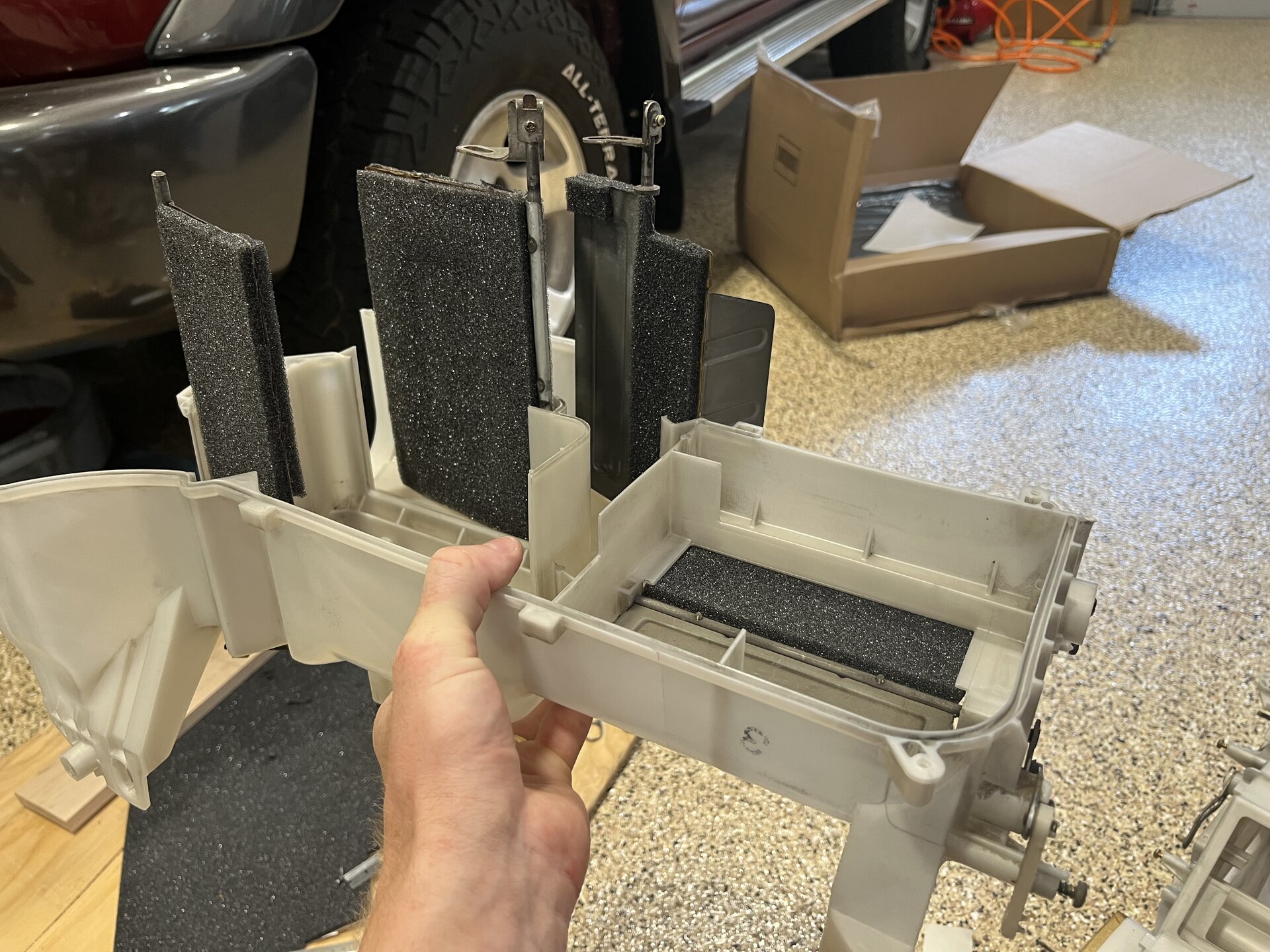

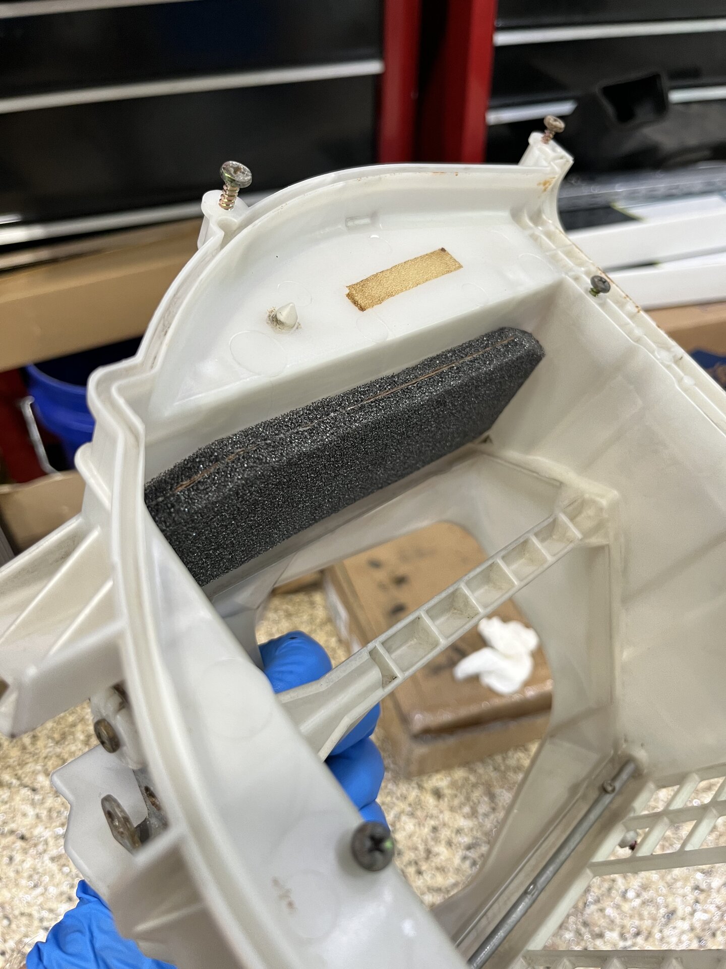

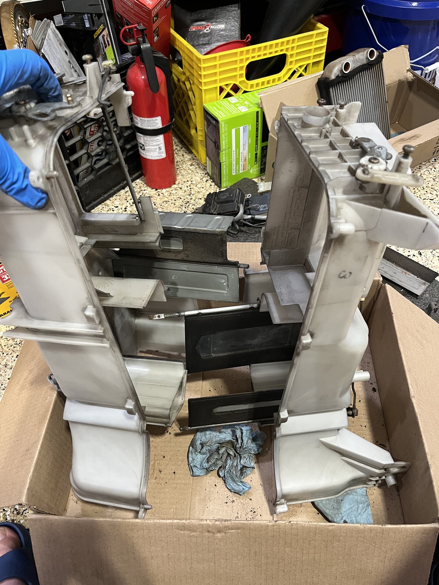

Cleaning is in progress. I broke down all the components for a deep clean and re-foam all doors and seals.

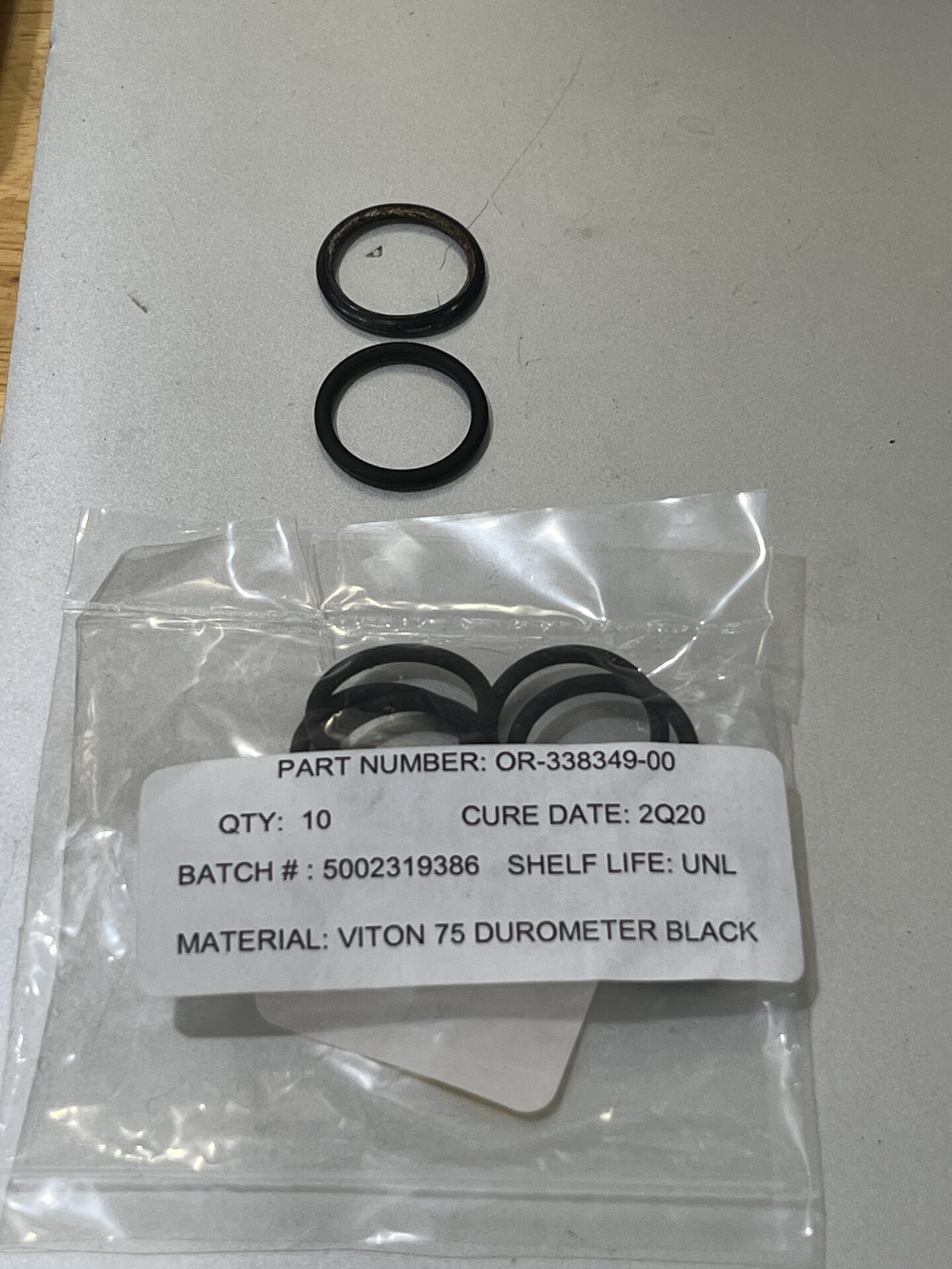

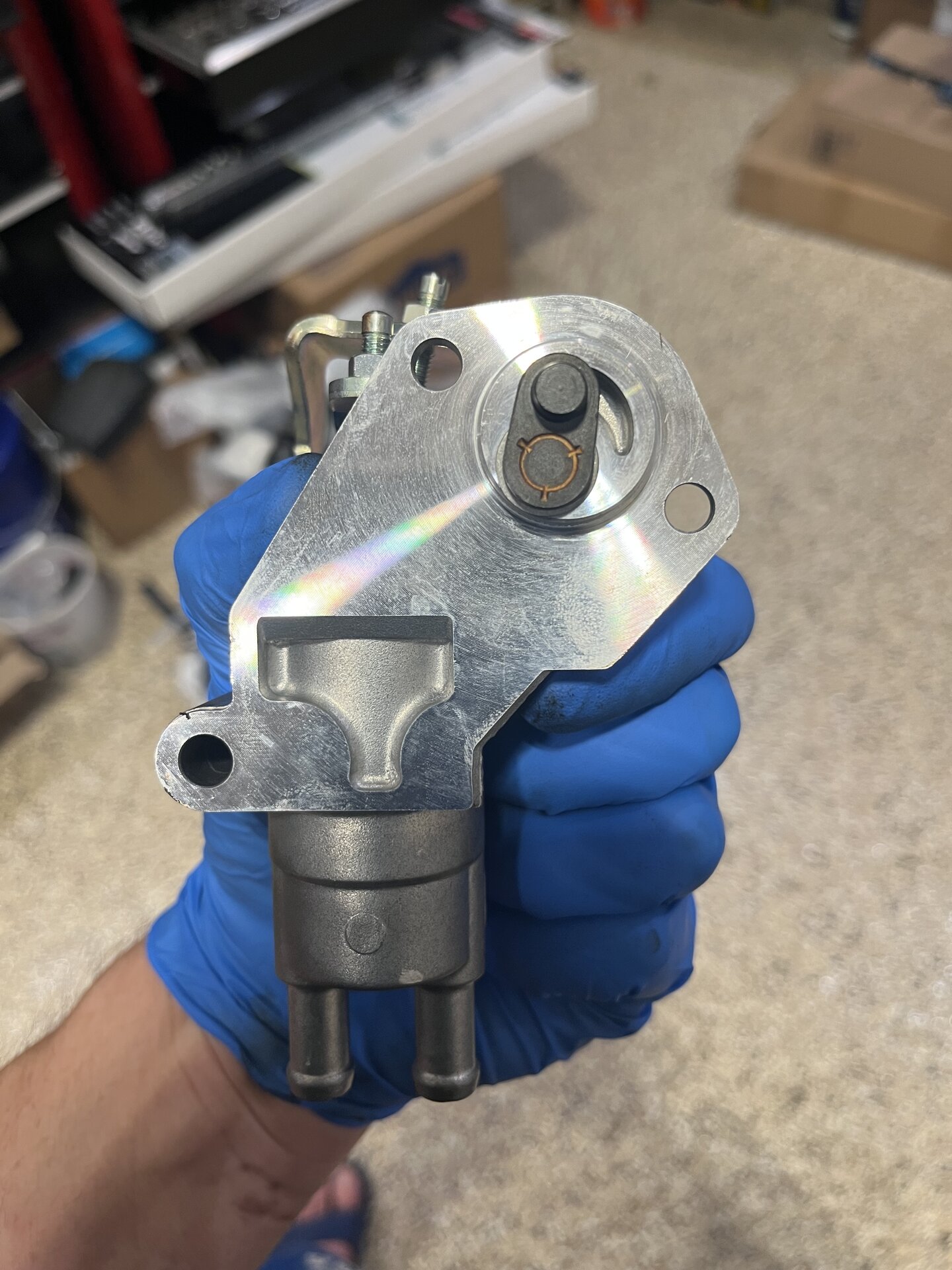

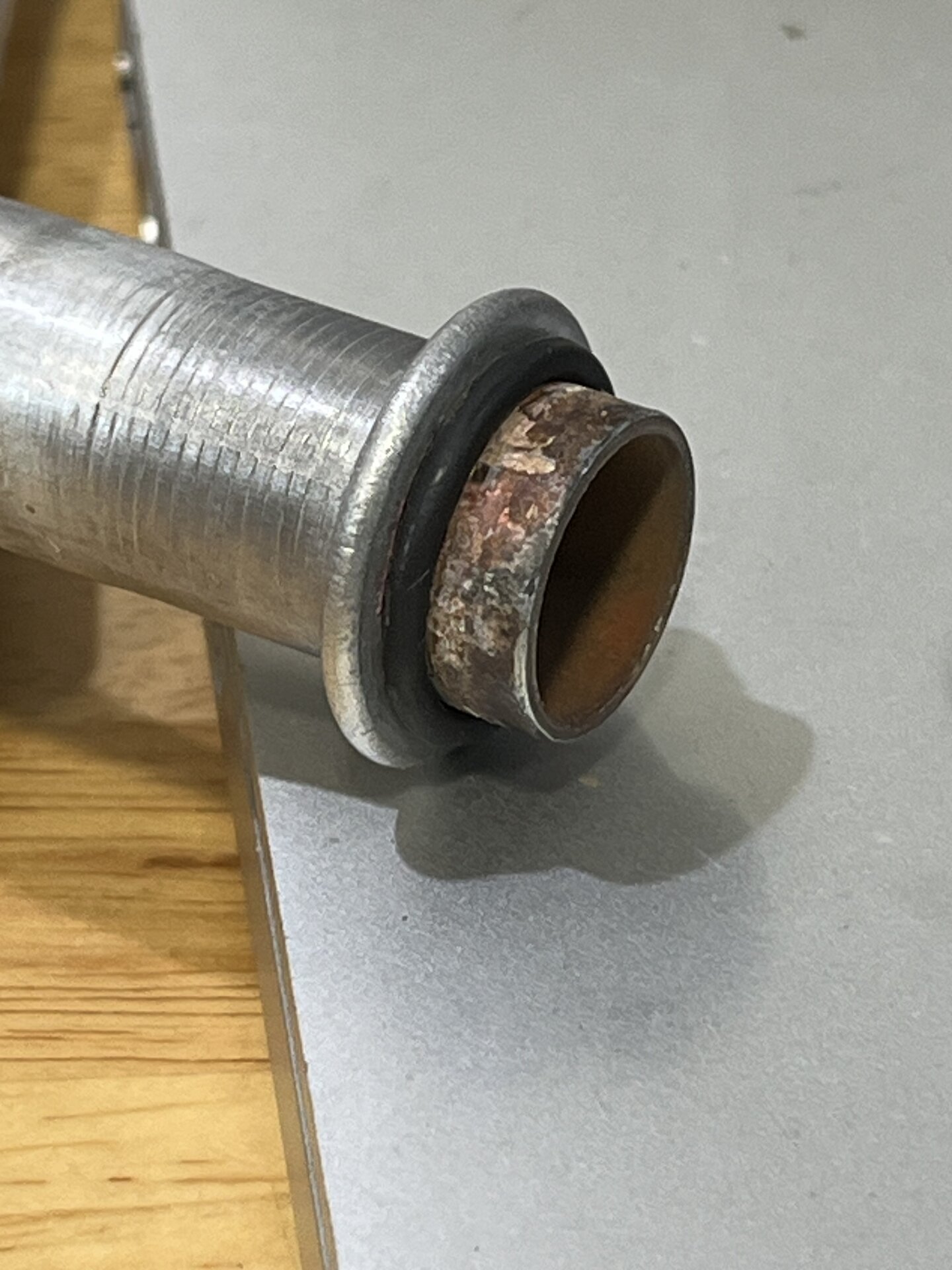

A new OEM heater core, TXV, evap, condenser and drier will be installed. I found matching o-rings for the heater core pipes from McMaster. I opted for Viton material for the resistance to various chemicals and high/low temperatures.
Link to McMaster Product Page (1295N241)

I changed the rear and front diff fluids. No concerning chips or evidence of water entry. Installed new OEM gaskets and torqued to spec.
I found the 24mm fill/drain plugs much easier to undo after grinding the end of a single hex 24mm socket so it's flat and has square shoulders at the new top of the socket.
Lots of sockets have a slight bevel on the edges at the end. The bevelled edge makes it easy to locate a socket on a nut, but on a flat plug, it means you don't have much contact with the plug head edges/flats.
Grinding the socket gives you maximum possible contact
Great suggestion. I ended up replacing the drain/fills with Allen key type.

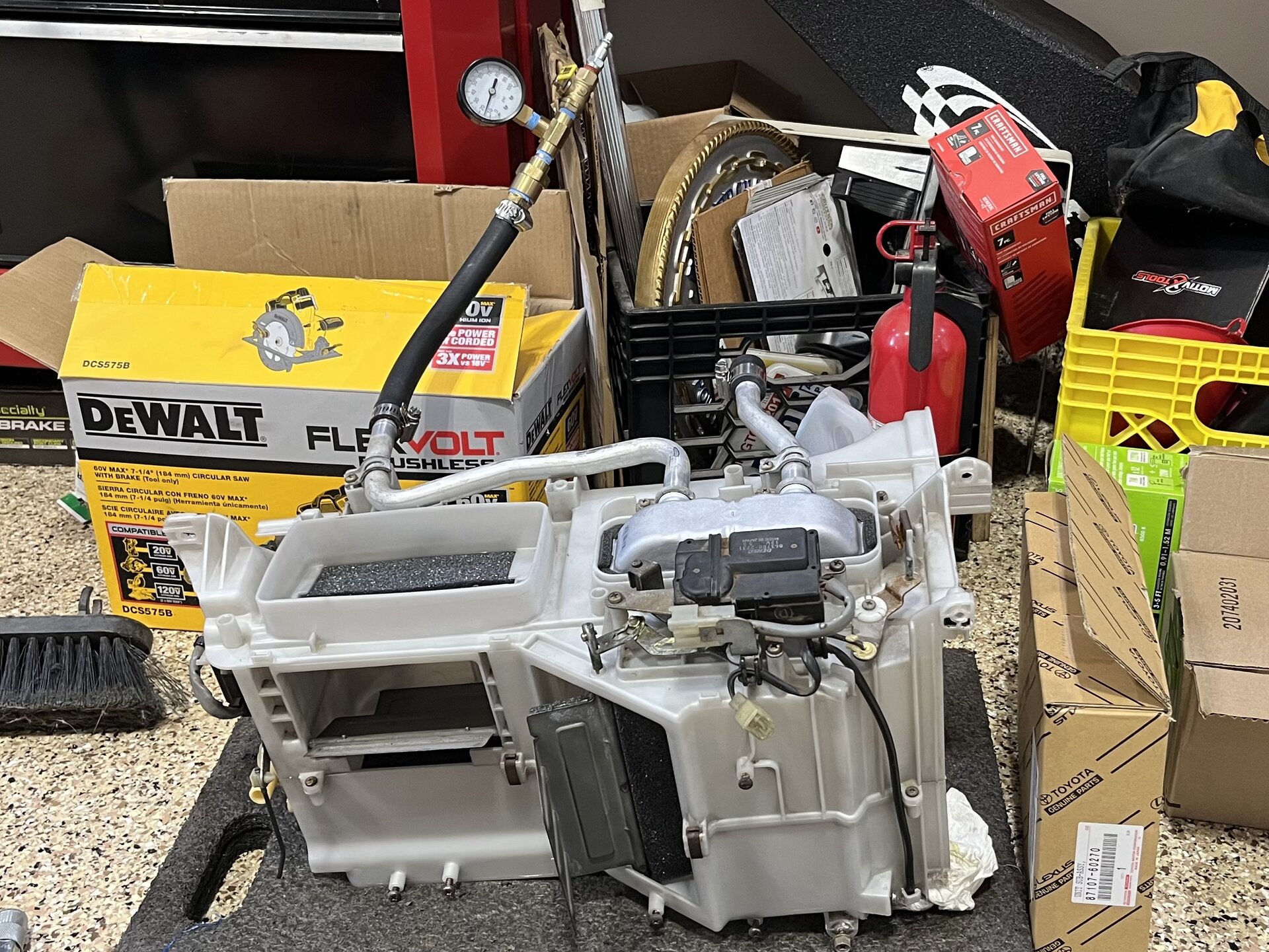

I installed the heater core with new Viton o-rings and pressure tested the connections while the unit was out. I pressurized to 16psi and held it for 30 minutes before installation.

Foam will be replaced prior to installation on the evaporator box assembly.
