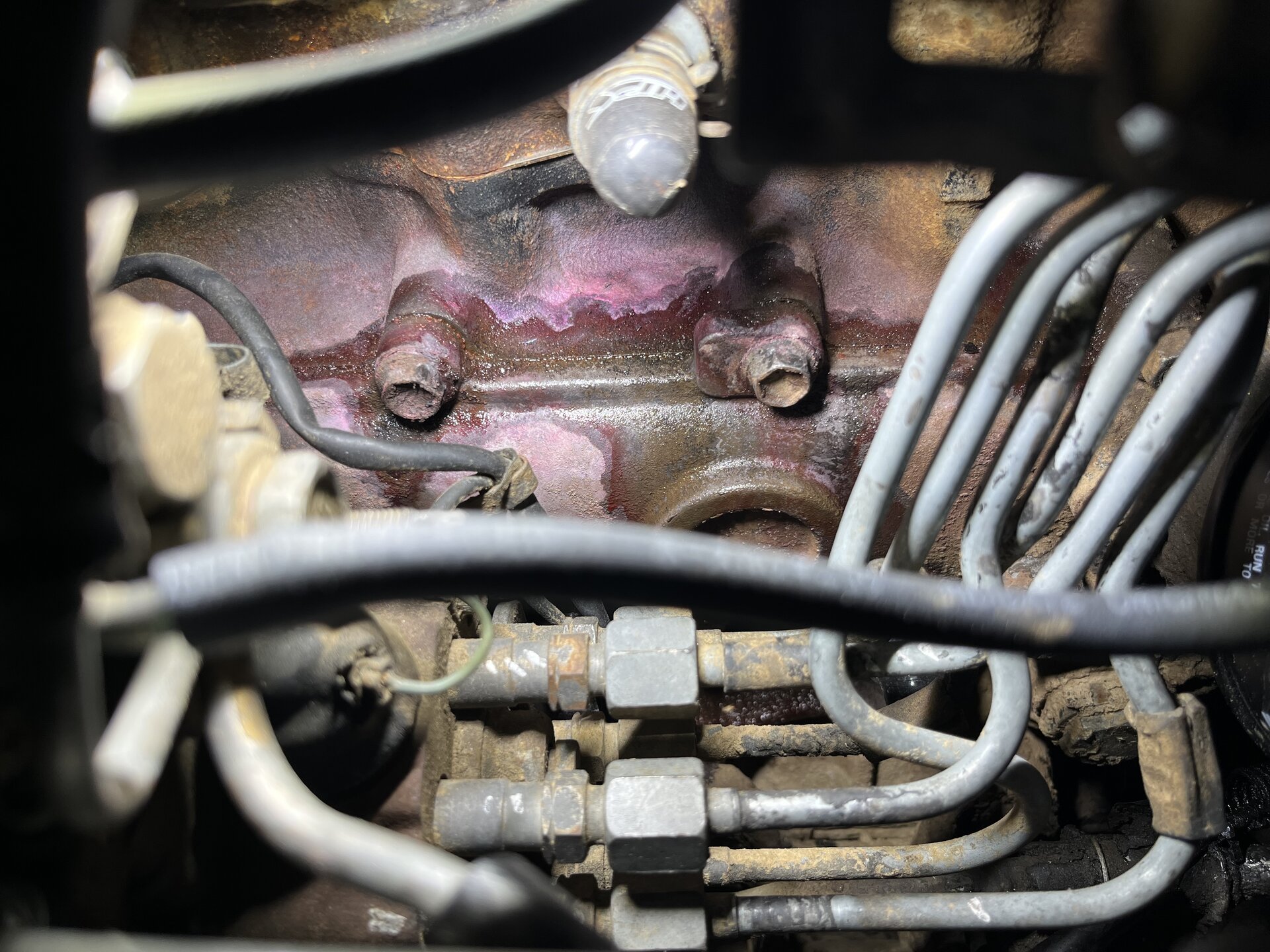

I have been driving the 80 on local trips and some short highway runs. I noticed a slight leak around the oil cooler cover as well as a drop in my reservoir tank. I tried to tighten up the nuts for the cooler cover but that did not change anything. It's a very very slow leak that seems to evaporate on the block before reaching the floor.

As you can see in the next photo, I have presence of coolant at the top of cover/block interface. I looked at other locations including the new cap I installed when I removed the ACSD but don't see anything. I will look again just incase it's something else that I missed.

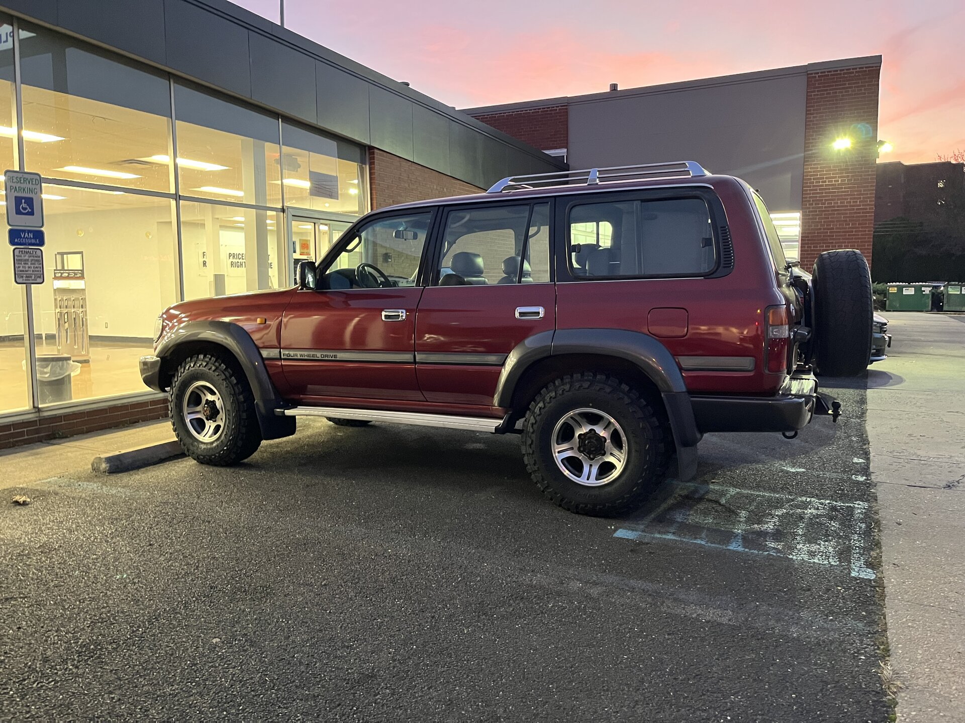

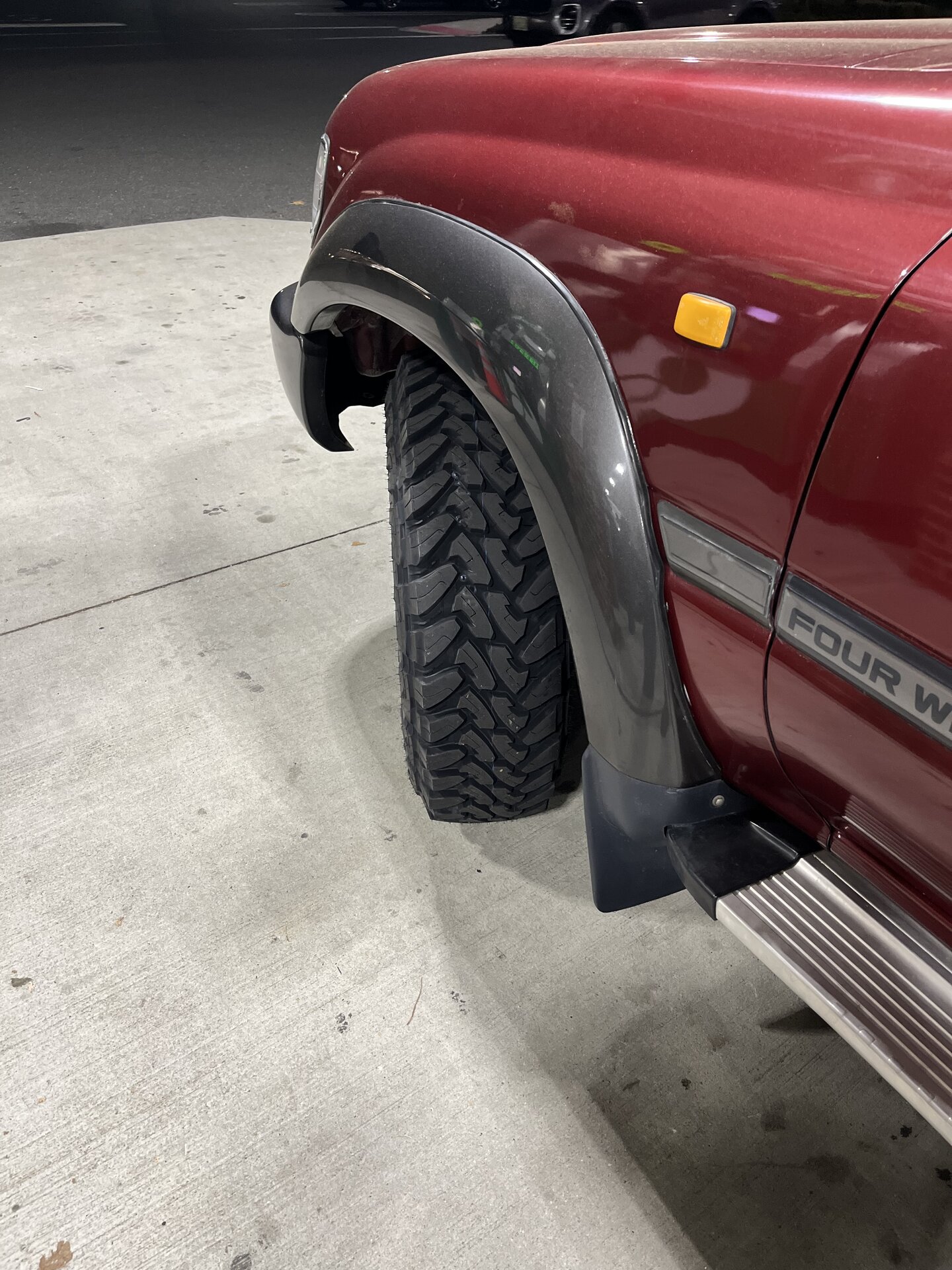

Toyo Open Country MT 255/85R16 installed. I had very clean LX rims that I used and love the look. I am still looking for a clean LX rim to put on the tire carrier. If anyone has one, reach out!
Looks good. I have a '93 in the same colour.
I need to replace a couple of flares. Mine are black. A couple need some love and some paint.
Was contemplating a change charcoal grey.
Seeing your pics confirms charcoal grey will look good

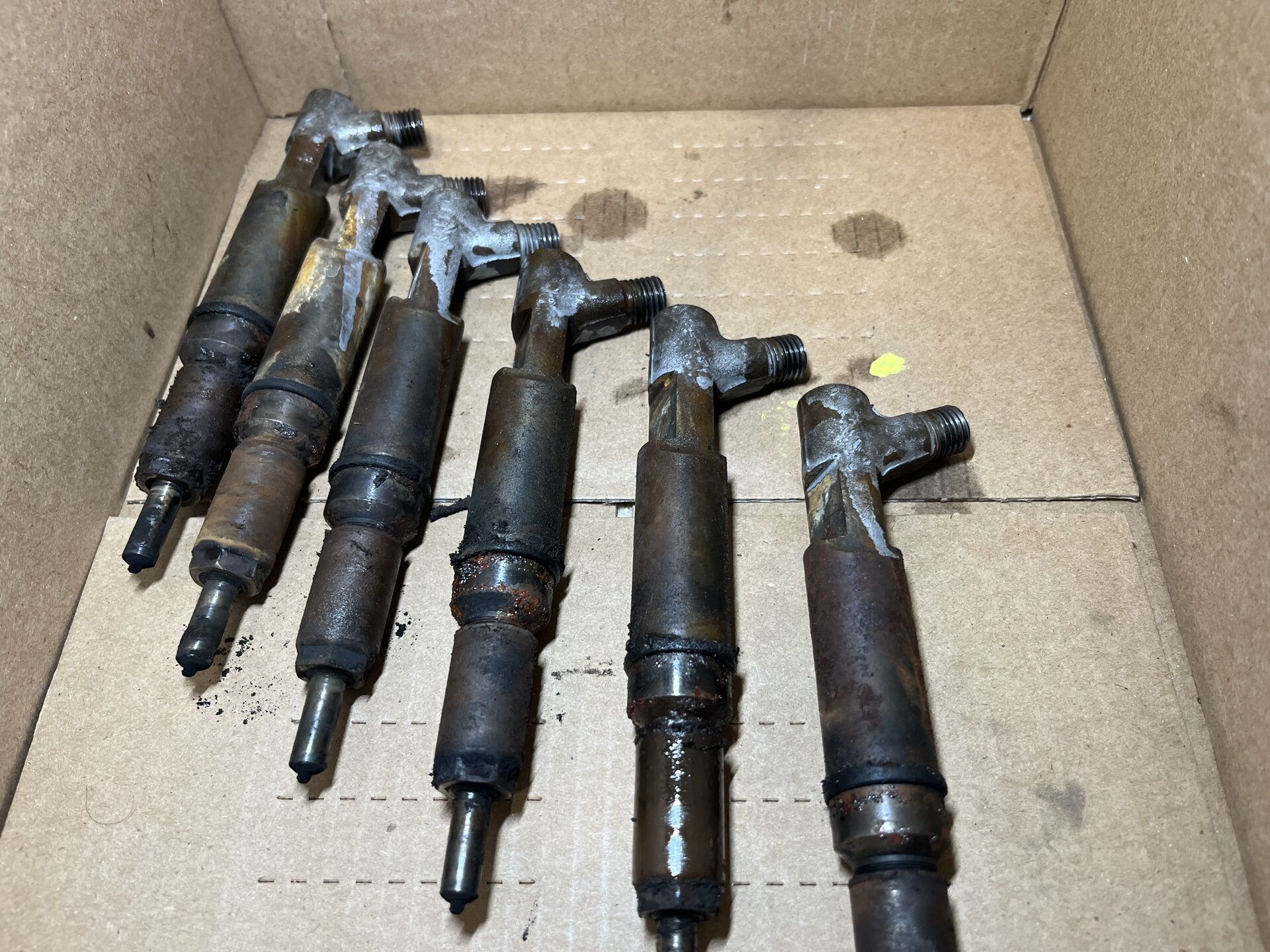

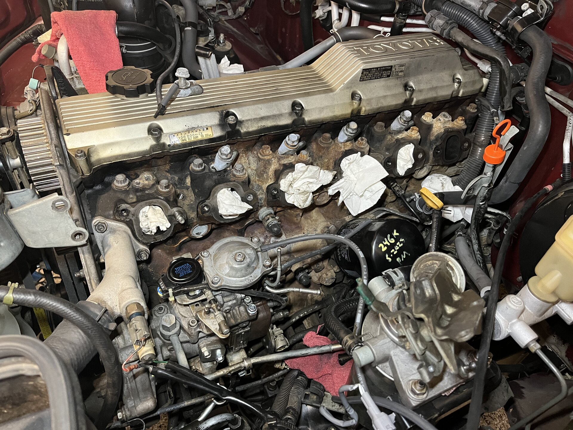

I began working on gaining access to the oil cooler cover to replace the leaking gasket. I need to borrow/buy a pull/puller to push out the injection pump as the last step.

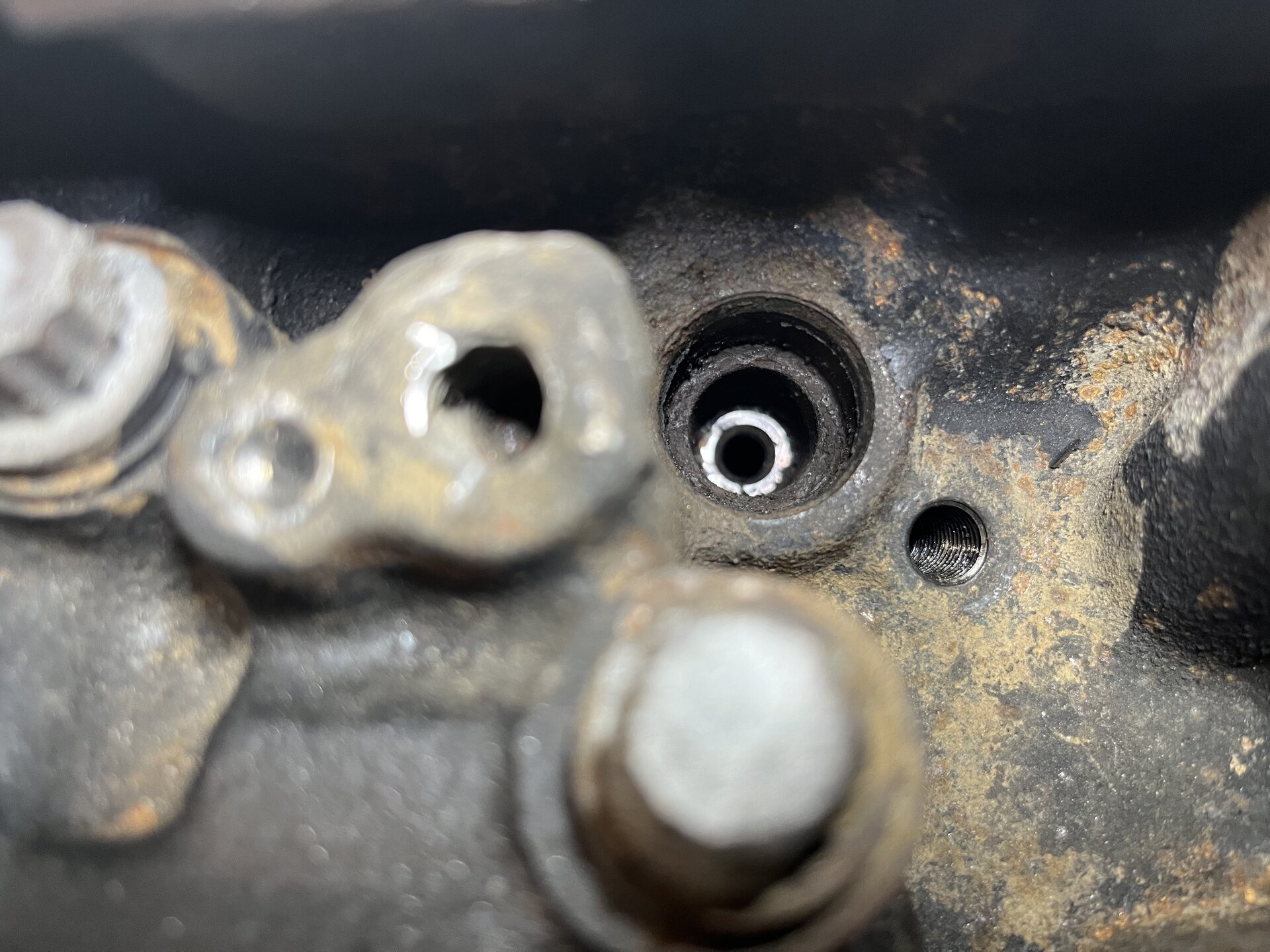

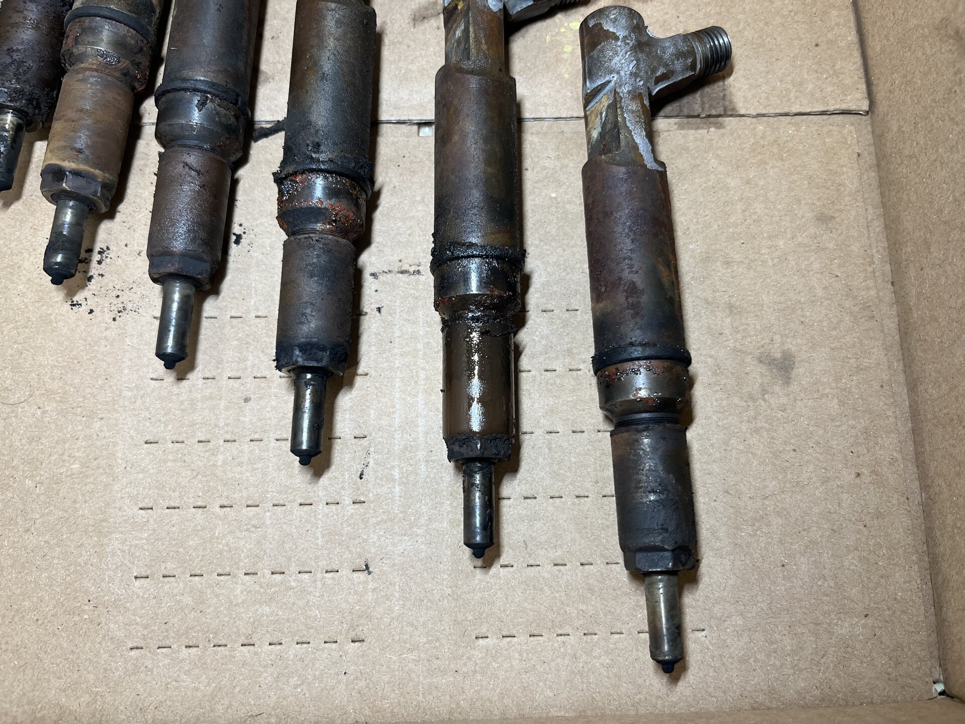

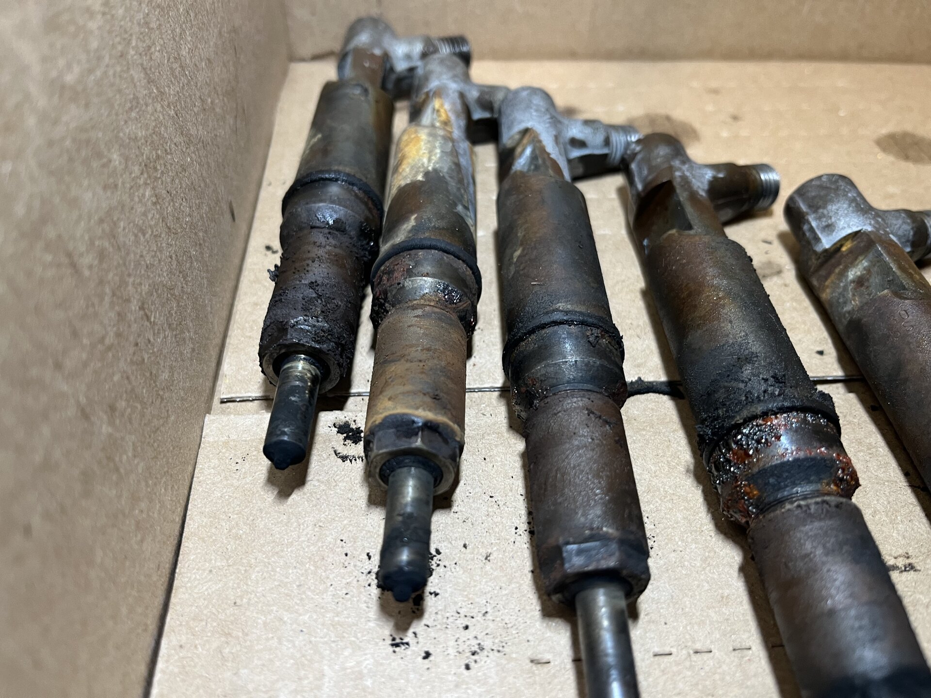

The injectors all came out via the twist method. None of the injector seats came out with the injectors. I will need to extract those.
I previously did a compression check but could not obtain cyl 2 because of the leak pipe in way of my pressure gauge . Before starting this job, I re-did the compression check with the leak pipe removed. The numbers came back much different (lower) than the first time around. Engine was warm to operating temperatures both checks. I am thinking this gauge from Harbor Freight is garbage. Engine starts on first crank every time.
I do suspect cylinder 2+3 may have bad valve seals as the glow plugs contained some oil and the exhaust contains some blue smoke at startup that clears up a couple minutes later.
My plan is to replace all valve seals with the head still on.
I have a new set of injectors that will go in and I am considering having the pump rebuilt while its out.
